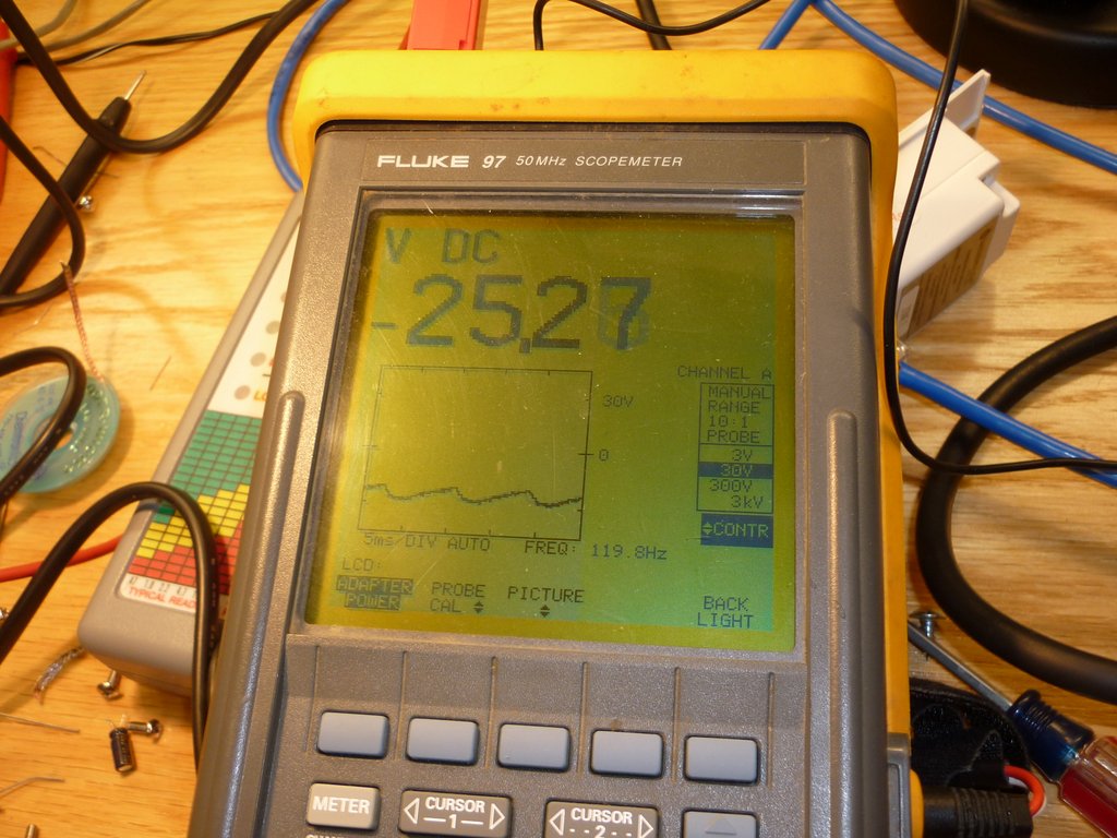

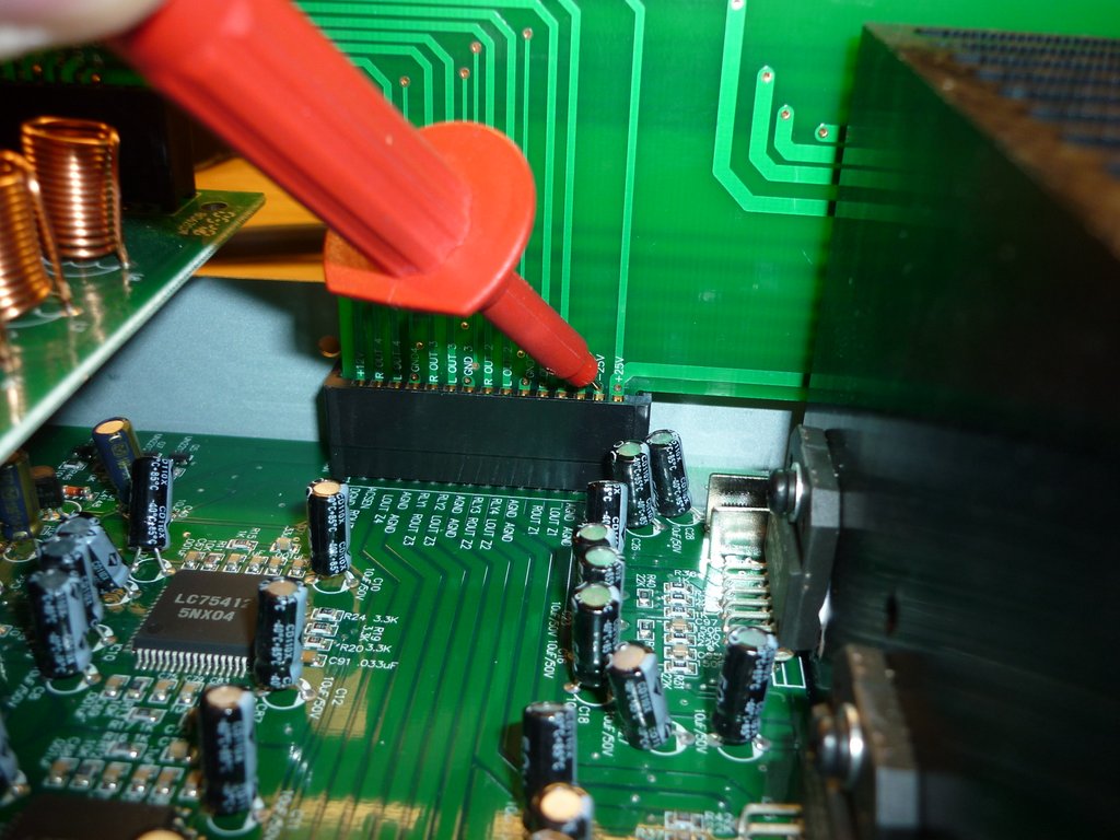

    So eventually I figure out the right button to press and I am off probing voltages. The supply puts out +25v, -25v and +12v. See the pictures, but I think the -25v has a 120hz ripple on it which could be the source of the hum. Its a little strange because the voltage was lower (-18v) probing just the power supply with the connection to the amp removed (pic 2&3). With everything in place for the amp to work I got the proper -25v (pic 4&5). Both however show a 120hz ripple. The +25 and +12 rails were normal. What causes this? One of the filter caps going bad maybe? They look like high quality items (Topcon!).
    TLDR: I have a 120hz hum on a whole house audio amp. I have isolated it to the -25v rail. Any suggestions on how to fix this are most welcome.

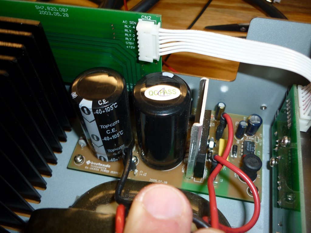

    One of the large capacitors filters the +25v and another filters the -25v ... the one for -25v is probably going bad.
    Try swapping the main capacitors around... if the problem moves to the other 25v ... you have the solution.

      the scopemeter just told you the one on the - supply is shot.

        I have a capanalyzer which I don't yet fully comprehend. I pulled both caps. Tested the first one and it fails with the DCR (DC resistance) low alarm. The second one doesn't react at all on the capanalyzer. I am not sure what to make of those results. Both read in excess of 10,000uf capacitance on my DVM (Out of range - 10,000 is its limit). But I know not trust that measurement as proof that they still work. So now I am off to order 2 new caps from DigiKey! I'll report back with my results.
        edit: I will add that the one that didn't react seems a little bulged on top as compared to the other one.

            Well, the scope already showed him what he needs to know - the cap on the -25v rail is bad.

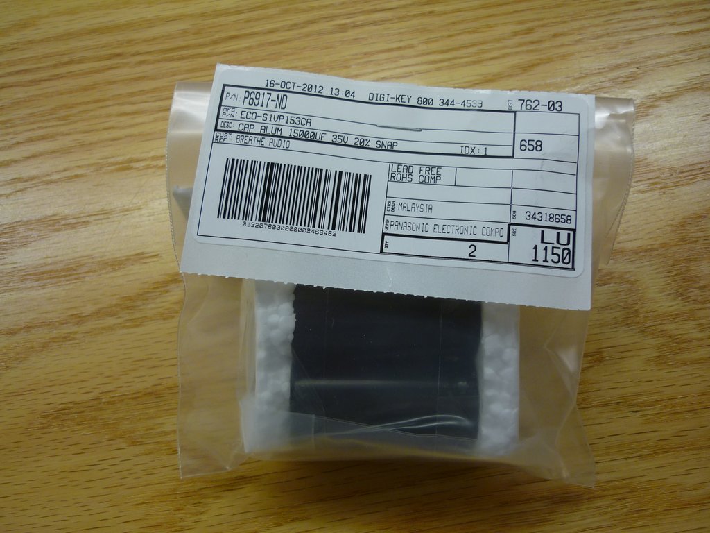

                  Success! Another one saved from the dumpster. The two new filter caps did the trick. So if anyone else has hum or static on your amp on all sources and in all zones, just order yourself up 2 ea of the filter caps (P/N P6917-ND) from digikey.com and you will be back rocking out in no time at all. Thanks for all the helpful replies too!

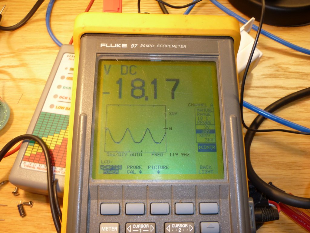

                    No capacitance! You were reading pulsating DC.

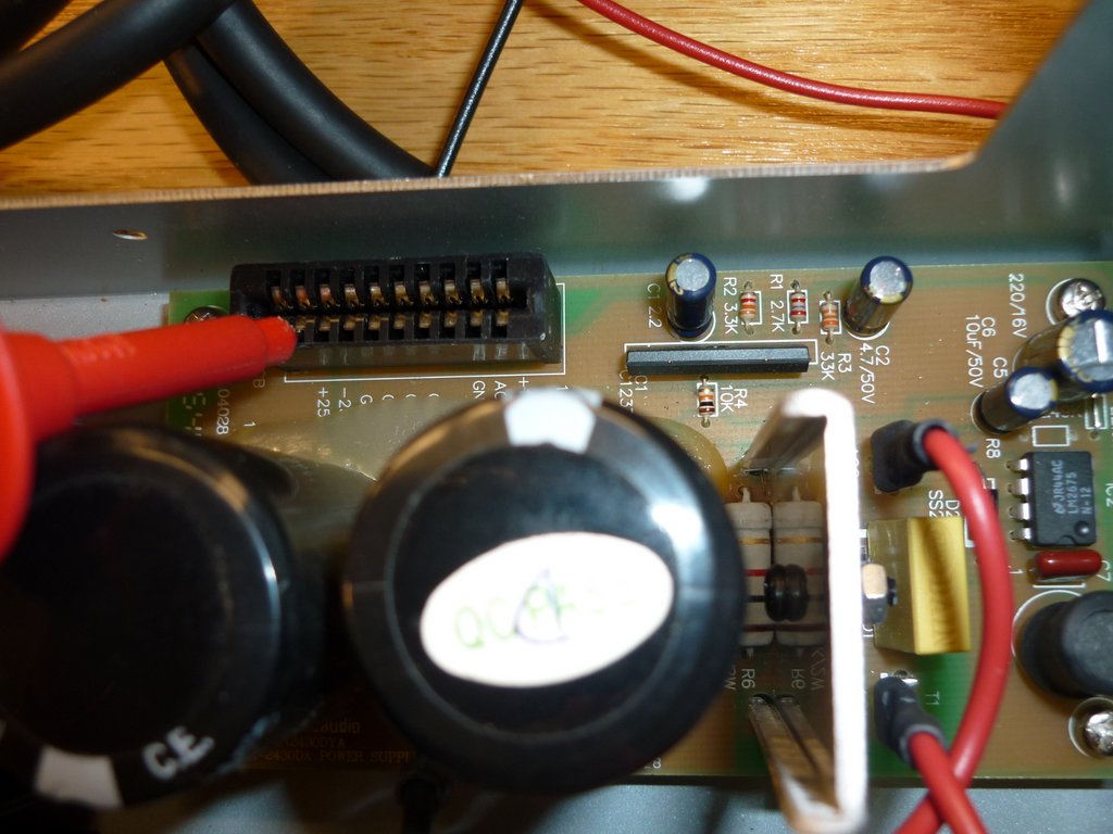

                    Not really. The voltage appeared to come up, since there are some smaller caps on the amp board that were vainly trying to hold the voltage up. But still no filtering, hence ripple and buzz. Just a 'gotcha' to beware of- as you've seen, it can mislead you. The scopemeter sure didn't, though!
