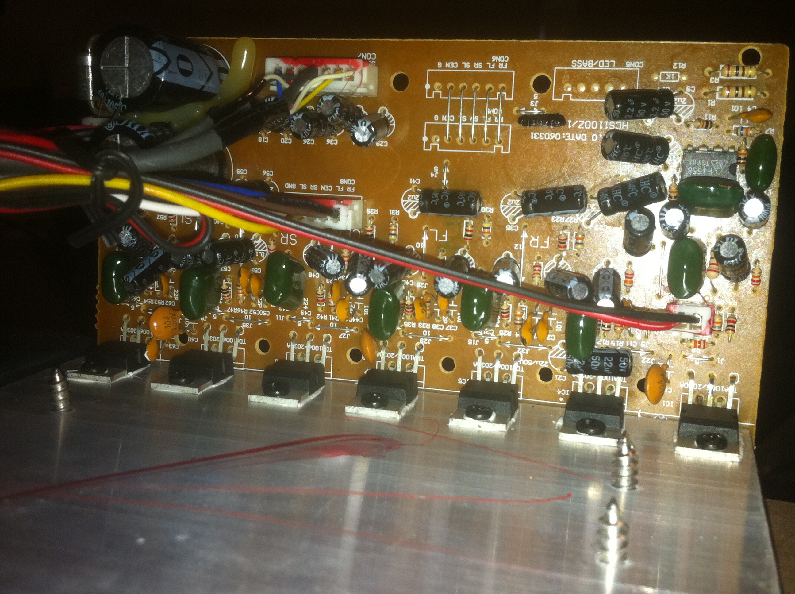

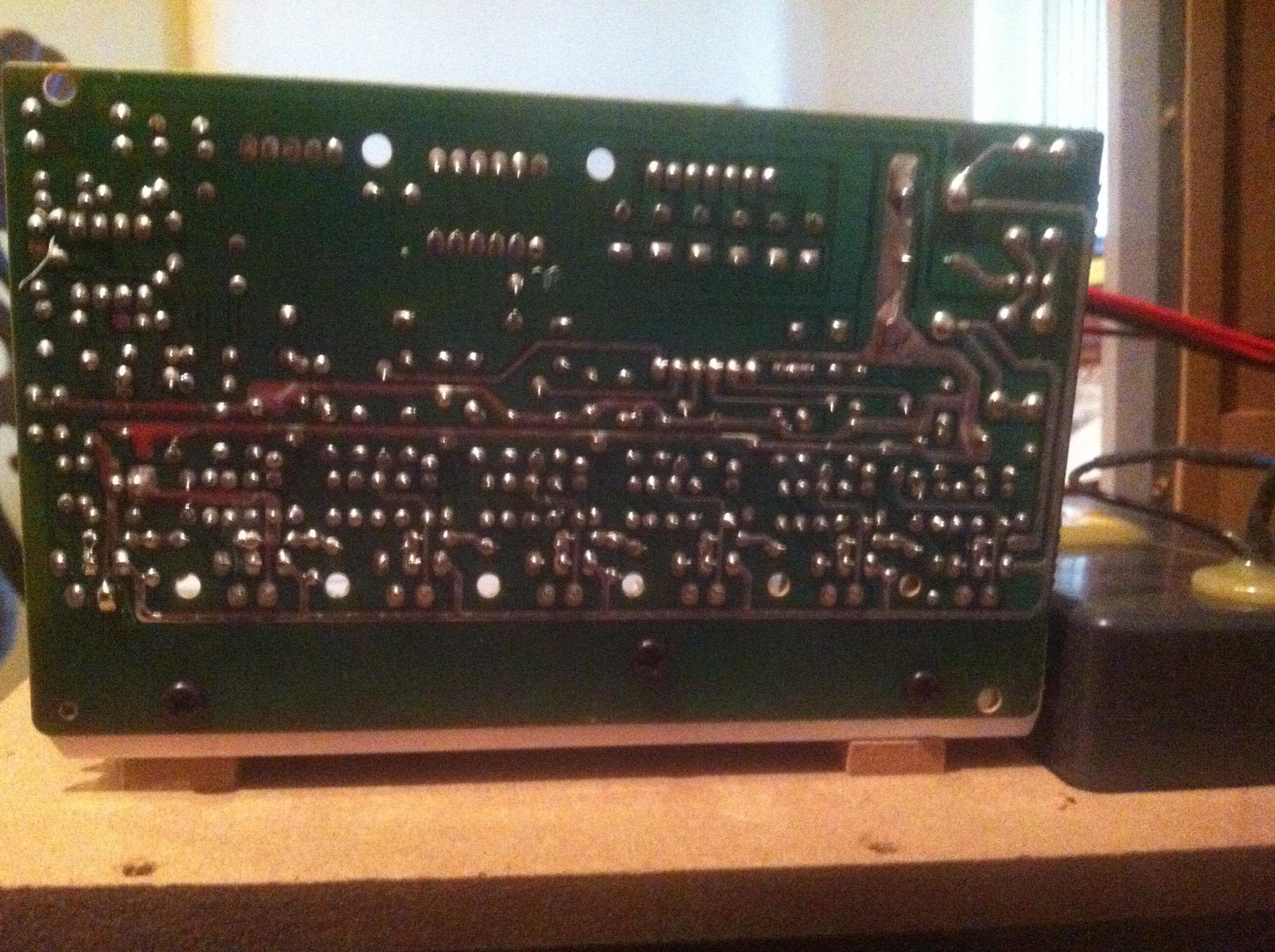

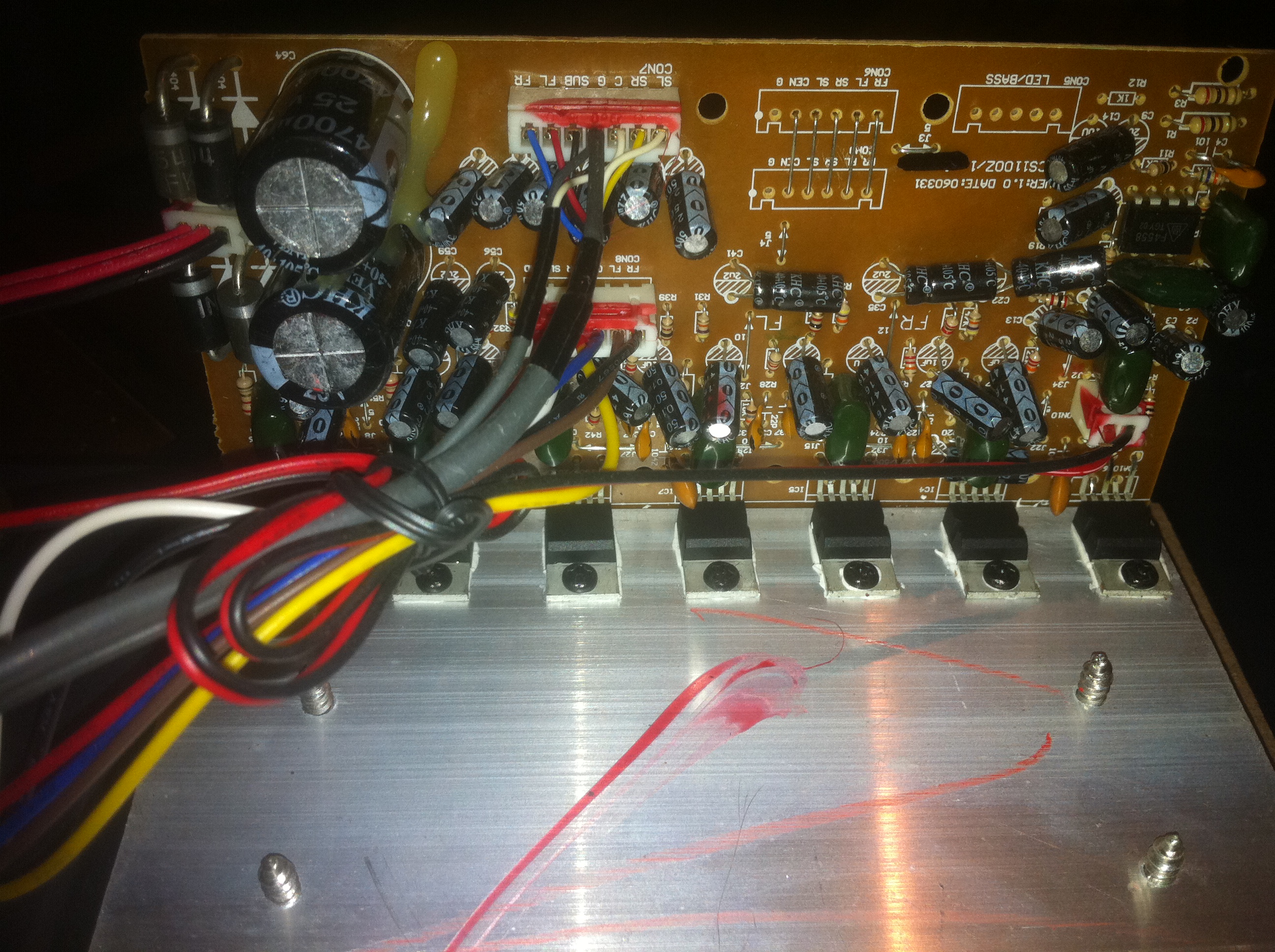

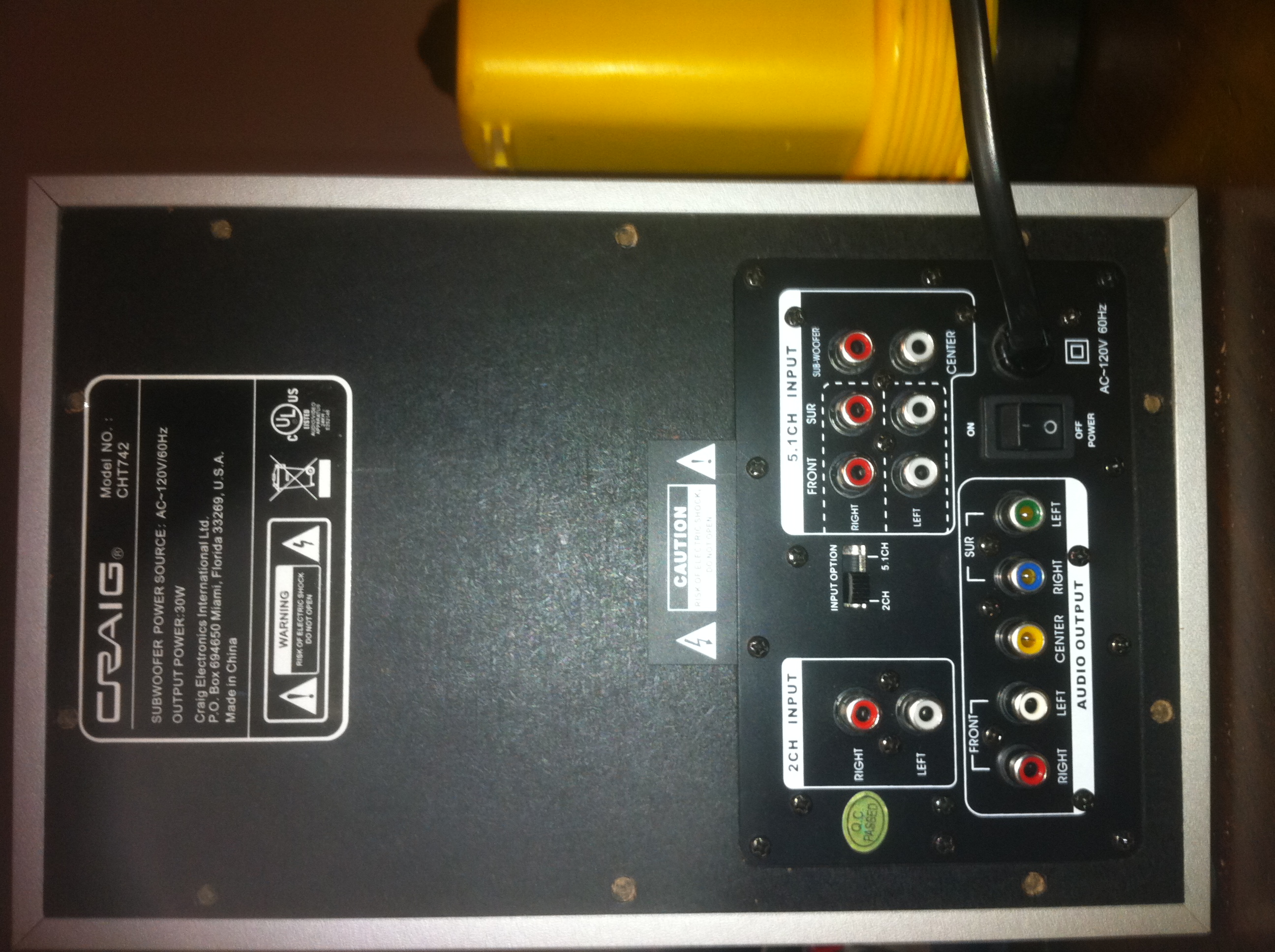

          Thank-you for the replies and here are a few pictures. I hope they are clear enough.
          momaka, yes the t.v. will be sending the audio to the sub (2-ch) and then the sub to the speakers. I believe it does amplify.
          999999999, i do believe that the amp for the speakers are in the sub, new here so forgive me if i am wrong but the amp is the 7ic s at the bottom. No? The output audio of the t.v. through the jacks are not adjustable from the remote or t.v. menu.
          I don't think i'll need independent adjustments as i will not be using the 5.1 but only the 2-ch option. I think trying to tamper with the 5.1 would be out of my league, for now.
          An equal reduction is what i am looking to achieve but wasn't sure if it was possible to just add a pot before the cable goes into the sub and have it work. Also would a 25k pot(stereo, log) be sufficient?

            Yes you can use a 25K dual gang log pot, or even two separate 25K single gang log pots for some attenuation of L vs R channel. Personally, I'd just drill a hole in the sub housing or back-plate and mount it there rather than having to build a separate box with connectors to have it before the cable gets to the sub, but either way would work.
            Having it in the rear does seem less convenient since you're going to have to go over and adjust that knob any time you want the volume to change.
              Re: Adding a volume control
              Does your TV has headphone output? What brand id the TV?
              The 7 ICs in the units are for sub woofer and 5 speakers (2 IC are setup as bridge output for driving the sub woofer speaker, the other 5 are one IC per speaker, 5 speakers).
