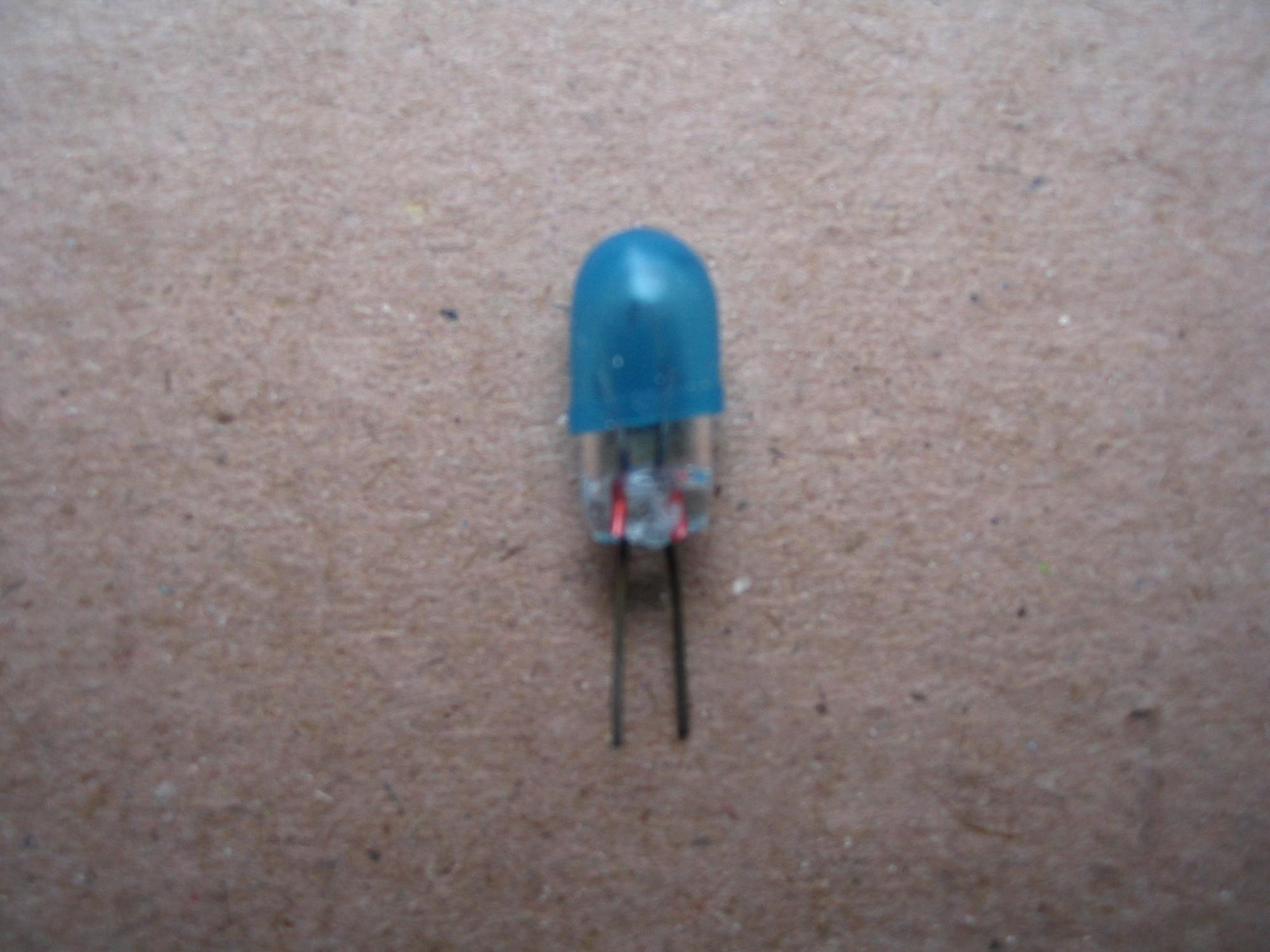

    Hello All,
    I'm almost finished restoring a Sansui R-303 Receiver. But I'm not having any luck sourcing a replacement bulb for the back-lit tuning dial. The old bulb had a blue sheath around it to change the light color to blue. I tried measuring the connection point for the old bulb to get the voltage info. I got 18.50VAC.
    Does anyone know where to locate such a bulb? Or perhaps a circuit to drive a regular blue LED in its place? Any help at all would be greatly appreciated!

    nothing there for scale but it looks like a common grain of wheat like the ham rigs use.
    are there several in series?i suspect that is a 24v or a more common 12v and a series resistor.
    and i often replace with led's.unless its a marantz blue may look tacky.
    the tinted boot whitens it.
    maybe white led's?
    you will need a diode too.
    or run em from another regulated source.

            incandecents dont care about ac or dc.
            just had a yaesu g800 rotor control in here with a dead bulb.it ran from the 14v ac winding on the transformer.a 1n4007,white led,and a 470 ohm resistor and it should be good forever.
            if the slight flicker bugs you a small lytic across the led will reduce that.
            since it edge lights the scale i used a diffused led.
            your sansui probably does too.

                  Hi, I know this is an old thread but I've only just found it while researching the same problem with an R-410 receiver (Same circuit as R-303).
                  Did you ever find a sensible answer to your quest?
                  The original lamp is 12 Volts at 150mA.
                  I haven't been able to find an exact replacement but I have found one of 12 Volts at 100mA which will do the job, albeit a little less brightly. 4mm diameter x 10mm long.
                  The 39 Ohm series resistor on the PSU board needs to be changed to 60 (62) Ohms, 1 Watt to suit. (or add a 20 (22) Ohm, 0.5 Watt resistor into one of the leads to the lamp board).
                  An LED won't do the job, even though it is straightforward to cobble one in with a suitable diode and resistor, because the light needs to radiate all around the lamp to properly illuminate the plastic dial, whereas an LED radiates from the end only and doesn't illuminate the plastic 'ears'.
