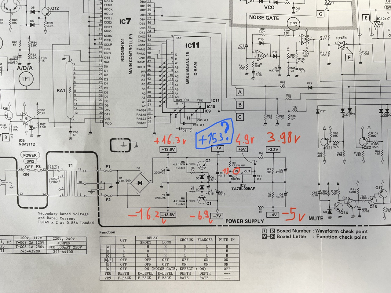

      Hi everyone, I took a step back, and before delving into the world of signals over time, I started again to measure the voltages arriving at the circuit immediately after the transformer and rectifier bridge, and I noticed a voltage at the ends of Q2 which doesn't add up to me, it should be +7v and instead it gives me more than double, instead at the ends of Q1 it is correct -7v, I measured carefully several times so I'm sure of it, it could be the capacitors or some component, or it could actually be Q2 the problem? I attach the photo of the circuit and the measurements I made, Greetings Mauro
        Re: ROLAND DAC-15D only dry signal
        Doesn't look right. Check the voltages at both the zeners going into q1 and q2.
          q2 appears shorted or d3 is open or has bad connection . it should measure 7.6v
            I checked the voltage at the ends of the zener diode, and indeed there was a broken solder, now the -7v and +7v voltages are correct, but the effects are still not felt. Excluding and hoping that ic7 controller is ok, I start to think that it could be a bad electrolytic capacitor, or some transistor. I'll gradually start checking the ESR of the caps etc, and then I'll move on. even with the oscilloscope, for now I don't think I can do anything else, thanks and greetings to all of you enthusiasts.

              You need to follow the input waveform around giong by the points that you have posted from the service manual. You previously posted waveforms from point "2" (I think). So you need to do the same for each point as identified by the pictures in the manual. The one of interest is at point 3.
              Having said that, IF the voltage output was at 15v as you posted, it is possible that it might have taken out a few components that rely on the 7.x volts.
