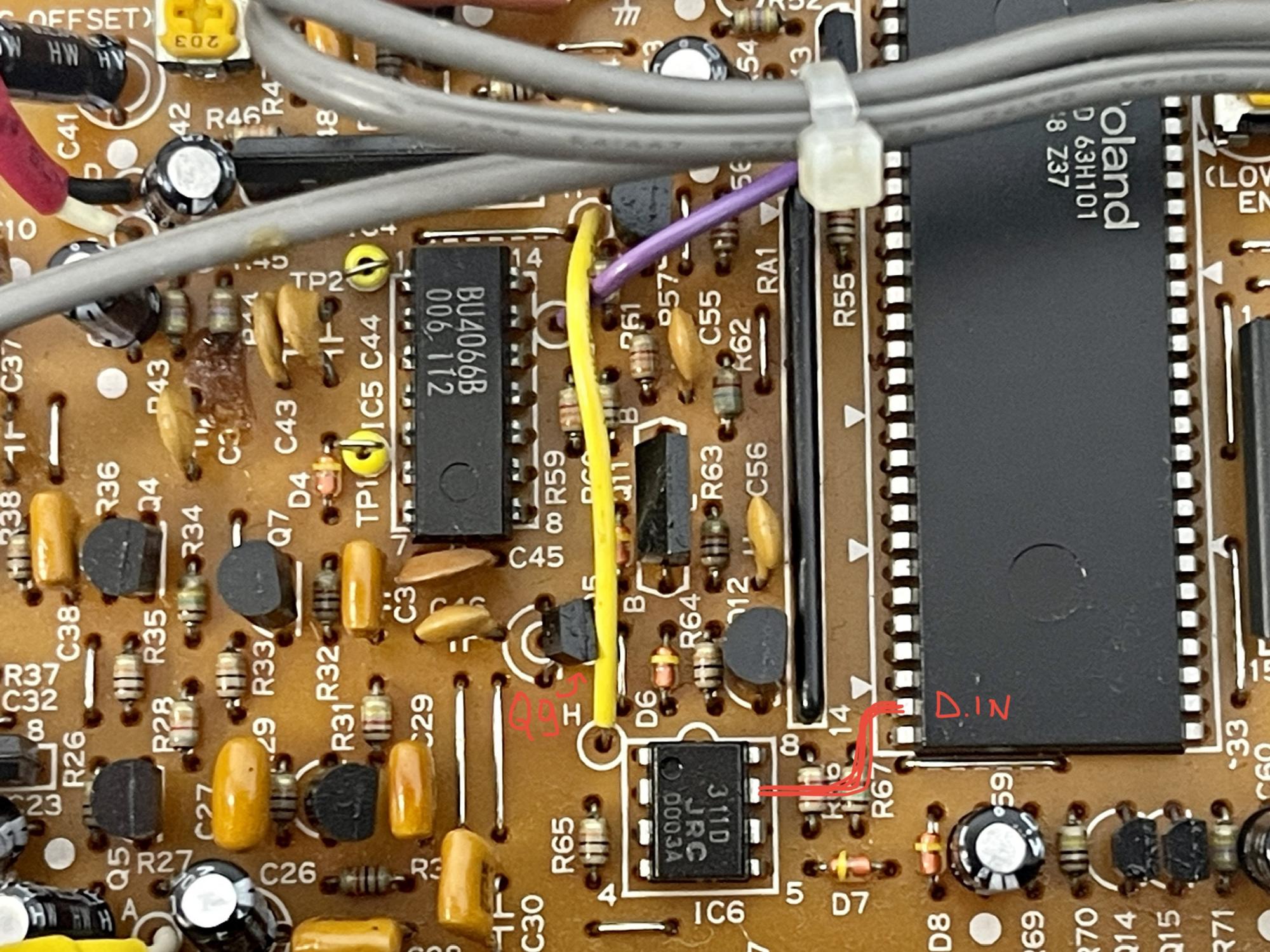

    Hi,i have this 80's vintage guitar amp in the lab for repair.
    The amp works pretty good,except the built-in effects,delay-chorus-flanger section.Led switch are working but cannot hear any effect.
    I have original schematics and they are pretty similar to Boss DD-2 delay pedal,but i don't understand very well how the signal is processed through IC 7 main controller,DRAM ic9 ic10 ic11,and other sections.
    I have an audio probe,poke with 1khz sine wave signal at input jack,i have also a mini oscilloscope,so if someone can lead me to the right way it will be so appreciated,thank you so much

    Hello,i made some progress,just poking around DRAM IC's pins with sound probe i can hear a modulated effect sound coming from speakers so it seems that something is working.Now i had to track the signal path until it stops,but i need help in reading schematics,i hope that someone more skilled and expert than me can help me in narrowing down the problem.
    PS: I thought I could see a waveform at the output of transistor Q9 but there appears to be nothing, just a voltage drop,sorry i'm a bit confused.

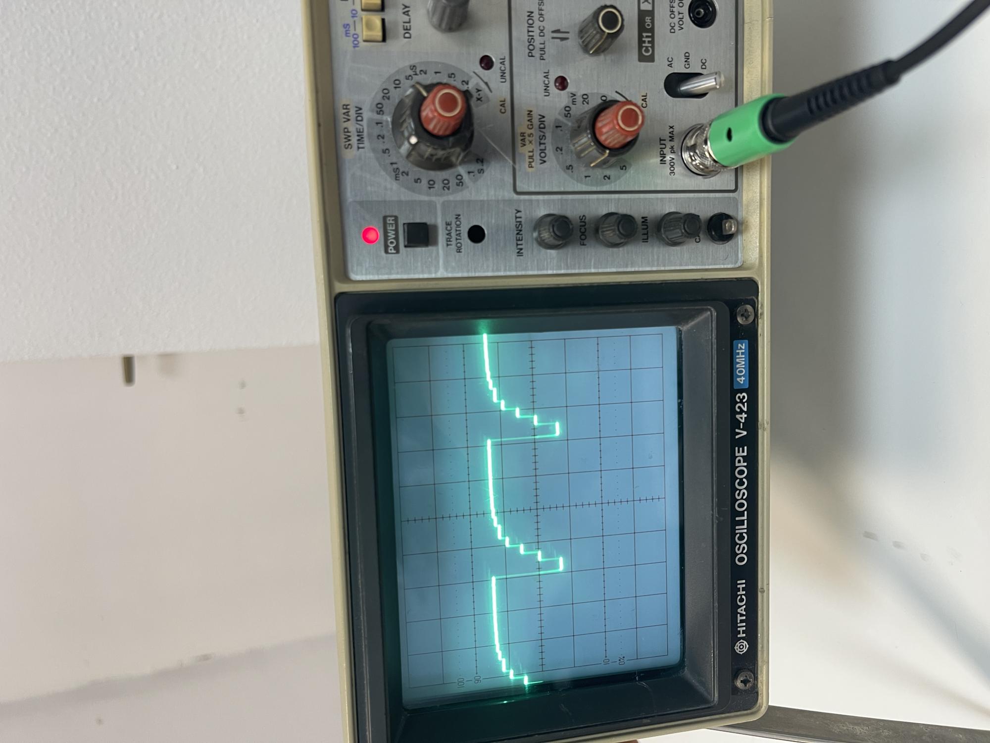

                  Sure,this is what i see at pin 31 of ic7 Din,an analog signal before digital sampling i suppose

                    ok... thanks. I am starting to get beyond my limited knowledge / experience (my roland suffered from noise / leaky cap). Anyway, I don't know what it means.... but you could be right as it is certainly digital. I think the levels seem "high". How big is your input 1khz signal. Further, how are you generating the 1khz... do you have other frequencies available just to see if the characteristic at IC7 changes with the frequency change?
                    At IC6 (after q9), both inputs should have a similar look. What are you seeing there?

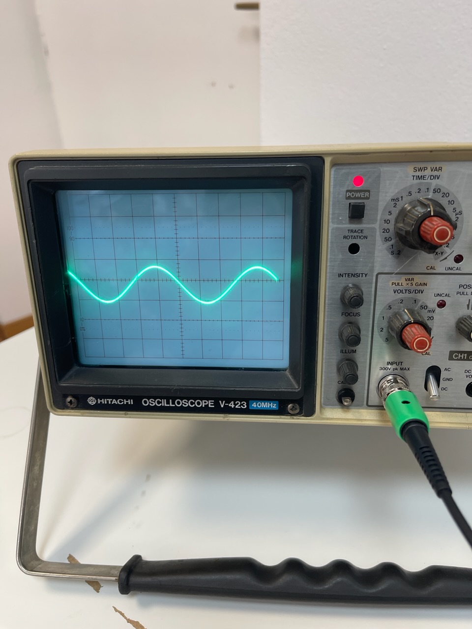

                      you should be seeing some sort of similar 1khz wave form at the output of the LPF section at q8.
                      another question about your input.... is it a nice clean 1khz sine wave? and further along the input signal path, does it continue to be nice and clean or are you seeing a totally "distorted" wave at some point.... maybe the input portion has some "weird" gain or such that the input can be handled in the further processing down stream.

                        It’s a 1khz 50mv sine wave coming from my laptop

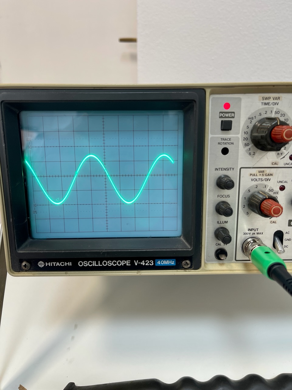

                            Re: ROLAND DAC-15D only dry signal

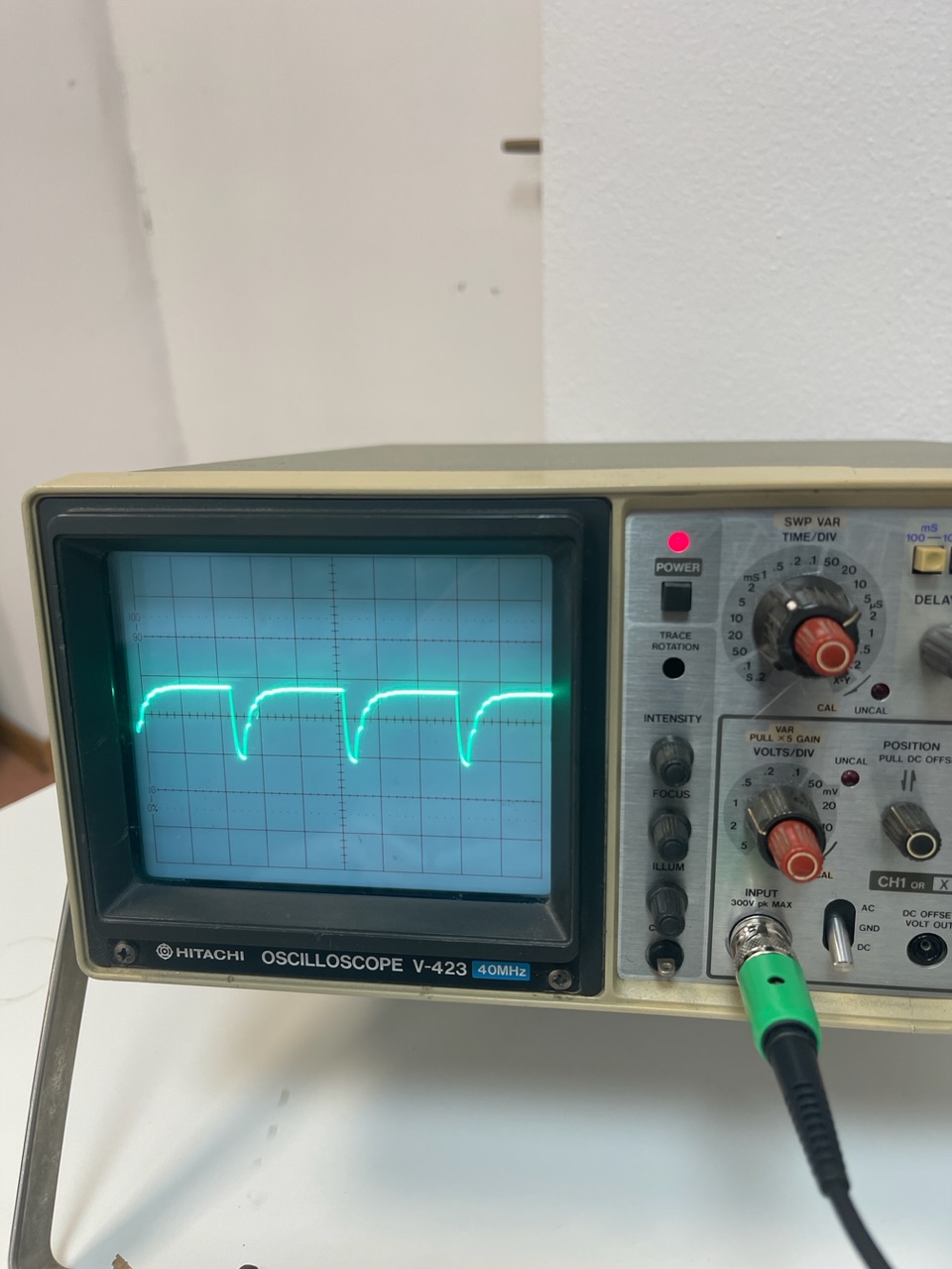

                            Ok i have an update,this is my input signal,1KHz at 700mv if i read correctly,and tje second image is what i see at master volume

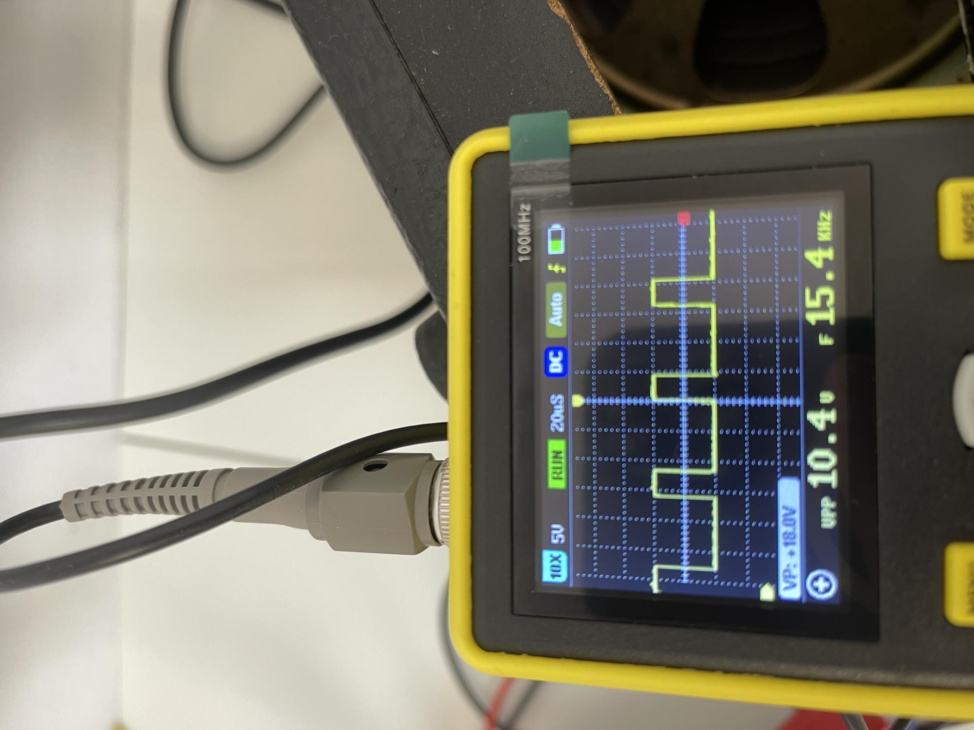

                              And this is what i got at IC7 DIN

                                This is the signal at TP2,effects are off because with chorus or flanger ON the signal is modulating in frequency so i don't have a stable image.
                                  I can't add much more other than "good stuff". Are you able to get a trace "point 3" which is just after Q9... it should be some sort of chopped signal similar to what you posted in #16. I am not sure why you aren't seeing a "normal" sine wave. It almost looks like you are getting some form of "rectified waveform" instead.

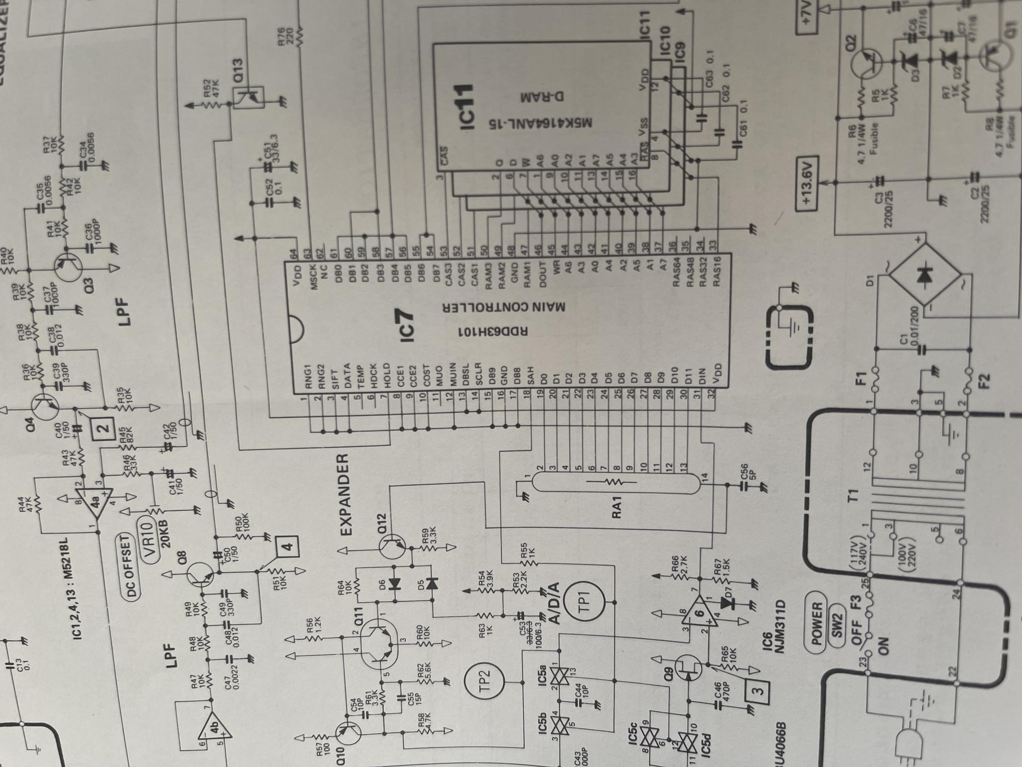

                                      sorry don't know much about the dram function or for that matter, the overall processing itself. When I was dealing with the noise problem, I did the same as you... put in a nice clean 1khz waveform and followed it along til I found where it went bad / noisy and then started check components in the area thereafter.

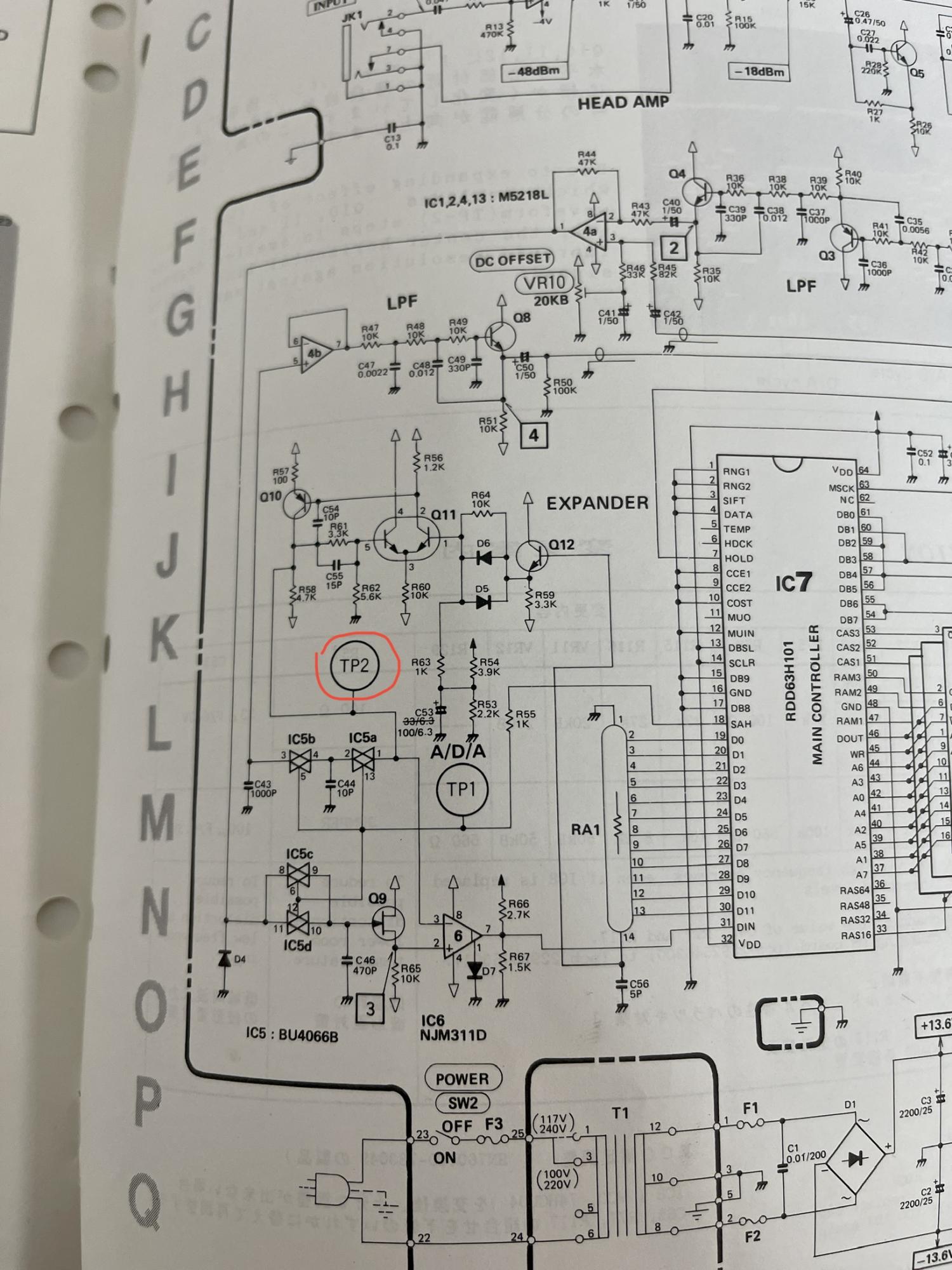

                                      Another question for you, your post showing the schematic shows a better "picture" than previous posts which I think you took from other sites. Do you actually have the "service notes" for the DAC15. Mine shows some wave forms at some noted points....
                                      in particular, tp1 and tp2... but I think you use them via a two channel scope and cause some triggering there in.
                                      One more thing... I was referring to "reference point 3" (square box 3) and not TP3.... just to ensure we are talking the same thing. Further, the chorus should be on to check waveforms at 1-5.
                                        Yes i have the original schematic of Roland Dac 15D,so now i understand what u mean when you say Box 3,they are waveform points,i will check on those in the lab on tuesday so i hope i can figure out something interesting,the thing that i would track is the effetcs signal path from the IC7 controller outupt to the output loudspeaker,but i’m not so confident in schematic readings,i try to do the best i can
