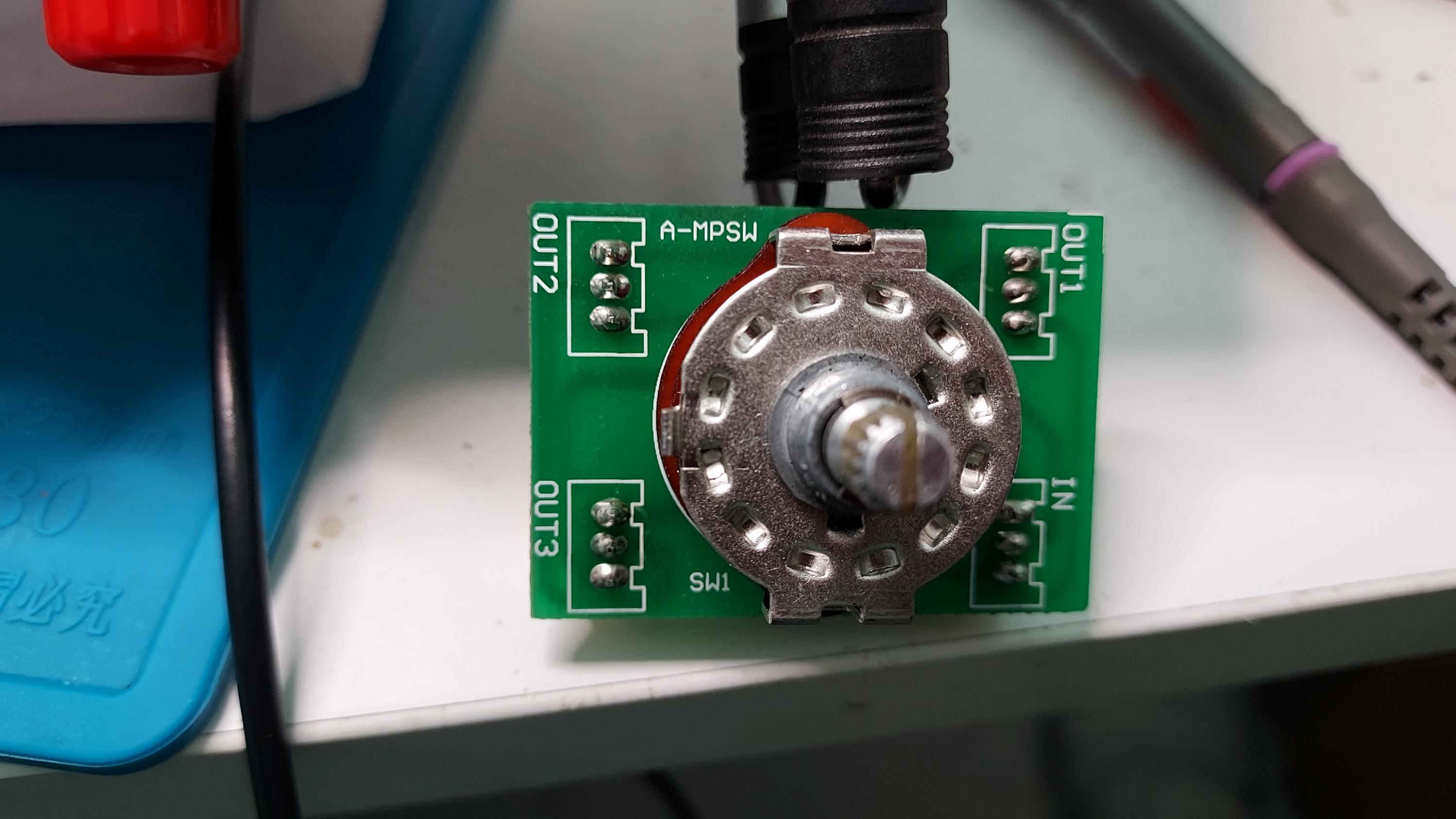

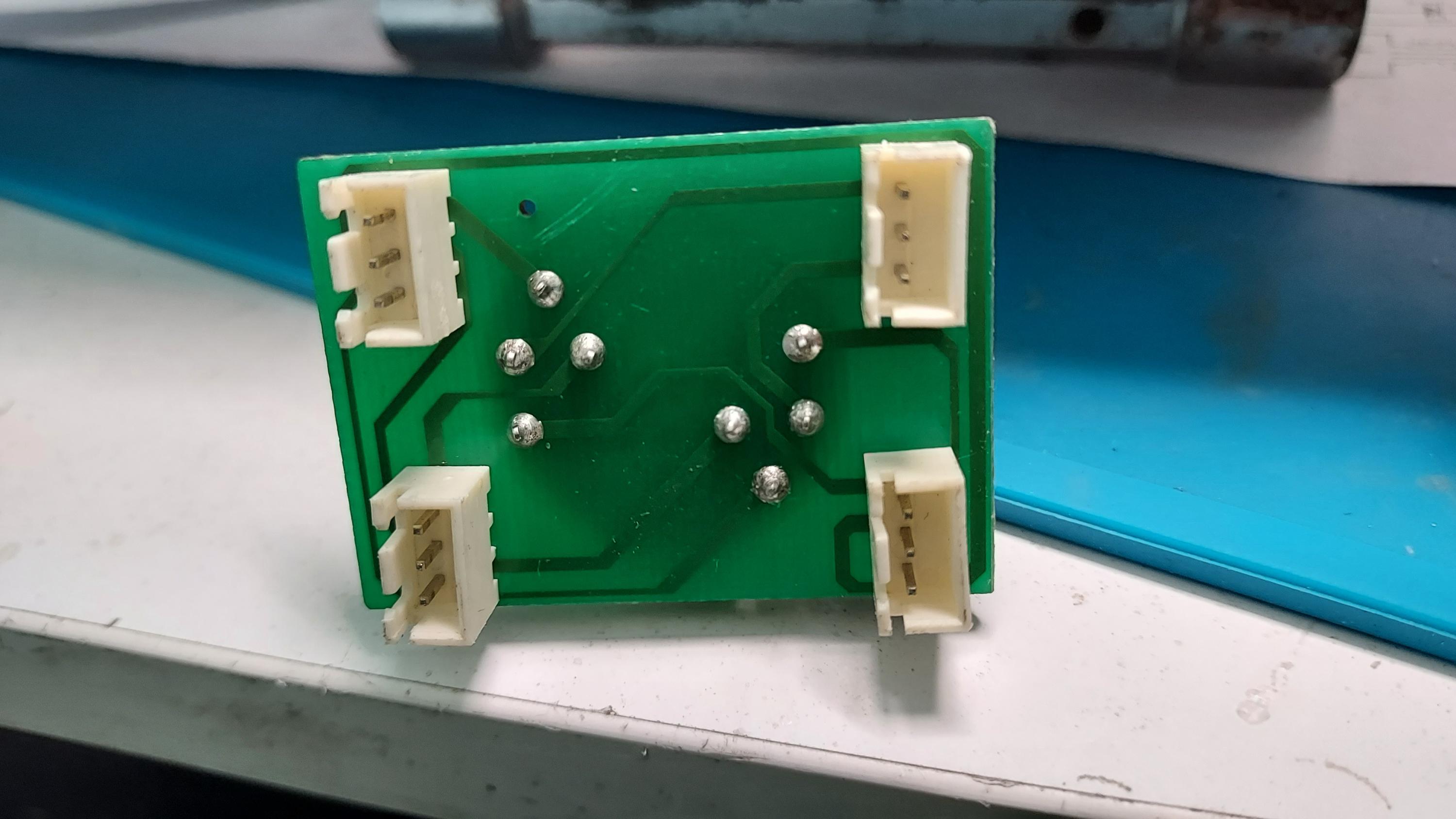

    The 3 input selector is broken for right channel. (it's a 3 position, don't look at previous picture where it's shown a 4 position selector)
    Could you help me to find a suitable replacement based on the picture provided?
    What would I need? A "RS25 2P4T"??? Any guidance, more than appreciated.

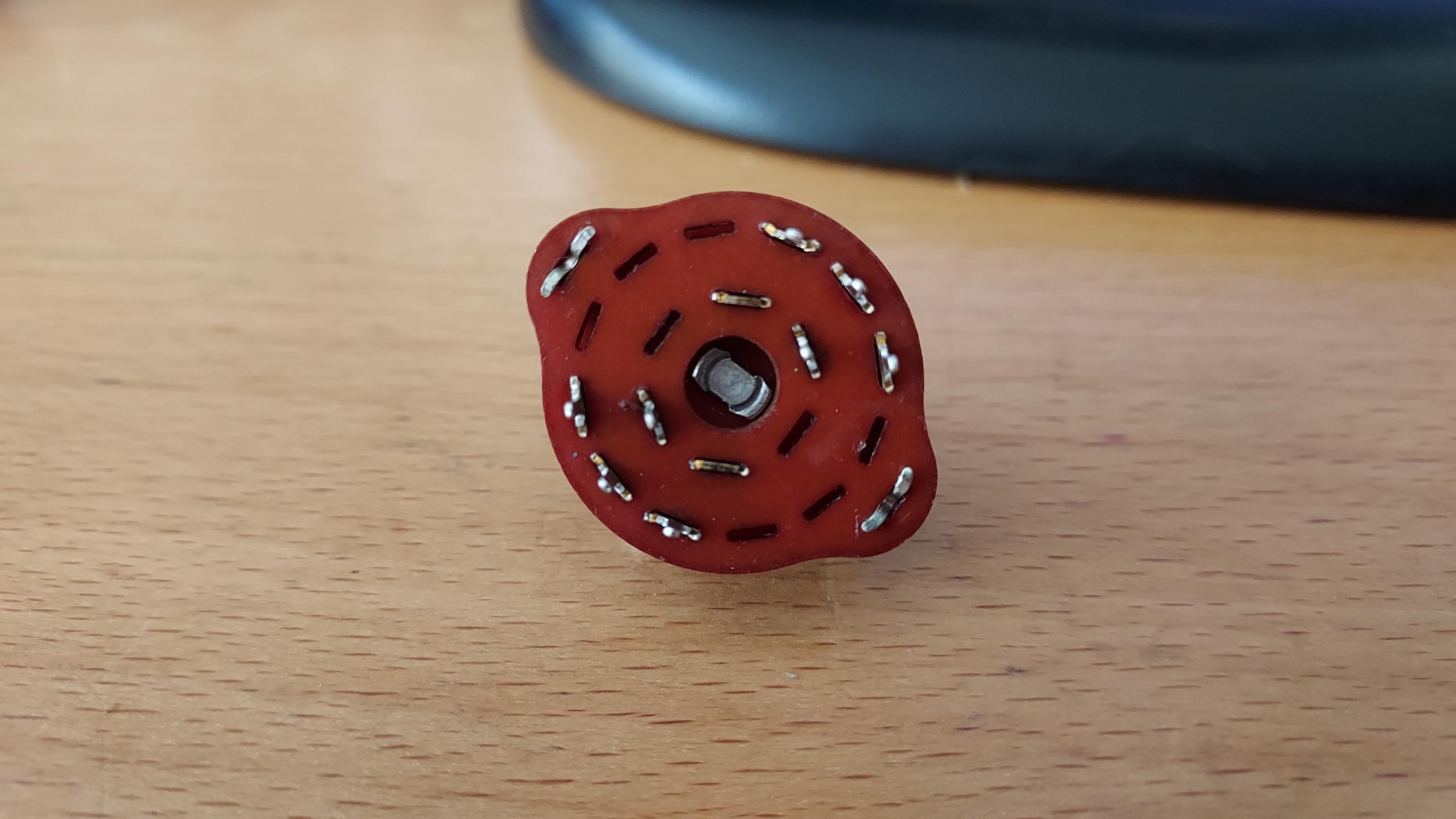

      After de-soldering it, I think I need to order a RS25 4P3T and cut 2 terminals from the center.

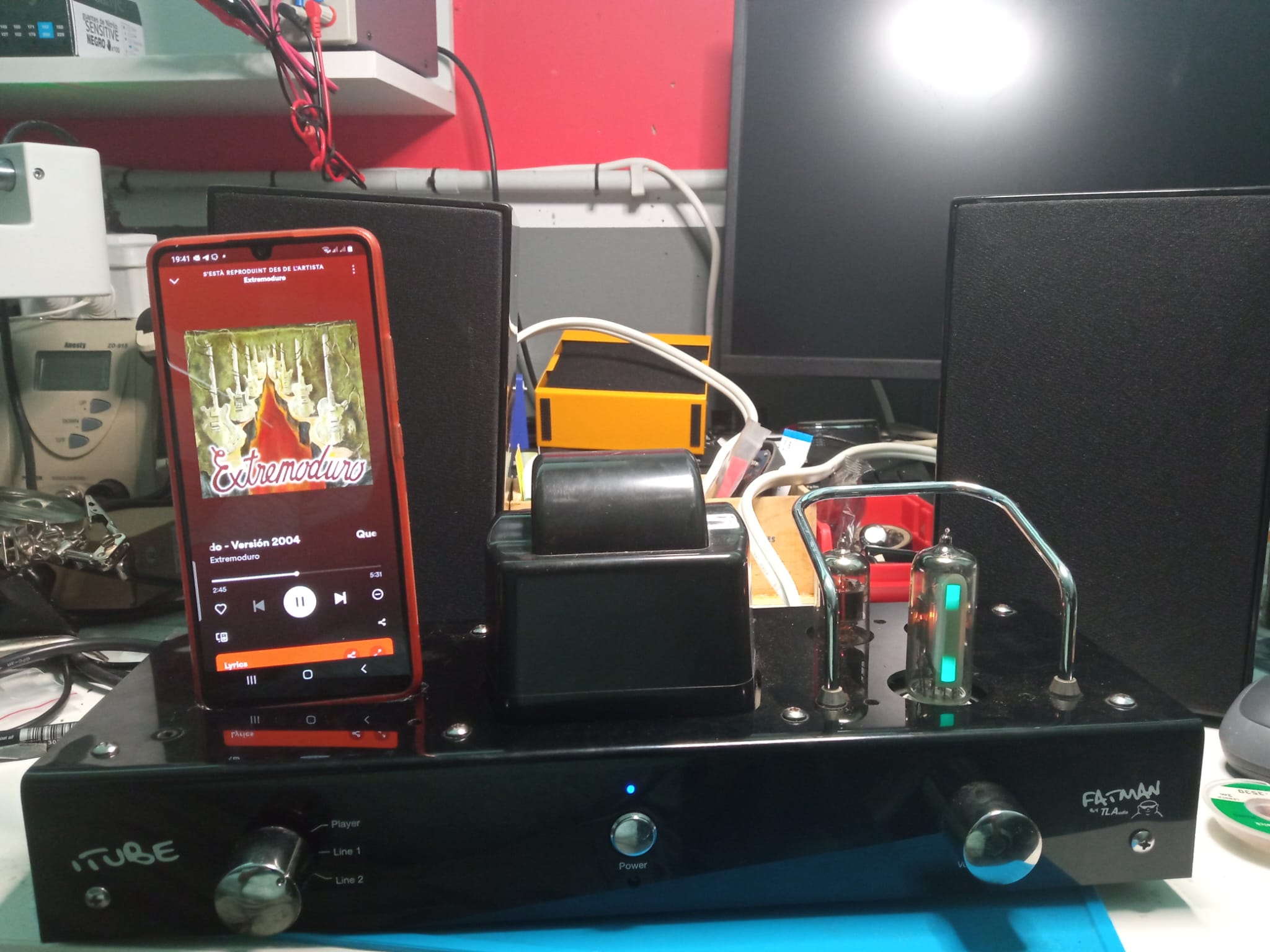

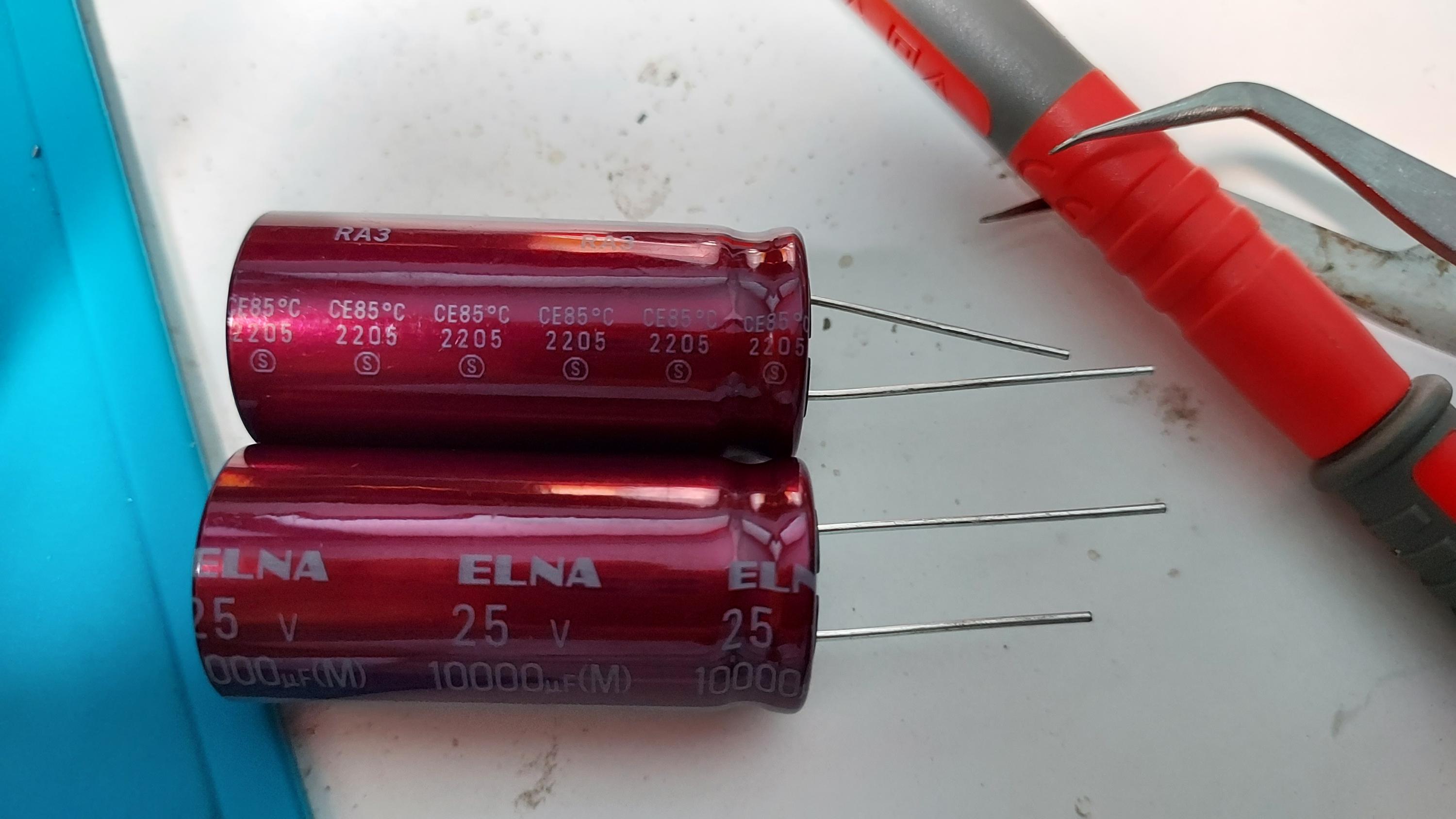

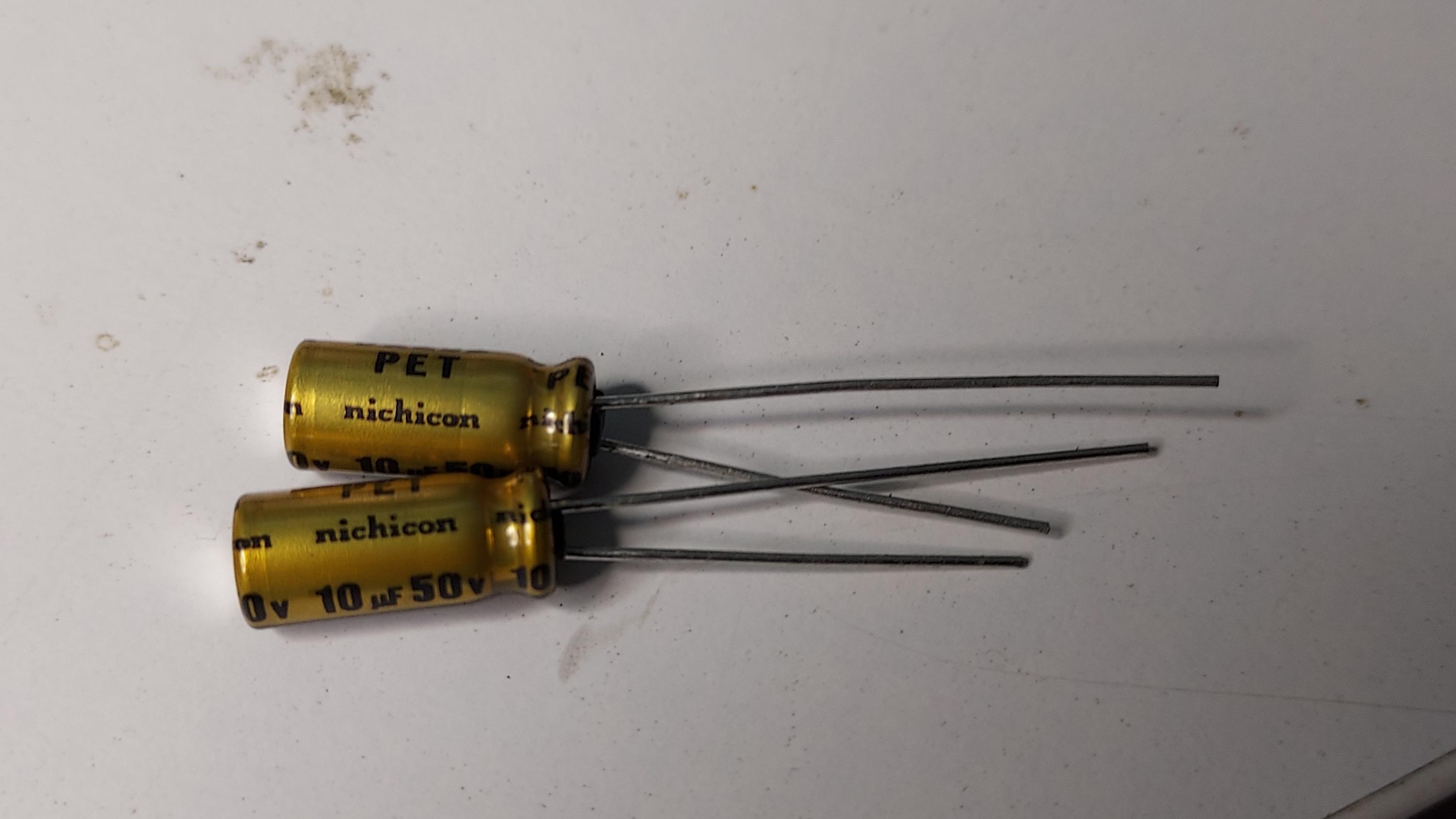

        Switch has been changed, but also took the oportunity to upgrade some Chinese capacitors to a more sofisticate ones.

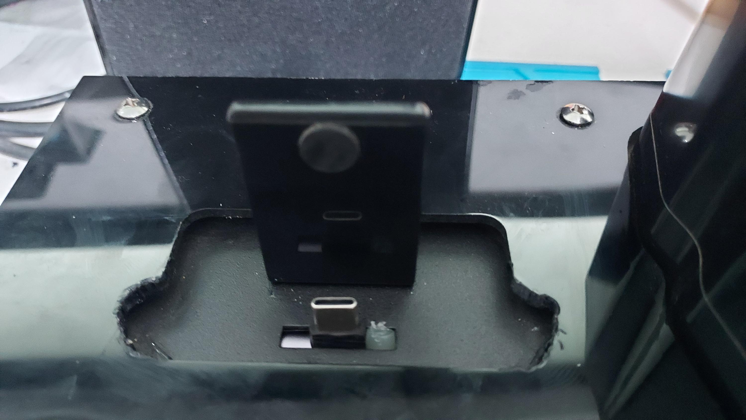

        Last but not least, I've changed the iPod connector to a USB C connector, so now I can plug my mobile.
