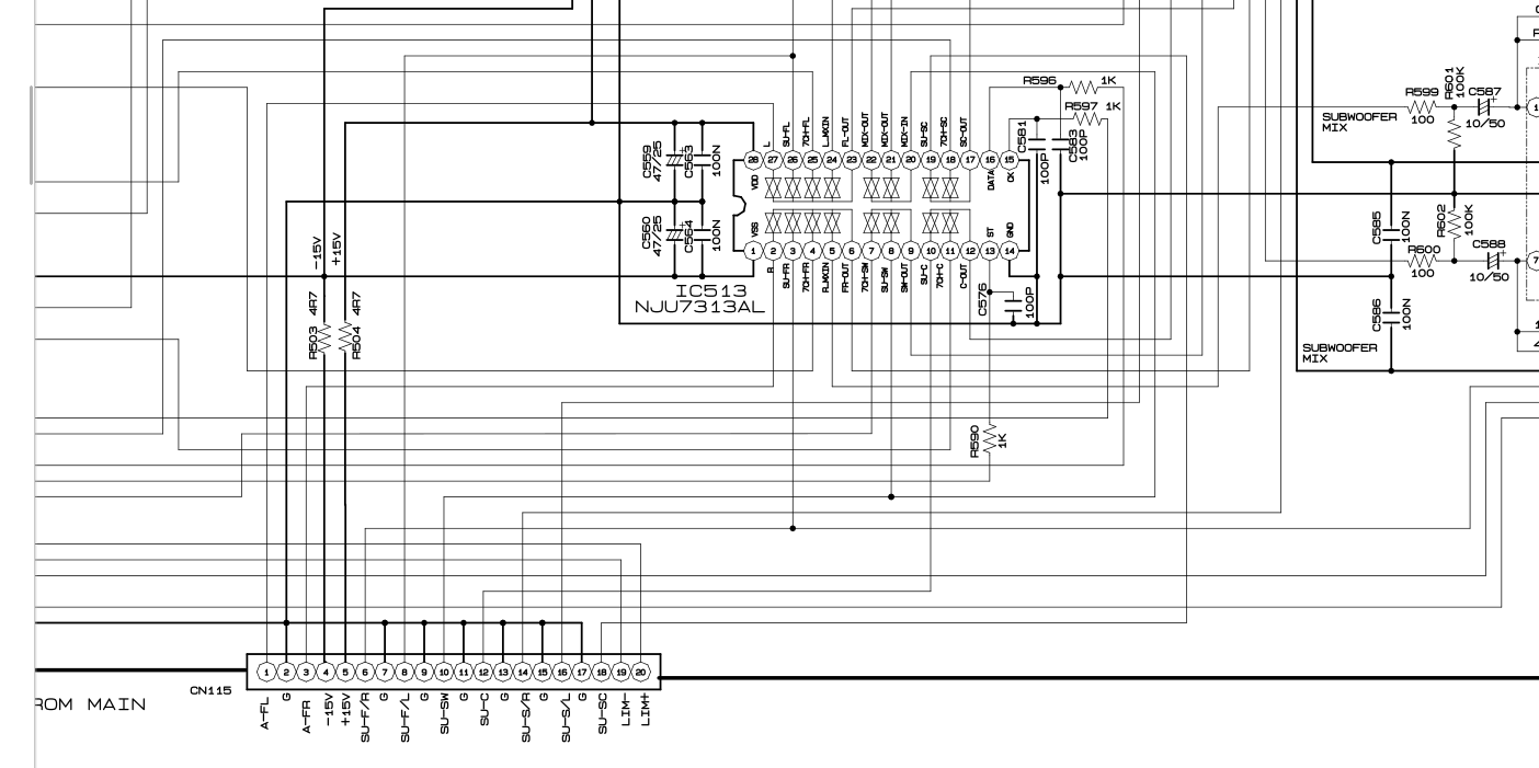

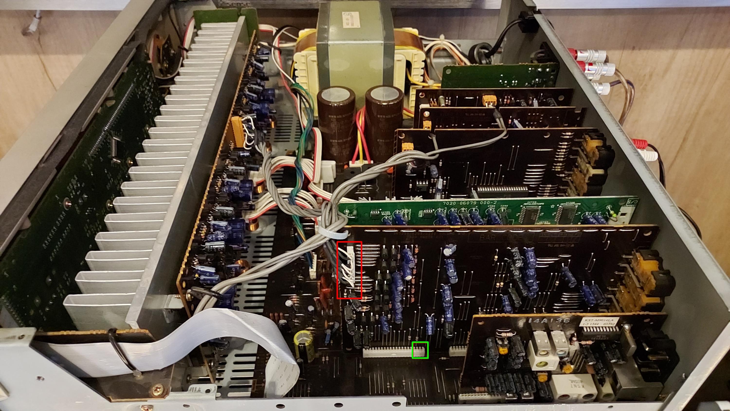

    I think I've done some progress with the unit.
    Using a "test CD" I am tracing the signal using a 10Khz sound (track 5)
    - The signal arrives ok for both channels to CN115 connector (marked in green)
    - There is no R signal in CP201 connector (marked in red). This ones goes directly to the amplifier section. Only L signal in pin1 from this connector.
    I've attached part from the "volume board"......This card is connected to CN115 connector. Pins 1&3 from CN115 are directly connected to IC513 (NJU7313AL) pins 27 and 2.
    I see signal in these pins but not in the R output (pin 6). I only see signal in L output (pin 23).
    I've ordered a new chip and let's see the outcome.

          Changing NJU7313AL has not made any difference. I have the L+R inputs entering pin 2,27 but just the L output on pin 6 (nothing on pin 23). So maybe the previous chip was ok and it's something different.
          Looking at the datasheet, I should have bit9 and bit10 enabled to have both outputs (L&R), but I guess the current situation might be that only bit10 is enabled.
          I guess all this digital data is coming from DATA (17), CK(16) and ST (13). And all these pins come directly from IC107 (CXP740096).
          This is getting complicated.
          Any tip / suggestion how to move forward?

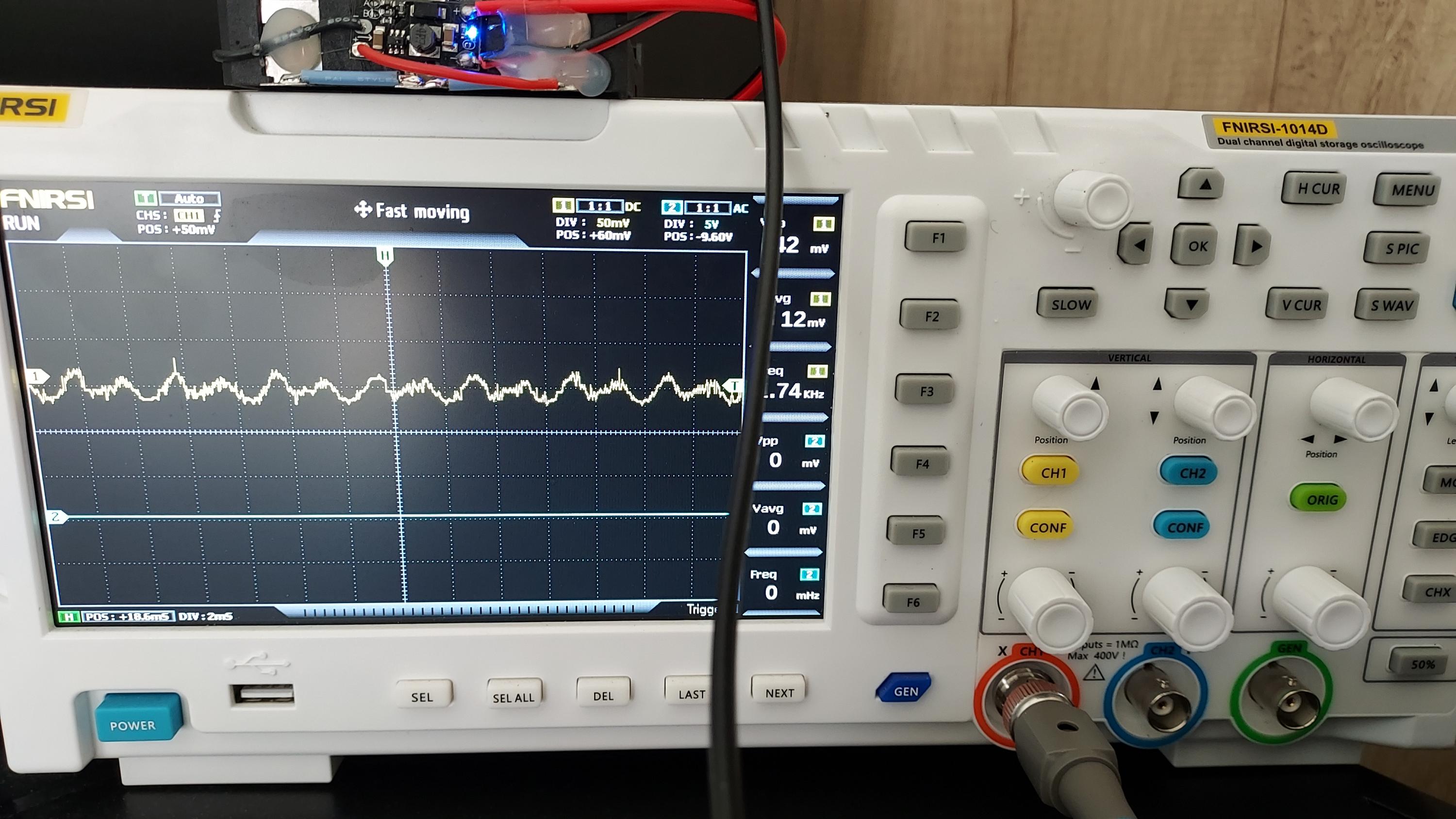

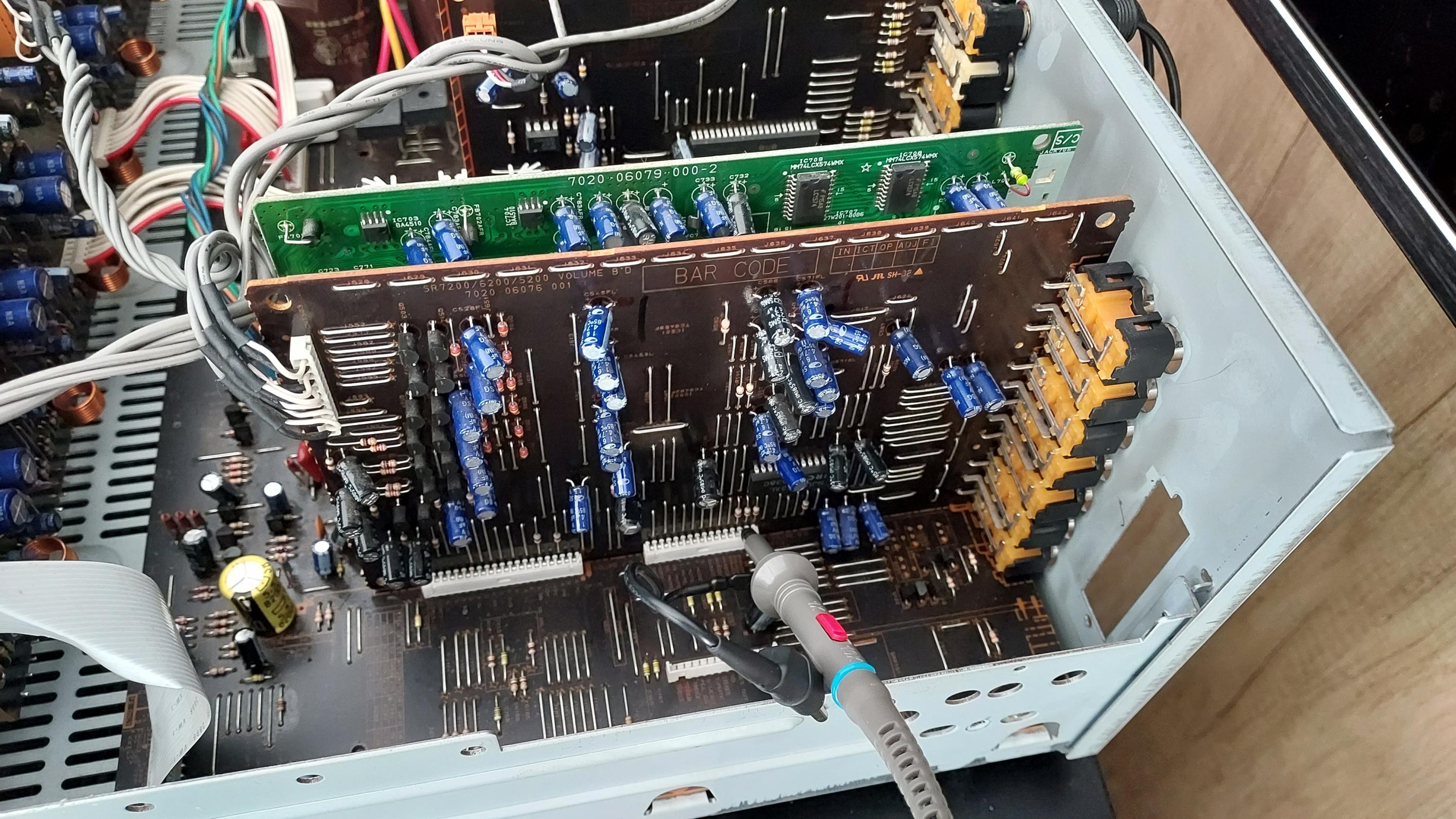

                By removing the cap (I removed positive, so negative is the direct contact point with IC). No difference. Just the signal is there when "direct" is activated.
                Data (pin 3), and clock (2) show noise........Maybe is because I am not doing something right. (GND is chassis).
                I've attached a pair of pictures for reference.
