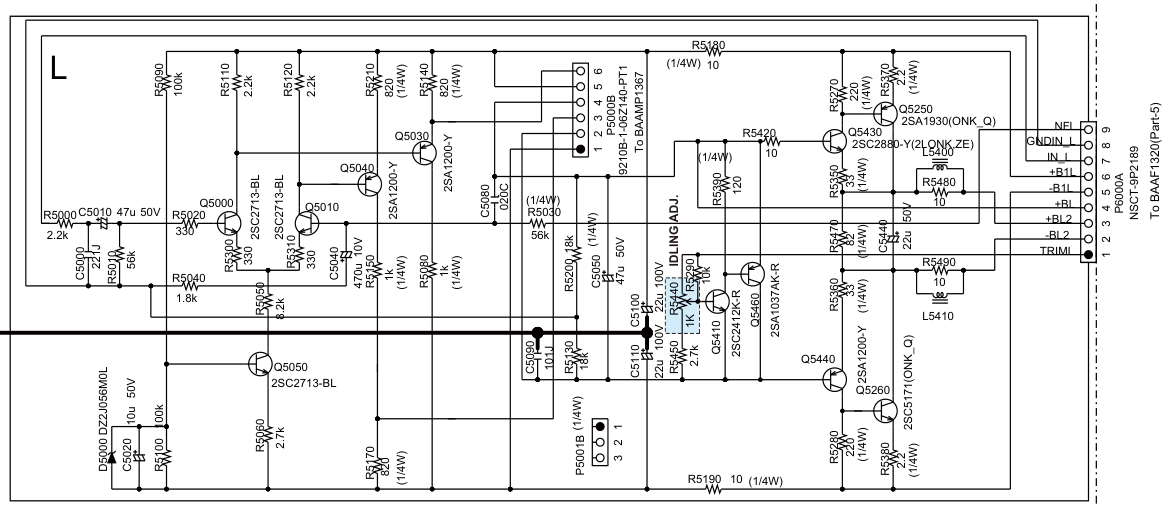

    Object: Onkyo TX-NR828
    Problem: Overheating / Burned off
    Service manual: available

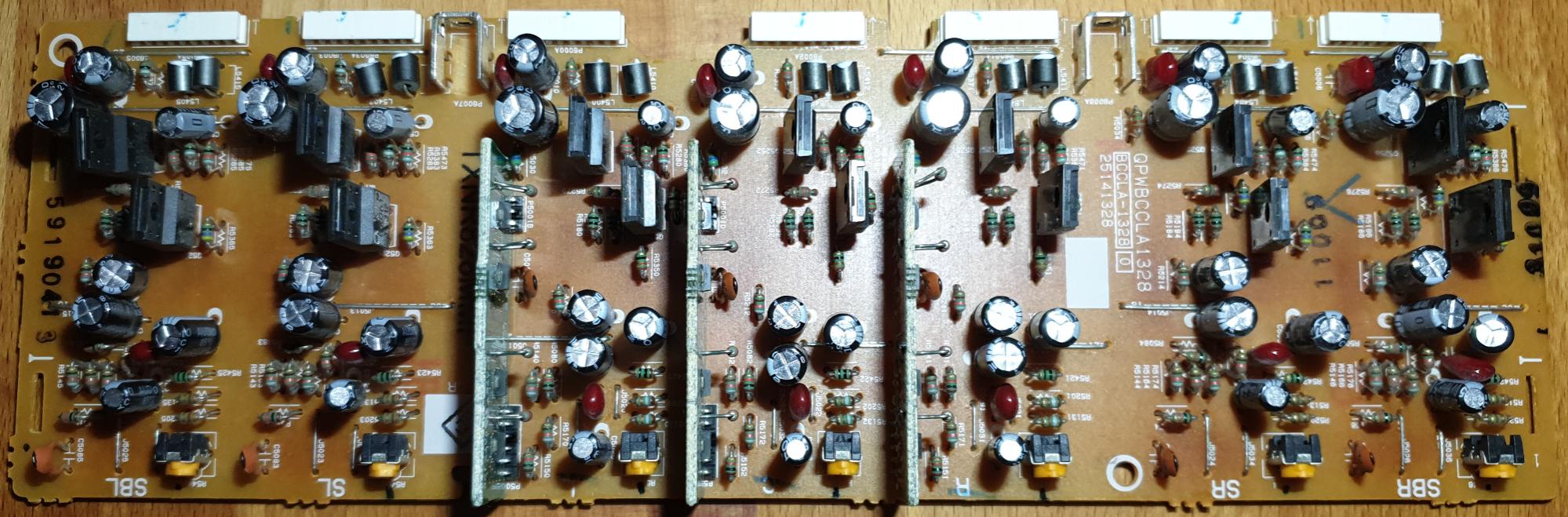

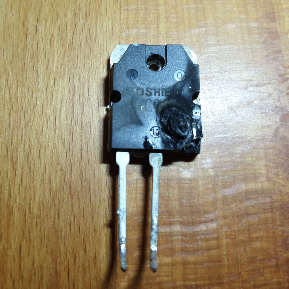

    Runs all the years without problems, day on day off. Then all of a sudden with a bang and a small flash one of the final transistors burned out. This is the left front channel. Since the original Toshiba were no longer available, I replaced them all with the equivalent:
    Toshiba TTA0001 => 2SC1962
    Toshiba TTC0001 => 2SC5242
    This also included replacing the thermal paste and the very own insulators with pads (1.3W/mk).
    After I now put everything back together and wanted to do a first test, it turned out that the heatsink on the left side (Channels : SBL - SL - L - C - R - SR - SBR ) quickly became very warm. So it is obvious that the burnt transistor was only the result of another original problem. This is the point where I would like to ask you for help. Unfortunately my knowledge is limited / and also a little rusty. Every hint for troubleshooting is welcome.

    Re: Onkyo TX-NR828 - Repair assistance wanted
    you selected both npn replacements when one is npn and the other pnp .. ttc npn tta pnp .
    you should be checking the bias circuit and driver transistors and the power supply .
      Sorry, I made a typo when writing down the types. Of course, the correct ones are installed:
      Toshiba TTA0001 => 2SA1962OTU-ND
      Toshiba TTC0001 => 2SC5242OTU-ND

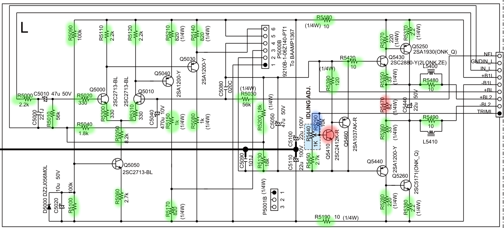

      Without really having a concrete idea, I have already started to measure the left channel. Currently Q5410 and R5470 are striking and show too high values / results. Am I on the right track with this?

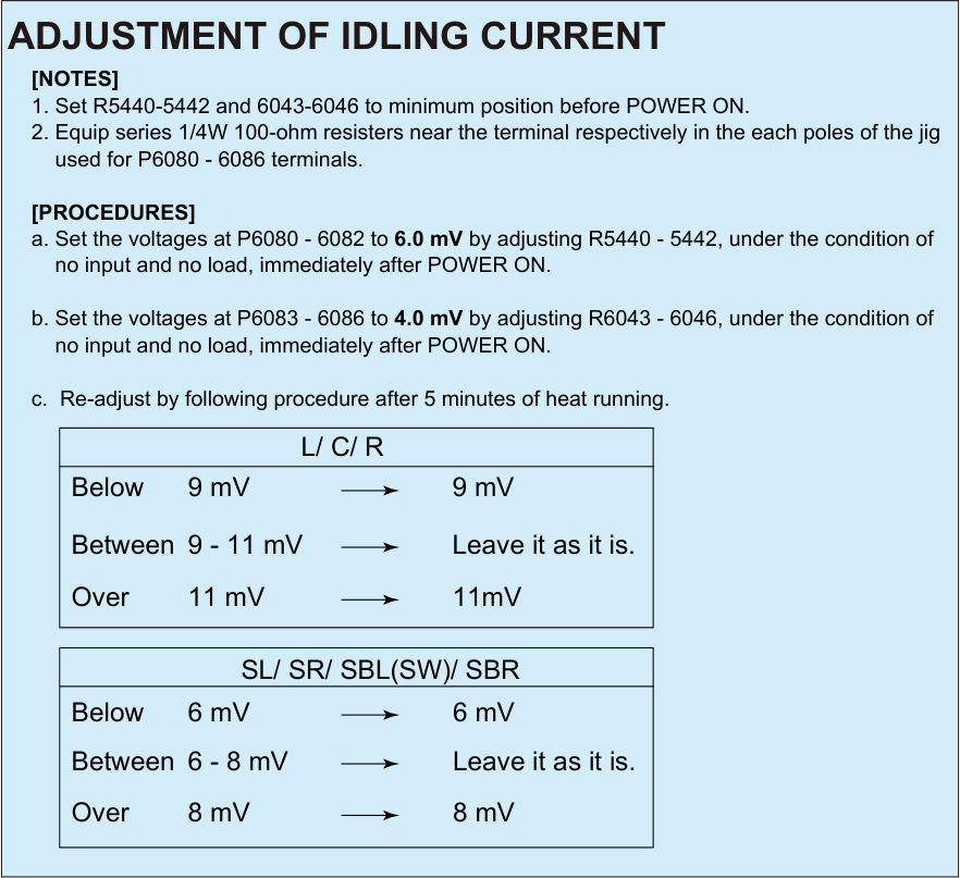

        yes check everything including the bias adjust pot which should be turned to zero after replacing anything then adjusted to correct idle current after repairs . .
          Thanks for now, I will then measure further tomorrow (it's already late). Can you deduce what could have caused it? The procedure for setting the idle current is described in the service manual as in the attachment. If I understood correctly, I should set/measure in series to a 100 Ω resistor the mentioned voltages at the mentioned time. The measuring points for e.g. the left and right channel are shown in the circuit diagram above.
            This is the current status of my measurements. The two marked in red are the ones that need to be replaced. Now I looked on Digikey but found replacements with different values for the transistor.
            2SC2412 (a) https://www.digikey.com/en/products/...2KT146R/650455
            2SC2412 (b) https://www.digikey.com/en/products/...2KT146Q/650454
            The difference here is "DC Current Gain" with once 120 at 1mA, 6V and once with 180 at 1mA, 6V. Which one should I prefer?
            Would it also make sense to replace the 2SA1037 (Q5460) at the same time?
              https://cdn.badcaps-static.com/pdfs/...bb9809e8c3.pdf
              looks like you want R gain
                      When I work on an Onkyo receiver, I check all the parts on that channel, before and after the repair. I compare measurements to another channel, just to be sure.
                      When you turn it on after the repair, with the 100 ohm resistors connected, make sure that the measured value does not increase to fast. If it does, that means that there is still something wrong. Turn it off right away.
                            measure voltage across each 2,2 ohm emitter resistor then work out the current using ohms law .

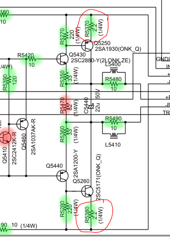

                              @petehall347
                              I may have missed something, but what 2.2 ohm resistors are you talking about? Do you mean the 0.22 ohm ceramic resistors?

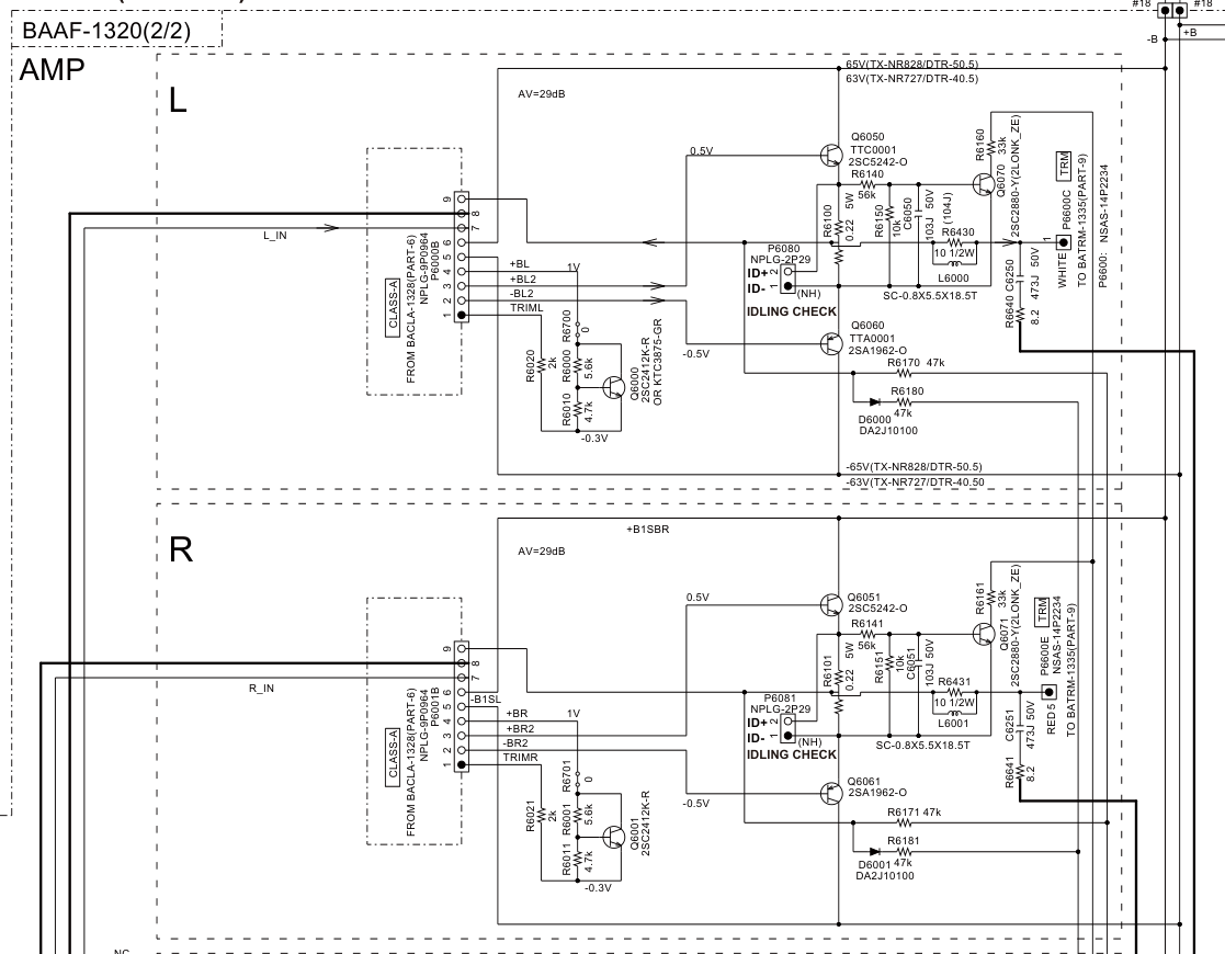

                                Originally posted by roman-hartwig
                                @petehall347
                                If the circuit you posted is correct, then we are talking about these resistors.
                                  You're right, I overlooked them. Thanks! But since they are marked green, I have measured them as intact. Don't get around to it today and won't tomorrow either. So on Sunday I will measure the voltage drop and then calculate the current. But what can I deduce from that? Whether they are running within their specification, or is the set point of the current known?
                                    I have now measured the resistors and their voltage drop and calculated the resulting current. For comparison, I measured the right channel.
                                    The results are as follows:
                                    Left Channel:
                                    R5370:
                                    R = 2.3 Ohm
                                    U = 25,7 mV
                                    I = 11.17 mA
                                    R5380:
                                    R = 2.4 Ohm
                                    U = 25.6 mV
                                    I = 10.66 mA
                                    Right Channel:
                                    R5371:
                                    R = 2.3 Ohm
                                    U = 26.6 mV
                                    I = 11.56 mA
                                    R5381:
                                    R = 1.8 Ohm
                                    U = 20.7 mV
                                    I = 11.50 mA
                                    • petehall347
                                      • Jan 2015
                                      • 4451
                                      • United Kingdom
                                      they are looking much the same so shouldn't be any hotter so long as they are thermally connected to the heatsink
