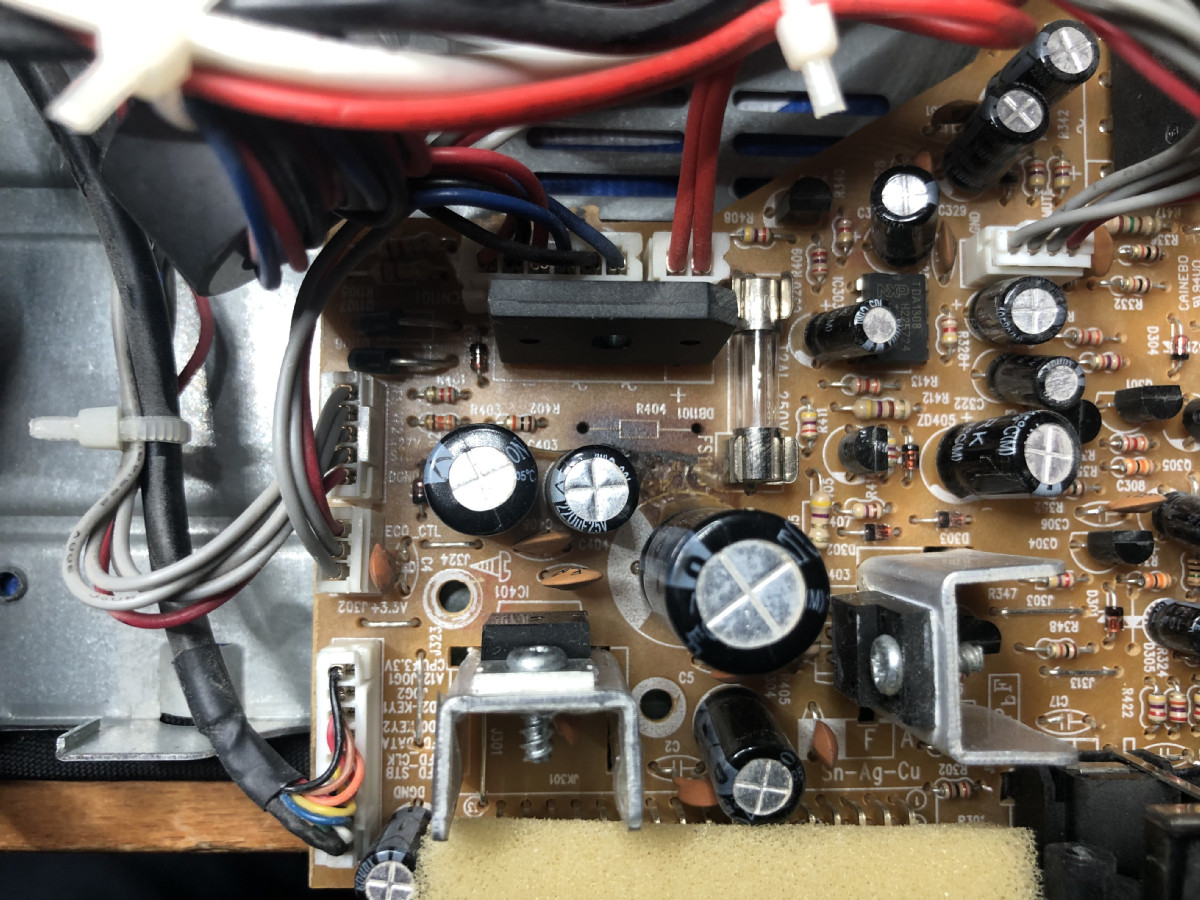

    I own a very cheap TCM 240020 mini stereo system. This one is for my children in there room. Yesterday the magic smoke came out...

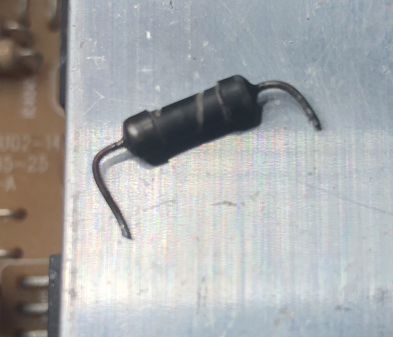

    I dissembled the broken device and found a burned resistor next to a ac/dc regulator (i don't know the correct English word for it).
    The resistor is infinite.
    See the pictures. Now the question is, what value could it have had?
    I could not find any circuit diagram from this device. The board has 248-T80U02-147 printed on it.
    And yes... it is Resistor 404.

    Without schematic not easy but we can help with a good guess if you start drawing the schematic on that part of the circuit. Where in circuit is the resistor, if it is feeding a regulator , what regulator is it and maybe plug it in and measure voltage on the empty pads. Also from the rating plate of the device you can see max current which can help calculate the value of resistor if that is inline with main power source. Help us to help you.....

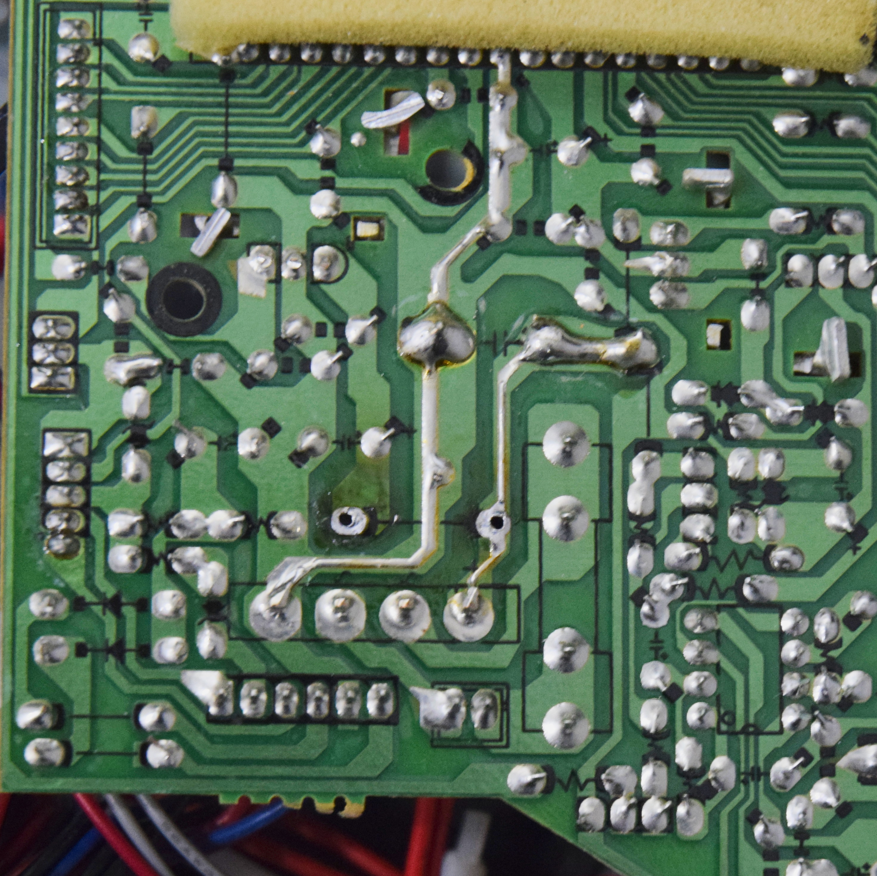

      You need to post a clear, in focus picture of the trace side of the board so we can see where the resistor is connected. post the highest resolution you can.
      It may just be a low value fuse resistor feeding a regulator ic, it looks like it was running hot for a while.
      DB1101 with the [-~~+] is the bridge rectifier

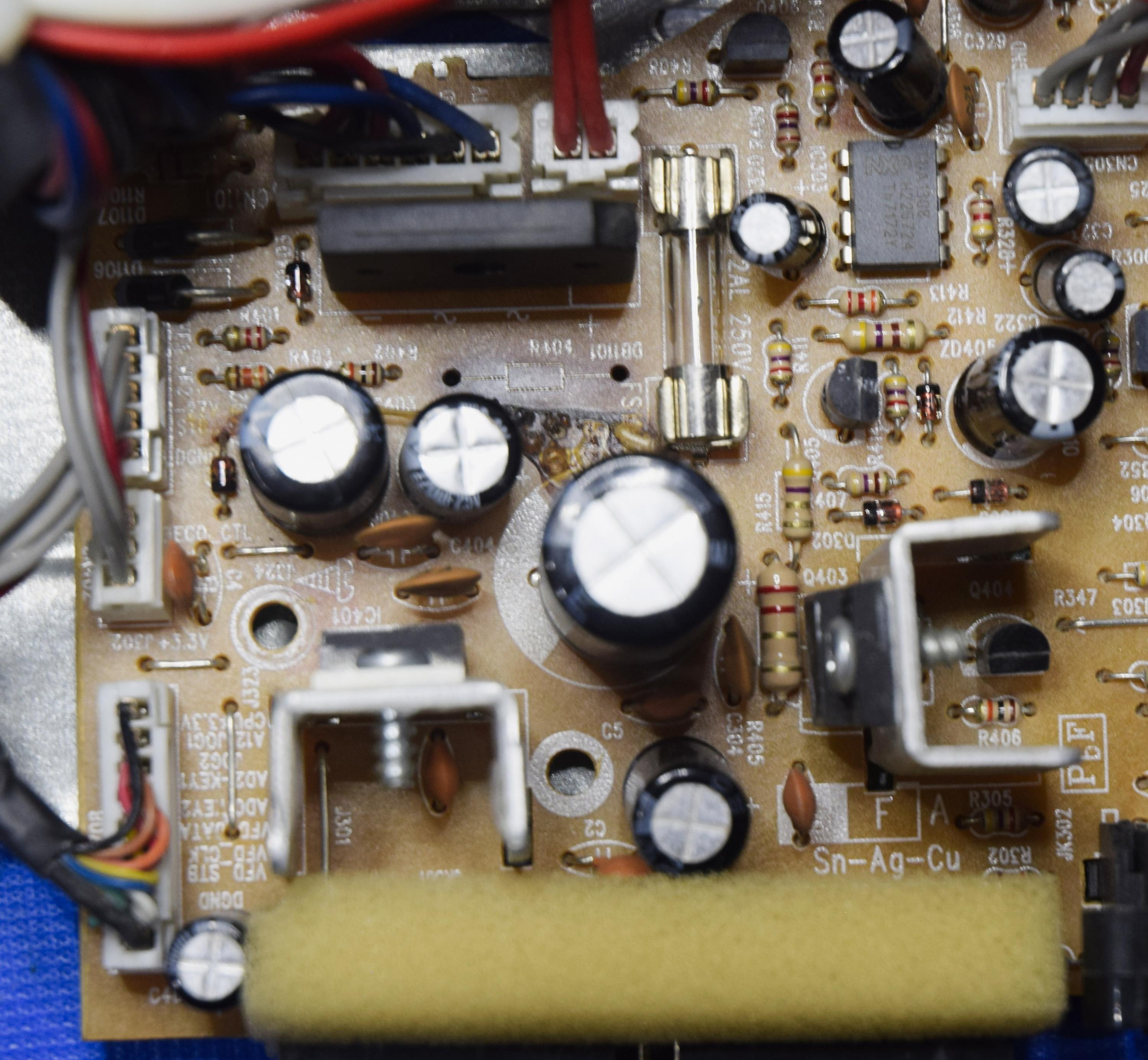

        Here are two pictures.
        The burned resistor is just behind the positive side of the bridge rectifier. In Germany it is called Gleichrichter.
        There goes 14V in, at least that is printed on the circuidboard near the 2 big red wires.

          Did you test the bridge rectifier ? , can you identify its name ?
          The burnt resistor is in the rail of Ic 401 . Can you identify Ic 401 name ?

            On the bridge rectifier ist written " GBU 8D AC"
            The burned resitor goes to the IC401 indeed. To the right leg. The middle leg is goin to the negative of the bridge rectifier.

                    BOO... poor design. The resistor is indeed a low value resistor that was meant to "protect" IC401, the 7805, due to voltage on the output of the bridge rectifier.
                    What is the voltage across the + and - terminals of the bridge rectifier, is it that 14VDC?
                    TBH if you can put a larger heatsink on IC401, any low value resistor would be fine there. Based on the size of the heatsink and assumption that 14V is correct, I'd guess a 1W 4.7R or perhaps 0.5W 2.2R resistor was its original size/value and it died. I'd start with that, measure the current with a 4.7R there and then perhaps choose another resistor for longer life. Do you have any random spare resistors around this value to make measurements?

                      Any value between 1 and 10 Ohms is fine , but should be marked with a fifth white band as it's a protection mainly .. I already calculated its value , and I suggest 5.6 ohms .
                      But he didn't reply yet , and since it could be that neither bridge or regulator are the original problem , and I need an affirmation , otherwise the resistor will burn again .

                              The heat the resistor generates is heat the 7805 doesn't heat up. So that's the tradeoff here. BTW this resistor does not need to be a fusable type as this is a low power circuit, but it needs to be sized appropriately to last!
                              If you have 3 pcs of 15Ω Â½W resistors, connect them in parallel, that would be acceptable. What is in your arsenal?
                              I don't know how big of a heatsink is on your 7805 but the bigger it is, the smaller (in ohms) resistor is needed for the ballast. The smaller the resistor (in ohms) the power rating can be lower as the 7805 would take the heat instead...

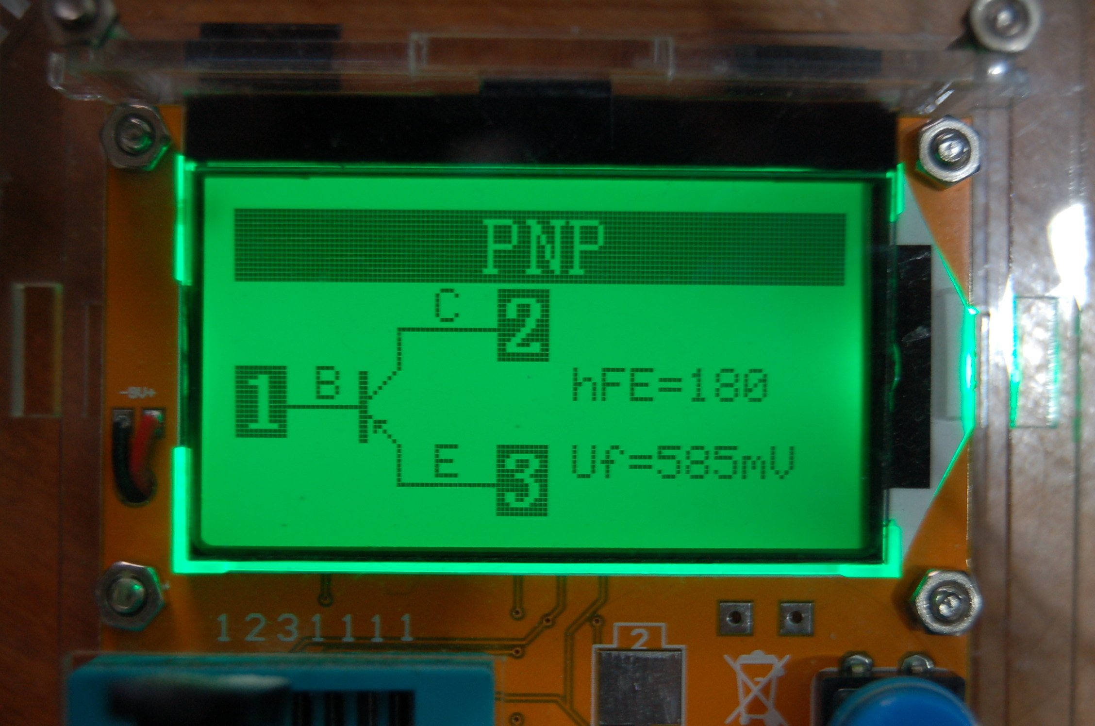

                                  The Q403 is a B1185 http://www.datasheetcafe.com/b1185-d...et-transistor/
                                  Do i test that the same way?
                                  The big capacitor still has his value of 3300uF I measured 3356uF

                                    Test the b1185 , like 2 diodes , on mode test , and it's a PNP Power Transistor.

                                      I just removed the B1185 and put it into my testing device.
