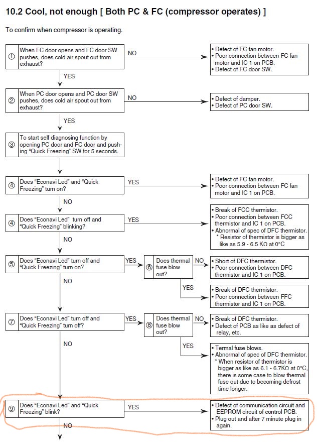

    I am actually quite uncertain about the Self Diagnostics instructions - seems to be a translation from Japanese to English, and some texts are quite unclear..
    Here's the summary of the Self Diagnostics done:
    1) Page7 - In process Inspection
    - after 1 minute: Illuminance Sensor LED is On, indicating BAD
    - after 30 minutes: All Freezer Control LEDs blinking - indicating BAD
    ** no description of what is BAD...
    2) Page 11 - SELF DIAGNOSING FUNCTION
    - based on the initial blinks (before they go off): PCD is BAD
    3) Page 15 - Not cool at all [ Both PC & FC (compressor does not operate) ]
    • Defect of control PCB.
    • Communication error between IC1 & IC201
    4) Page 16 - Cool, not enough [ Both PC & FC (compressor operates) ]
    • Defect of communication circuit and EEPROM circuit of control PCB.
    • Plug out and after 7 minute plug in again.
    Same outcomes in repeated tests. If these tests are done correctly, and the outcomes interpreted correctly - all seems to point to PCB Board faulty. Or possibly some setting is locked permanently like "compressor lock", or "defrost on", etc...

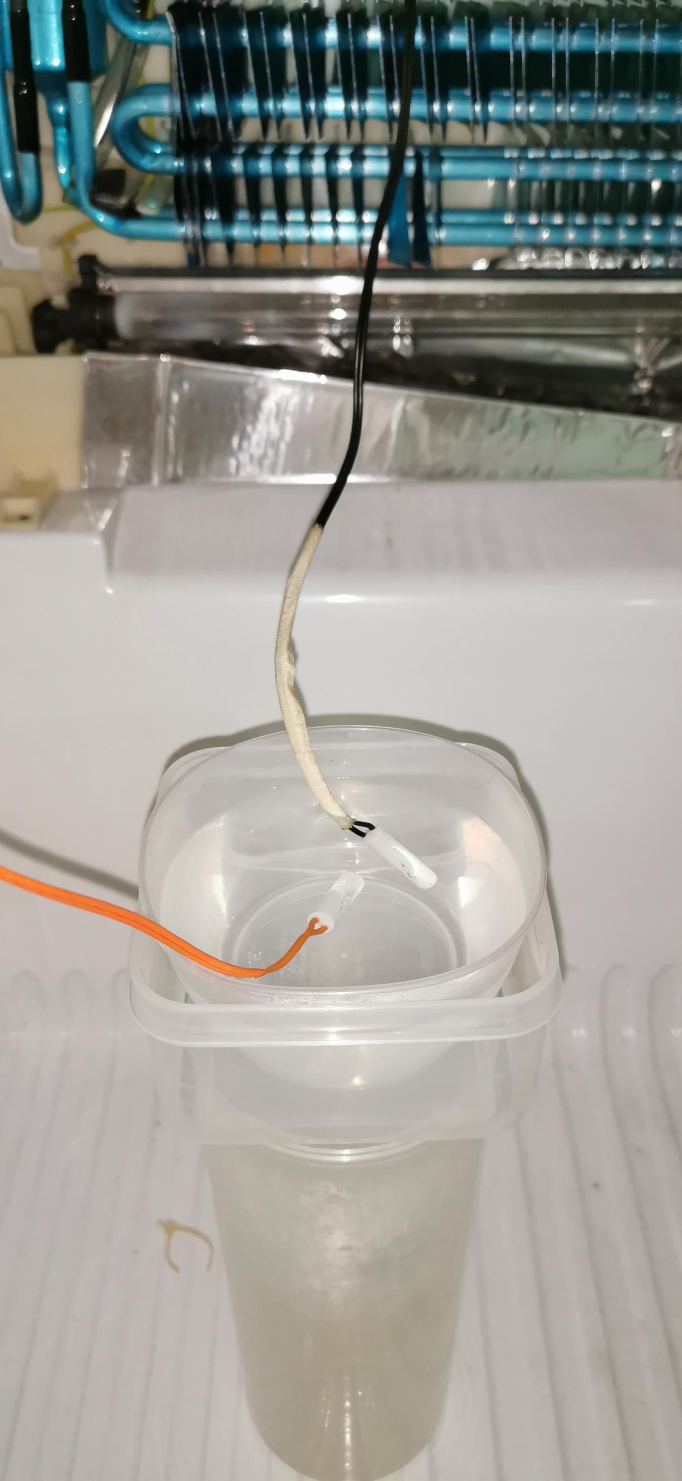

        There is absolutely no frosting anywhere around the evaporator coil.. I don't think the refrigerant inside the coil is cool enough to form frost/ice. Touching the coil can feel the gurgling liquid flowing, but no sense of coldness at all.
        After power up for a few minutes, I place both defrost and freezer sensors in a cup of semi-hot water (around 50degC I guessed), but cannot really tell if the compressor is running at full speed or not.
        After 10-15 minutes, no observable difference in term of coldness in both compartments.
        How long does a normal fully working fridge takes to start feeling coldness if you place your hands in the freezer compartment?

          That what I thought ( “gurgling liquid flowing” ) I being to think that either the compressor ( will not run at full speed )[Controller issues] or [ compressor pumping issues ]
          OR
          You have a restriction in filter dryer ( OR ) cap-tube
          OR
          You have a gas leak
          This is where you would need a set service gauges and a specific type of amp probe to figure out what going on with this system
            It should only take few minutes for the coil to start getting cold where the cap-tube is and the coil meet together
            When hear the liquid flowing like this is not a good sign and not getting cold
            There is not much refrigerant in theses units so if have a leak or a restriction it does not take it long for it not work
