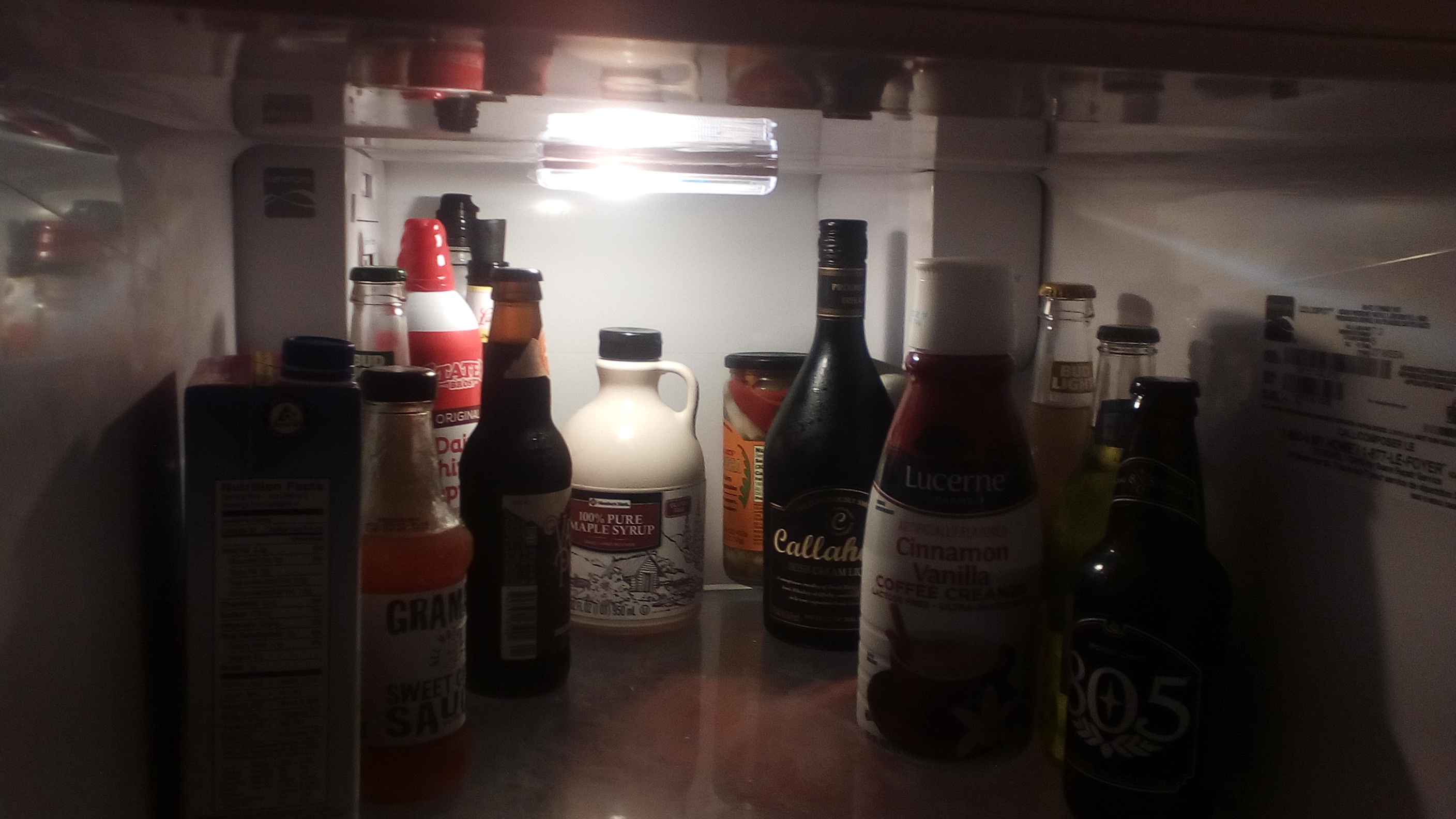

          #44
          Re: Whirlpool Refrigerator LED lights flickering
          Here is a pic for reference... I would say it's brighter than the pic shows as maybe the light shut the camera down a tad looking direct into it.

            #45
            Congrats on finding a solution. The G9's are much more powerful but I thought small enough to fit. Ikea has some small LED's too and eBay has lamp sockets.

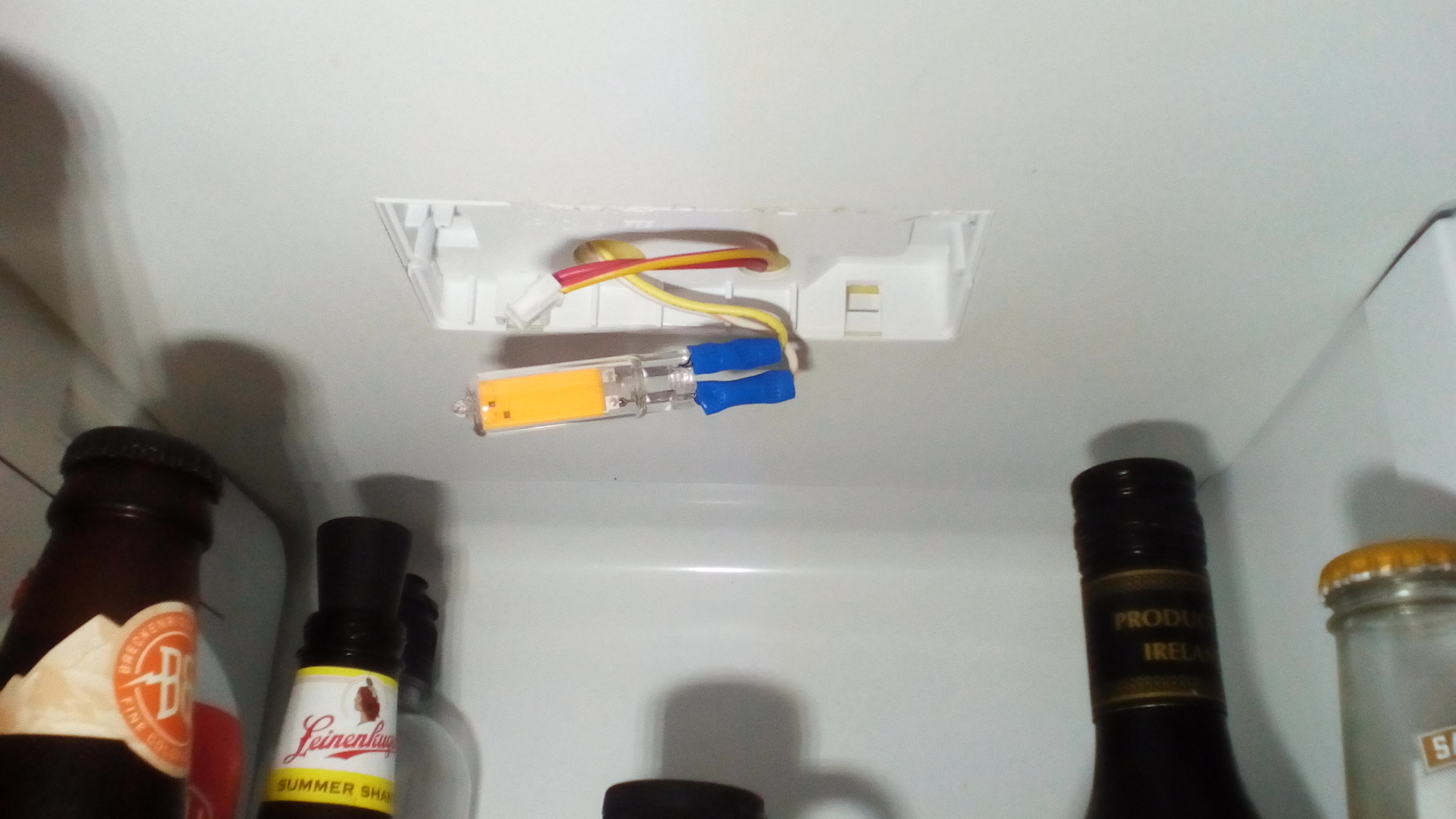

                    #49
                    Dave
                    Let's see, the devil is in the details. I didn't try that style, I used what is called a Butt Connector which is still a Solderless Connector. If you have a Harbor Freight near the assortment pack is really cheap.
                    Things to think about,,, I only connected the top light so far and MY plan is to redo the connector anyway but I don't have the next two bulbs yet.
                    The connectors are color coded for wire size range, the proper color for the Refer wire would be the Red connector 16-22 Pretty sure the refer wire is 18Ga. ah, but the Red connector won't fit over the bulb wire, so I used the Blue Connector, 16-14GA and I lightly squeezed one side to OVAL that end a bit so it would go over the Bulb Wire,then crimped it hard.
                    With the Butt Connector I also trimmed back the end only for the Bulb side so it would slide further onto the bulb, just the Blue Plastic flush with the metal.
                    I choose to crimp both sides on the bulb first and spend less time in the refer crimping with the door open.
                    Now the style you posted the Female stake on, I don't have a bulb to test fit ( I do have that style, Red and Blue) could probably made to work. The metal is very soft and can be bent easily to reshape it bit if you had to. You might have to open it up a bit first, I don't know without trying it. But, If I used that style I would still attach to the bulb first and maybe get some electrical tape around the connector or heat shrink tube as they would be exposed.
                    When I cut off the Refer Plug, that is the wider one I left about a 1/2" of wire in case this didn't work I could crimp it back on. **** I taped the Door Light Switch Closed *** better bet would be to unplug the Refer **** your call.
                    • Log_on_Bob
                      • Aug 2019
                      • 26
                      #50
                      Hey Dave
                      Thought I would post a pic of just the top light so far.

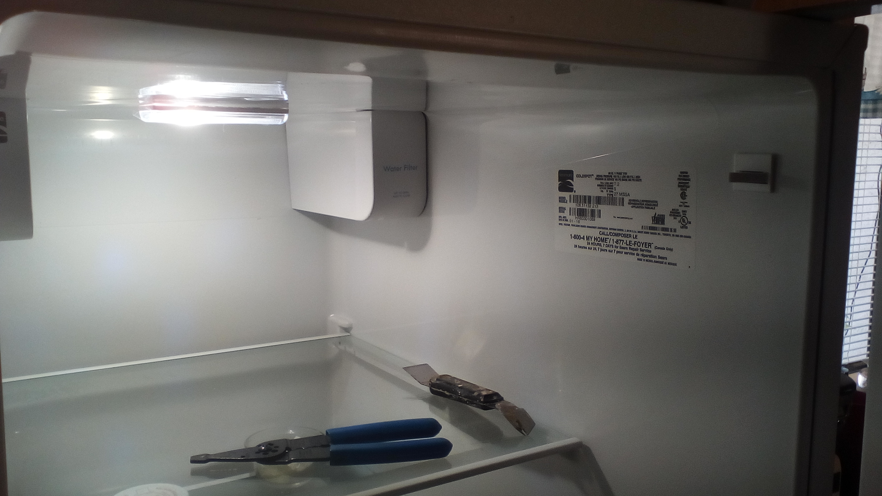

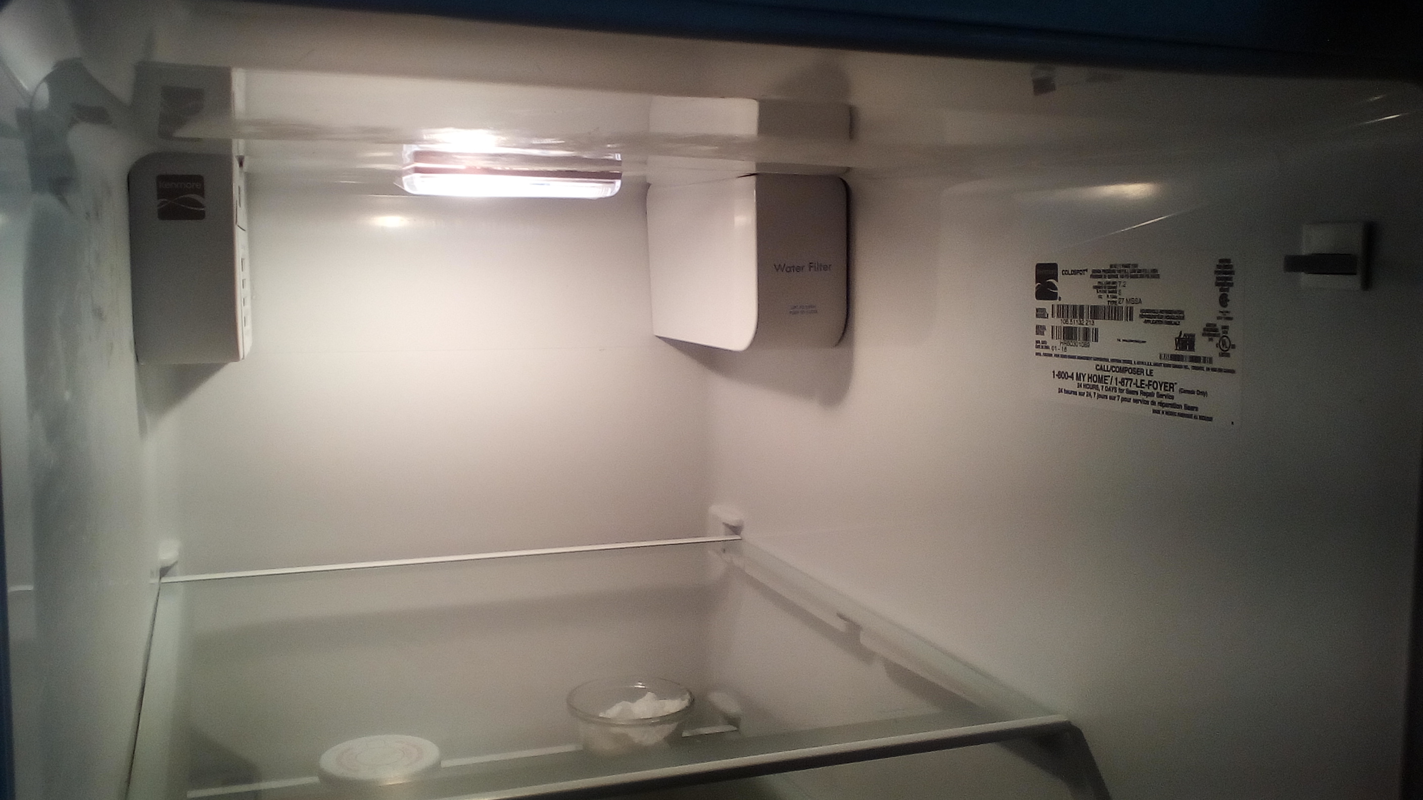

                                  • Log_on_Bob
                                    • Aug 2019
                                    • 26
                                    #57
                                    Two new pics same time of the day, 35W 3000K and the new 40W 5000K
