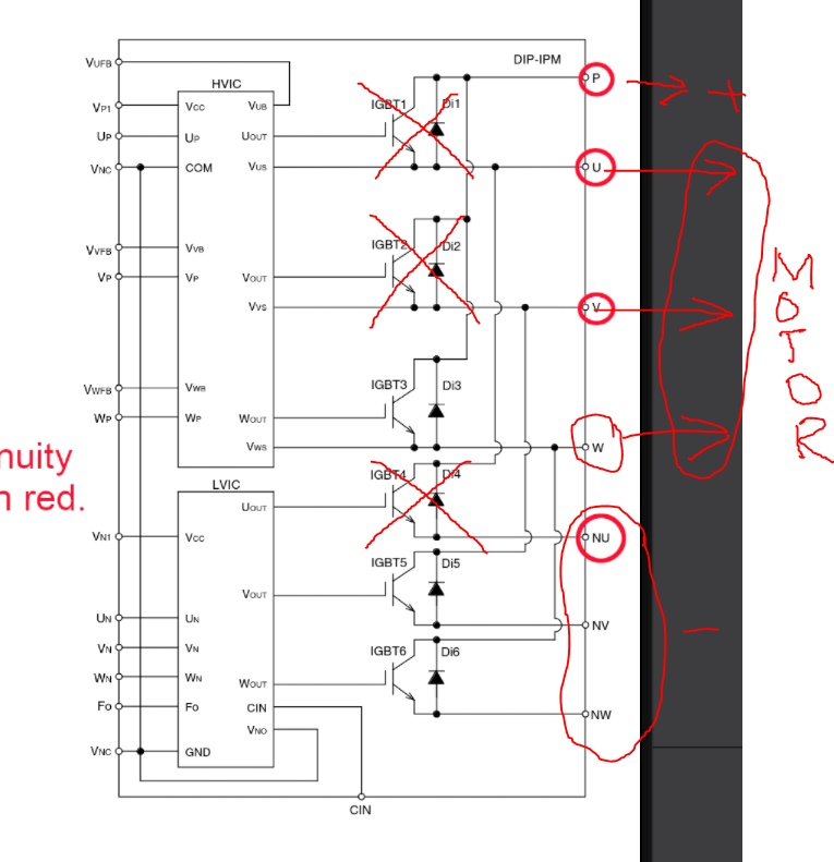

    Your module is faulty, it has three phases for powering the motor and two of its phases are broken, there is a short circuit on three IGBT transistors.

      Ok, thanks for the answer!
      I'll try to reconnect the washing machine without the motor driver to see if the machine turns on.

        I did a few tests earlier, put everything back in place (TOP246 and other components removed for testing) then plugged everything back in.
        Result: Nothing happens when I press the button on the machine (although I'm not really sure, perhaps a relay has been activated).
        In a nutshell:
        The initial problem was that the power resistor linked to the ignition burned immediately when the Power button was pressed.
        After removing the motor driver, it turned out to be short-circuited.
        I repeated the test without the driver fitted, and nothing happened.
        Maybe the TOP246 didn't really appreciate it and should be changed.
        What can you deduce from this?
        Thanks for your advice.

          Small update, I finally received the Mutsibishi PS21964-4S motor driver and proceeded with the change, I also changed the TOP246YN.
          A few solderings later, I reconnected the whole thing: it worked again, great joy, but after 24h of operation, the machine stopped during the end of a cycle (I suppose spinning/drying).
          After dismantling, the TOP246YN literally exploded.
          When I reassembled the TOP246, as I no longer had a thermal tab, I used a double thermal face for the connection between the TOP and the radiator, perhaps this was a bad idea.
          I've read the feedback about replacing the TOP246 with a TOP248 (with resistor in series), so I'm going to try that as well as using good thermal paste.​
