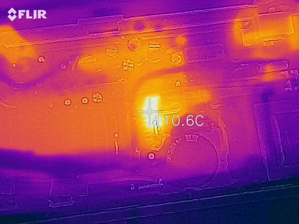

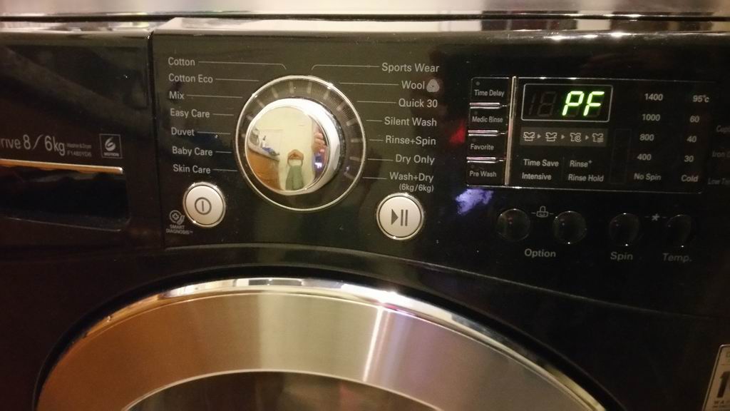

    We have a 6-yr old LG combo washer dryer model 1480YDS that has started to cut out part way through the drying cycle. This has now become a highly repeatable failure giving me a chance to diagnose the problem. On restarting the machine (after an imposed wait of a minute or two) the display would show PF (power fail error) indicating an unexpected removal of power part-way through a programme.
    Searching around the internet this fault seems to be fairly common to a wide range of similar LG washer dryers and because the only solution people were finding was to replace the entire control board for around £130, I decided to work out what sub component was failing.
    I wondered initially if it might me a glitchy relay or something else relating to the drying phase causing the microcontroller to crash out because the machine would happily do a full wash lasting over an hour, but would always stop after 5 minutes or so of tumble drying. Equally it might have been the increased heat of clothes drying - but disconnecting the heater element (both cooling things down and removing a big switching current) made no difference to the time it took to cut out.
    I figured that if programmed machine logic was involved it would report a more specific error so the PF error is indicative of an unexpected power down. This got me thinking about the power supply itself. Sure enough, a thermal camera image of the control board in action revealed one very hot TOP242 IC. The shot here shows it still working at 110C but it will go past 130C whereabouts the built-in thermal shutdown trips. Bingo!

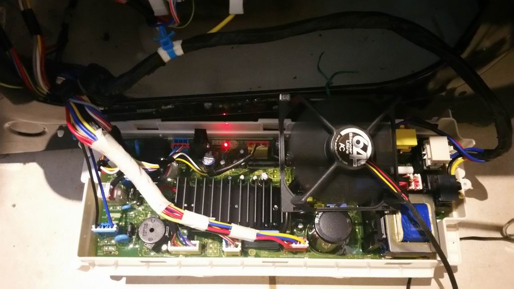

    The TOPSwitch datasheet confirms the trip-point to be 130C to 150C and a ghetto-rigged fan proves the point finally keeping the machine going all the way through a 1 hour + drying cycle with the TOPSwitch staying under 50C.
    Tempted as I am to bore a hole in the control box lid and mount the fan there full-time, it's obviously not fixing the problem at source. I think the most likely reason for the TOPSwitch to overheat would be the 330uF 400V input reservoir capacitor ageing. All the capacitors are suspect of course so the next step is to try and remove/test/replace as necessary. Unfortunately the PCB is flooded in the case with a clear potting compound that I'm not looking forward to tearing out. Will try and keep this posted.

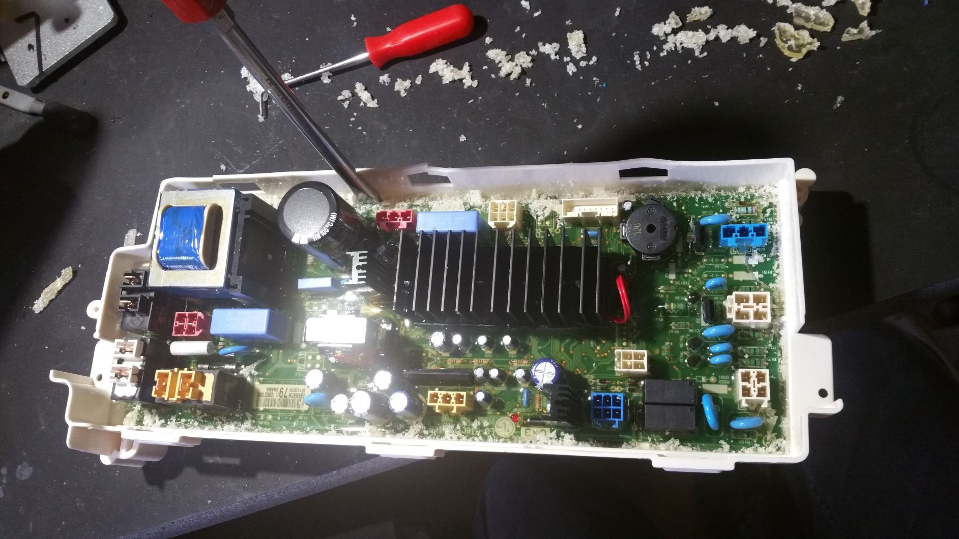

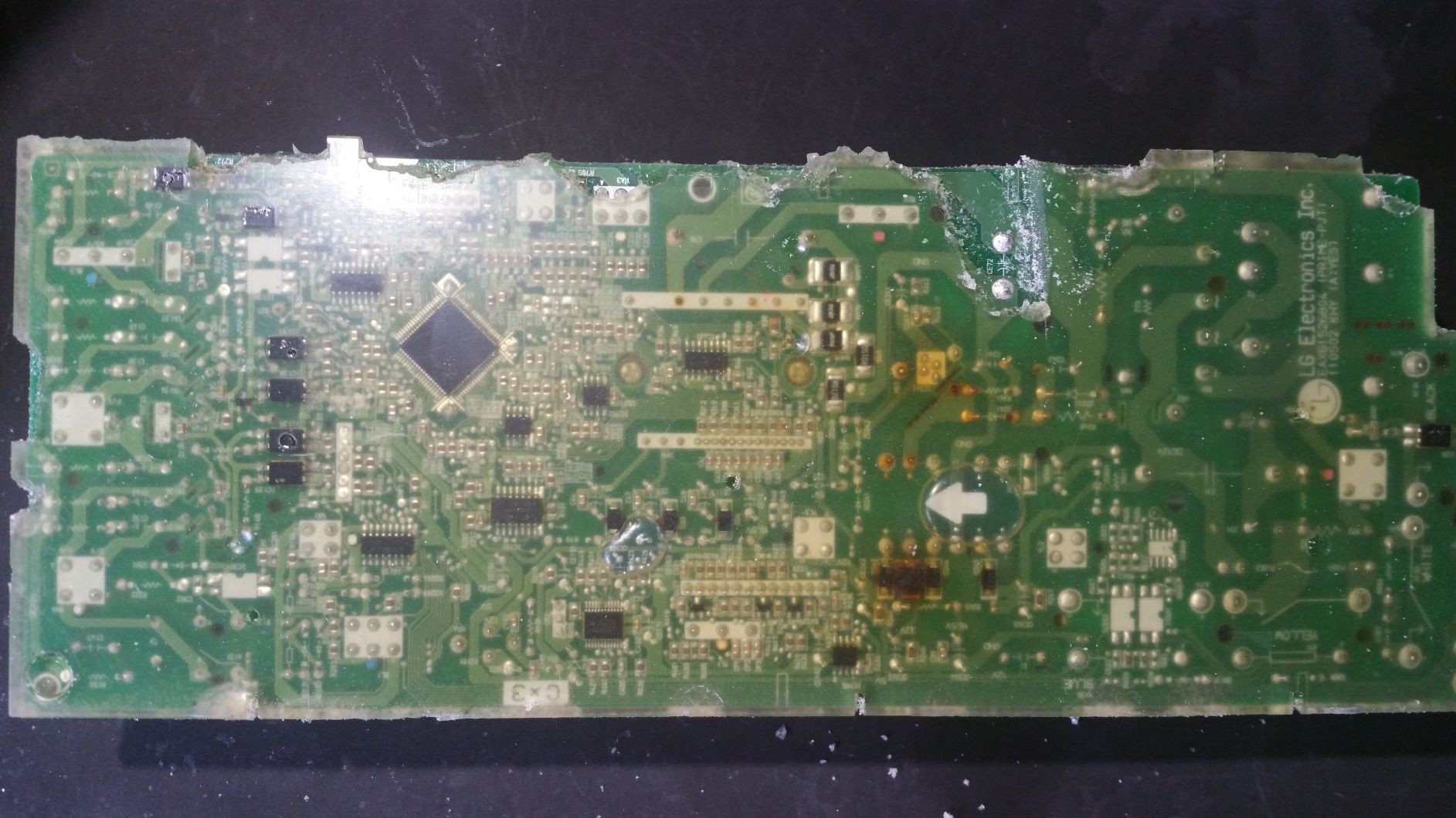

            Thanks everyone. I ended up prising the board out after running a knife around the edges.
            The potting compound is very soft and not too bad to scrape off to get to the component pads. I started with the 330uF input cap but this actually metered-up OK @ 322uF 0.28 Ohm.
            I've since exposed all the parts in the PSU area and none of the caps are out of spec. Sure I can re-cap them all but some have lower ESR than the new ones I'd be replacing them with so I think its a red herring. All the bigger O/P filter caps are good low ESR types. The only exception is the 47uF start-up cap that momaka and stj mention. This one reads 40uF 1.2 Ohm which isn't exceptionally bad I don't think, but I will see if I can find a better one.
            Notice though that there are some browned areas notably above the SM diode that's rectifying the 22V feed that ultimately powers the dryer fan. The TOPswitch output transformer also has two 12V outs, one of which feeds the logic stuff via a 7805 and another isolated tap that seems to be referenced to the HT for something or other. I think the 16.5V may be for the IGBT driver for the drum motor.
            These supplies are all fine when loaded by the washer cycle alone. But as soon as the drying cycle is engaged the 22V supply comes into play and this is what ramps up the heat in the TOPswitch. The dryer fan is by far the biggest load supplied by the regulator. I guess it could be a problem with the fan? It runs OK and, as I said before, if I blow air over the TOPswitch it settles down to a sensible temperature and will run all day like that. I'm mighty puzzled now.

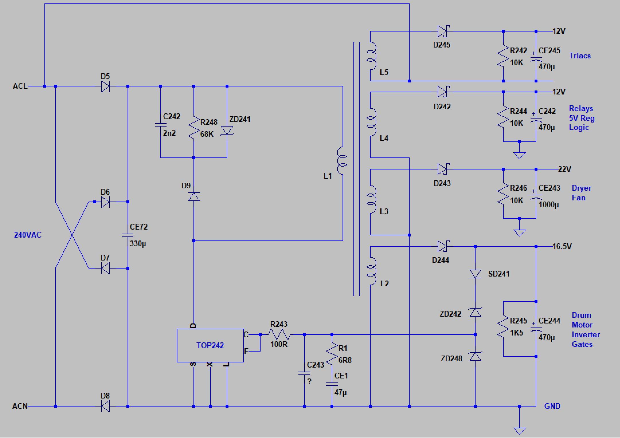

                            So this thing turns out to be "hot" everywhere. I traced out the front-end and AC Line voltage is but a diode-drop away from the so-called GND bus. GND isn't actually tied to chassis but it makes it hard/risky to work on.
                            My line isolating xformer probably won't handle the power of this thing so I'm going to have a tough time powering the 22v circuit independently or checking the ripple with a scope.
                            The TOPswitch is configured for half-frequency operation (F connected to C) and Line-sense and External Current Limit Features Disabled ( L & X grounded). It's also a bit weird around the flyback snubber and output control sensing areas. Do we still think a TOP243/244 would drop in here?

                              Re: LG Washer/Dryer Power Fail
                              Assuming the very hot IC is the problem, and not a side effect due to low line voltage or a bad electrolytic capacitor CE72, CE244, CE242 etc. I would say the IC needs cooling from extra PCB copper, or a heat sink/bigger package. The conformal coating over it acts as an insulator. A stressed/aged IC can have higher on-resistance and shifted current-limit so it cooks itself.
                              You can try add a heat sink or replace the TOP242. I would put in a TOP243 and extra resistor, to get 1/2 the heat.
                              With the "X" pin is connected to the source, then the part operates at max. current limit.
                              TOP242 is 0.45A and a TOP243 is 0.75A so going to the TOP243 it's best to add a resistor at X-pin to prevent the transformer from saturating. From Fig. 54b a 13k resistor from "X" to "S" will keep the same old 0.45A current-limit as a minimum. But the bigger part runs cooler with 1/2 the on-resistance.
                              Wait - the "X" pin is not brought out on the DIP-8 or SMT-8 package part, so this idea wouldn't work for that. Unless this the TO-220-7 packaged part TOP242Y ?

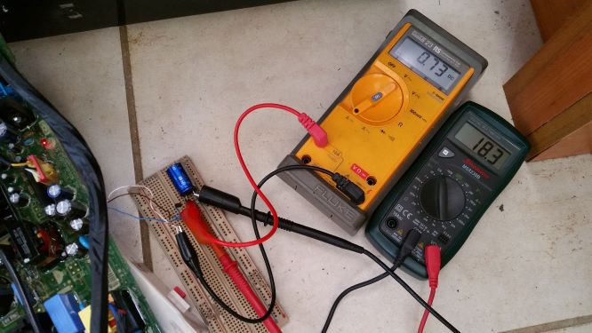

                                  Here's my test of the fan motor power. I pulled D423 off the board and jumpered it onto a breadboard with a separate 1000U cap to GND. From here I measured the current at 0.73A and volts at 18.3V so the fan motor alone takes 13.5 Watts. Resistance in all the dangling wires probably means more like 15 Watts when the diode is back on the PCB.
                                  Plugging the machine into a power meter adapter shows 25W going in during this test and at idle it's 8W all of which can only be supplied via the TOPswitch. So a delta load of 13.5W shows up as 17W at the input so the convertor efficiency is as expected at around 80%
                                  This makes the output power around 20 Watts if the input power is 25 Watts so I think however you look at it the TOP242 Y is being pushed too hard. It looks like redwire's suggestion of substituting a TOP244 is going to be the way forward, and as it's a T0-220 I can series-in a resistor with the X connection to stay with the original transformer design parameters.

                                    Sure looks like the PSU isn't able to supply power as it should. Forced obsoleteness, I say. If it were mine, I'd recap the thing and get a top242 and a top243 and see what happens with a new top242 in place. I also think that the current top242 may have cooked itself so many times, that its characteristics changed a bit. Probably the top243 is the answer at the end, but I'd be curious if a new top242 would run this thing again like it was before.

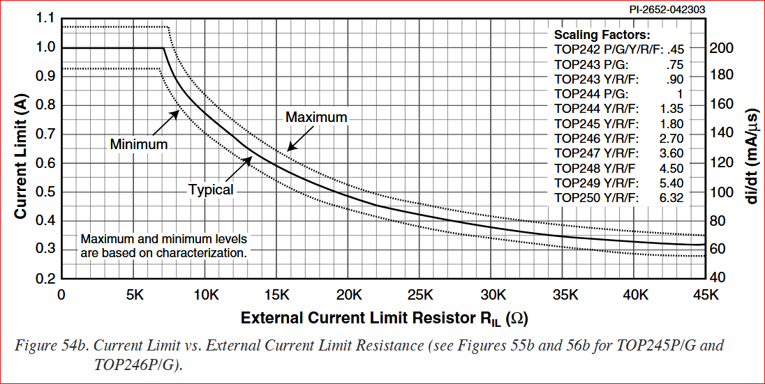

                                      I can get a TOP244 here by tomorrow and the laundry is piling up ;-)
                                      @redwire, looking at Figure 54b the scaling factor is 0.45 for TOP242 so with X at zero Ohms the transformer primary is current limited to 0.45A.
                                      To get the same limit for a TOP244 with a scaling factor of 1.35, am I right in looking along the Y axis for 0.45A/1.35 = 0.333A which seems to be around 39K?

                                        Wow. 13.5W on a part designed for 15W.... that's really pushing things too close. No surprise it's failed after a few years. Perhaps if the PCB was designed with more heatsinking, the TOP242 might have lasted a little longer (or a lot more).
                                        I agree with the others that a TOP243/244 is probably the best route to go. But nevertheless, I still think it would be a good idea to attach a large aluminum heatsink/heatsink on top of the new chip. PCB cooling could still be marginal, even if the new TOP243/244 chip has lower dissipation.
