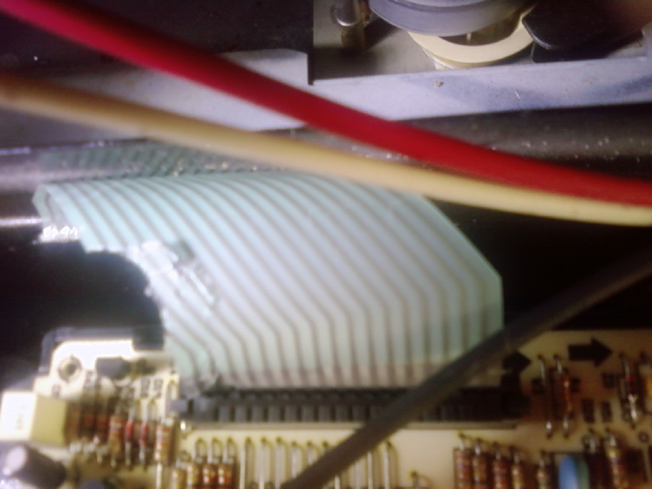

      After fixing the control board for 23 cents plus shipping everything worked fine. Then a day later the cooling fan and light came on and stayed on. I found the problem to be a short caused by the factory fold in the ribbon cable connected to the same board.
      Quick test to verify:
      turn off the power at the breaker
      drop the front panel
      remove screws that hold board and retainer in place
      turn on the power
      tilt the board upward and back
      at some point the fan should go off (you may need to bend the cable straight a little)
      Quick fix:
      cut a strip of packing tape about 4" long and slide it behind the ribbon and around the front so that the ribbon curls into the connector on the board like it should.
      I don't know how long the fix works for but I'll be keeping my eye on it.

          Thanks for your experiences on this dr. hook. The flex-cable on the timer board isn't all that great and it is easy to push it in off center. I've heard a number of reports of the same symptom happening after the clock display has been fixed. Assuming the connector at the timer board is ok, the "cooling fan runs all the time" symptom is unrelated and so far all the details are still a mystery. The only thing that is known is that the main controller board fixes that problem. Some people just disconnect the cooling fan and leave it like that. But the fan does keep the timer board from roasting. I still don't like the idea of combining microprocessors and ovens, but that's progress for you.

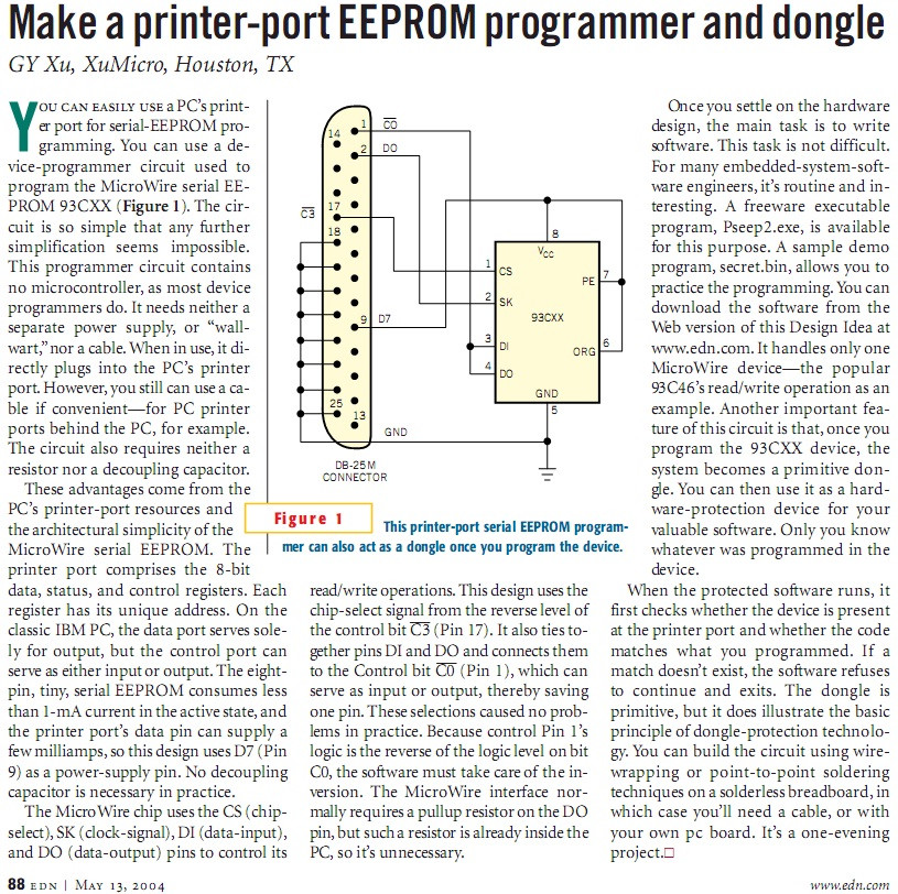

                        If you have a PC with a parallel port, an EEPROM programmer can be nothing more than a few wires.
                        (If I were making one I'd probably separate the input and ouput pins though, just like it says in the datasheet.)

                            24Cxx is I2C which needs a few more parts, but it's still pretty simple.

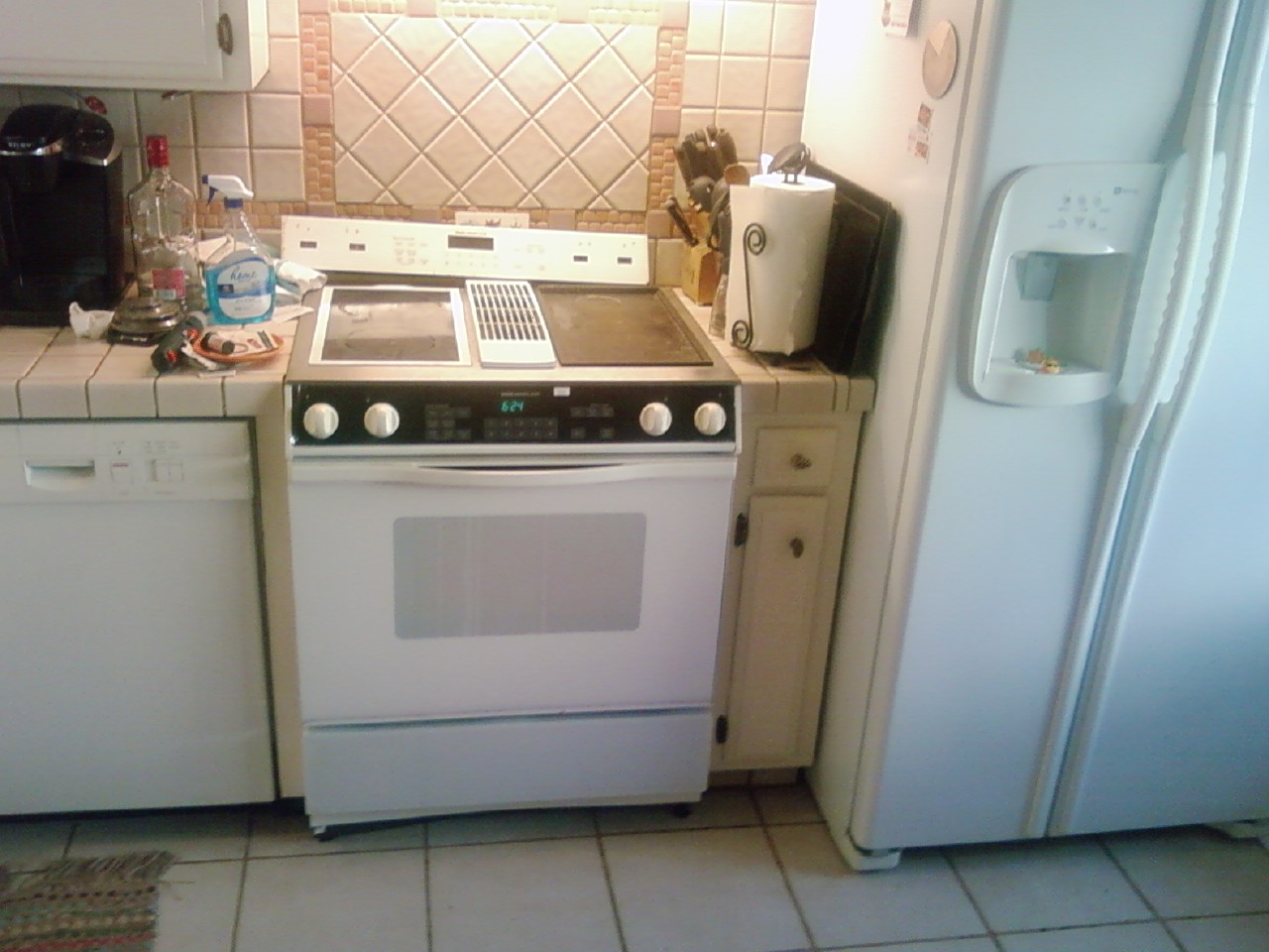

                                Haven't seen any recent updates in this thread topic but I'd like to thank you Drhook for your post. I have a blacked out display on our SVE47600W downdraft slide in oven range and have been researching the issue when I came across Bluto's thread and this one. I originally thought that maybe the display issue was heat related since heat venting from the oven door is just below the display.
                                I was able to still use the oven "blindly" (tho sometimes I would get a very dim display after the oven had been in use and fully heated) until a secondary problem arose. Sometimes the range would sound an audible whistle which I could cancel but it would start again at various time durations. This would suddenly occur without warning even though the range was not being used. I think I shut off the circuit breaker to stop this annoyance.
                                Subsequently the issue with the fan running and the oven light coming on simultaneously developed and did not abate unless I shut down power to the range. Powered on the light and fan run continuously and control panel buttons don't respond. The last operation with the range was to run the "Clean" cycle which seemed to function as designed.
                                I now know how to get at the related control board and will check and replace caps. I will also check that ribbon cable to see if that affects the fan/light issue thanks to you.

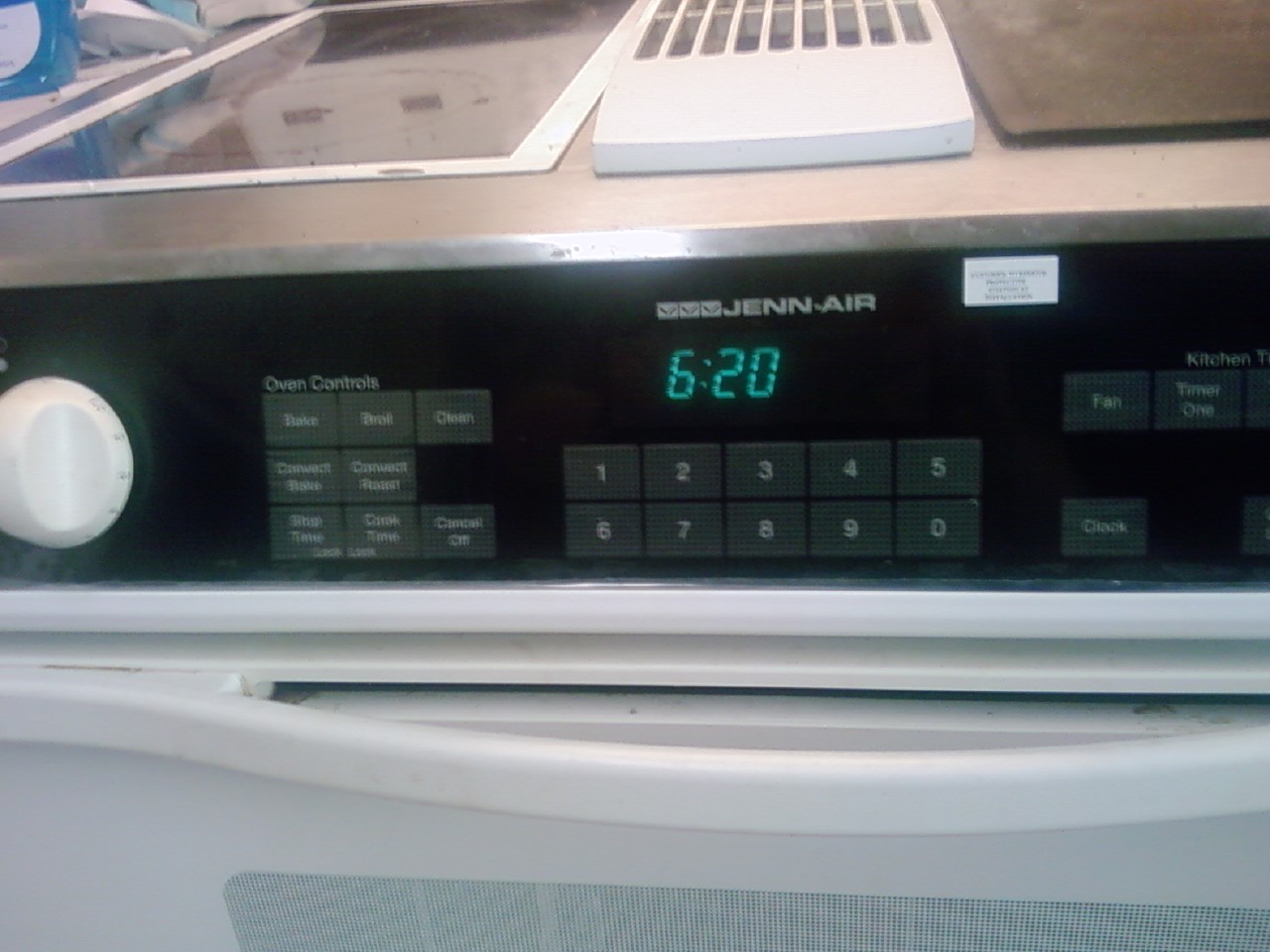

                                      I'm posting just to offer the details of my recent experience with this problem, in case it triggers an "A ha!" moment for someone else:
                                      My oven recently developed the dimming clock problem described in the other thread. It got progressively worse over weeks, until one day my wife turned on the oven, and it appeared completely out to her. I looked at it, and I think it was very, very dim, but not completely out. Certainly, it was unreadable. The odd thing, and the reason I'm posting in this thread, is that the broiler fan was also running. This was the first time that fan had come on at a time when it wasn't supposed to.
                                      I started researching the problem, which brought me here, and to the dim clock thread. In the couple of weeks that went by as I researched, ordered caps, and got around to fixing the clock board, we used the oven blindly, and it reliably turned on the broiler fan every time the oven started to get warm.
                                      I've fixed the clock board problem by replacing the 68 uF cap, and everything seems normal again -- except that the broiler fan turns on at 220 F every time now. I did not replace the other caps on the clock board.
                                      Now I'm living with it as-is for a bit, while I figure out whether the new fan behavior annoys me enough to do something about it. After having to repair that board, I'm not sure I object to this new, more aggressive cooling functionality. But the one thing that I can't shake is that these problems are somehow related. At the very same time my clock dramatically failed, the broiler fan developed this new behavior. The odds of them being unrelated problems seem low. I know stranger things have happened, and that the fan problem could have arisen coincidentally, but man, that's hard to swallow.
                                      I'm left wondering if the failure of that capacitor on the clock board somehow caused a cascading failure somewhere else.
