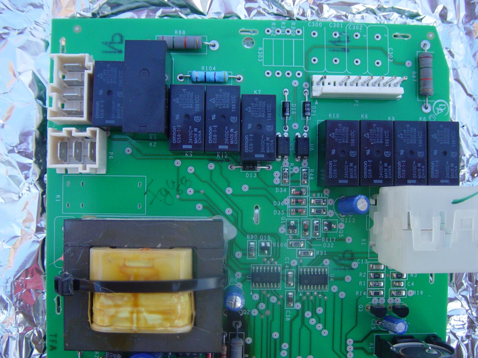

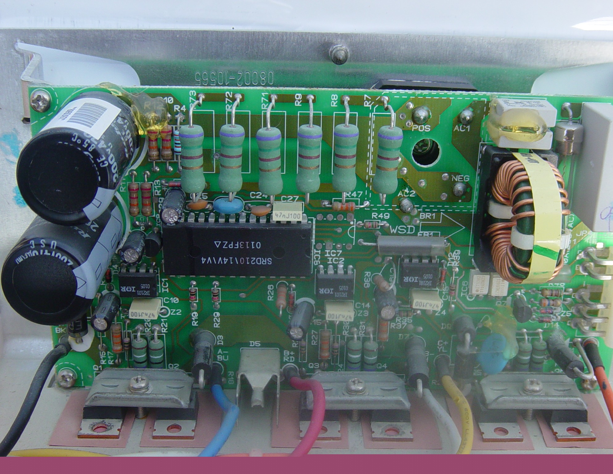

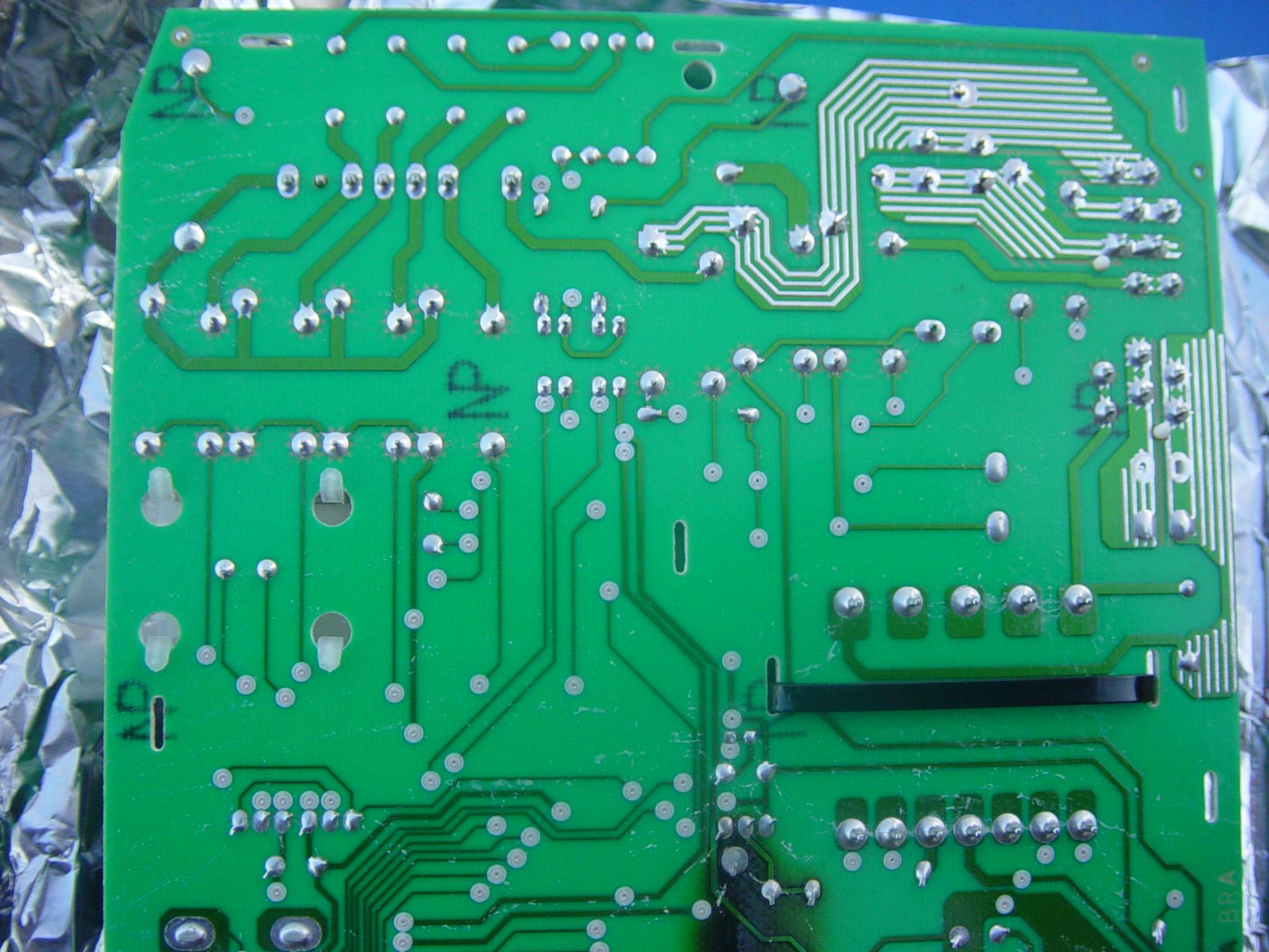

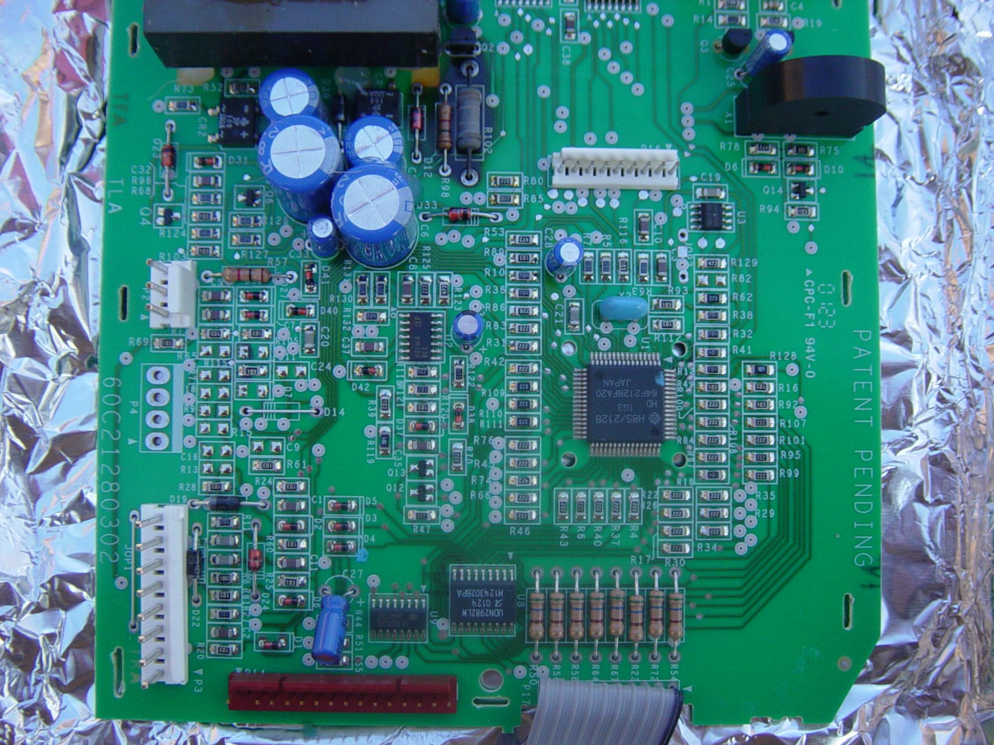

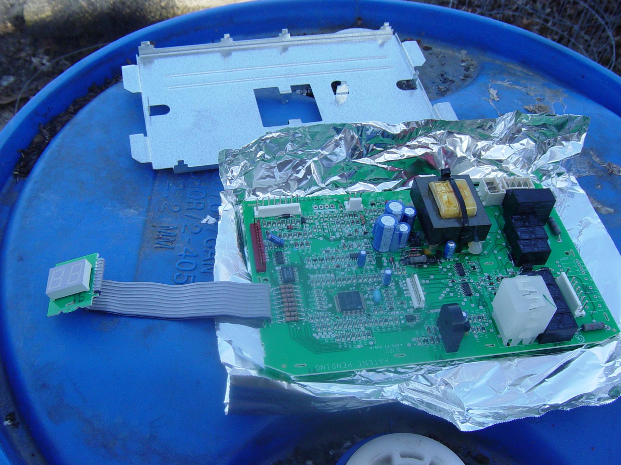

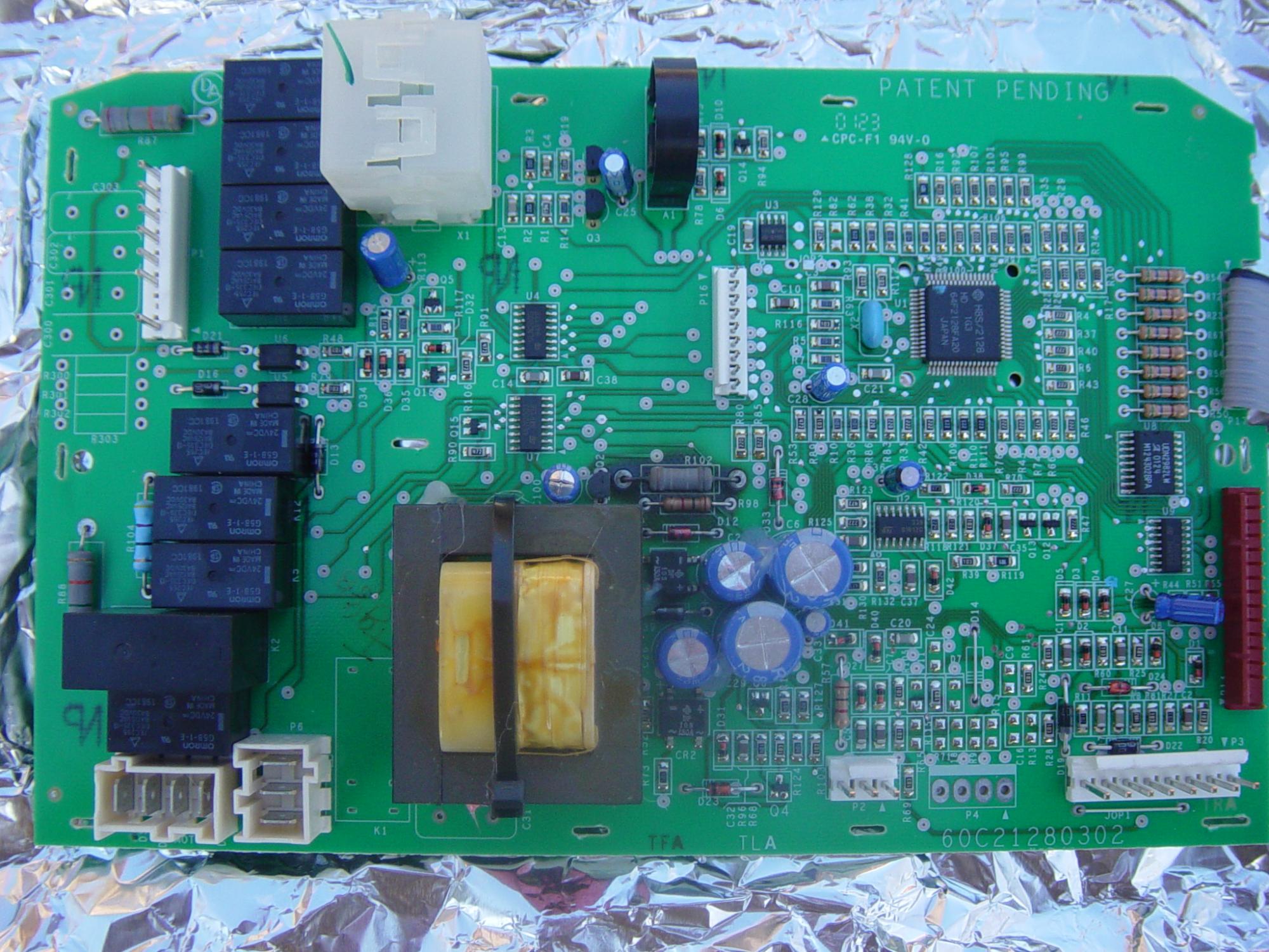

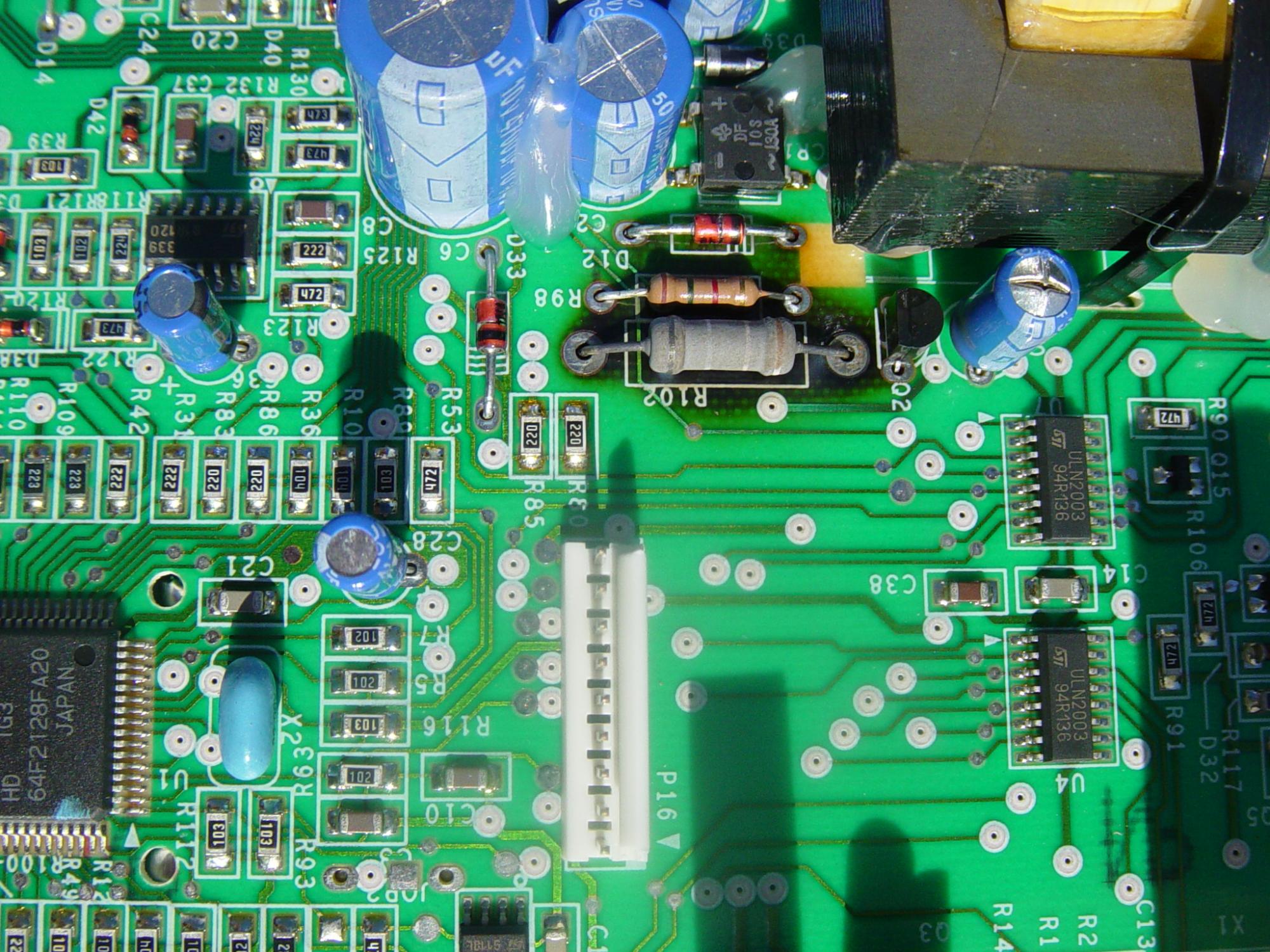

I didn't know where to put this, but I thought you TV geeks might want to test your skills. I suspect problems with a digital controller board of a major item in the home (not a TV or computer), but I am almost certain that the problem originated with one of the peripheral devices (which has been acting up for years). This board stores events and they all point to this same peripheral.
I have tried forums that specialize in this item, but they all want to take the easy way out and have me replace the whole item, or swap out one or more $200 components by trial and error.

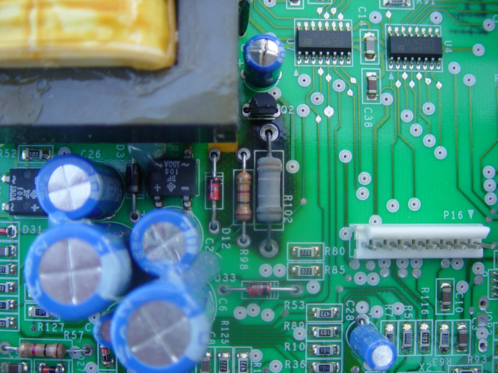

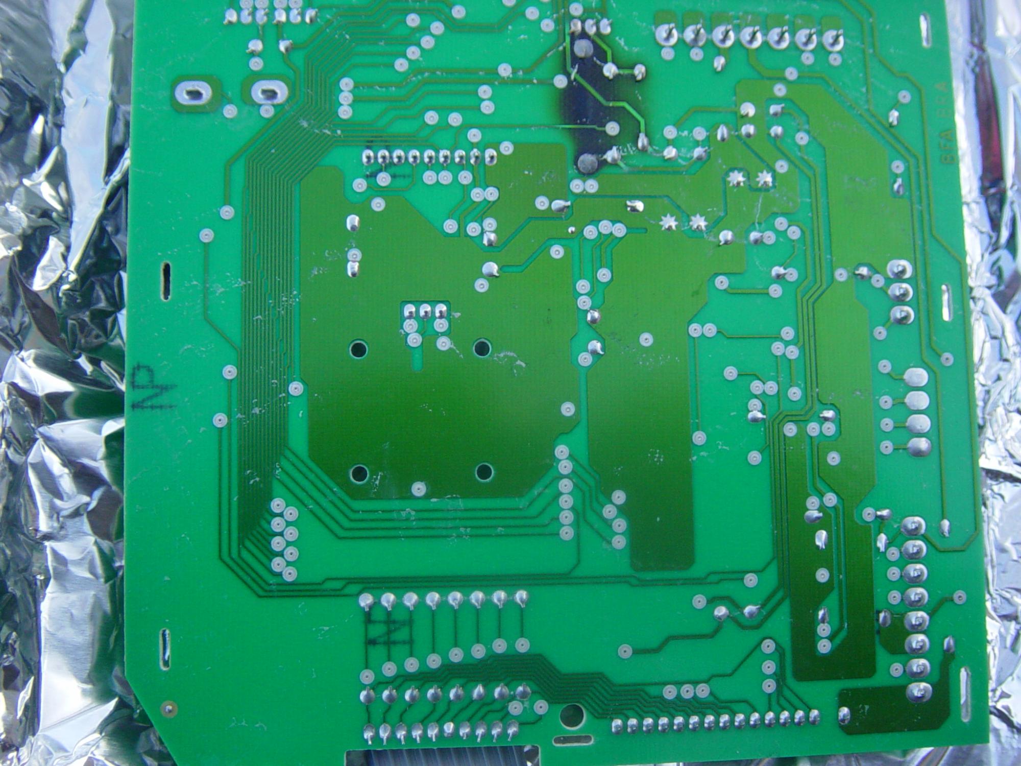

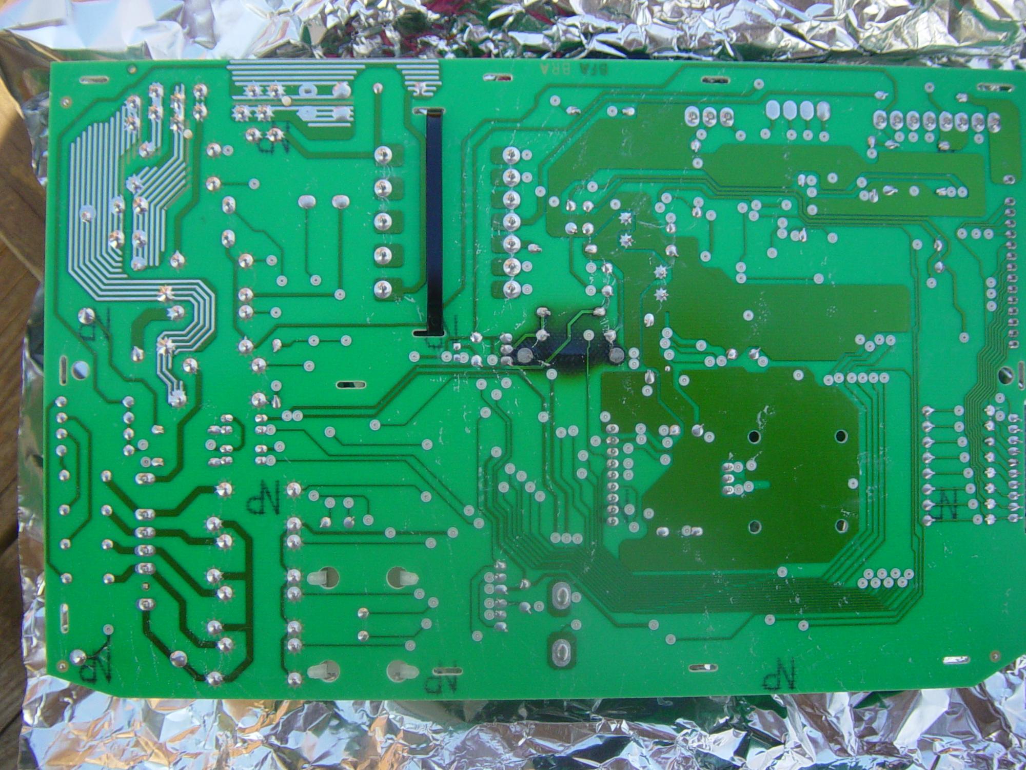

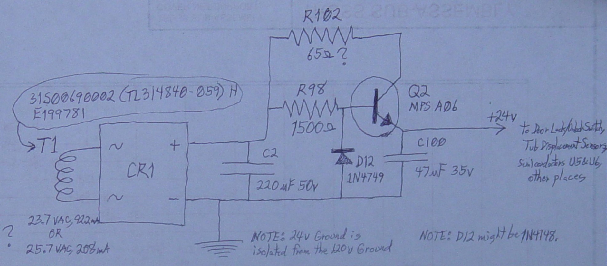

On the Control Board, one resistor gets very hot and has burnt the board around it almost black. Also (in close proximity), an electrolytic capacitor is domed on its top end. Is this ever normal?
I suspect that a sensor failed and that this led the controller to repeatedly send a signal to the peripheral until it burned it out. The control board may be damaged too.
If someone is willing to provide some serious help so I can fix this, I will go the extra mile to provide circuit diagrams, pictures, etc.
I have basic knowledge of analog and digital electronic circuits and have designed and built some simple gadgets, but no electronic troubleshooting experience. With a little expert guidance I would like to find the bad transistor or whatever if possible. I have been out of work for some time and need to fix this at minimal cost. Please help!
