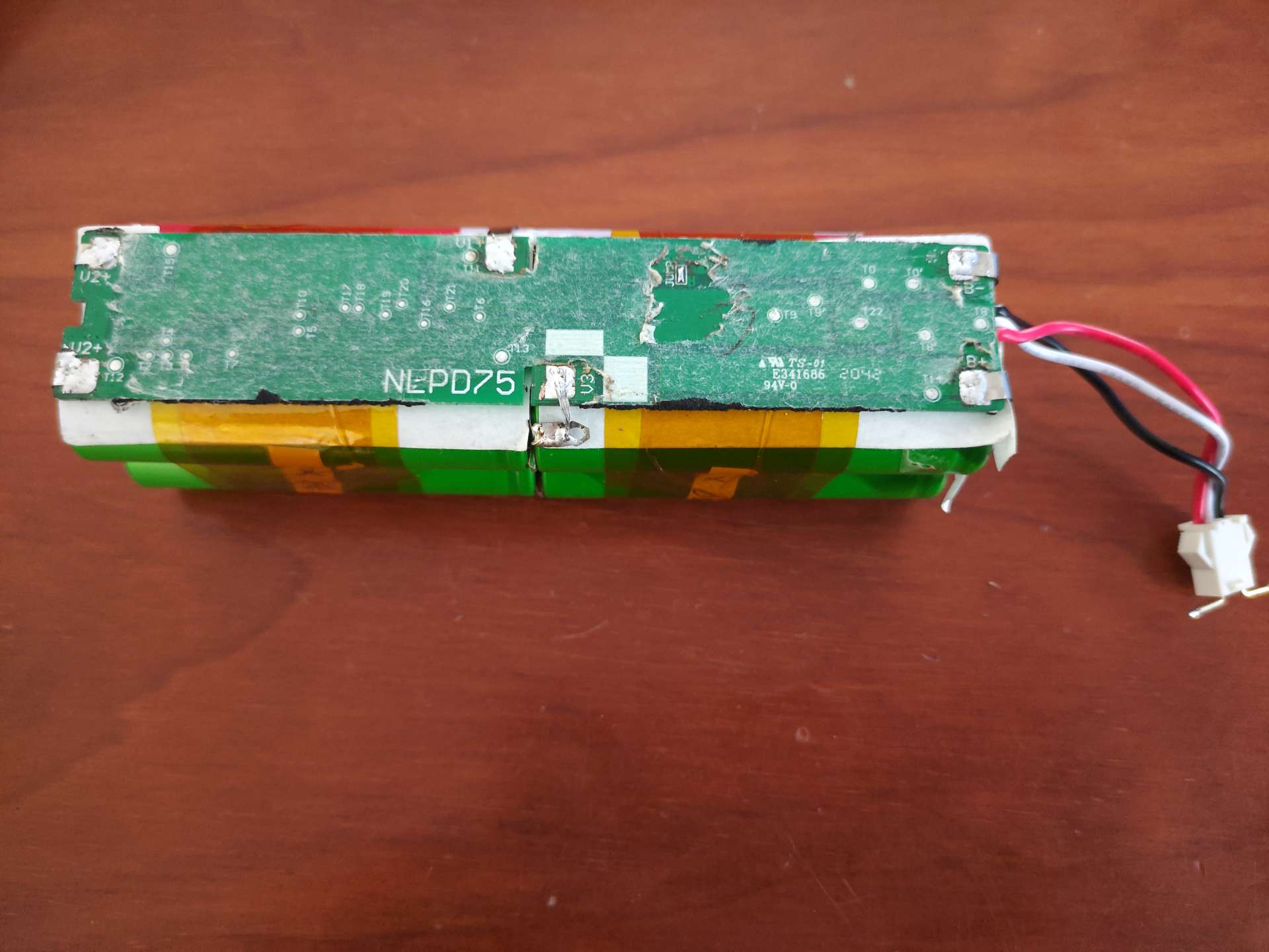

    Hi there.
    I hope one of you may be able to help me.
    My Xiaomi Roidmi EVE Pro battery died.
    I disassembled the battery and tested the cells to find 2 dead and other 2 almost dead.
    I then dug some batteries from my notebook battery bucket and recovered 8 cells to rebuild the battery.
    Yet I can't get the BMS to start working again: the output is 0 Volts and it won't charge either.
    Did not try to put it in the robot yet, but I don't think the robot will reset the BMS...
    The current cell balance is good with a total voltage around 14.5V.
    Any Ideas?

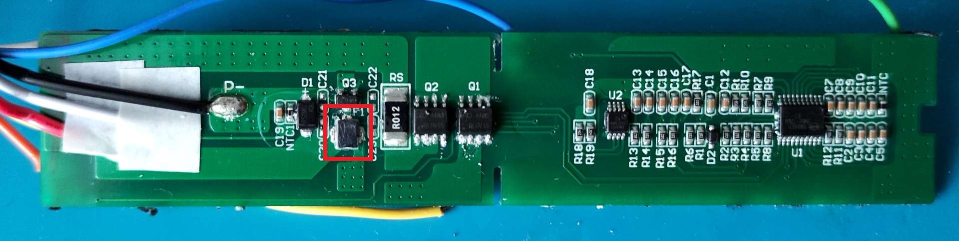

            Re: Xiaomi Roidmi EVE Pro battery died!
            Hello.
            Please check the attached picture.
            Hope it helps someone else.
            Cheers.
              Originally posted by CidiRome View Post
              Hello.
              Cheers.
              Did you try to temporarily bypass the fuse and see if it comes back to life and functions correctly or not
              I would not recommend leaving with out the fuse if you plan on using this BMS protection board but just for testing purposes
                Hello.
                I know that it will work if I bypass it, because I get voltage in the cable if I short it with the tweezers.
                I ordered it to replace.
                Cheers.
                  I had the same issue with this battery after replacing two failed cells. It seems if voltage drops on BCM below certain level it blocks itself. No idea on how to unlock it. So I soldered down a thick wire to short a control transistor on the photo above, reassembled battery and put it back to vacoom. Two weeks gone, no issues. Battery level detected correctly, carging works fine also.
