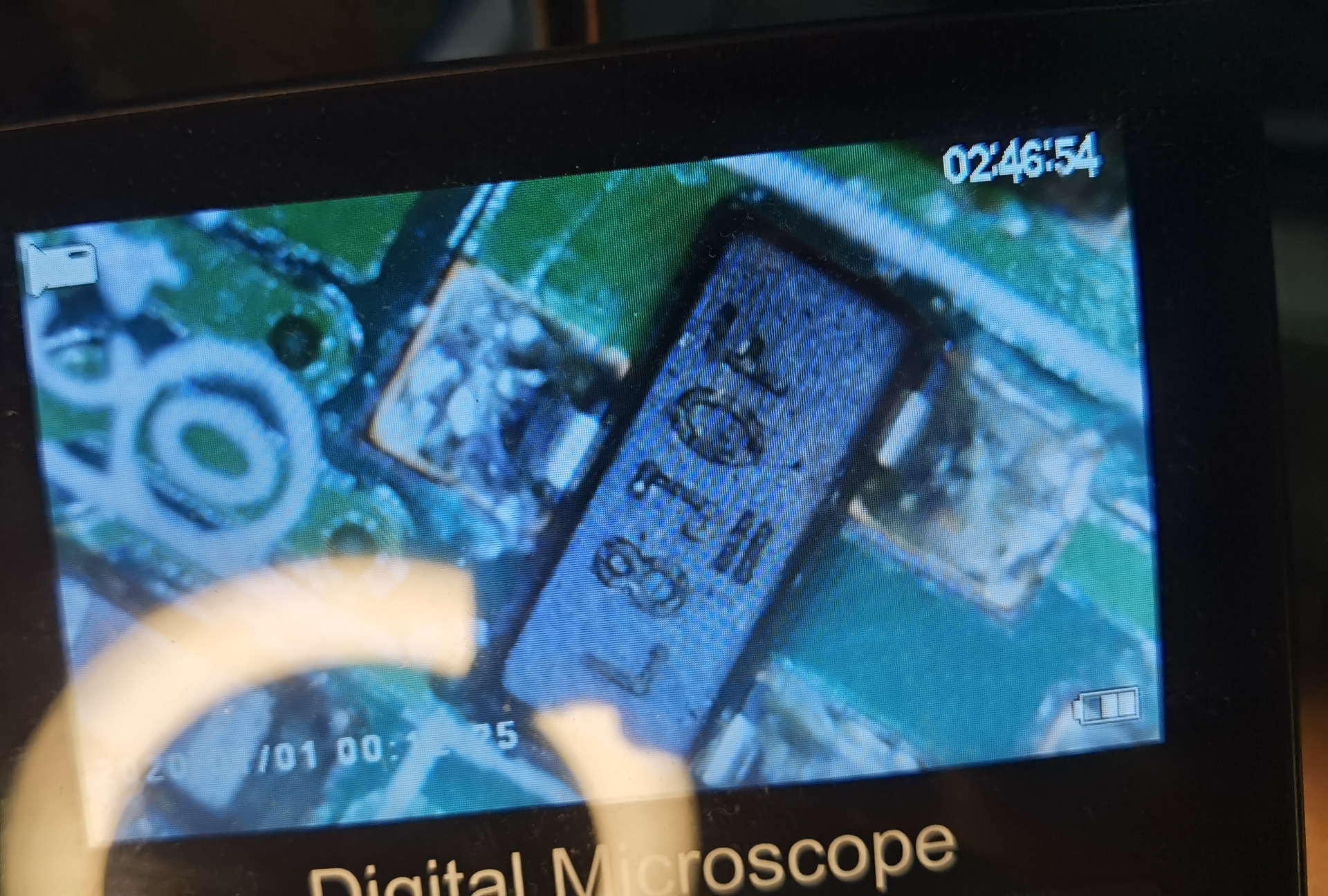

    SMD Marking L8J0F
    do anyone knows the value of this SMD components: marking L8J0F?
    Thank you,
    Mike

    What PCB is this part on,whats the make/model number

      Re: SMD Marking L8J0F
      Hi Mike,
      Based on L8, might be a dual diode, common anode schottky diode.
      BAR15 or BAT721A
      Check in circuit with meter on diode range to confirm. Expect forward voltage about 0.25v
        its from a samsung board model number: BN41-02568, can find any schematic diagram of this board. Hope someone can share...
