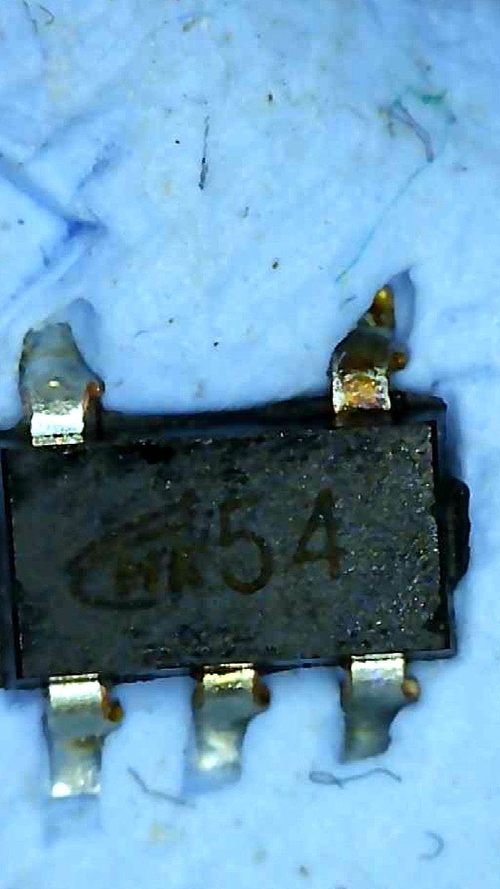

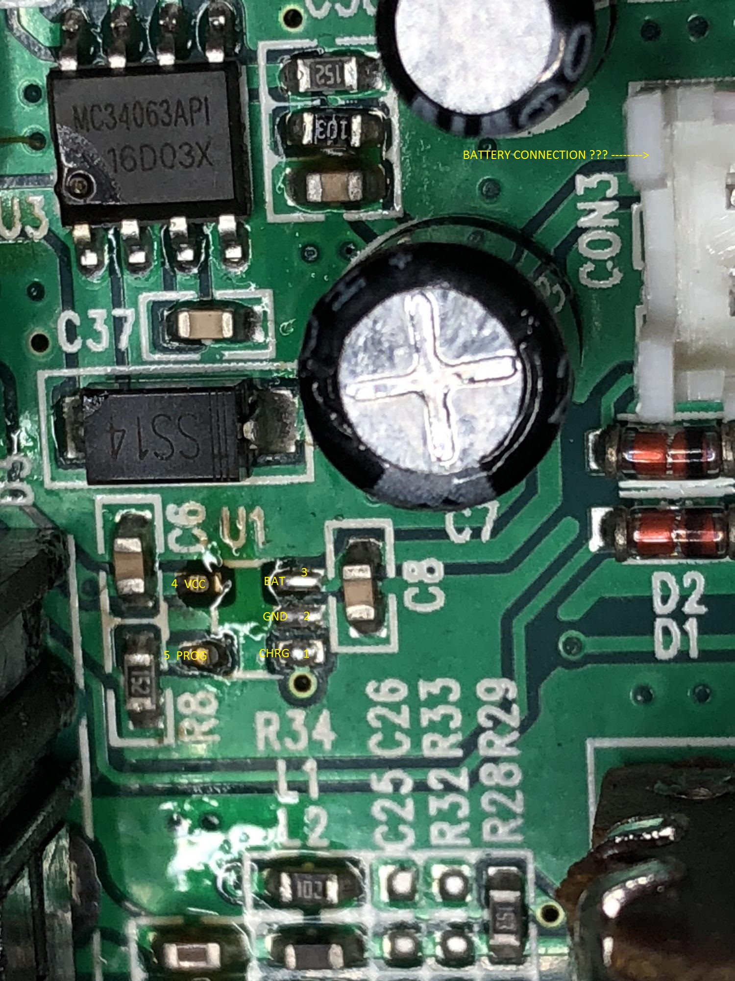

    Hi there

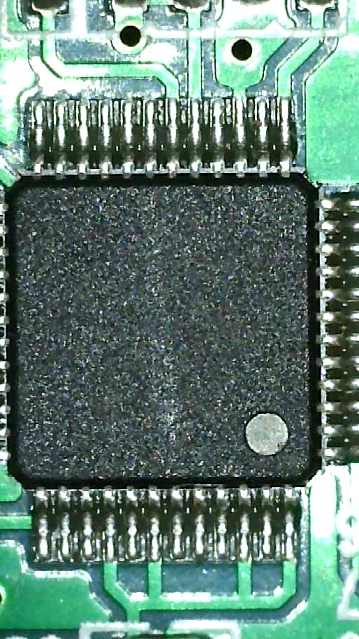

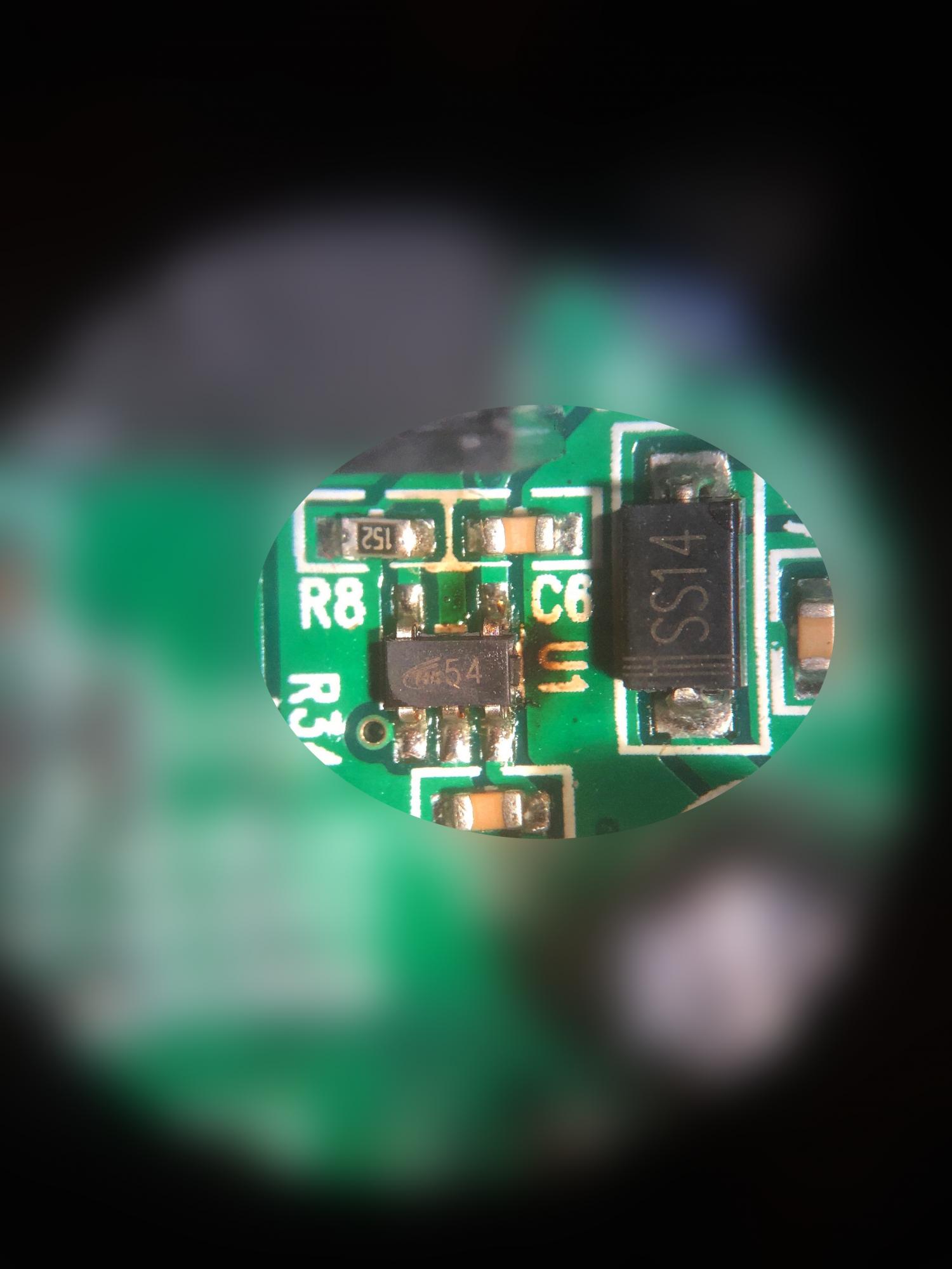

    Is anybody able to Identify these 2 Components Please?
    I am Looking for Tech info alsp Please as its for a BAUHN Portable Record Deck
    Model Number - BAUN - UVST - 0617
    I have another IC on the Unit, that is Suspect, but the Markings have been Scraped off, or wernt on it to start with

      The diode is easy, Schottky diode 40v 1 amp.
      Can you clean off the ic with something like alcohol so the logo shows up better?

        Re: BAUN - UVST - 0617,Can anybody Identify these Please?
        Hi R_J
        The IC has had the markings taken off, and when I spoke to the manufacturer, they said, " We dont give repair info"
        Do you have any idea what the Component is with the number 54, or how I can ID it please?
          Any Idea what the Manufacturer Logo is on the MOSFET looking Component?

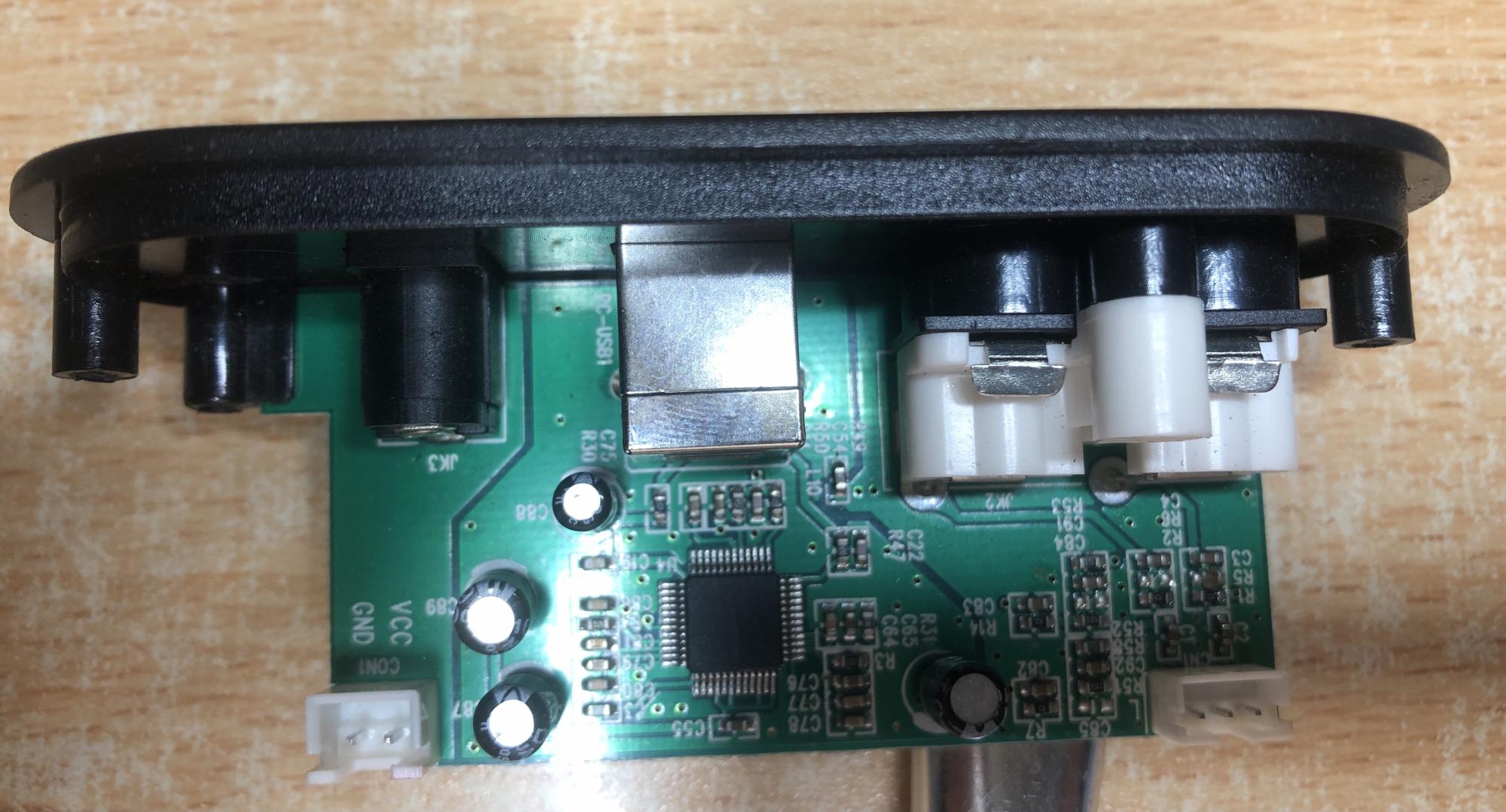

            The board marking suggests it is a ic not a mosfet, What is wrong with it? how can you know the part is bad if you don't know what it is.
            Can you provide a couple pictures of the complete board, both sides?
              Hi R_J
              The 2nd component has shorted, and started to melt
              The IC with many legs possibly is Ok

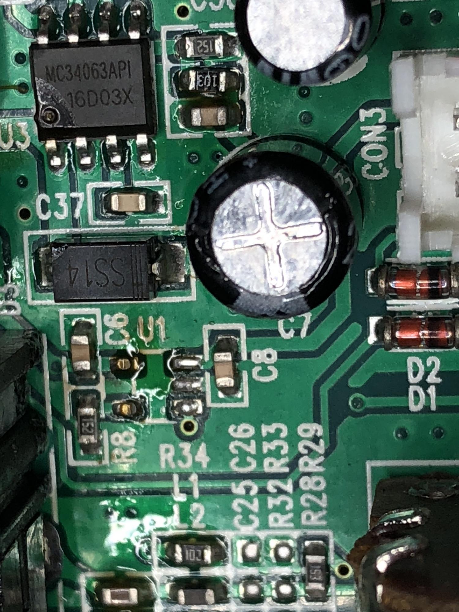

                The Board isnt shorted now, that I have removed the 5 legged Chip.
                I cant seem to ID the Manufacturer, and it seems to say HK 54 on it

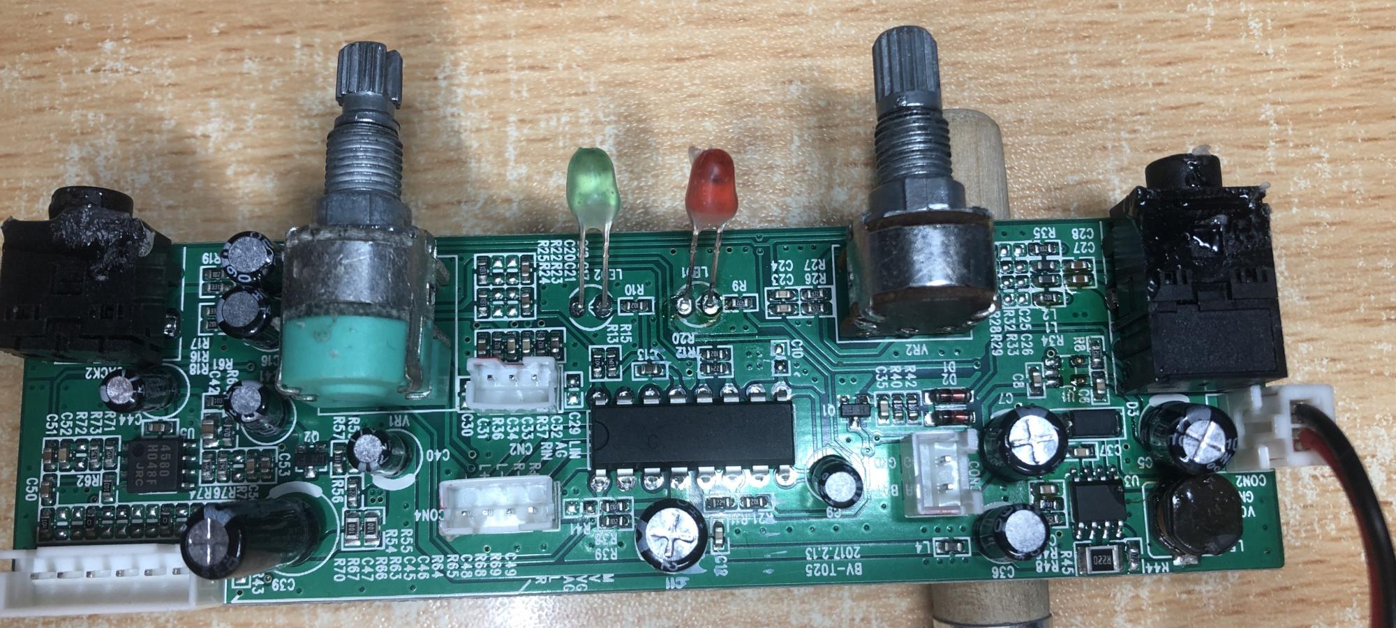

                  But where is it in the circuit? Is it part of the power supply circuit, this might help to identify it.
                  • Ritchie_Uk
                    Prawnography
                    • Mar 2021
                    • 185
                    • Uk
                    Hi R_J

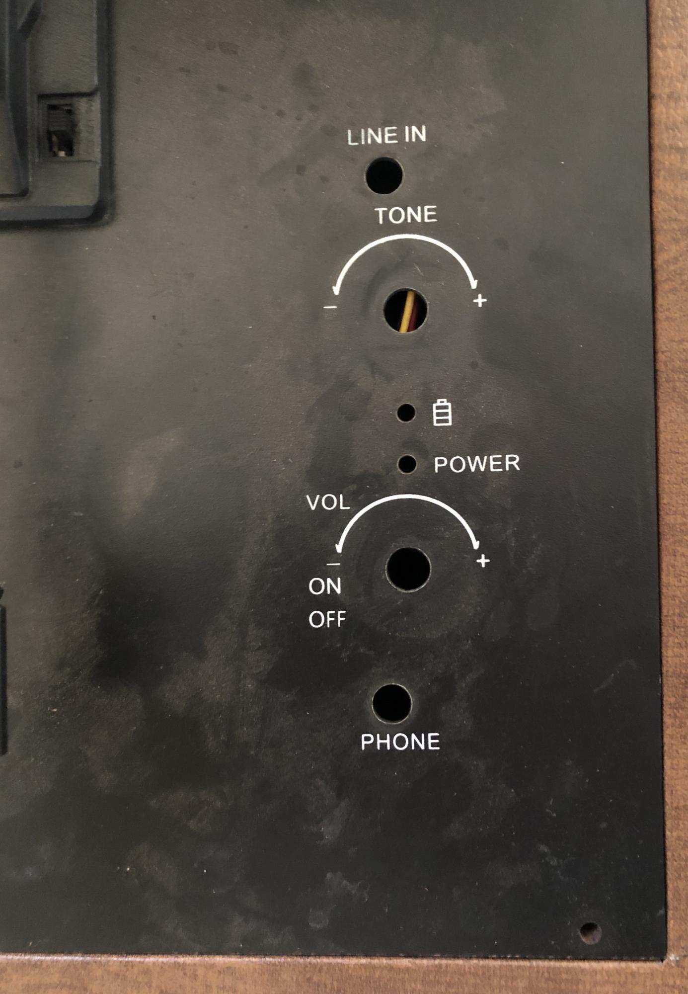

                    There are only 2 boards
                    The Simple board, is basically just an input, where the Power comes in from the Power adapter.
                    We can ignore this, as it's just a wire connecting it to the main board
                    The Populated board as you can see, has quite a few components on.
                    I have removed the shorted components, which was dragging the whole unit down.
                    The Left silver knob is the Power switch
                    The right is the Tone
                    The unit has an internal battery, that is dead, but I charged it manually, and the whole unit works
                    So it's not charging due to that component
                    That is all I seem to know
                    I hope this helps?

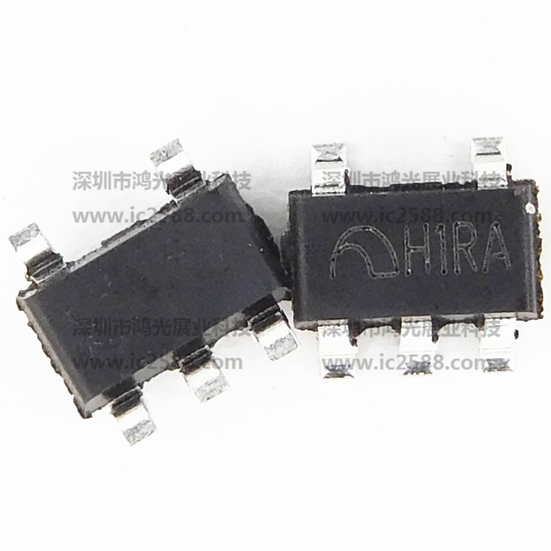

                      Then is likely has to do with charging the battery, trace out the circuit as I can't tell where the traces connect to based on the picture.
                      There are lithium battery charge ic's like the Tp4054, this may be similar made by some odd manufacture
                      The TP4054 might be close, check the datasheet and see if the pins line up. It looks close from what I can see.

                          • 31087
                          logo looks close
                          http://www.microne.com.cn/
                              what is the black socket on the right for ? u1 looks like it may connect to it
                                • 31087
                                is it related to a lithium battery?
                                ME4054?
                                http://www.microne.com.cn/ProductDetail.aspx?id=100

                                  • Ritchie_Uk
                                    Prawnography
                                    • Mar 2021
                                    • 185
                                    • Uk
                                    Here

                                      Here is a photo of the MicrOne version, the logo and markings are different, but I suspect the operation will be the same.
                                      I asked if you traced out the pins to see if this is the same ic, For example, pin 3 seems to connect to CON3, is this where the battery connects???
