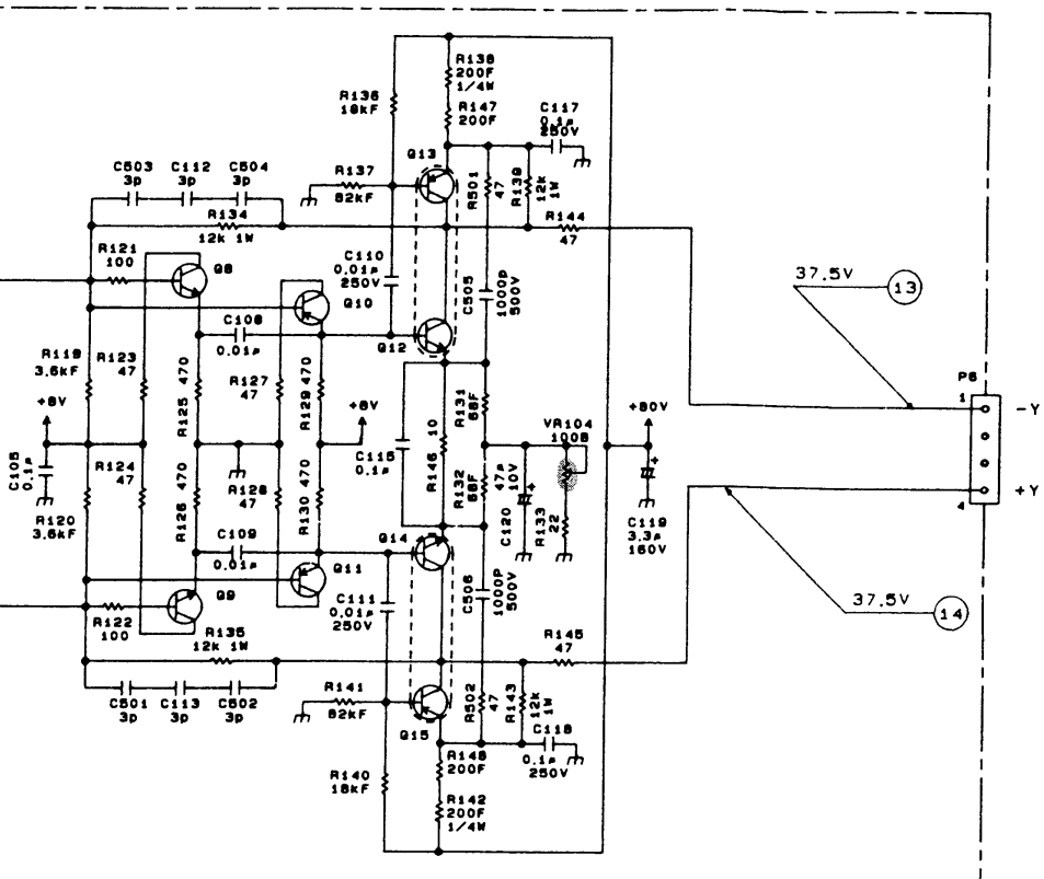

    Need a hand understanding how to read a part of the schematic.
    So, as reported in the earlier thread, after repairing the KMA-01 hybrid IC on the PSU, the scope came to life without any issues other than calibration.
    There were two of these scopes in the job-lot however, and the 2nd one also had the same bad IC on the PSU which was repaired in the same manner. This 2nd scope also had some missing transistors on the main board, which only arrived yesterday, and unfortunately, installing these components hasn't helped to resolve the lack of trace on the CRT. I know the CRT is working as it was tested on the other 'good' scope.
    All of the LV rails are also present and correct at the input connector to the main board, so the PSU is sound.
    The area on the main board in question, is part of the CRT control and via VR104, regulates two +37.5v lines which are taken from the +80v rail. At the moment the Collectors are reading 77v on one rail (Q's 14+15), and 5v on the other (Q's 12+13). Not 37.5v.
    What I am not yet understanding, is the sequence of control signals (or where they ultimately come from) to the bases of the transistors which regulate the +37.5v lines.
    There is the +80v input as well as both +8v and -8v connections further down the circuit.
    For comparison, I've taken voltage measurements from both scopes and it is clear that the 2nd scope is at least a couple of sandwiches short of a picnic.
    The section in question is attached if anyone fancies a challenge?
    I'll post photos and all the voltages if it will help

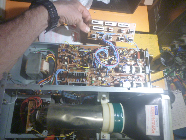

                  Looking closer, only the front section is connected to the chassis and it seems there is no continuity through to the rear although the rear is grounded.
                  The photo shows the X and Y channel selectors just to help visualise the setup.

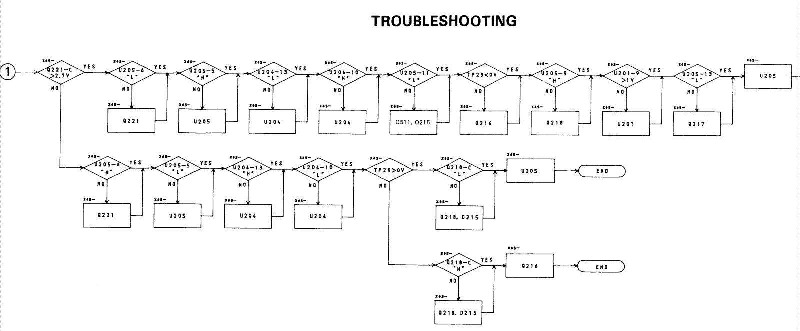

                        Blimey, there is something seriously screwey with this scope and I am getting nowhere.
                        Following the 'Troubleshooting' guide, it leads to the Sweep section, which following the failed waveform shapes at TP 29 and 30 leads to a couple more tests before leading to Section 1..
                        The first test fails by Q221C reading 1.12v instead of >2.7v yet following the chart asks to check Q221, which checks fine 'in-circuit'. The next test asks to check pin 5 of U205 for either High or Low, yet just to confuse things, it reads 3.1v.
                        I am thinking that the only option for me is to remove and test all the transistors and diodes and simply replace all the chips in the Sweep section, as I am at a loss as to how to test.

                            Looking through the schematic leads to the Sweep section which when following the 'Troubleshooting' section leads to Q221 which is (supposed to be) turned on by U201 - a Kenwood Hybrid chip, KMD 02.
                            Yesterday, I was tired and got lost, however the Great Electronics Repairman in the Sky visited me in my dreams and told me to check out why Q221 wasn't switching.

                              Have you checked the input and output voltages of U4? they should be 0v with no input signal. Also check the -1.2v (9) and (10)
                              The +37.5 v is changing because something is biasing the circuit to change. The circuit is DC coupled so anything can cause it.
                              Q221 is likely for blanking and may or may not have a pulse on it.
                              The sweep circuit may be working but it is sweeping off the crt face due to the vertical deflection not being 37.5v on both plates.
                              The +37 and the +68 are not rails, they are for the crt's deflection. when both -Y and +Y are at 37.5 volts the crt trace will be in the middle (top to bottom) Changing the front panel's Vertical position control will cause the 37.5 volts to change.
                              When the DX+ and DX- are each at 68v the beam would be in the center (left to right) this voltage will change as the crt beam is swept across the crt face.

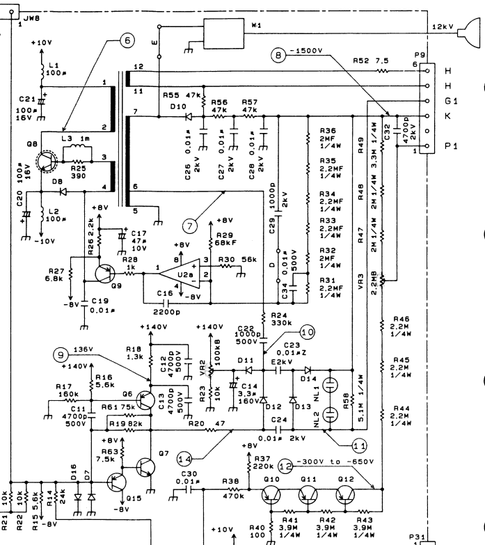

                                  There is still no life on the CRT, so I'm just about to see if there is any HV is present on the TP12.
                                  I don't have a proper HV probe so can't test the -1500v however TP 12 should be between -300 and -650v.
                                  Let's see?
                                  EDIT:
                                  So... no high voltage whatsoever at the TP (R44 - R43). Only 684mV
                                  At least there is some kind of progress now...
                                  Including the schematic below
                                  I'll check the Op-amp and transistors tomorrow

                                    Does the heater light up in the crt? it may be hard to see in a bright room. Also check the intensity control, this button should be IN to adjust the crt intensity and pulled OUT to adjust the scale illumination.
                                    On page 30, P12 pin14 is the INT pin, this should vary when the intensity is adjusted.
