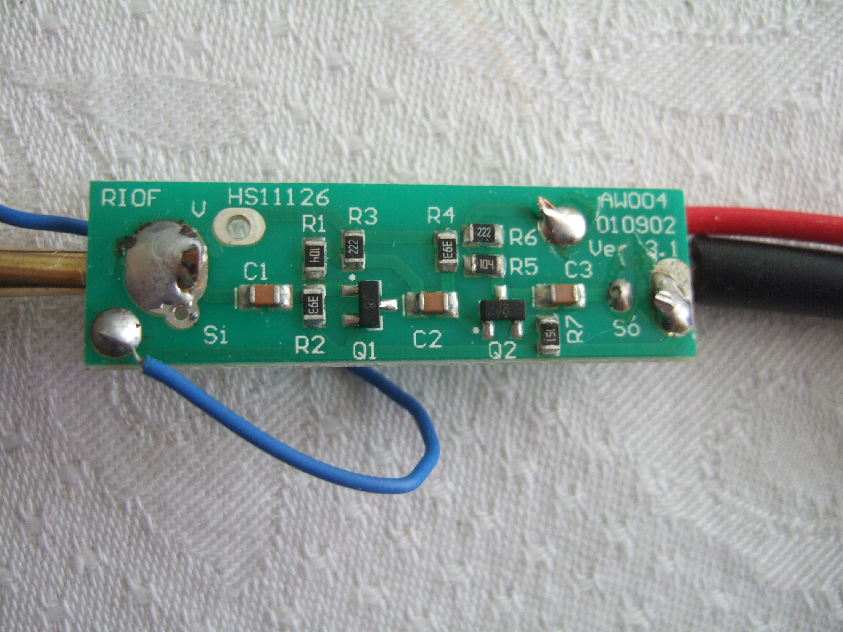

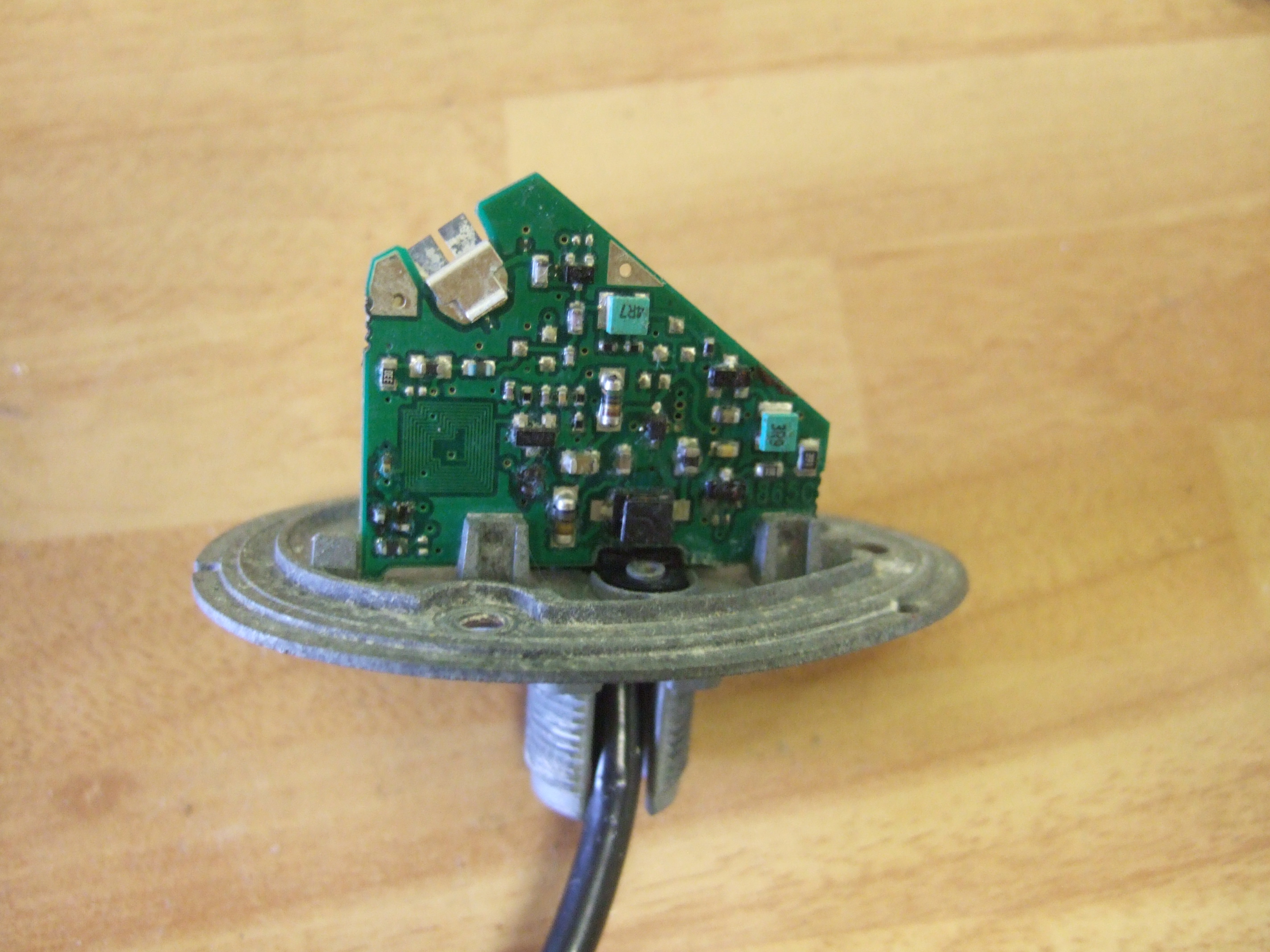

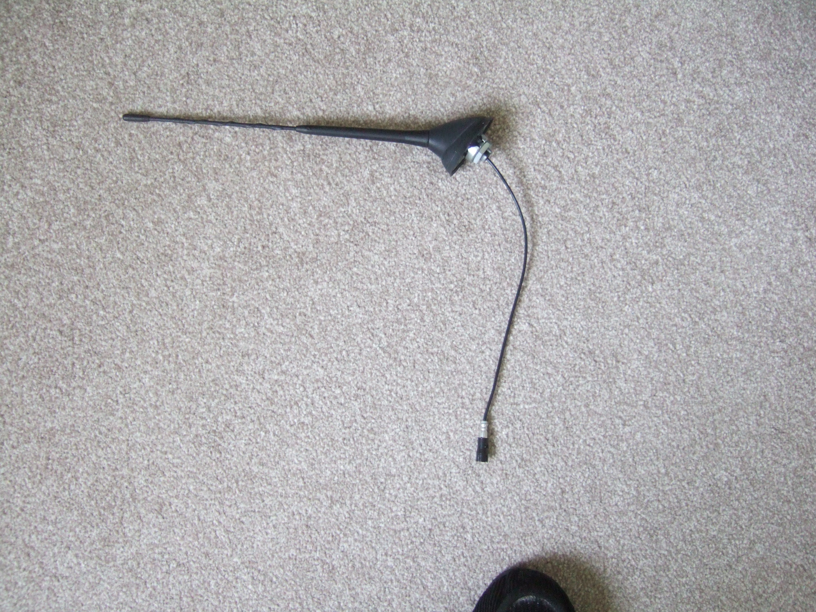

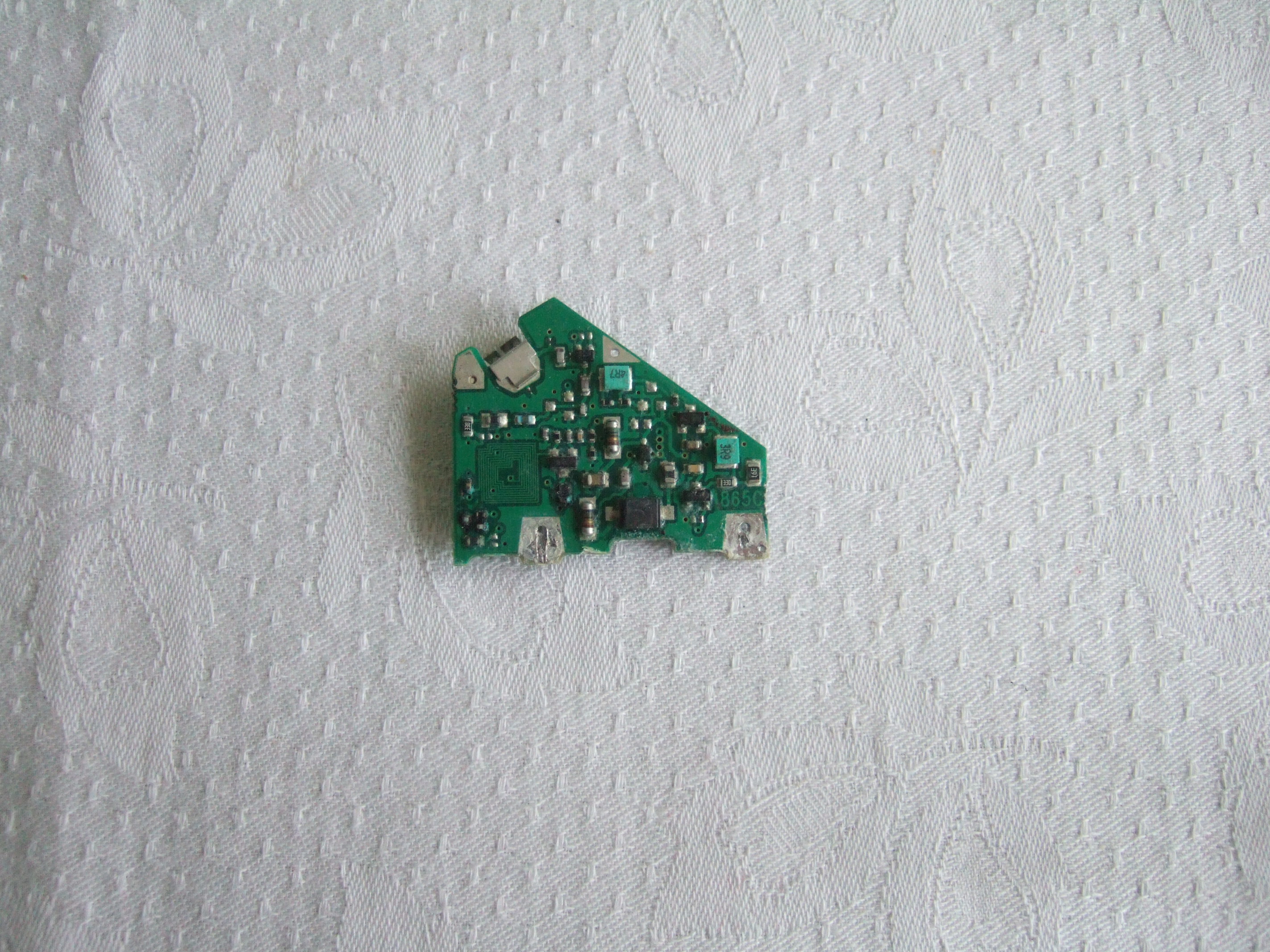

                            Re: Active Car Radio Aerials
                            Hi some pictures
                            The active aerial from the Citreon ,only has a 50 ohm cable.
                            the amplifier inside the aerial
                            and the in line amplifier I bought on line.
                            I had to make a filter to power this up.
                            The intention is to fit this amplfier inside the aerial unit
                            I have seen an aerial that looks exactelty the same with two leads on line
                            It would mean running a cable from the radio to power it up.
                            Barry
                              The factory antenna amp looks better than the one you bought IMHO.
                              The OEM has spark gaps, transient protection, 4 transistors and a bunch of inductors.
                              The new board has none of that, and only 2 transistors. So you might want to evaluate it before fitting it in there. I can't see it performing that great.
                              It looks like Citreon is using a tiny antenna and trying to make up for that with the preamp?
