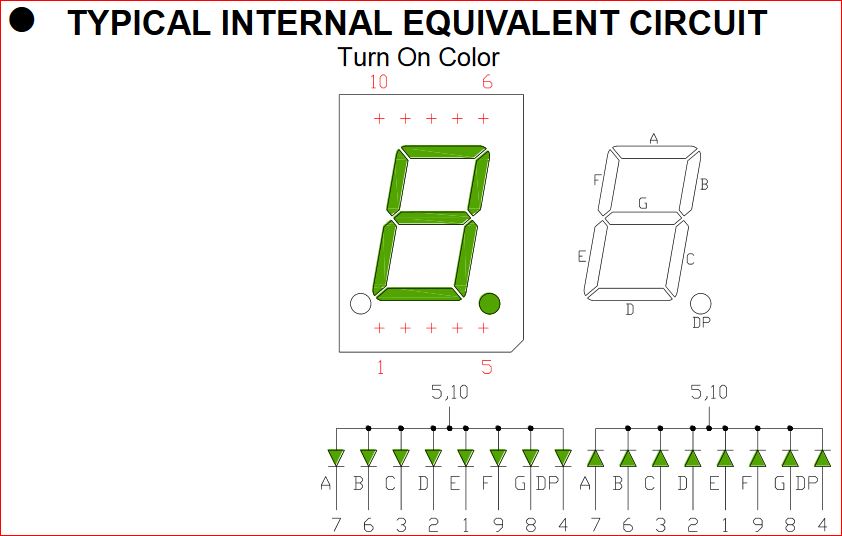

    Hello!
    I need to replace a green 7 segment LED display that has the common anode at pins 5,6 but I've only found ones with common anode at pins 3,8 and of course I cannot fit them into the circuit.
    Do you know what kind of display is this and where can I find one ?
    best regards

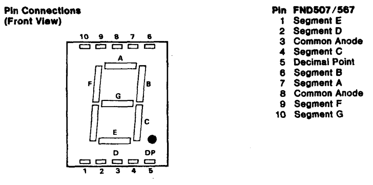

            Re: 7 segment LED display with different pinout
            My old Quest SuperELF uses Fairchild FND500 series and there's the smaller FND357 - both of which have the pins along the top and bottom, that's the second style of LED display pinout that is common. These have pin 3,8 as common.

              • ADF79
                • Dec 2021
                • 4
                Yes it's a single digit, about 0.6" with 10 pins parallel to width. I can't find a part number.
                The only difference is the non-standard pinout, common anode is at 5,6 instead of central pins.
                • redwire
                  • Dec 2010
                  • 3900
                  Usual Fairchild-style, pin 5 is DP and pin 6 is B-segment, with 3,8 common.
                  I did see an alternate pinout, for the 10-pin (across the top and bottom) LED display.
                  There is common on pin 5,10 which is the opposite corners, with DP pin 4, C-segment pin 3, G-segment pin 8. Not sure where this pinout-style came from.
                  There's 0.56" (14.2mm) height and 0.6" (15mm) height.
                  • ADF79
                    • Dec 2021
                    • 4
                    This has exactly the same pinout on the bottom side and a little different on the top side, but I guess would be much easier to fit than the standard 7 segment pinout.
                    I attach a picture of the actual pinout I'm looking for. Has anyone ever seen it ?
                    Regards
                        hmm necro post but found something interesting.
                        The pinout desired seems to match one half the standardized 18-pin dual digit '88' common anode pinout. Unfortunately the other digit needs to be dealt with.
                        Pinout of the 18-pin is like
                        (18)F1 G1 A1 B1 CA1 CA2 F2 A2 B2(10)
                        (1) E1 D1 C1 P1 E2 D2 G2 C2 P2(9)
                        Course having E2 where CA1 should be doesn't help.
