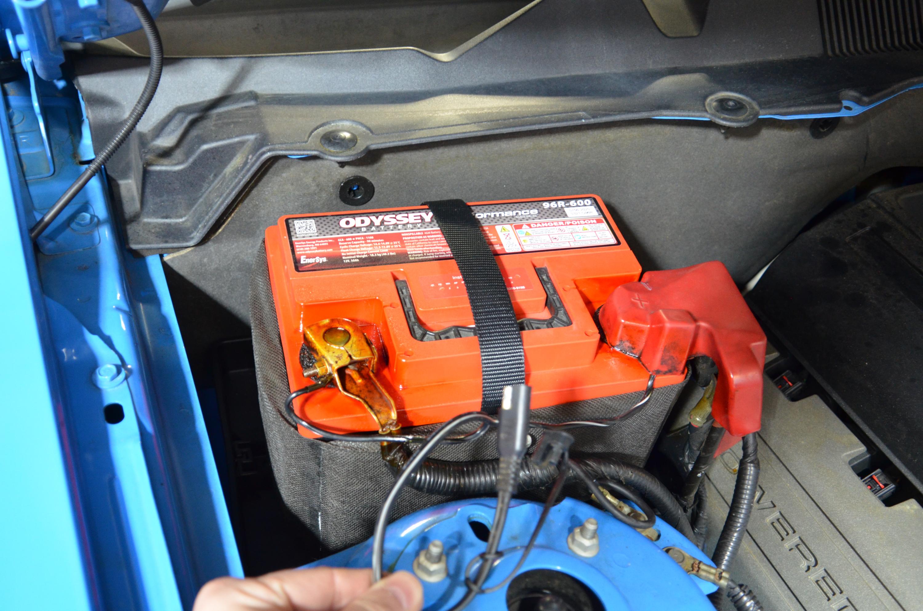

    On my Mustang which doesn't get driven much in the winter I have an SAE quick disconnect (similar to this one: https://www.amazon.com/Battery-Tende...ps%2C55&sr=8-3) wired into the battery (I just use a plug-in battery maintainer since it is parked in a garage with plenty of electric outlets) which will work with most battery maintainers (both plug-in and solar) and allows quick connection without messing with alligator clips and risking shorts.

                            Note the SAE disconnect plug I have is just to plug in a charger not to disconnect power to the car. A disconnect for the car itself will drop parasitic losses, but you'll also loose any saved settings and dynamic ECU maps (also the emissions monitors will be reset, so if you live some place with emissions testing, make sure to go on a few "drive cycles" so all the monitors can run before taking it in for testing).

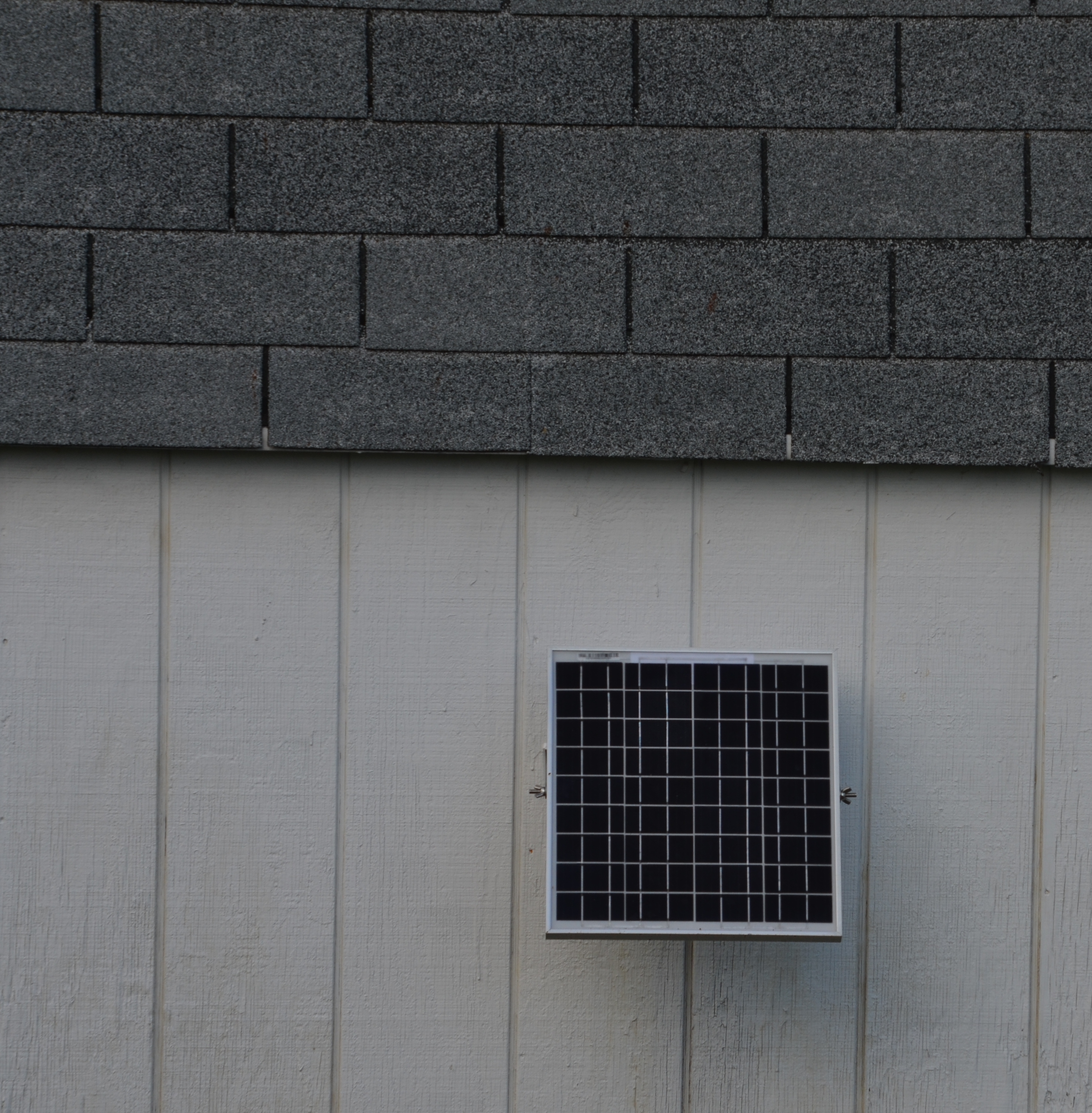

                            It depends on how good the panel is (which granted a cheap solar charger probably isn't going to have a great panel), I don't charge any car batteries with solar chargers, but I do have a solar system in my shed for lighting consisting of a 20w panel, a 12ah 12v lead-acid battery, and a charge controller, and this panel will still produce around 30-50% of its rated wattage on a cloudy day.

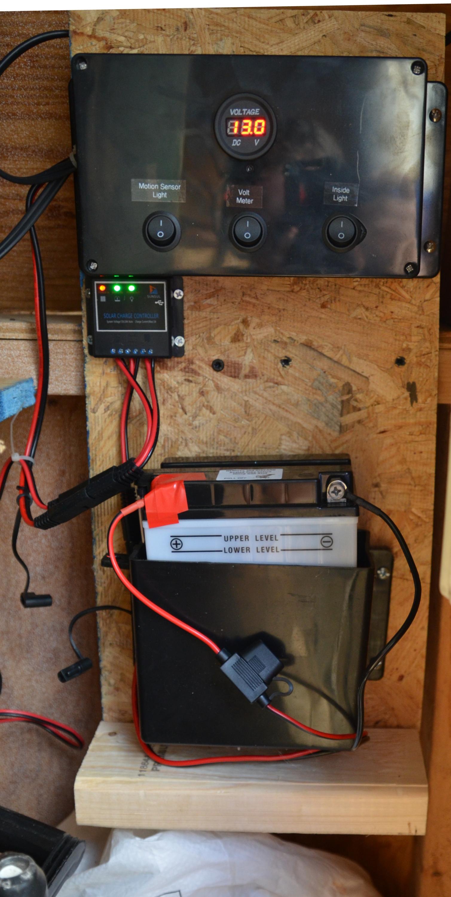

                            This was not a particularly expensive setup (specifically it is this: https://www.amazon.com/dp/B0956QFKVY...roduct_details), though probably still a little higher quality panel than the average "suction cup to the roof" or "throw on the dash" charger.
                            Originally posted by EasyGoing1
                            Check out this gizmo ... only $18 and it looks like it will make sure the battery stays properly charged...
                            That is similar to the charge controller on my shed (though a bit more advanced with the LCD display and RS232 port), don't count on them meeting the advertised current specs (but a "10A" charge controller should be able to handle the 1A-2A of a small solar panel just fine), but otherwise it seems to work pretty well.

                                        So I got the same setup you have using the link you posted ... I got the 20 watt panel with the charge controller... the instructions are total crap, so I wanted to post this photo and make sure that I'm reading all this properly...
                                        So Im going to connect the solar panel to the SC ports, and the battery, I'm going to connect to the center ports but I'm going to connect the hot lead through a normally closed relay where the relay is actuated when the ignition key is in the on position. This should guarantee that the system is not connected when the alternator is running. And that last set of ports I'm going to just remove those wires since I wont be using them for any lighting of any kind... does that resonate with how you have yours hooked up in terms of properly identifying the ports?
