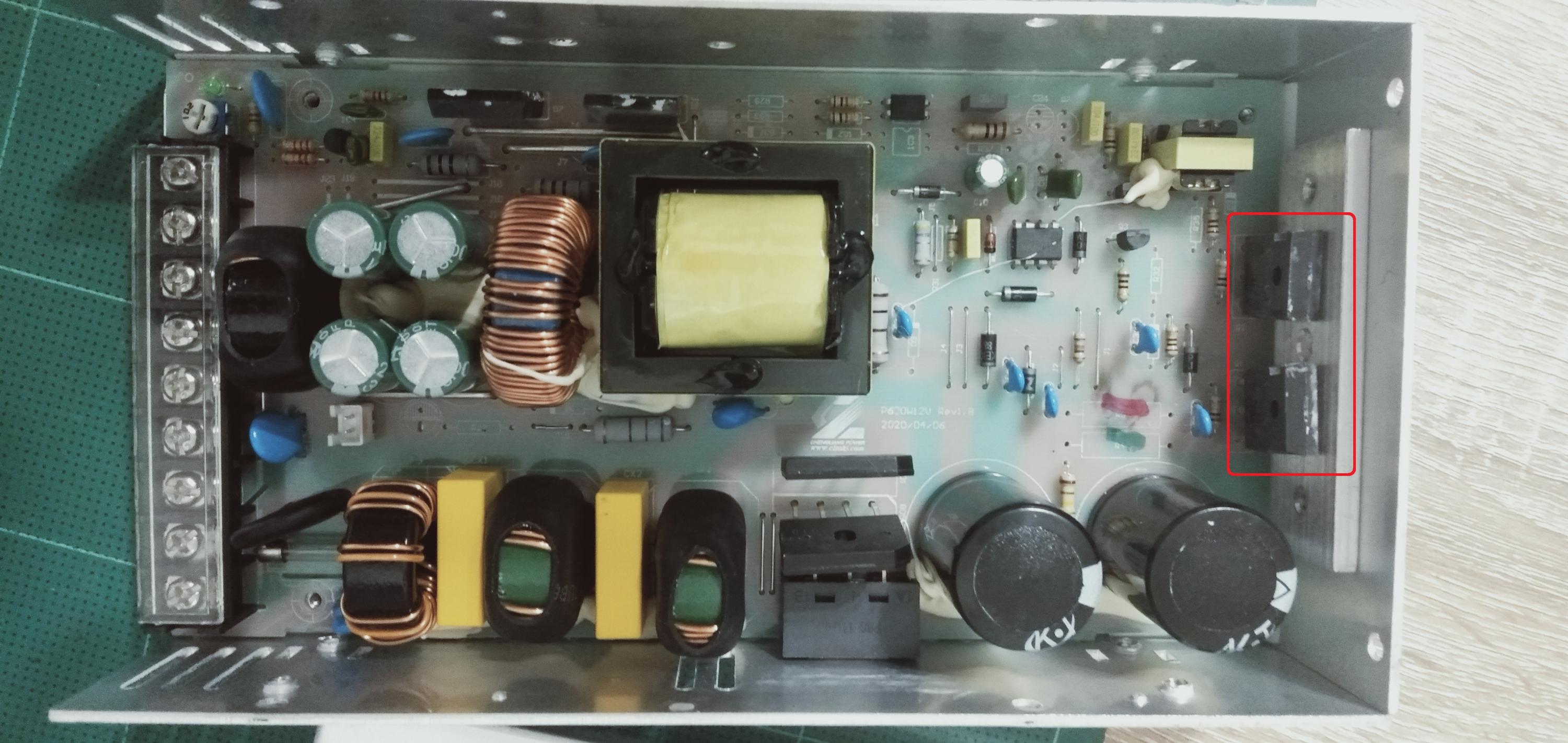

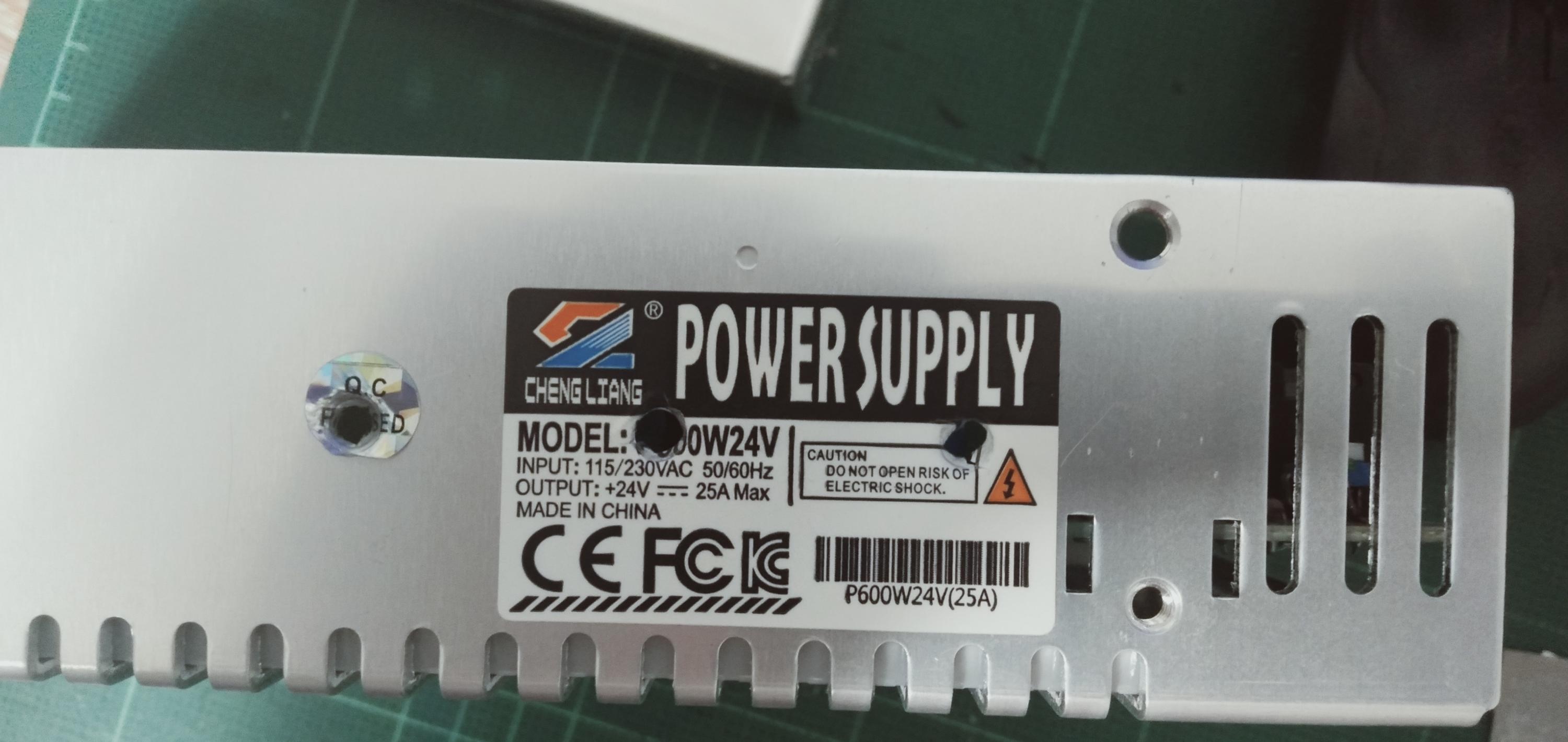

    Hi, I have a 24v 600w SMPS from a cnc/engraver machine. It has stopped working, No power from the supply. I opened it up and found the main rectifier, 2 mosfets, and 2 current sence resisters all blown. I can find the bridge rectifier and resistors but not the mosfets. They have the number 600R160 on them but i searched everywhere on internet but unable to find any datasheet or info to get equivalent. The only reference I can find to 600R160 is for resetable fuses. Can anyone advise me as to what a replacement might be. I have attached photos if its any help. Thanks in advance for any info.

      The manufacturer of IC is "Wu Xi China Resources Huajing".
      It seems to be hard to find on the internet. Source:
      http://www.ecadata.de/herst/myshowlogo.php?F_SPRACHE=2
      Can you measure the size of the mosfet?
      I am not sure if they are mosfet, because the part number does not match other mosfet part numbers from that company. They use "N" between the numbers instead of "R".
      If those are mosfet they are probably 600V 16A. Maybe you can replace with one with the same or greater parameters and check if its work.
      An example: STW25NM60ND

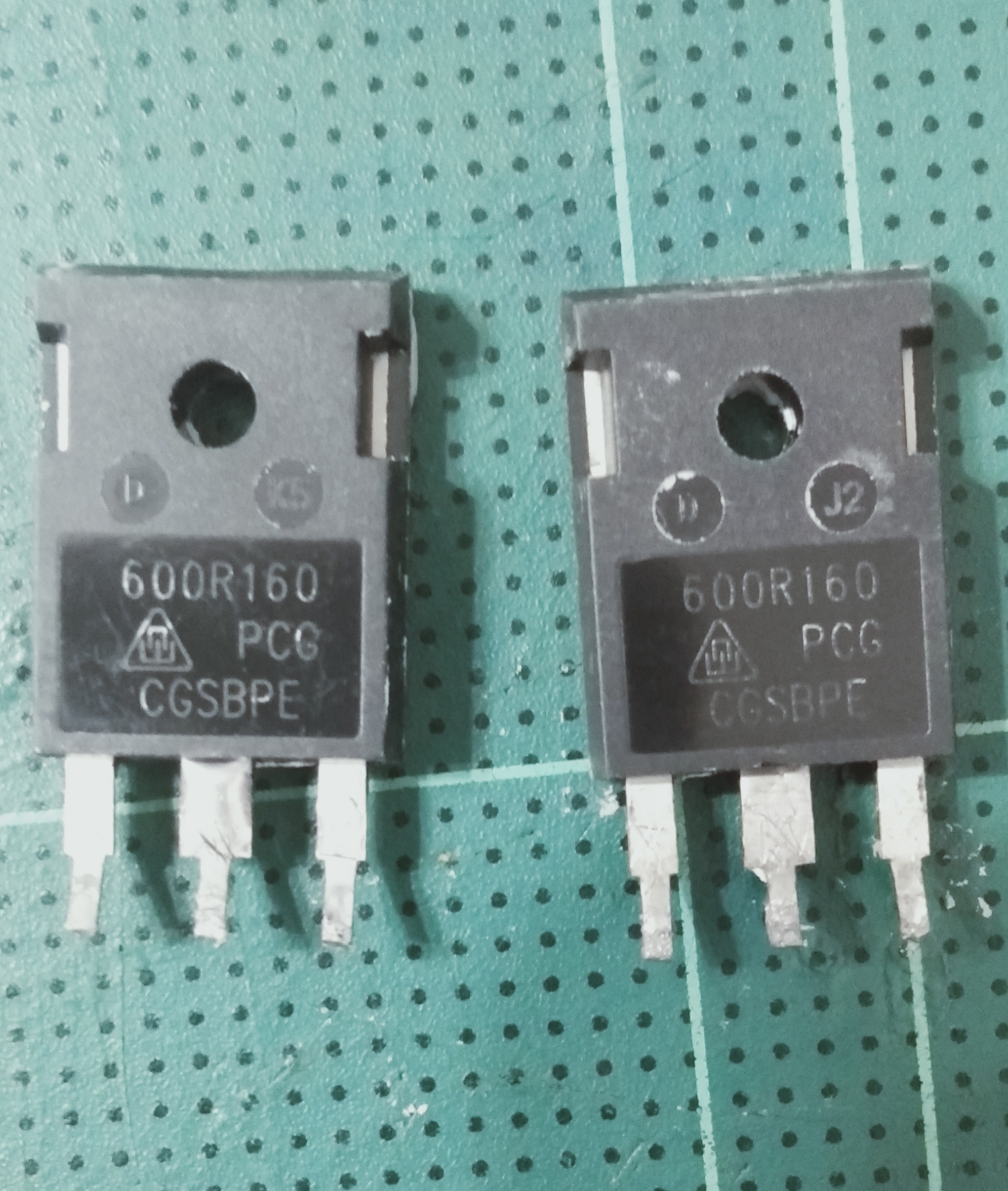

          Re: Mosfets for P600W24V Smps
          600r160 - hpf600r160pc-g
              Thanks to everybody for all the replies and info. I should be ok finding an equivalent now. I have already got a replacement complete supply from the machine manufacturers under warranty but still would like to fix the old one for a spare in the future.

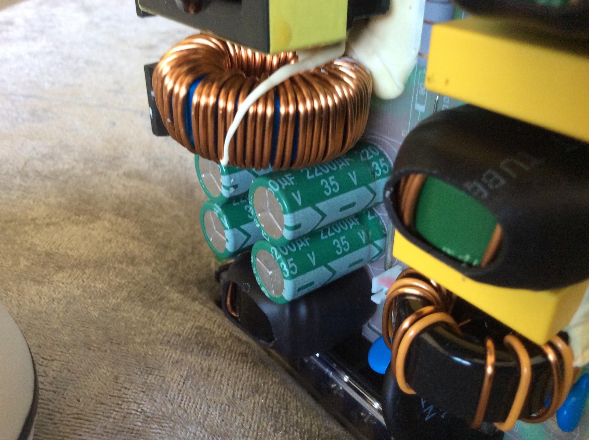

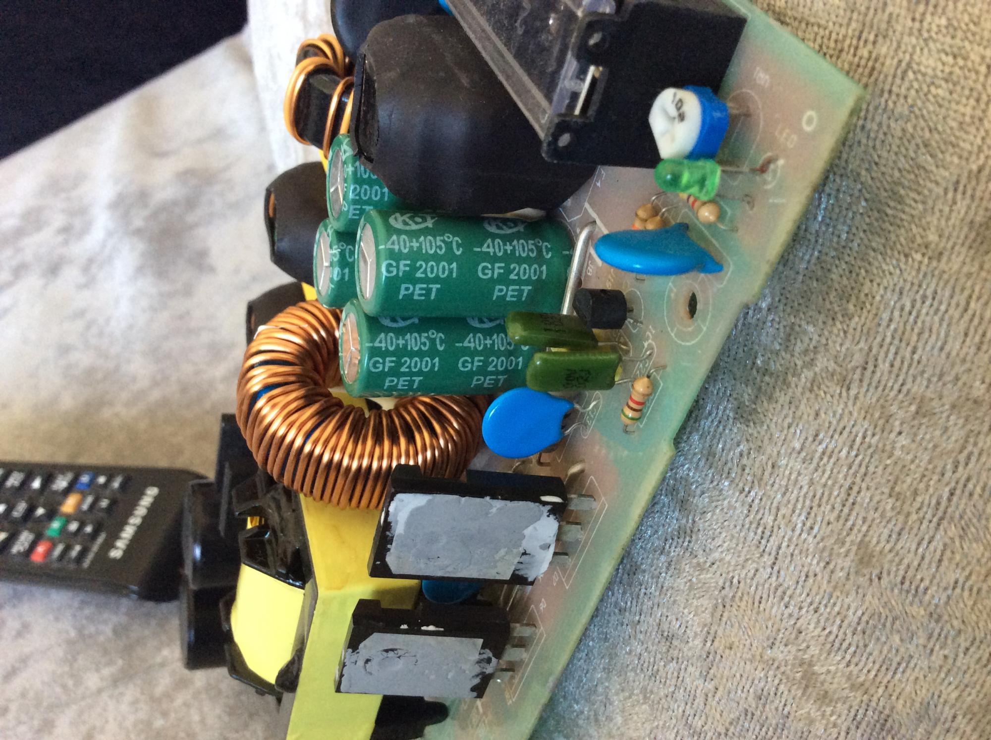

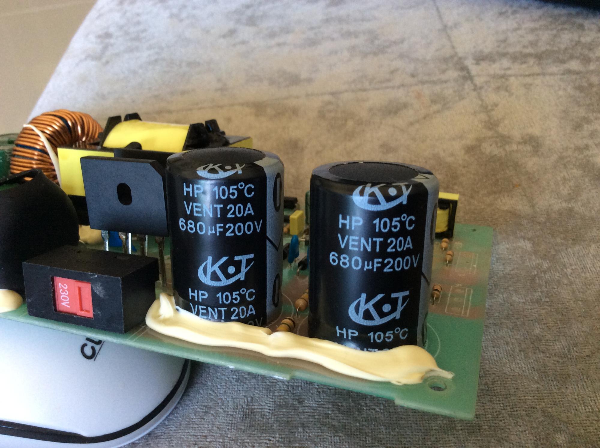

                          Here's the pics of my capacitors. The supply was for a Hictop Idex 3D printer, not CNC/engraver as I originally said.
                            Here’s the pics of my capacitors. The supply was for a Hictop Idex 3D printer, not CNC/engraver as I originally said.

                              Yes these are non brand name capacitors but if they are the main filtering capacitors they might be alright but if they look swollen in any way do not trust them to be good anymore any capacitor that it’s voltage is less than 100 volts I would highly recommend that you replace them with name brand capacitors if they have a UF value of 100 or less replacing these are very important to be replaced
