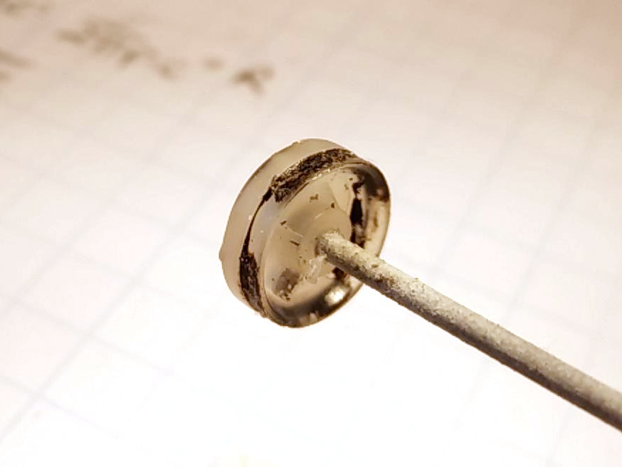

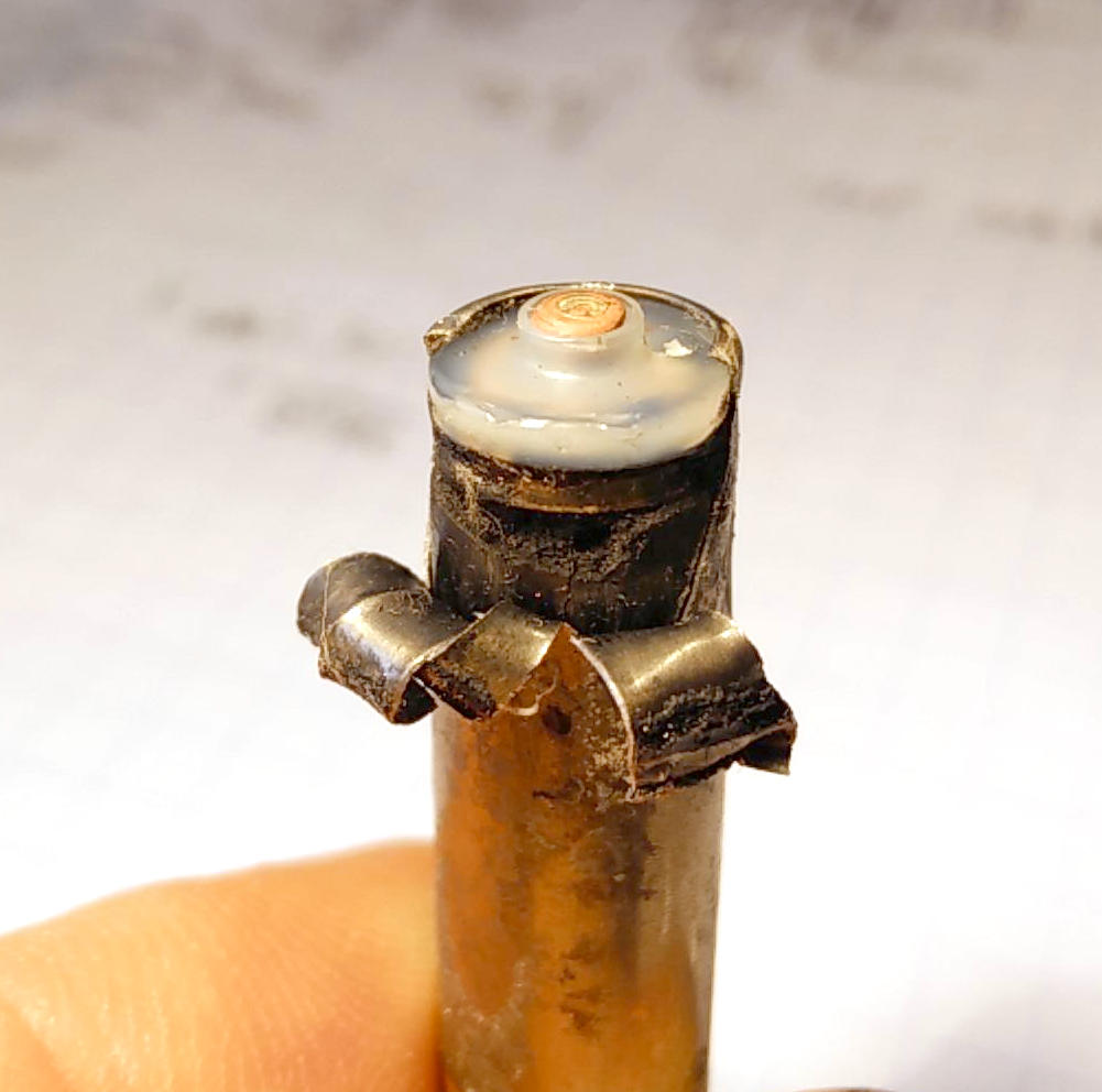

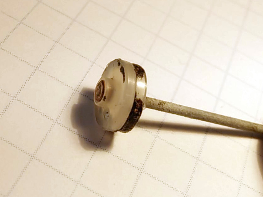

              Re: Has anyone had issues with Rayovac Alkaline batteries leaking
              Alkaline batteries internally make hydrogen gas when they're discharging due to use or storage, or see reverse polarity (imbalanced string). They need to burp.
              Problem is that also spits out caustic electrolyte, which then wicks/creeps along things due to the tiny current leakage of the wet film. The common narrative is all of this was not a problem with old battery's added mercury- which stopped the offgassing. But that ban started in 1996! so say 20 years ago. Rayovac went bankrupt in 2009, $4.4B in debt then Spectrum Brands like another P&G mega-corp has them. So they are just an acquired brand name.
              What's weird today is many alkaline batteries leak badly, but others do not.
              Something nose-dived in the race to the bottom for price. It's like a casino in Vegas. Duracell are the worst- even their "made in USA" ones piss just as well as ones made in Indonesia etc. regardless of lot # or expiry date.
              So that looks like a quality problem has come in. I took one apart and the seal is a polypropylene piston with some bitumen, for Duracell or Energizer. Either the seal is crap or the battery's chemistry makes too much gas, or both.
              Too bad they continue to "blame the customer" instead of fixing their crappy product, and make guarantee claims impossibly difficult.
              Note the government definition of "Made in USA" changed, I expect wording on batteries to get cleaned up. Hear that Duracell and Mr. Buffett?

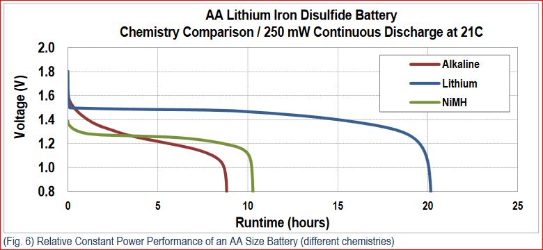

                    The voltage of 1.8 is going to be a problem for digital devices in general the question I have is why does the voltage need to be that high
                      It is not that high, it is just the open circuit voltage.
                      I.e. with an actual load it comes down a bit, check the datasheets.

                        The cell voltage is based on the chemicals used in the battery. Lithium has a high potential, you'll usually see 3.7-4V and here Energizer did get it down using iron-disulfide.
                        I mentioned the 1.8V just to check the device can take it, it's the worst case and only for a short time. I think it would be worse for two battery devices seeing 3.6V as many IC's are rated ~3.6V max. before the higher classes.
                        Fluke does not mind it, the voltage regulators drop it down.
                        The 9V L522 is ~8.4V nominal and 9V peak.

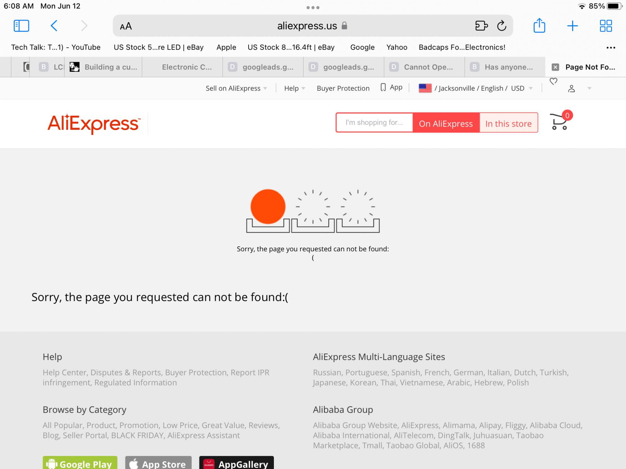

                                        Originally posted by stj
                                        the links work for me.
                                        Here is what I got when I try to open the links that you provided
                                          • 31121
                                          #100
                                          aliexpress.us???
                                          thats not the links.
                                          use a pc or a better browser
