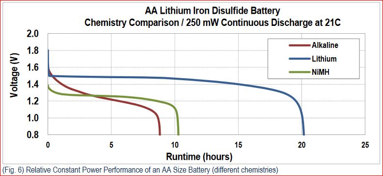

      I took Duracells apart as well as Energizer alkalines, and the seal construction is almost identical. A polypropylene piston-cup with bitumen ring. Many patents on the design so it would be hard to monkey with.
      Pretty sure the leaking is due to getting rid of the mercury for environmental laws. Maybe the tiny bit of tar was also banned. So now the batteries make gas and burp, seep caustic electrolyte.
      I also had the weird hassles with Duracell specific pictures trying to make a claim to customer service. Pic with the battery cover on, then off etc. As if people are scamming them? Wasn't worth it, they expect damage to be at most $20 in a TV remote control kind of thing and it takes $10 worth of my time lol.
      Another option is Energizer lithium LiFeS2. Lifetime is the best, almost 2-3X alkaline. But they cost a lot, almost 2-3 times as much.
      I'm using them for outdoor weather station because they don't freeze and work to -40°C. They are slightly higher voltage, around 1.8Vpc when new at no load or light load 1mA and then it does drop. But it can be too much for some products.
      I noticed there is a 9V L522 that looks really good... but $10 each so 2x the price of alkalines but 3x the life... I would use them in multimeters.
      AA lithium L91 Datasheet and app manual.

                                    Then apply that knowledge to alkaline batteries. Too bad you can't do the same testing with alkaline cells - LOL.
                                    Yes this is LOL but I still think something has changed the way these batteries are made because I very seldom had batteries leak and if they did it not like now it is basically pouring out of them
                                    But this brings to what type of batteries should I use in my Fluke FC 3000 meter because I do not need for this meter to be ruined because of leaking battery damage this meter cost over 300 dollars I do not use it every day but when I need to use I need it to work right when I turn it on
                                    Lucky I caught it before it could do any real damage to the meter however I might not be that lucky the next time
                                    I actually have two of these meters one I use at work and one I keep at home this one I took the batteries out of it the other one I use at work has Energizer batteries in it and I now check it every couple of weeks to make sure it has not started leaking but even with this brand of batteries I might just take them out as well and put batteries in it when I need to use it
                                    When I worked at the other company I would need to use the Bluetooth function of this meter to troubleshoot electrical issues with the overhead cranes and hard to reach electrical controller boxes at the new company I work for now my role is a little different but I might still have to use this meter and it Bluetooth function to monitor something that might be malfunction on a piece of equipment that why I still take this meter to work with me just in case I need to use it for this
                                    I thought about using nicad metal hydrate batteries but there is an issue with doing this and it has to do with the low battery indicator on the meter when this is on the Bluetooth function is a little bit more unpredictable in its functionality in other words it drops the connection or it freezes
                                    I thought about using 4 cells and using two diodes to drop the voltage down to close to 3.75 volts which would be very close to what Alkaline battery cells would have but I wonder if this is the right approach to this issue ( because I bought a bunch of AAA Panasonic metal hydrate batteries surplus and have not used any of them yet they were made for home wireless extension phones ) or using a
                                      I would use Energizer lithiums, they do have a higher open circuit voltage but if you want you can discharge them a bit to get a lower OCV.

                                        maybe do a test to see how low the battery can go and still power the meter.

                                          I did and the voltage needs to be above 3 volt to have at least one bar left on battery indicator if I remember correctly
                                          And you have to have at least one bar left on the battery indicator for the Bluetooth function to work correctly
                                          I also ran the voltage up to 4 volts for a short time and it seems to work ok but I do not want to this because I do not know if the circuity can handle this higher voltage or not
                                          I have thought about running it on a li-ion battery with a drop down diode to get to 3.7 volts or very close to it but my issue is what brand of battery has good quality controls for dependability is the question I would use AAA size batteries so it will fit in the battery compartment and put a charging connector on the battery compartment door
                                          I have found some EBL batteries however there quality is variable at best because I have used there 9 volt batteries that have li-ion batteries in them sometimes you get very good quality ones and last for a very long time and other time the running time is not quite there and ( they do not last as long in terms of they do not charge up to 8.4 volts like they are suppose to )
