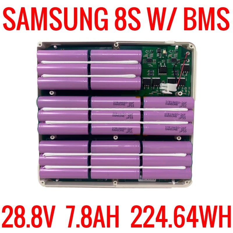

        Damn. It's an off-brand battery pack so who knows what's in it, was meant to be a clone of a name brand tool of some sort.
        But I got an OK from the shopkeeper to bring in a contraption to test it. A multimeter isn't enough IMHO (BTW, the LED fuel gauge reads "full"), I need to load test. now I need to design and build a test circuit of some sort that I can carry into the shop...and hope it doesn't get sold to someone else...

            Minimum I'd have to have two identical headlamps in series and a multimeter I suppose. but I don't have two headlight bulbs. Actually maybe I do but they're halogen capsules that are kind of dangerous to operate outside of encapsulation. Ugh, don't think I should do that.
            This is 0.125kWh/pack. The hope is that it can light two headlight bulbs in series without voltage depression.
            Alas still not close to target capacity, but it is ~ 10Wh/$1 ...

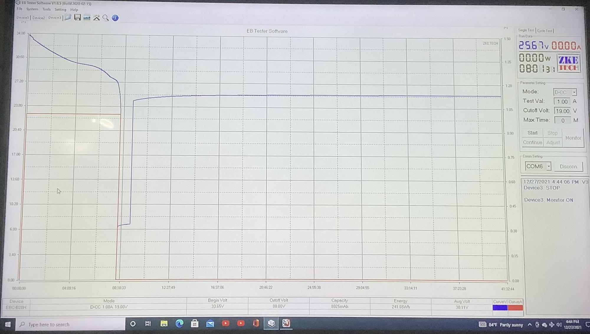

                  Here is an update on these battery packs that I bought
                  This battery pack does give me 7800 milliamperes hours like it suppose to and the BMS protection board does work correctly this battery pack will be used as it for my LED yard light
                  Here are the exact results 7739 milliamperes hours @ 27.001 volts which is close enough to 7800 milliamperes hours in my book

                                Well here is the data on all four battery packs
                                One was 7400 milliamperes hours after cycling them several times before it reaches this point each battery cell 2100 tested separately charging and discharging curves look not very good but battery still can be used in other devices
                                Two were at 7600 after two cycles at 24 volts cutoff
                                One was 7800 was at after only one ( rechecked results) cycle at 24 volts cutoff voltage best performance battery out of the 4 battery packs that I bought
