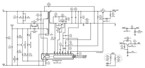

          Would this work
          https://ac-dc.power.com/design-suppo...noswitch3-pro/

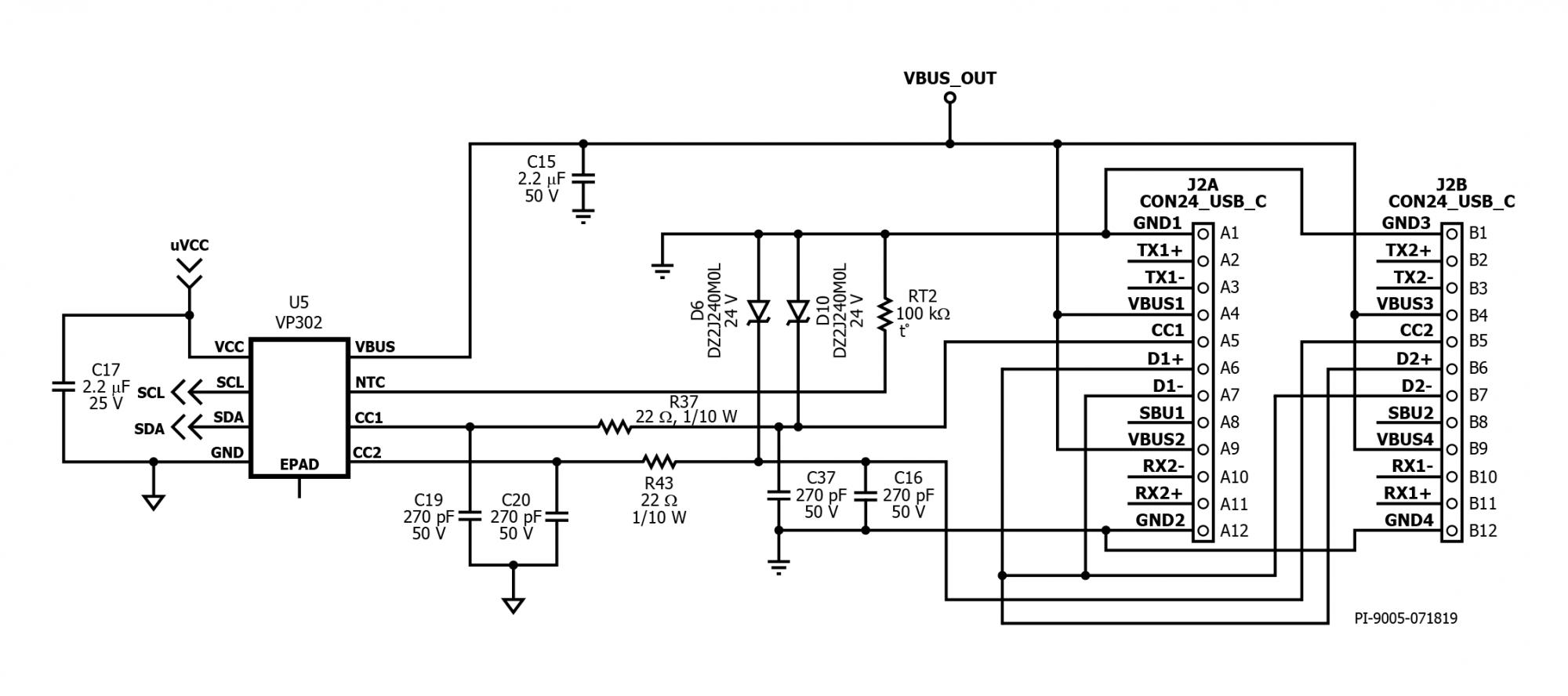

              • Jul 2011
              • 6057
              Re: Multiple USB-C charger brick are there any for sale or do you have to build your
              Originally posted by stj
              where is the rest?
              it has a serial connection.
              I posted the website link earlier there several diagrams for this device
              I tried twice to upload the diagram but it does not want to come out clear to be able to correctly read it but you can see at the website link that I posted earlier

                    • mon2
                      • Dec 2019
                      • 14505
                      If you locate a 100W unit Type C adapter, you will be able to have the range you have listed.
                      These are USB Power delivery contracts. The vendor of the adapter defines the contracts (voltage & amps) for each pair.
                      Then on your mating widget, you are required to negotiate over the CC1 / CC2 lines using biphase communications to 'dial up' the contract of interest.
                      There are single chip solutions to allow for your end widget to select the contracts from ST / Cypress and most likely others.
                      Be aware that the adapter will share the power ratings across their ports. So this means if you want 100W (20V @ 5A) on a single port, then the other onboard ports will NOT be able to support the same output. Often it is a wimpier output due to the above contract.
                      Respectively, if you wanted 4 * 100W of power for whatever reason, then the adapter box must support 400W of conversion to permit any contract on any of the USB PD3.0 port.
