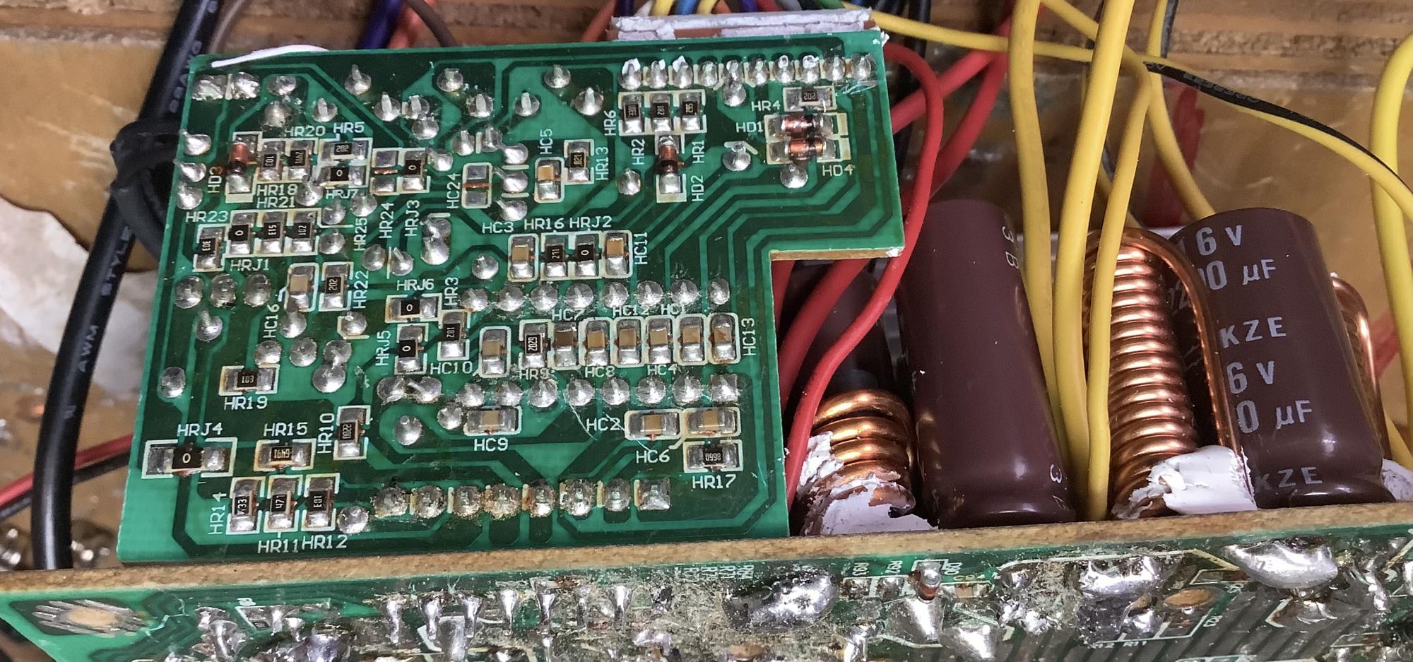

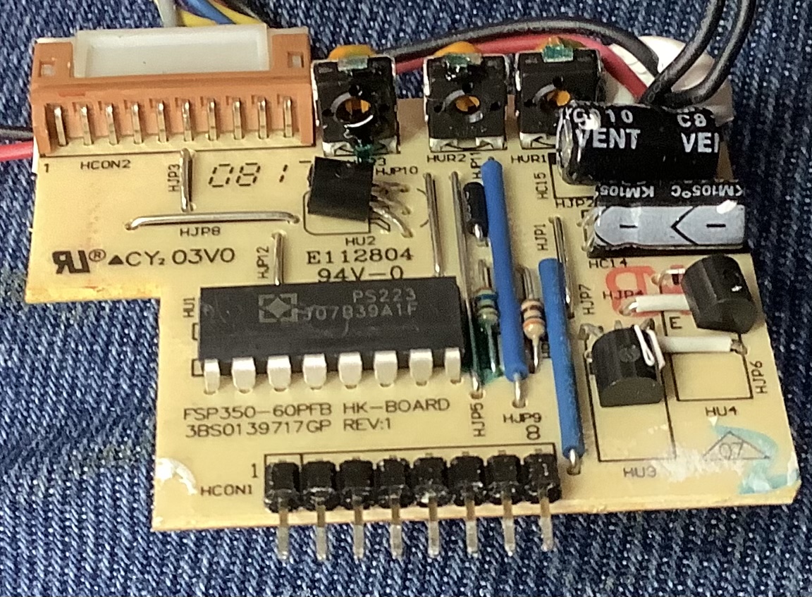

    This ic chip is on a little daughter board with pins to the main board
    This is in a SPI 350PFB with a FSPXXX-6XPFB main board
    This is one of the ones that I have and want to know if the voltage output rails can be modified and if so is there any post that someone has done with this exact daughter board if so can you please post it for me
    This is the little daughter board that this ic chip is on and how it mount to the main board
    If you need pictures of the main board let me know and I will post them

      I think there's confusion with the TPS223 touch sensor IC, and this PS223 power monitoring IC.
      The PS223 monitors 4 voltages for being hi/lo and 4 currents, for 12Va, 12Vb, 5V, 3.3V rails.
      It has the voltage dropping resistors built-in, so you could only increase the thresholds adding a resistor, for that rail.

          The PS223 +12V rail monitor has stock 13.78V over-voltage and 9.05V under-voltage trip points. Max. spec is 14.5V it depends on how accurate the IC is, it's +/-5%.
          Adding a series resistor to VS12A (pin 12) or VS12B (pin 8) to move up the trip points for that particular rail (my math):
          14.5V OV, 9.5V UV with 10.4k ohms.
          14.6V OV, 9.6V UV with 12k ohms.
          14.8V OV, 9.7V UV with 15k ohms.
          If you are making a battery charger, it might undervoltage trip into a dead battery?
          I thought you could put a 12V and 5V winding in series to get more voltage, I'm not sure you can go from 12V to 14V with much current. Most 12V SMPS do not crank up to 14V at full output current.
          The adjustment pots look like they're for the fan control? I would need bits and pieces of a schematic to see what the pots are about.
          Usually the PSU regulation is a hodgepodge summary of the high current rails. So an IC looks at +12V, +5V , +3.3V rails and regulates based on those. The -12V rail is low current, not so important I thought. Might search for the PSU schematic or something similar to see how that's done.

              To change the output voltage, it's two things to mod. The Supervisor trip points for OVP/UVP, and the voltage regulation loop.
              I think the hardest part is the regulation loop, if it uses a TL431 or just mixing resistors to the SMPS IC for sampling the main three rails.
              elecktrotanya has some FSP schematics.
