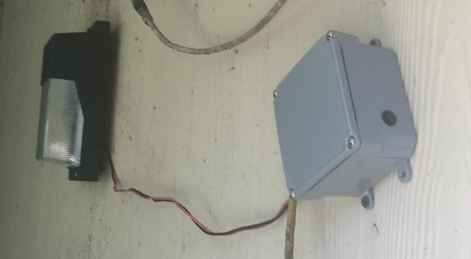

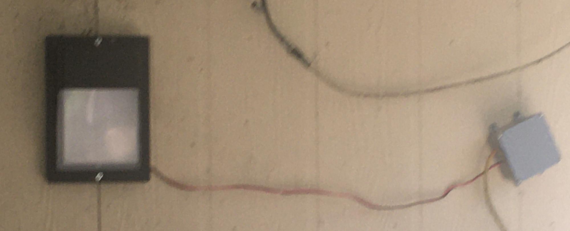

Honeywell 42 watt having on/off issues under over hang solved
    • Jul 2011
    • 6057
    I bought several of these lights and the other two work fine but the one under the over hang would turn on/off issues because of the light bouncing around on the metal ceiling
    I first tried moving the photo diode but it would not turn off the light for some reason so I just made the power wires longer to the LED panel and this solution worked
