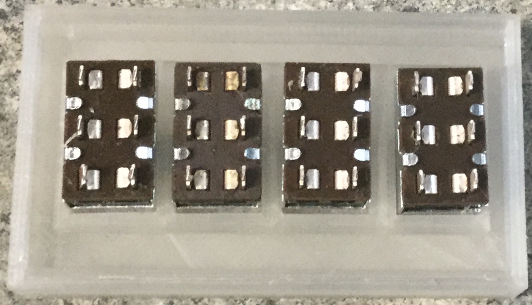

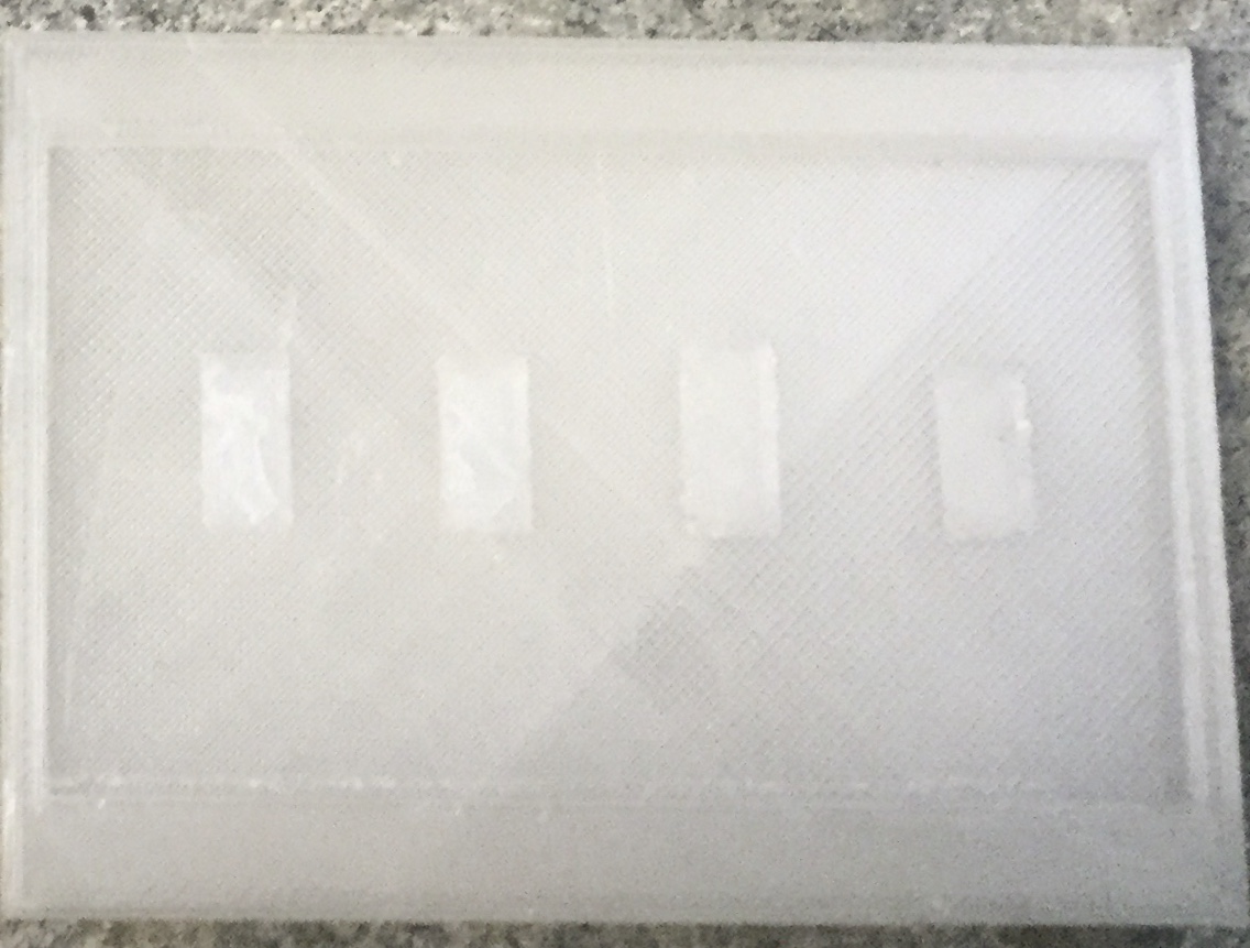

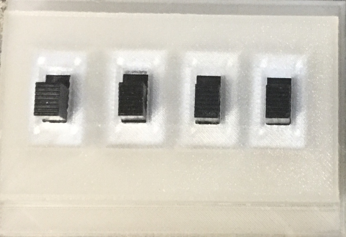

              Well I now finally finished the switch enclosure that I was working with the 3D printer it came out pretty good not perfect but workable
              One thing I had to do is trim the terminals on the switches so the enclosure would come together
              The switches in the enclosure are a little bit loose but but not terrible I will not need anything to keep them in place
              The back cover I tried to do something that did not work correctly
              Some how the slicer did not slicer did not compile the top part correctly I stopped the printer before I could not salvage the part
              This is for the engraving machine that I am building
