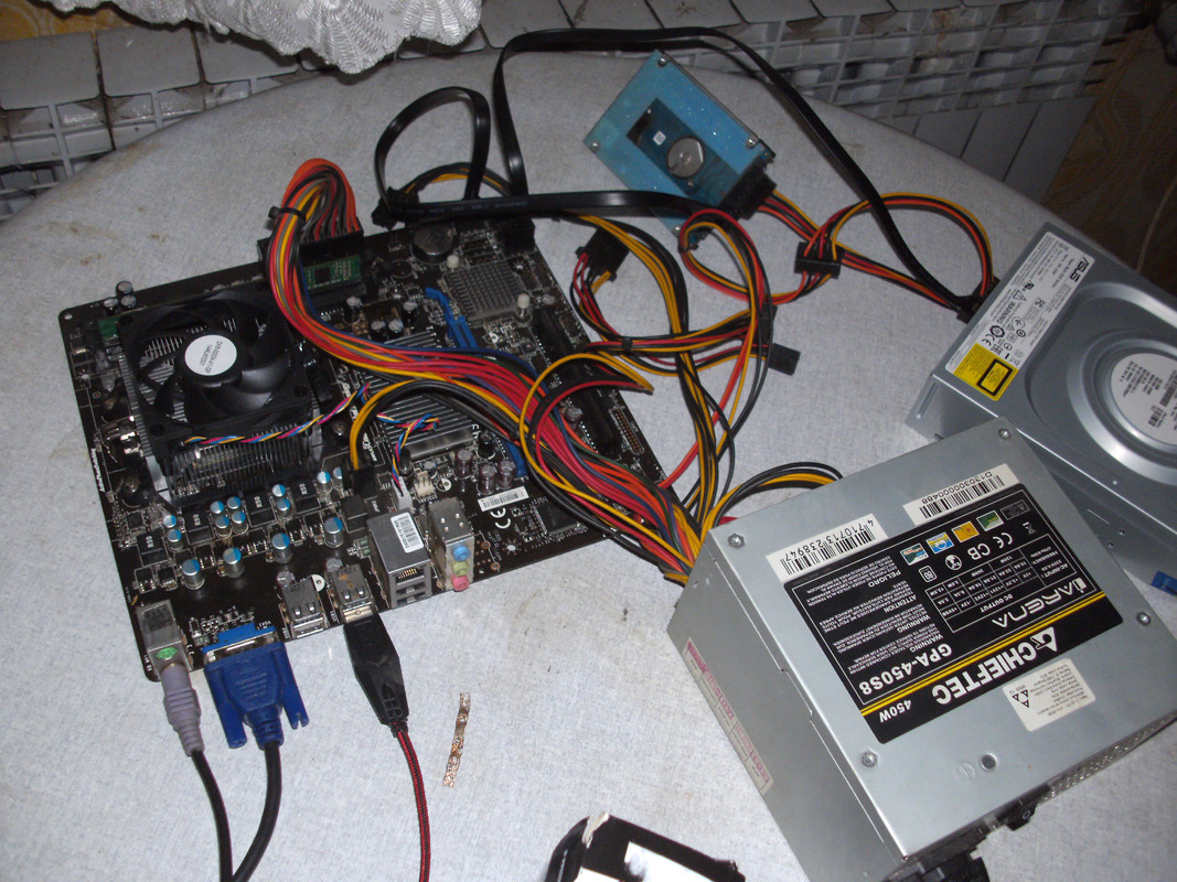

                              Re: Behavior of Faulty IC's
                              Im repairing a motherboard right now The FX 760GM-p21 , I have found a faulty MOSFET with markings P0903BD , ITs the mosfet next to the CPU slot, so I removed it and sure enough its shorted all the way with 0 ohms across all... I have replaced it with AOD408 Which i hope one of you could clarify for me if that is a viable option... Now about the short i was talking about... SO there is a powersupply next to the northbridge , and that powersupply is shorted together , i mean when i go across the caps they are shorted together for like 15 ohms.. Now , i do not intend of messing with that area for now as i believe that i have found the main problem which was that mosfet... But should the northbridge psu be shorted with 15 ohms when turned off?
                              Anyway hope i get some feedback on that mosfet replacement thanks all
                                Also i found only 1 cap close to the NB that is shorted for 0 Ohms , and that cap is on the chip itself (next to the IC DYE) wonder if i should turn it on as it is to just see if it gives any sign of life?
                                  Now that is interesting as I also have a north bridge with a 0 ohm short across one of the capacitors on the die and I am also trying to find out if that is actually faulty. Mine is a completely different chipset to yours though, it's Intel X58.
                                    Honestly if you found one cap on the dye shorted aswell then that gives me hope to think that that is normal.. I think you might have problem elsewhere.
                                    • sigmeyer
                                      • Feb 2020
                                      • 147
                                      • Serbia

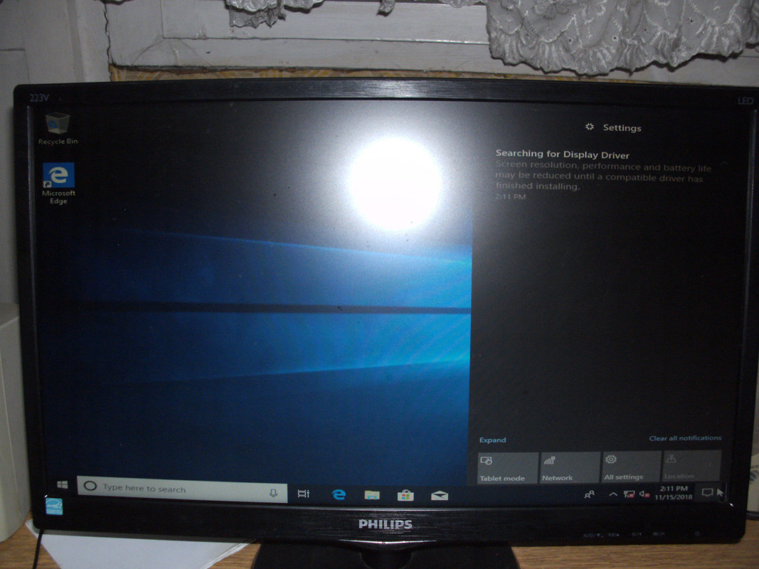

                                      OK so i turned on the motherboard and it exploded ....
                                      JK its working fine, seems to like the new mosfet i put in there...
                                      I installed new windows 10 and it booted with no problem ... I will upload some pictures tomorrow just so you guys know im a real person repairing real problems, incase someone would think im not hehe
                                        Here is the motherboard set up that i had going on... Luckly everything was working fine and the motherboard is good, i just have the part of plastic that holds the cooler in place broken off so i thought of fixing a manifactured part of plastic (made bby me ) stuck on there with hot glue ? has anyone ever done this?
                                        anyway heres the board and the first Windows boot
