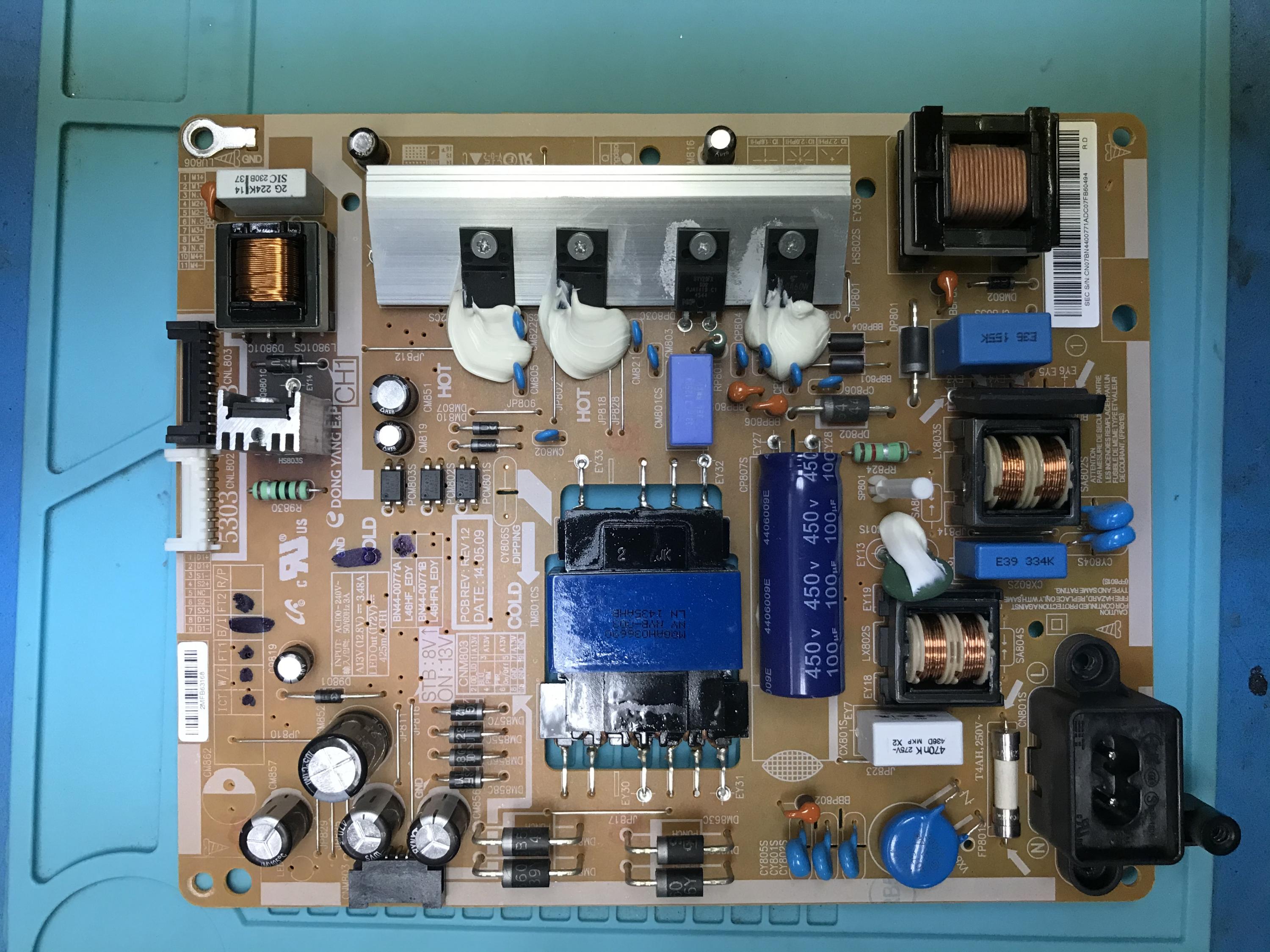

    Good morning Badcaps!
    I'm looking at a Samsung UN46H6201 smart TV from December 2014. 42 of the 44 backlight LEDs were shorted out. I replaced all of them, but the backlights don't turn on (each strip tested OK with my LED tester). I have a feeling it's the backlight driver on the SMPS that is bad.
    The power supply board is BN44-00771A. The led driver package is an SOIC-8, but I cant find the datasheet for it. Would someone happen to know where the datasheet is?

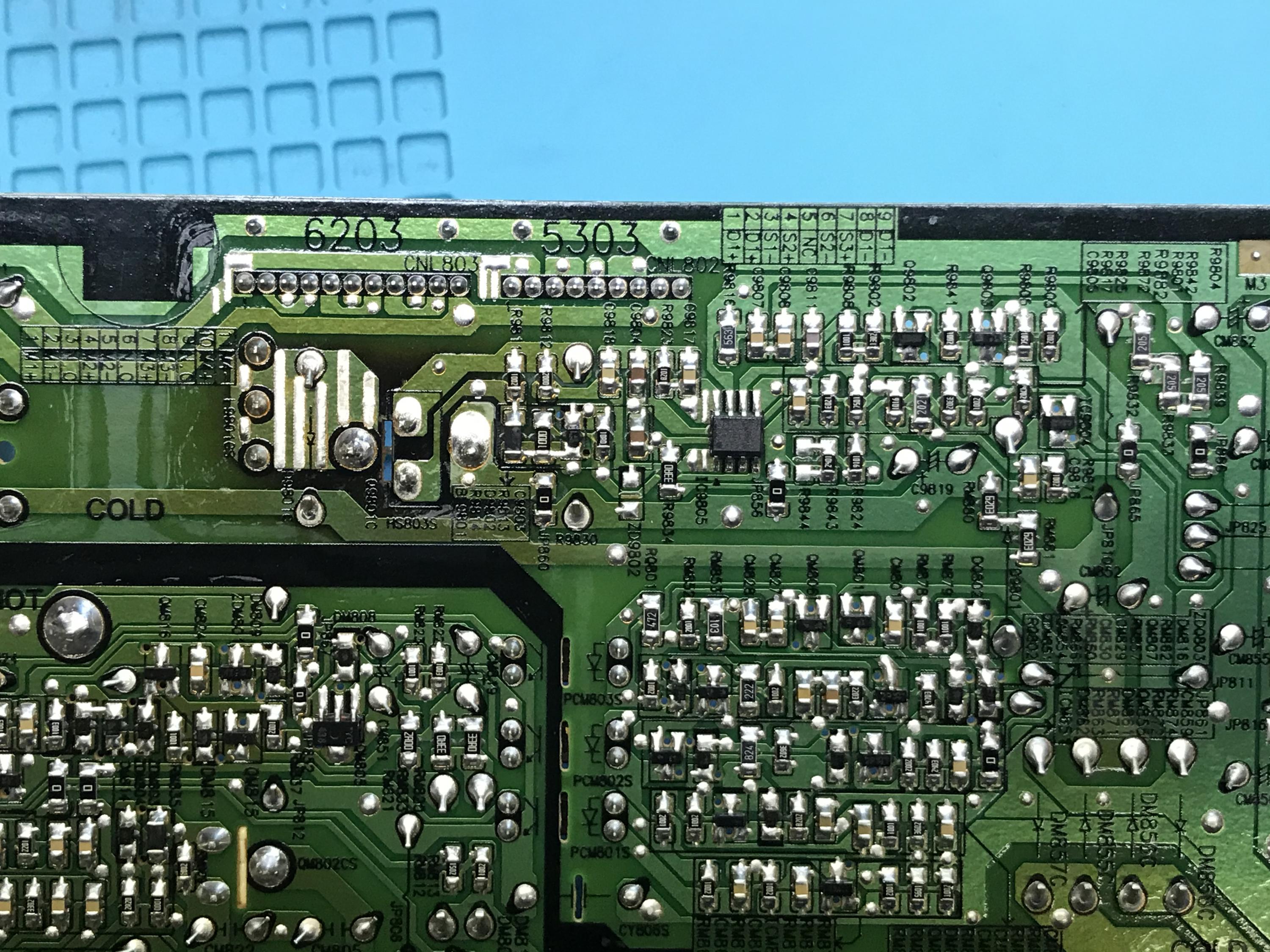

    The backlight driver (on the back) is labeled:
    7014X
    1438
    K6D
    Pin 1
    Pin 2
    Pin 3 - GND
    Pin 4
    Pin 5
    Pin 6
    Pin 7
    Pin 8

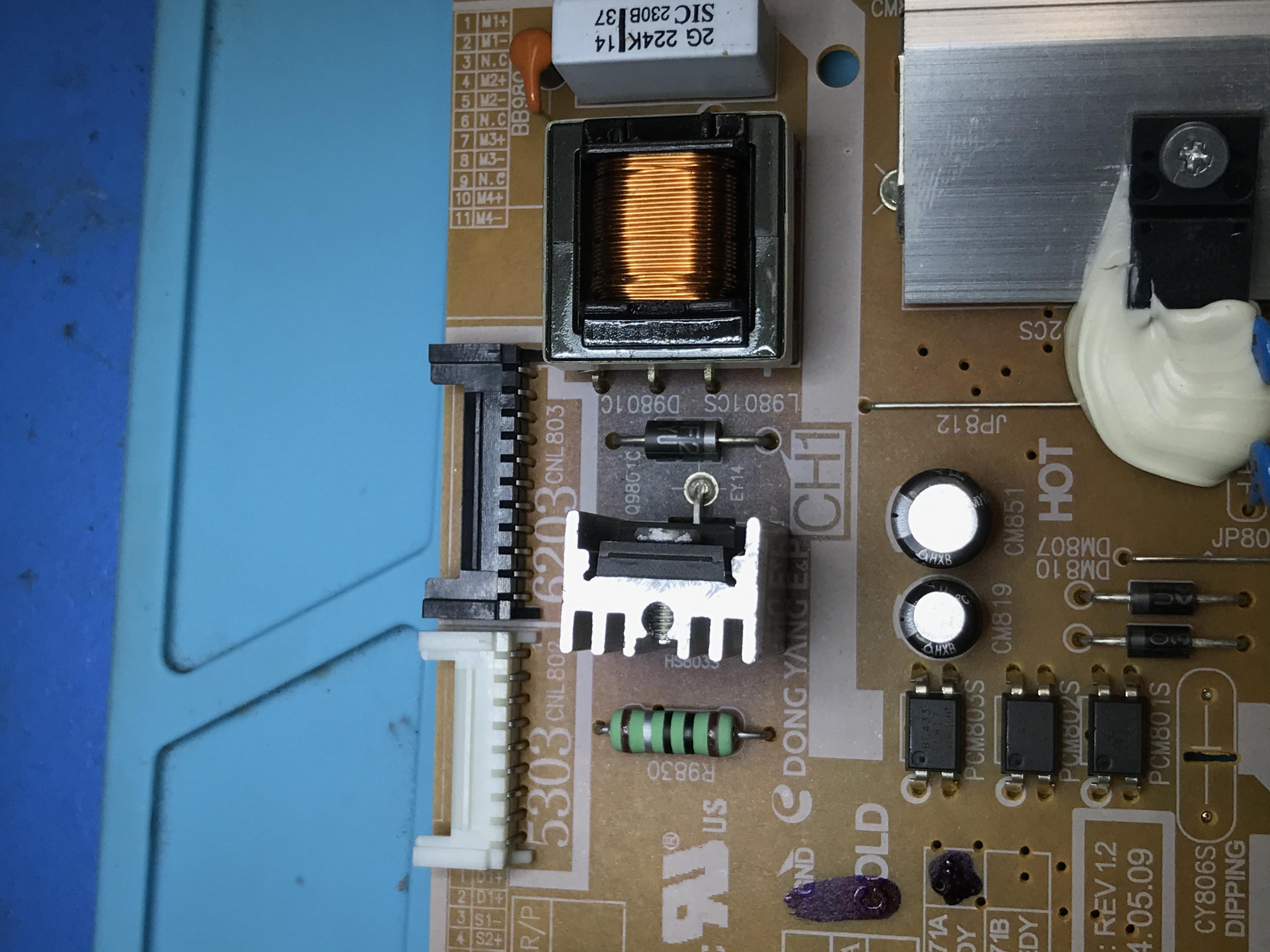

    On the top side, there is an N-FET (TK8A50D) and a diode (SF23G) that has darkened the PCB. I removed them out of circuit to test - the N-FET does not appear to be shorted, nor does the diode. These were correctly identified with my parts tester.

    Re: Need help to identify "7014x" SOIC-8 LED driver

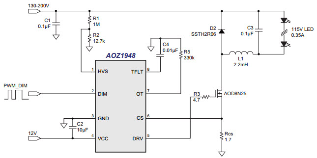

    I have found that the MAP3511 may be SIMILAR, It may not be a direct replacement. Check the voltage on CNL803 pin1 when you first turn on the tv.

          This is what i get on CNL803. All measurements taken relative to the chassis ground.
          Pin 1 - M1+ == 233V
          Pin 2 - M1- == 206V
          Pin 3 - NC
          Pin 4 - M2+ == 206V
          Pin 5 - M2- == 180V
          Pin 6 - NC
          Pin 7 - M3+ == 180V
          Pin 8 - M3- == 155V
          Pin 9 - NC
          Pin 10 - M4+ == 155V
          Pin 11 - M4- == 233V (?!?)
          The backlights are wired with four strips in series.
          I double checked the connection on Pin 11 - it is really sitting at 233V.
          Diode D9801C (next to the N-channel FET) shows a voltage of 233V on both sides.
          The same with the diode - it's 233 volts on both sides as well.
          Assuming the MAP3511 is a representative circuit, then that diode could be bad possibly? I'll pull the diode and test it out of circuit.

            *Note, in post #1 - I'm re-reading post #1 - I incorrectly stated that I tested the diode out of circuit. It was only the N-FET at that time.
            I pulled the diode and tested it. In diode mode, i get +0.6V with the positive lead on the marked (cathode) side, and +0.4v with the positive lead on the anode side. The resistance through the diode is approx 740kOhm with leads in both orientations.
            The SF23G appears to be a 2A, 150V diode.
            Looks like i have a SB5150 (5A 150V Schottky) in my parts bin.
            -Thomas
            I'm a hardware engineer focused on networking equipment for my day job. I void warranties and fix consumer electronics for fun.
            • ngth82
              • Jul 2015
              • 541
              Yep, it was a bad diode. 10 cent part...
              At least i can start reassembling the panel and get most of the stuff off of the floor!
              As always, thanks guys!
                Samsung uses a lot of that topology for the backlights driver, AOZ1948 also the same topology. That diode seems to fail a lot with bad leakage resistance in that circuit.
                Glad you got it fixed.

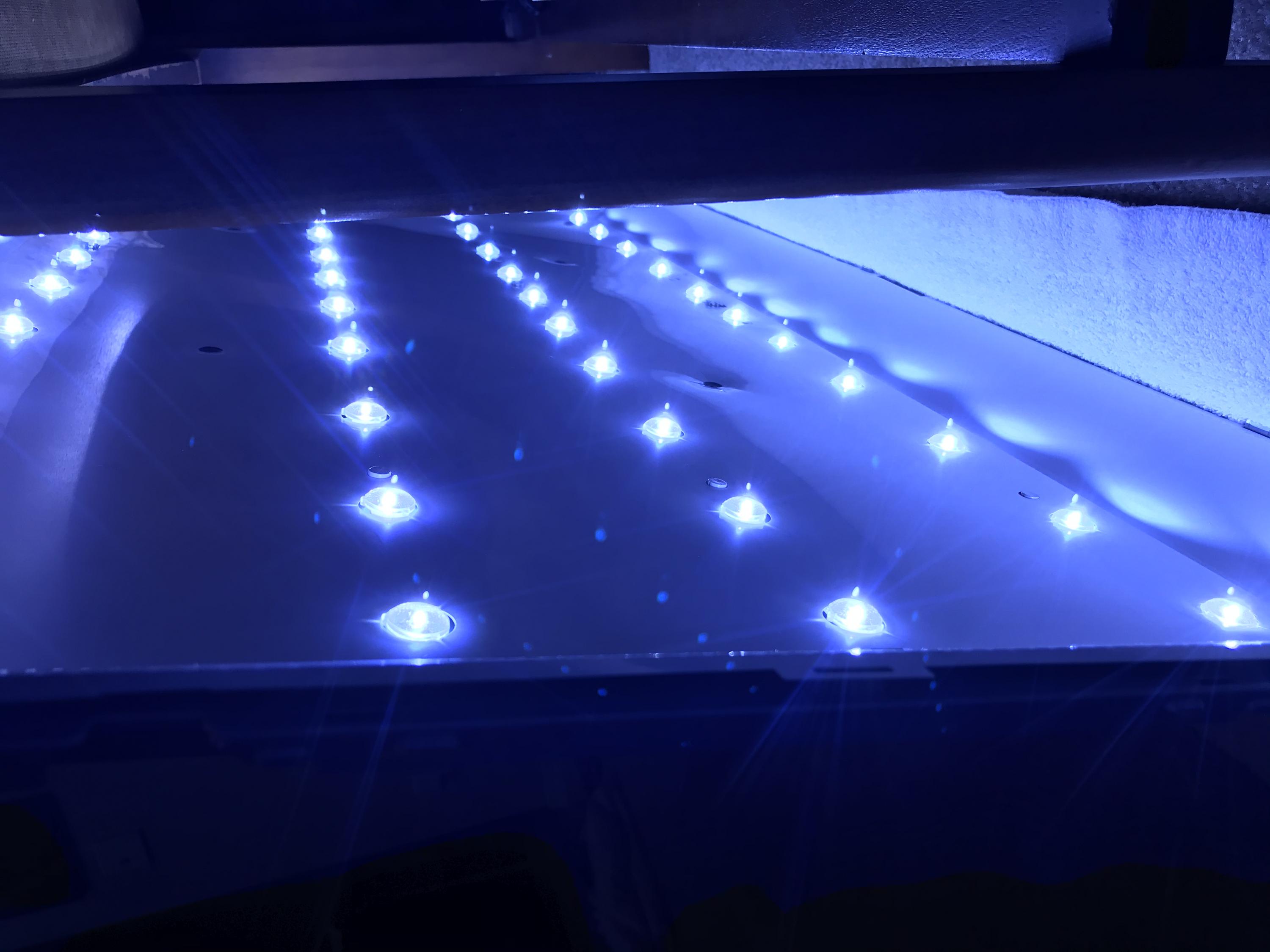

                    Well, maybe i spoke too soon.
                    I turned on the TV for the second time and the backlights were off. I looked closer with the room lights off - the backlights are barely on - biased just enough to see a faint glow on the TV in a dark room. I'm able to barely make out the contents on the display as well. The backlight PWM signal is sitting at 2.5V - this should be plenty bright at that value, but what i see on the screen and through the chassis holes is almost nothing.
                    The input voltage to the LED connector is sitting at 200 something volts.
                    I'm able to get the display to come back to full brightness when i change the picture mode to something else (e.g. standard, movie, dynamic, etc).
                    When i turn the TV off, and back on, the same thing happens.
                    Interestingly enough, if i disconnect the power cable to the main board, the backlights come on at full brightness - every time. Maybe this is a timing problem with the PWM signal. I can likely just bias the PWM at 2.5V with a resistor divider and call it good.
                    I'll see about spending additional time on this over the next few days. Firmware update first, then followed by additional debug. At the very least, the LEDs are good now.
                      I just ended up disconnecting the PWM signal from the main board and biasing it at 2.5V. This appears to work over the last 10 hours that i had the TV on and with several manual power cycles during that time.
                      The side effect is that the backlights are on prior to the main board/T-Con driving a valid video signal. You see "garbage" on the screen for a brief period of time during the init, then the SmartTV logo appears.
                      The same is true for powering off - there is some static / "garbage" that you see on the screen when normally the backlight is already off. The SMPS powers off some seconds later.
                      The unit seems to be good to go. This will replace one of the sets in the house.
                      I picked this up for $20, and threw $5 of replacement SMT LEDs at it. Not bad.
