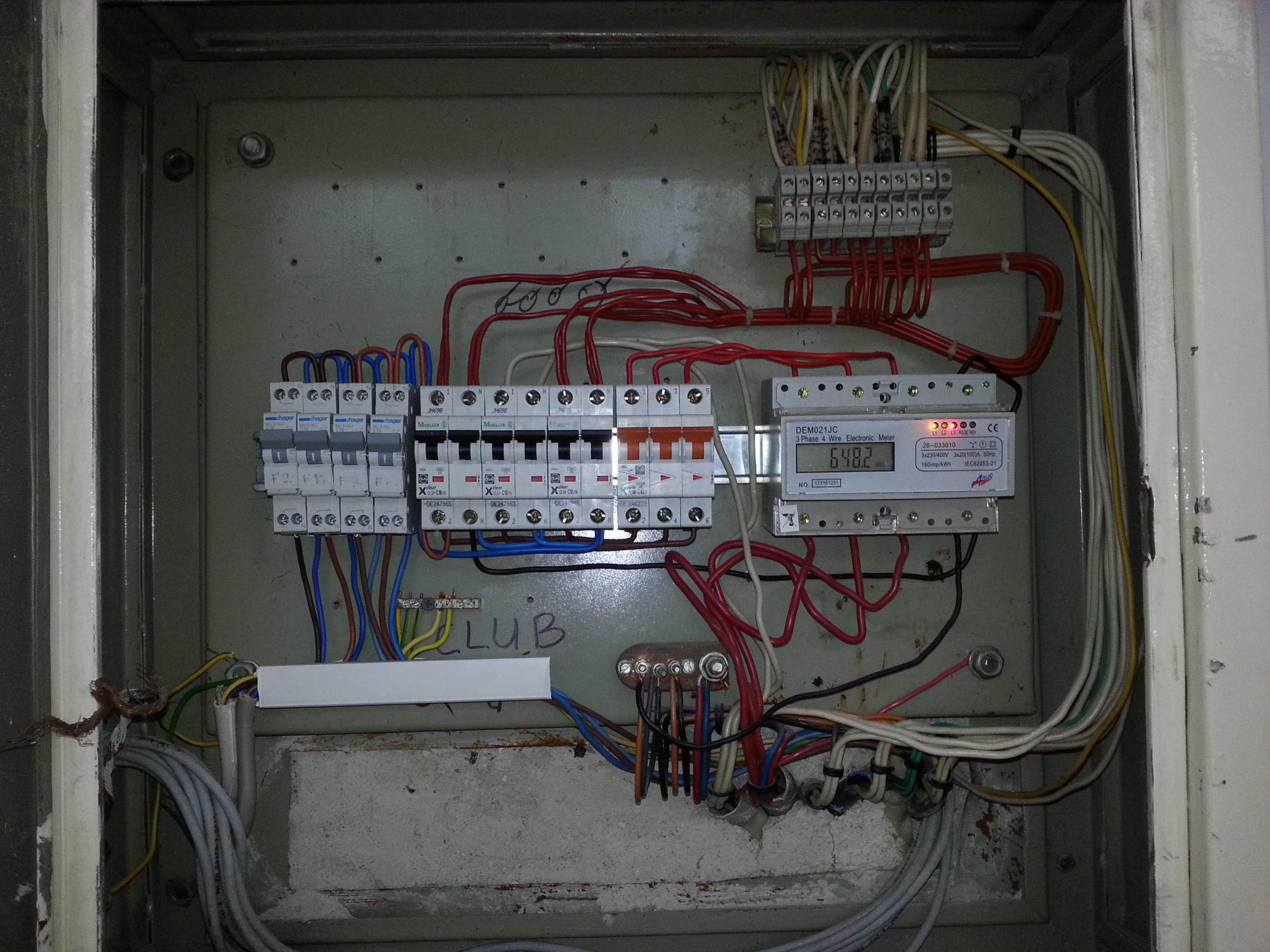

    Connecting Neutral/Earth together

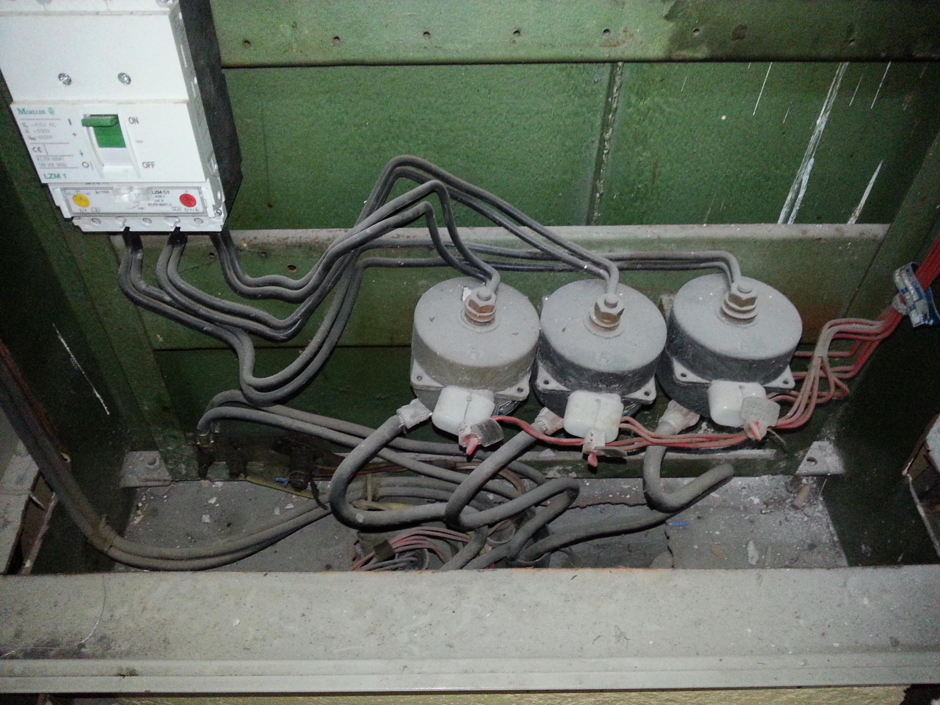

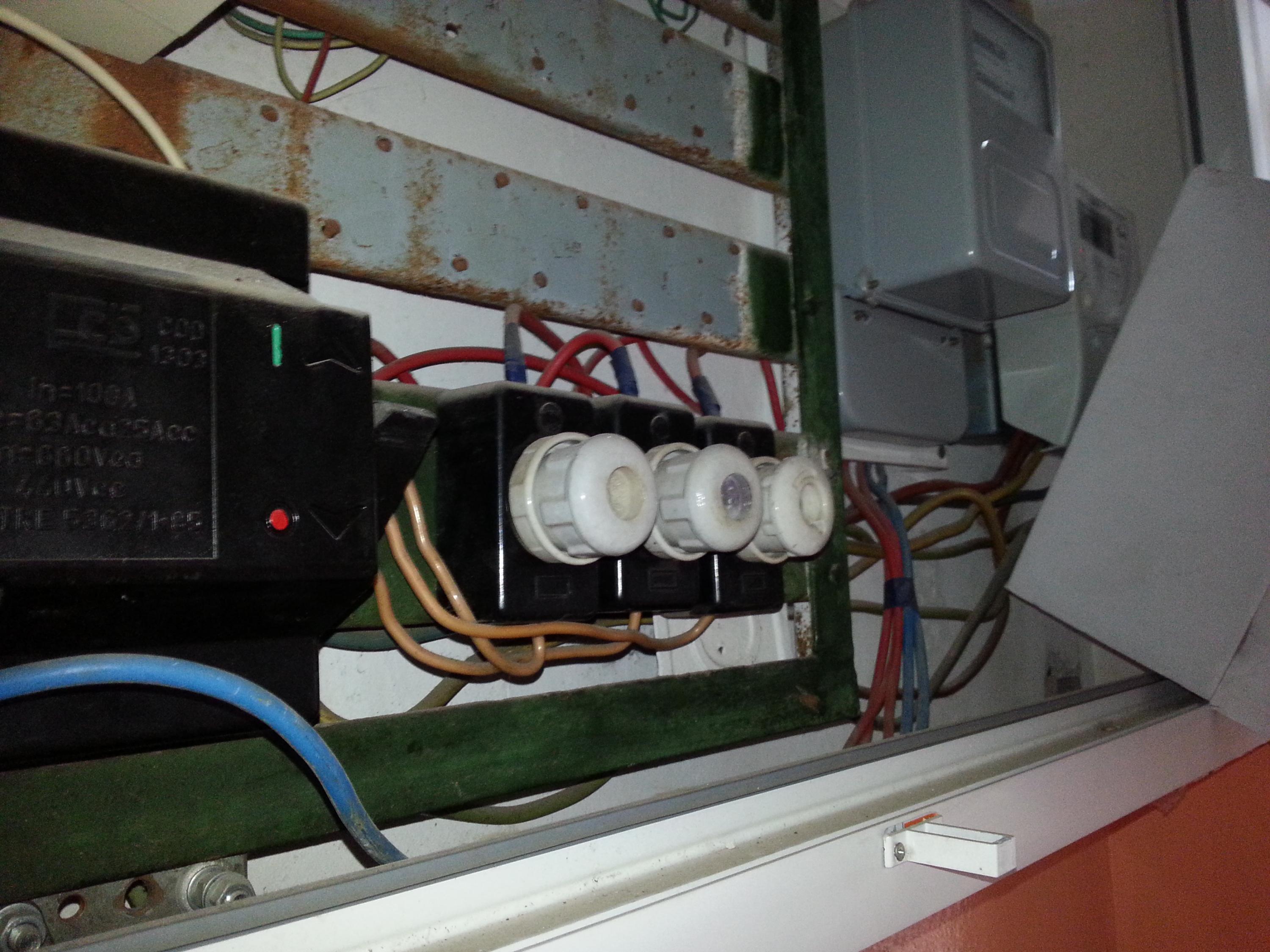

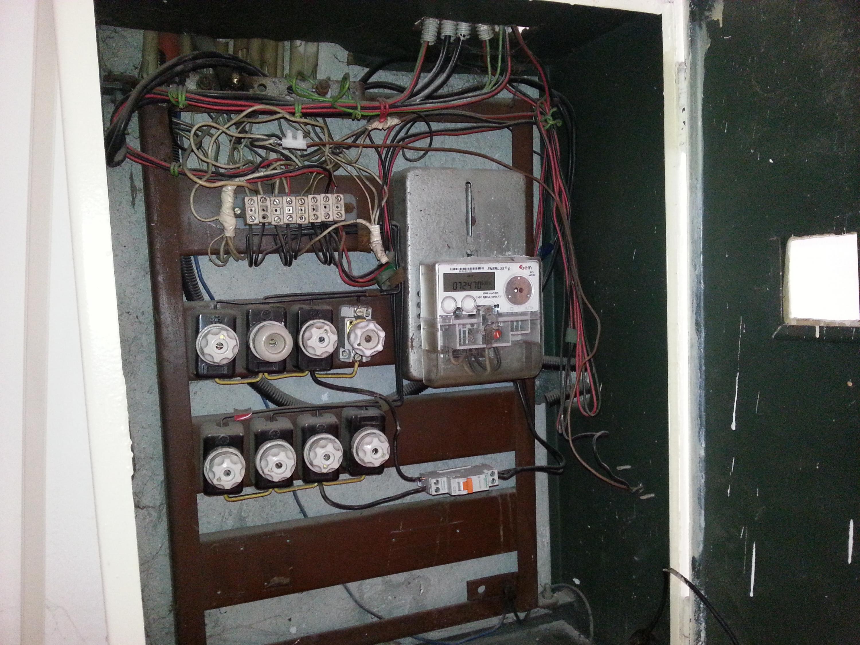

    Good day folks. Recently my company has, in a kinda-sorta-way, nominated me to join the "security systems team" which involves going to various sites to install alarm systems and CCTV cameras...not the best of positions, since I've gravitated pretty far away from my beloved laptop and electronics repair, but at least the pay is adequate (enough....for now) and I'll definitely be moving back to those once my boss decides it's the right time, but I digress.
    The reason I'm asking about how mains grounding works is because more often than not, I have to connect up the alarm panel's mains supply directly to a distribution box rather than an outlet with a simple plug-socket and this involves playing electrician and playing around live wires to a pretty good extent....which I don't really mind, it's fun as sh!t for some reason Feel the danger !
    Anyway, having opened up a couple of distribution panels so far, some of which were rather old and messy as you can see in the example pictures below (some even going as far as still using ceramic cartridge fuses, even blown ones at that, with pieces of wire jammed in them to revive them!), I had a bit of trouble properly identifying the neutral from GND (earth), or rather couldn't tell which was the safest way to connect these up.
    Some had a flat earthing bar coming into the box, tied to the metal chassis which holds all the fuses/MCBs and all individual earth wires running to the outlets were tied to this, which was the easiest and IMO safest thing to work on, with three separate connections: L to L, N to N and E to E - simple, consistent, perfect (panel in the first picture was like this, despite being a mess in terms of everything else, including those "reused" fuses I mentioned).
    Then there were others where the chassis had the N wire tied to it, making things a bit......confusing. I know it's "neutral", but shouldn't this be separate from E ? For this reason, I hesitated a bit when touching the metal case of the alarm system after the first powerup When I first encountered this setup at one of my sites, I didn't even connect the GND wire for the panel, thinking it'd result in an unsafe setup if the wires were somehow swapped and the chassis became fully hot. Panel in the second picture had this "combined" setup - notice the long green wire leading into the white box of MCB: this tied all the neutral wires to the metal chassis and that earth bar which was somewhere in the bottom-left of the panel. I was actually planning on removing this piece of wire when I did the install there to make it like the first one.
    This last one I did today was the most interesting so far: a 380v three phase panel, because the building also has a small elevator. Of course, I didn't quite care about that, since it still broke the phases apart into the more manageable MCBs we're all used to as you can see in the third pic after the BIG breaker and ceramic fuses which I couldn't quite figure out what they do, especially since it had some sort of weird two-meter configuration, presumably sharing the costs with another company or some junk....This too had earth tied to neutral. Electricians might spot this, but you can see all those MCBs in the picture, despite being on separate phases, all end up with a small common blue piece of wire back to the earth bus bar at the bottom of the box where the green wires are, which is presumably the star point of the three phases. This again didn't seem particularly safe TO ME, though in the back of my head I was certain nothing would happen, since it wouldn't be done otherwise and would pose a hazard for ALL earthed equipment in this building like washing machines and fridges, so this time I DID wire my alarm's chassis to that common N/E bar (white wire coming in through the top of the MCB box and snaking around the right, near the screw post and back up to the top of the "tripped" MCB).
    Wikipedia was very helpful in clearing up some of the mystery that to this point I always thought was some idiot's unsafe idea of tying E to N willy nilly, but still: any electricians in the house ? What are some of the dangers and precautions I faced here ?

          Re: Connecting Neutral/Earth together
          Neutral is return path for electricity in a electrical system. At the panel it is bonded to earth ground.
          They are at the same potential. neutral is meant to carry the unbalanced current of the live wires. 3phase or split phase. Only difference is ground wire is to carry the fault current. Its meant as a protective wire.
          In canada/ USA when subpanels are wired up, we remove the bonding jumper so there is no current flowing through the grounding conductor.

            normally neutral and earth are together at the main panel only . am sure i read once on farms where the animals were getting shocked they tied neutral and earth together further down the line nearer to the animals drinking troughs . struck me as an odd thing to do though .

                neutral and earth are joint together only at the main fuse panel.

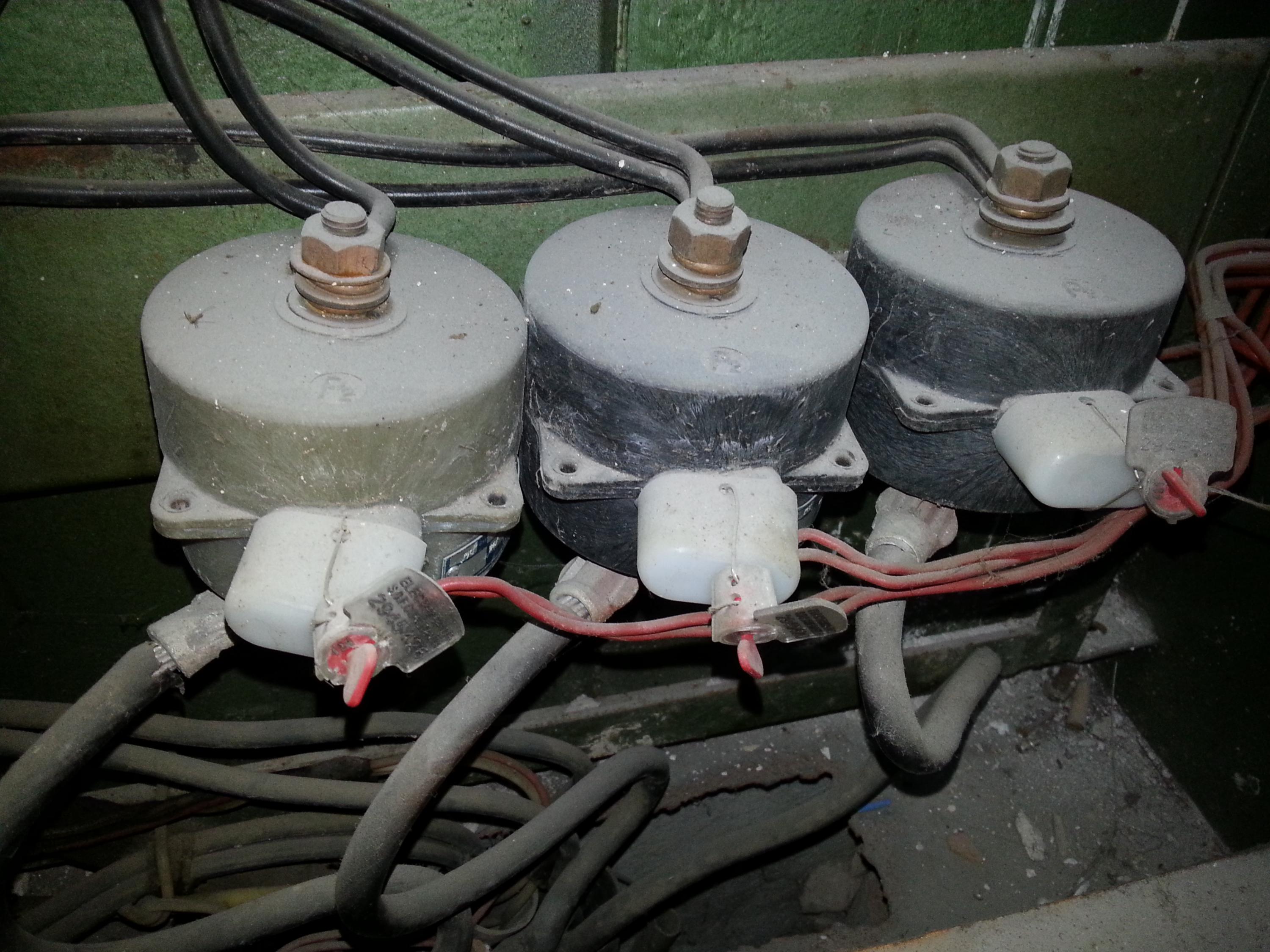

                  Here's more of my "discoveries". This one was today, though I only popped it open out of curiosity like I always do, since my workmate the electrician had already wired the extension cord for the alarm panel for me here (the lone white multicore wire). This one was a bit interesting because it had a partial makeover relatively recently, since it's rather tidy in there and the enclosure itself is new and more like what you'd see in this century, as opposed to the others I've shown you The large breaker at the bottom is new, the GPRS(?) remote-access electric meter is new (has a small antenna sticking out ), the MCBs are new, however, I can tell that the green mounting chassis is STILL the original one, dating back to when ceramic cartridge fuses were in use, as you can tell from all those mounting holes placed diagonally from one another - these would accommodate those E26 (?) sockets for the ceramic screw-in holders that held the cartridges (there's a couple of these in the other pics). From what I can tell, what they did to preserve the chassis, they cut into the old box with an angle grinder enough to make room for this cabinet, which is actually just the door and the surround, with no backing, so they could just slip it over the whole panel to cover the guts. It's a bit smaller than the original, since there's still a bit left of the old one at the top/bottom. It's like forensics, I love this stuff more and more
                  I believe this one also uses the "TN-C" system as they call it, whereby the earth bus bar at the bottom is also tied to the neutral star point...makes sense.
                  Those cylindrical drums at the bottom caught my attention. I didn't know what they were at first, but by using my brain a little I think I can safely say they're current transformers for the meter. These new "smart" meters don't have the phases running straight through them, but instead employ these "remote" CTs, clearly shown by how there's no thick wires running to the meter itself, unlike in the other 3 phase system (with the 3 ceramic fuses) where the meter DID have the three phases running directly through it. Fascinating stuff, don't know why There's something about old electric panels that fascinates me, or a combination of old and new technology like this...figuring out what used to be there and what's been removed or added or modified....makes the brain tick

                    • 31246
                    GPRS = 3G
                    put a staple through the antenna cable
                      I reckon the "execution squad" would show up to inspect what happened when it loses connectivity Otherwise it would be WAY too easy to sabotage. Better yet, hack those CTs somehow
                      Wattevah...
                        • 31246
                        yes, those inductive sensing coils are a nice target!
                          Yeah, stealing power, especially for (large) businesses, is a dumb thing to do IMO. You'd get busted before you know it. If you reading stays the same for months on end, someone is going to catch on eventually. It's not like it's a small country cottage where you might argue that you don't indeed use any electricity at all. If you're running a 3 storey tall building, complete with elevator, there's no way in hell that thing's not using a single extra kW a month, I guarantee it, so the only thing that comes remotely close to hacking your electricity bill would be to just slightly modify the reading of the meter, so it reads less, but doesn't stop entirely....unless you're doing it legally, which involves having your own generator or wind turbine. That's not the ideal scenario in the middle of the city, is it ?
                          I imagine if you just cut the wire to one of those CTs, the panel can sense it (plus you'd get busted upon the first inspection which happens every few months here AFAIK). However, if you're somehow able to alter the induced magnetic field, that would make the meter read less I imagine....I dunno...guys, help me out here - I want some free kWs
                          EDIT: I looked up that 3g meter out of curiosity and it's apparently a Honneywell Elster AS1440

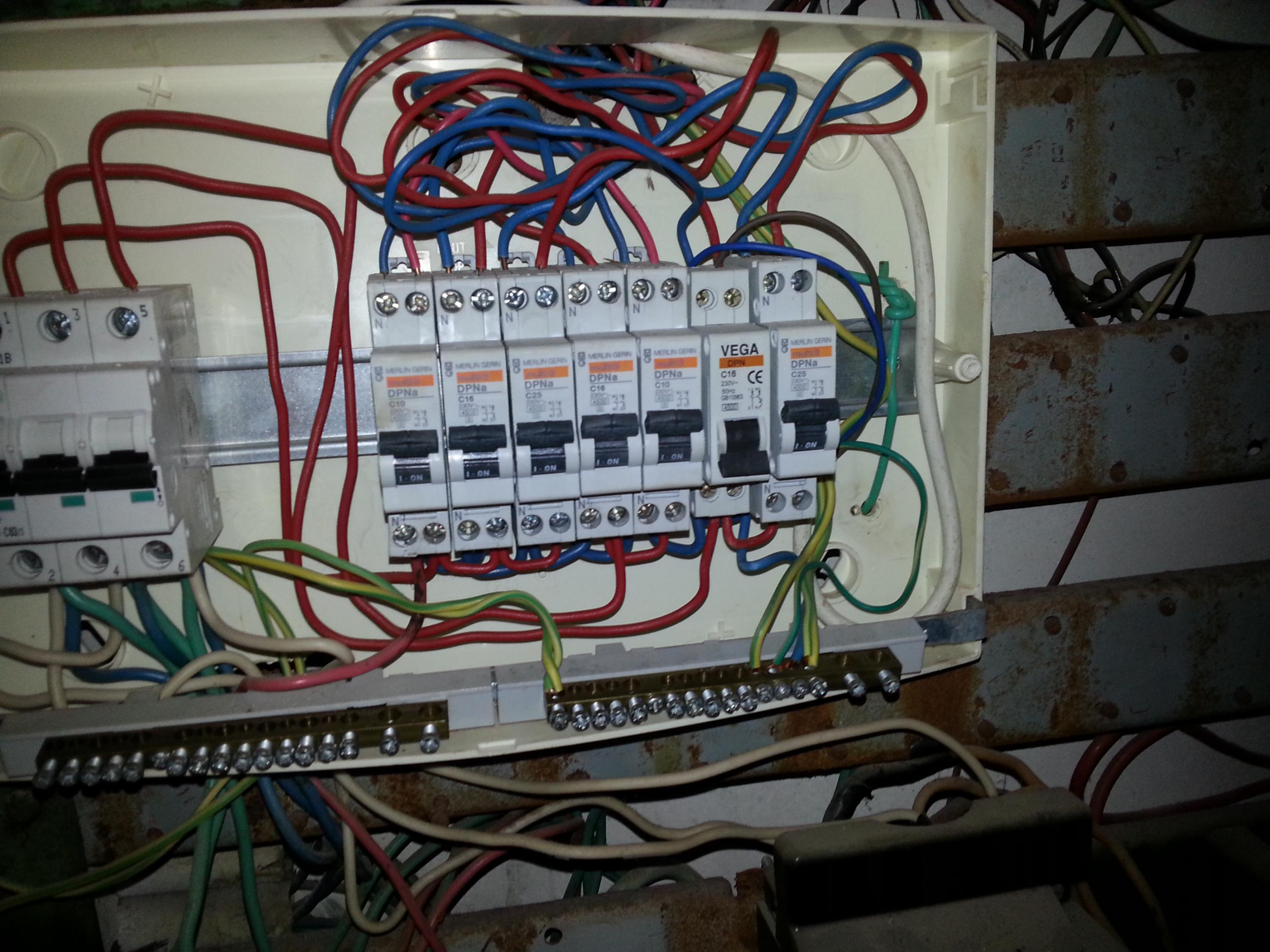

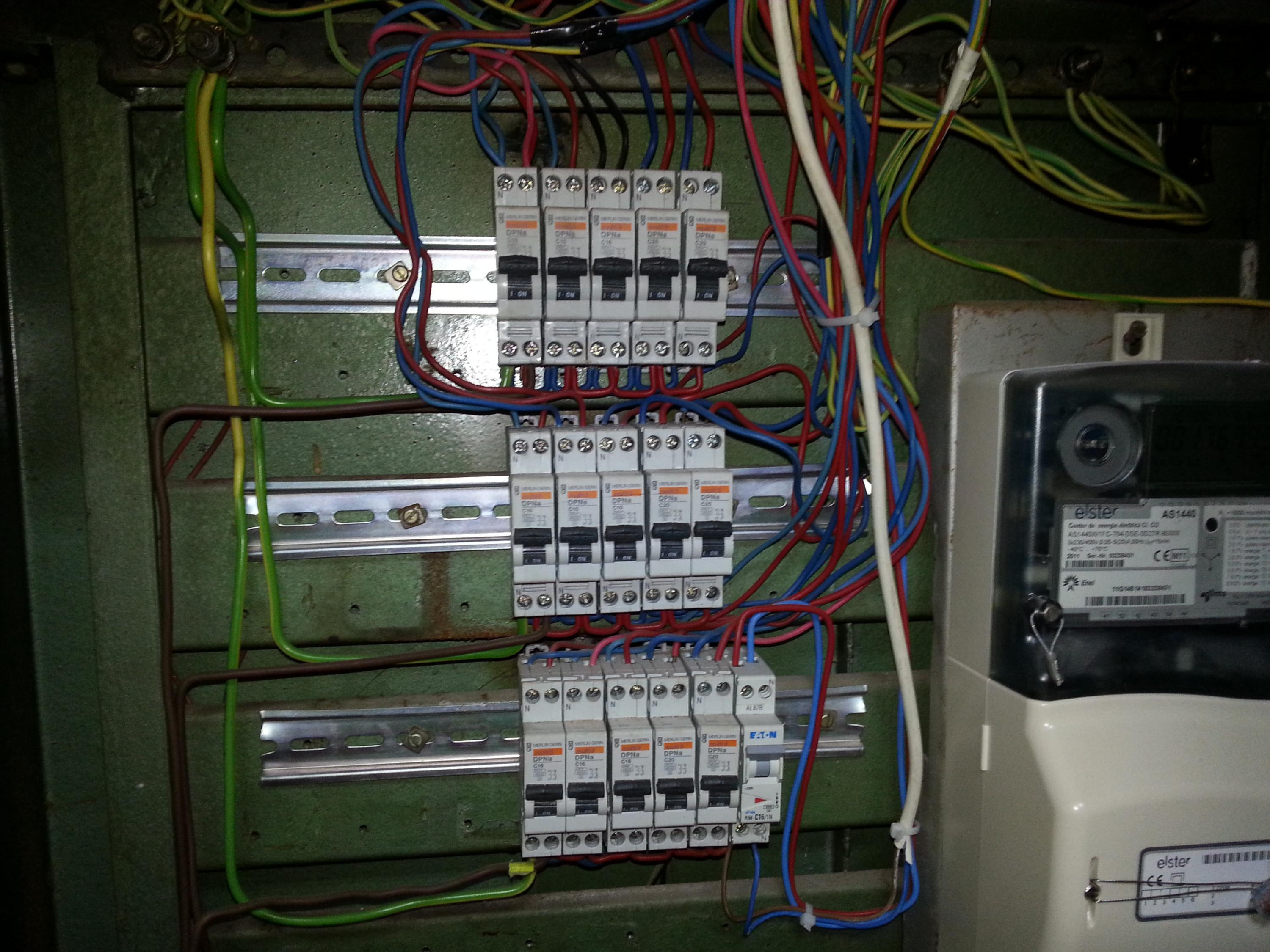

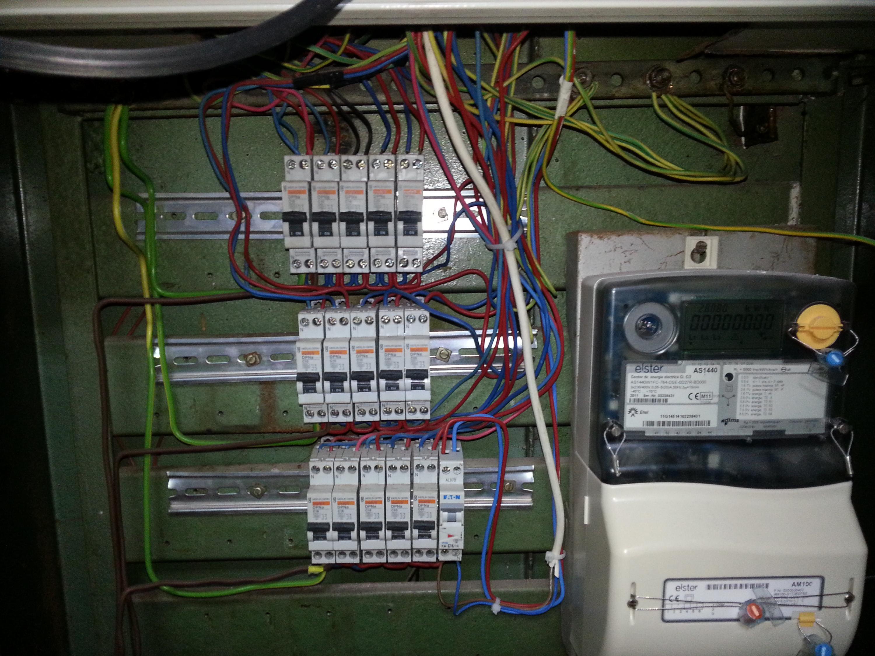

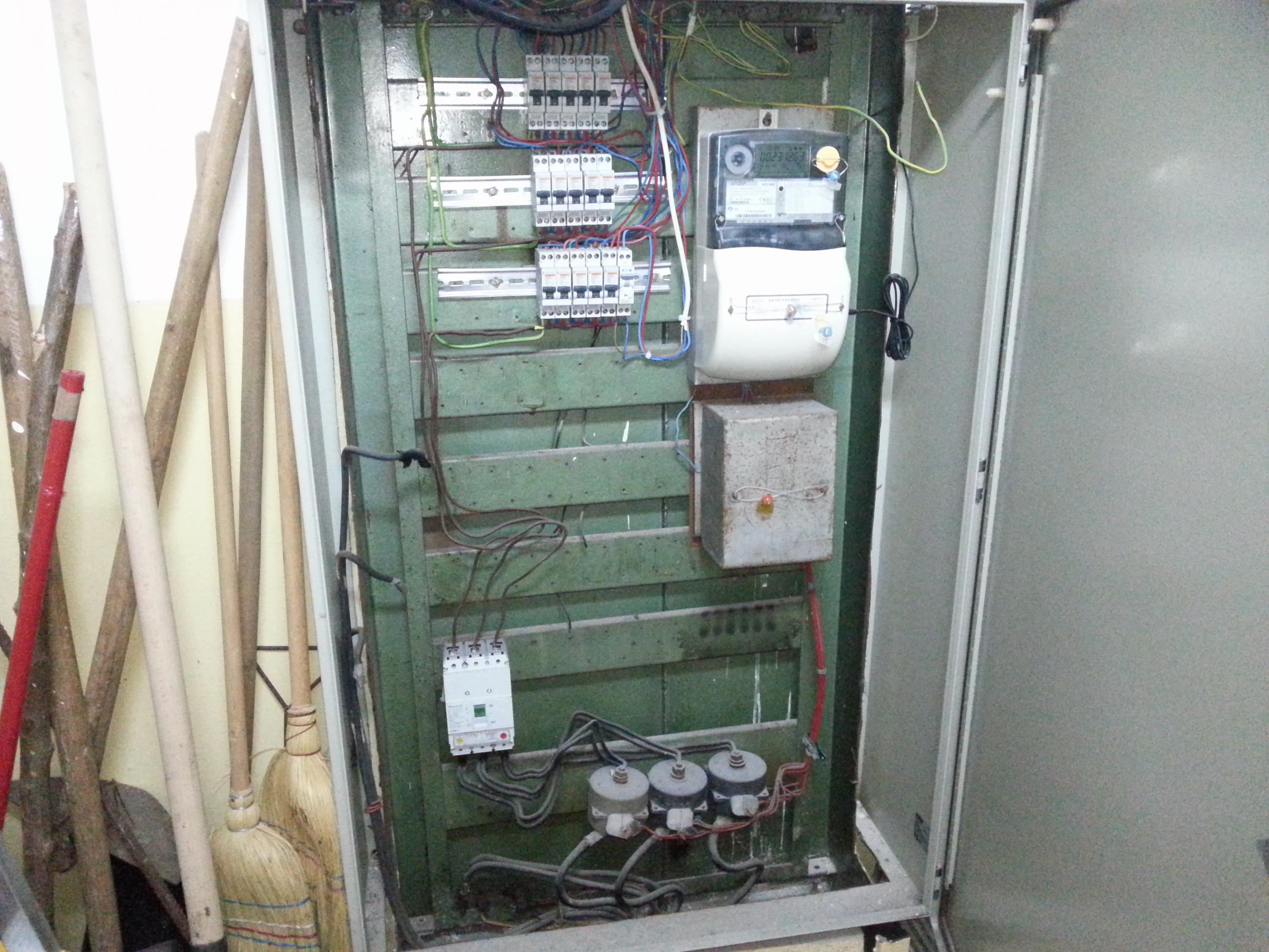

                            After a very long time since I've talked about this topic, here's another panel I got to mess around with for a new install, though here I only needed to run some network wires THROUGH it along the bottom, rather than actually do electrical work. Still, this is a new space in our company where I'll most likely move to, so being the perfectionist that I am, as you can see, it's quite messy in there and could use a little tidying by my standards.
                            For instance, notice that black neutral wire going from the bus-bar at the bottom to the bottom-right corner of the meter - bit of an eye-sore, isn't it ? Is it safe to disconnect just the neutral wire while you re-route it, or could that cause issues ? Sucks I can't disconnect the three red phase wires too, since they're all mangled up and I hate living with the through they're like that I'd need to find a breaker somewhere or work "live" without touching them, which is quite dangerous and not quite something I'm willing to do.

                              Perhaps make those network cables nice and aesthetically pleasing before starting work correcting someone else's. Twisted, an unsightly bend in the middle and a big gap between the bunch and that stray cable.

                                Well that's as good as we managed to get them with what we had to work with and I'd call it decent enough, if we're talking about the network cables. We purposely made them U-shaped like that so they'd be away from the power wires, plus running them straight to the hole on the left would cause them to bump into the bus bar and other wires, since the two holes are not at the same height. Sure, I would've replaced the whole panel since it's really old and pretty bent and doesn't close properly, but without the necessary funding we did the best we could for now.
                                  Why are you even running network/data cables in these? That's against Electrical Codes here. Where is the telephone wiring then?
                                  A cheap chinese energy meter with the breaker/disconnect and skinny wires AFTER it?
                                  Lifting a neutral makes it go hazardous live, so there is a shock hazard if you unhook it. Notice the wiring for the energy meter's power... to shut it off...
                                  Don't mess around cleaning up these panels. You have to learn to let go and leave prior work alone as crappy as it is. Every picture you show is due to cheapness. The neutral busbar is full with stacked connections, use the nearest rusty bolt... somebody needs to spend money on a new busbar.

                                    Oh yeah, that's another thing I'd do differently: I'd put the main breaker BEFORE the meter, not after. Again, that's how I found it and it's not ideal in many ways. I'd love to rebuild it from scratch, to make things proper, but that requires money which is unlikely to be invested, plus the "good-enough" mentality is in full effect with these guys. It's sad because I could understand not bothering when you're working on something unrelated at a client's site and all you can do is notice stuff which is not right but can't/shouldn't try to correct, but this is our own building...you'd think it'd be in our best interest to make it "nice"...
