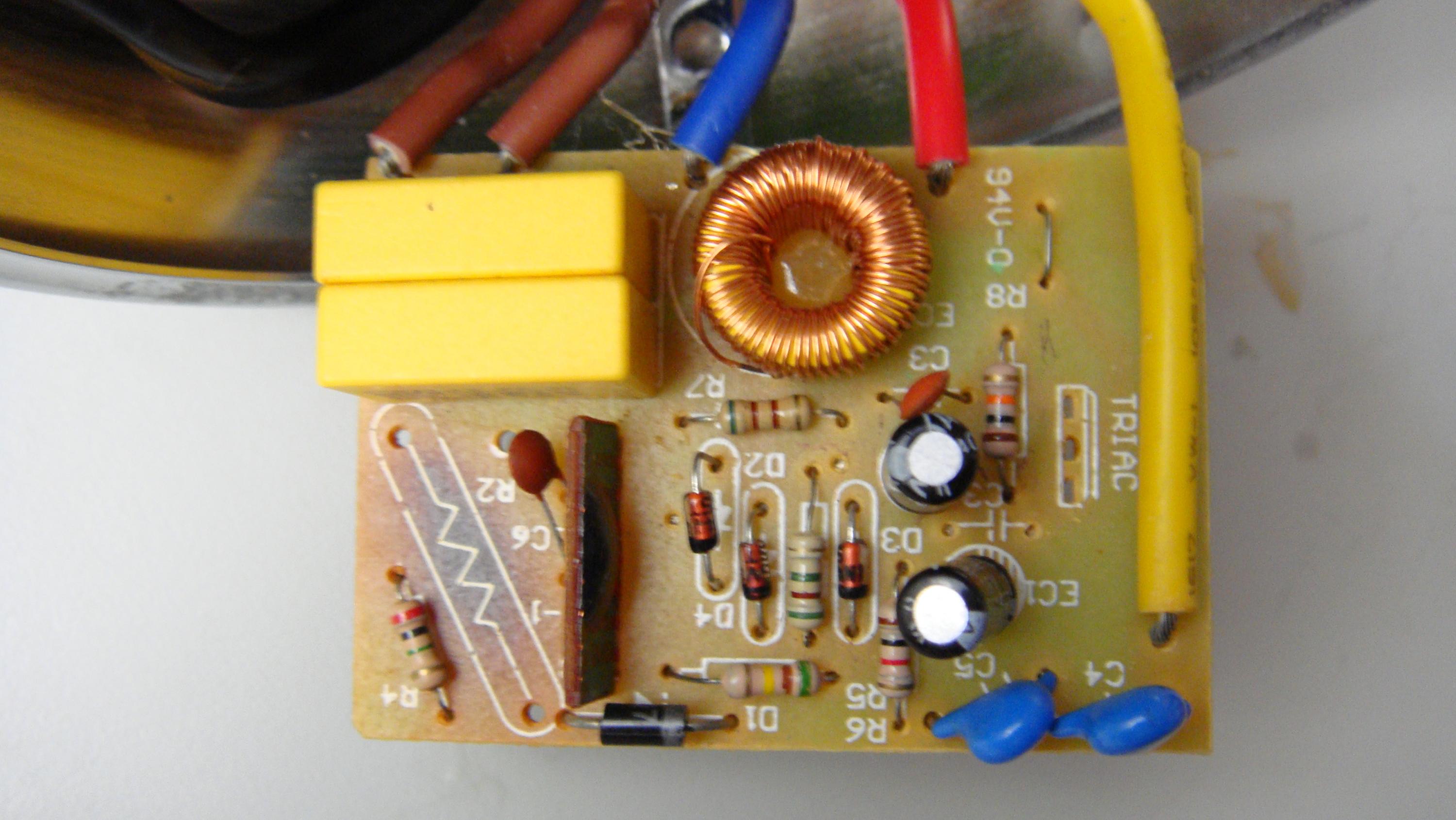

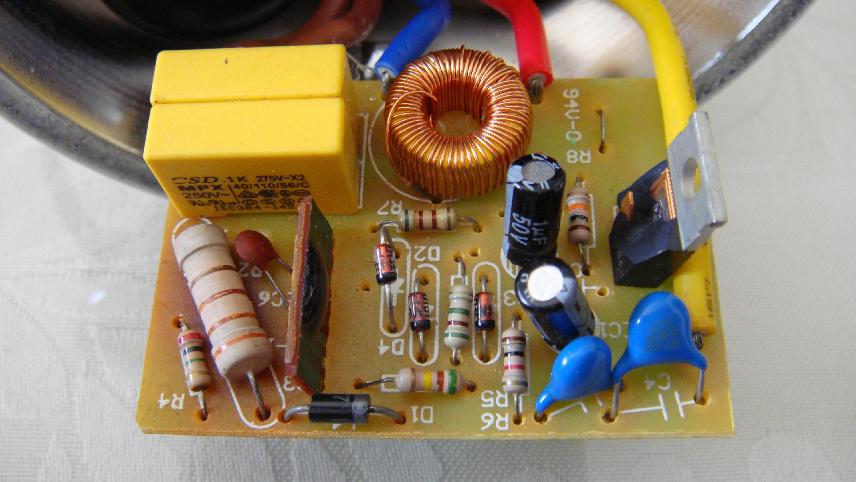

    Hi, referring to the picture in the attachment, can someone please advise which way a Triac BT136 (TO-220 package) should be mounted. Thanks.
  • redwire
    • Dec 2010
    • 3910
    Re: Triac BT136 pin-out on PCB
    I can't quite tell from the pcb silkscreen. The heatsink will tell you more, which way the tab faces, if it has a heatsink.
    What I'd do is look for the gate circuit, it would connect to all the little parts D3, R8 etc.
    That puts the gate near EC1 etc. and so the tab would be facing the pcb edge. A pic of the pcb backside would confirm it, or you can trace the gate lead.
    MT1, MT2 would have heavy high current traces.
    BT136 pinout is MT1-MT2-G, tab is MT2.

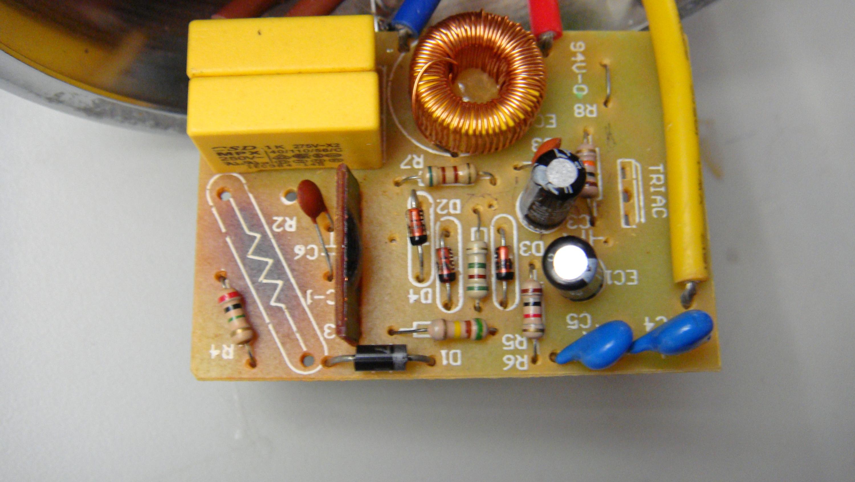

      Thanks redwire. First of all, wow, how did you know the gate is near EC1? You must be very familiar with this type of circuit? You're the right man I was looking for

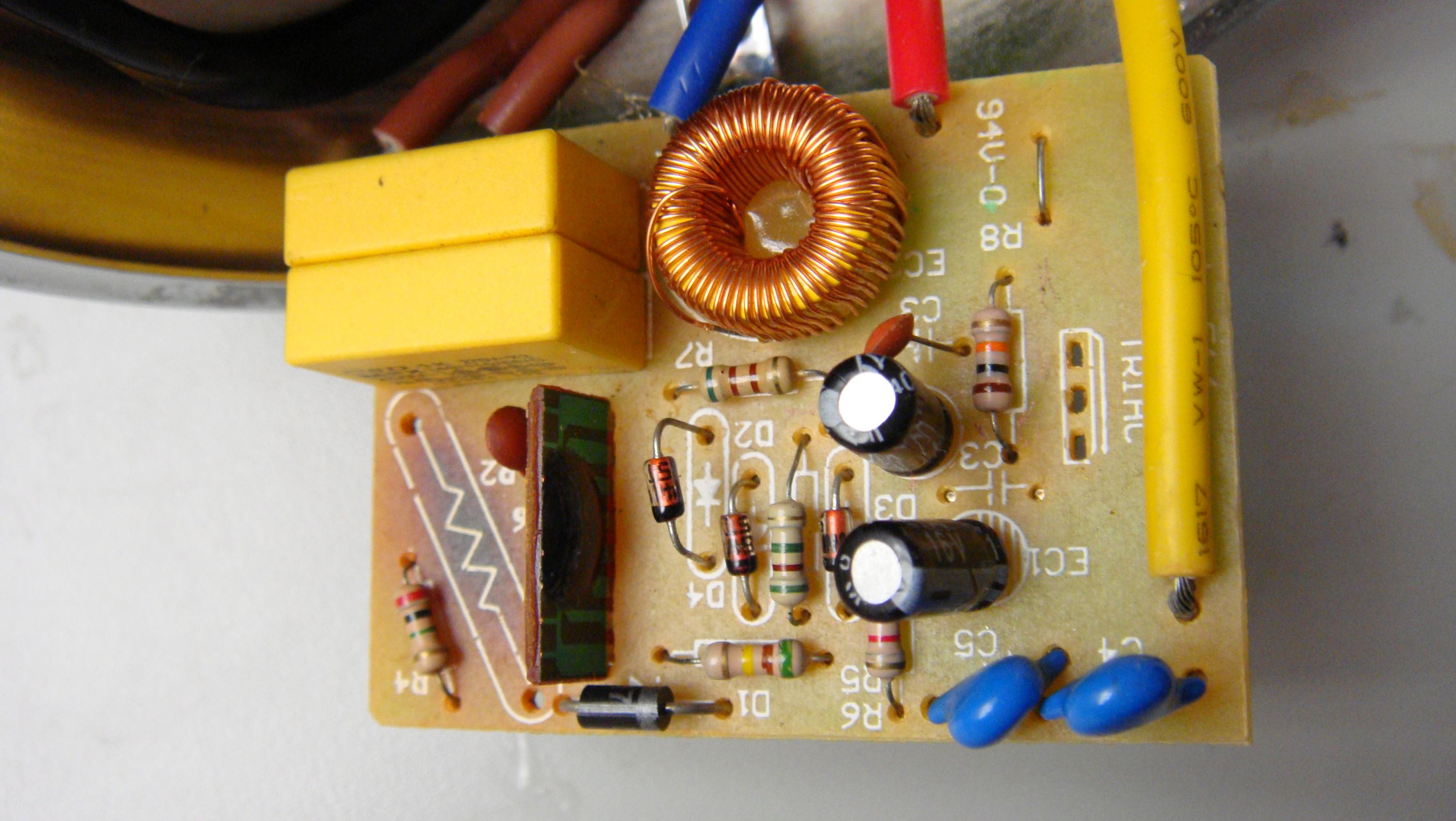

      I've attached a few more photos for references. First one is the full view of the dimmer pcb with the Triac still on the pcb. Again you were right, the tab was facing the pcb edge. And you can see the Triac was blown.

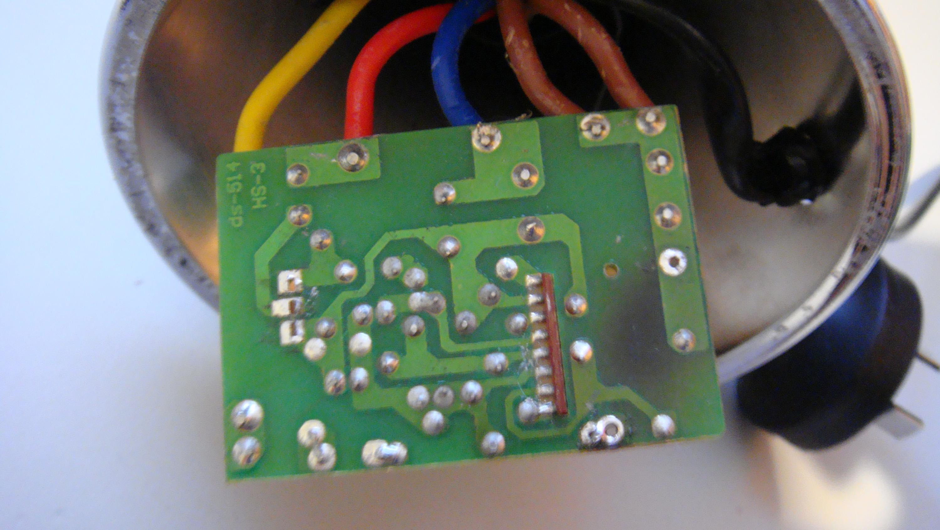

      The second photo is the back side of the pcb.

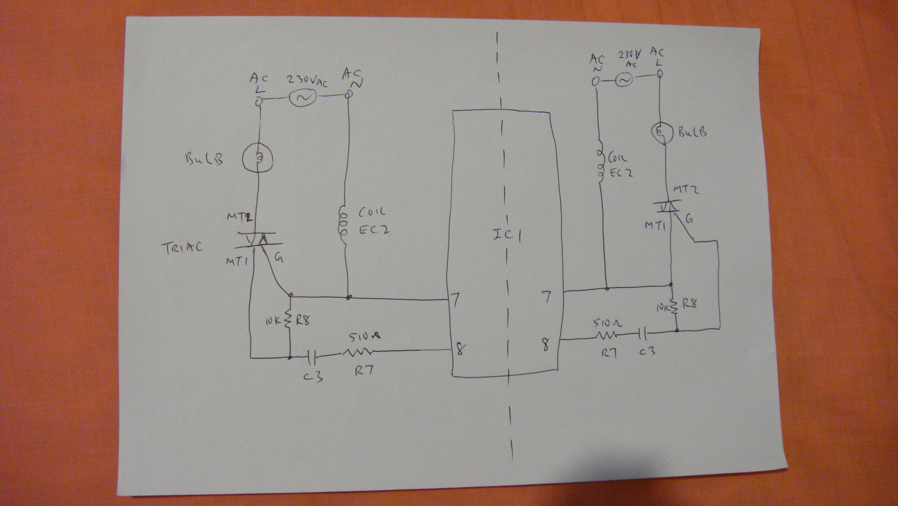

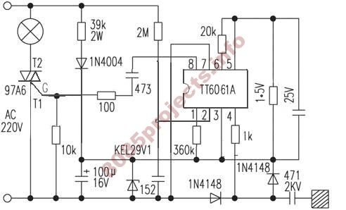

      So, what was my problem? Well, look at the third photo which is a schematic I drew. The left half showing the Triac part of the circuit I traced and you can see straight away something is wrong. It should have been like the circuit shown on the right half where the Triac MT1 and Gate should be the other way round.

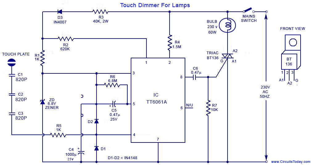

      The forth photo is a very similar circuit I found on the net and it's like the right half of the schematic, except the AC Neutral did not have the coil (ec2) but connected directly to MT1 and pin 7 of IC1. The fifth photo is another similar but much clearer diagram I found.
      Can you verify whether my finding was correct from the photo of the back side of the pcb? I've double checked my tracing, but just in case I really did made a mistake. If I was right does that mean the factory made a mistake with the Triac? The lamp belong to my grandson and he said it was working properly before it blew. This really got me confused and unsure if I was wrong
      By the way, the 33K ohm 2W resistor on the other side of the pcb has also open circuited. It is equivalent to the 40K 2W resistor in photo 5, which is part of the Vdd (6.8Vdc) supply rail circuitry to IC1.

              Is BT136 the original triac? R8 (10k) seems to be connected between T1 and gate but if that is correct there is nothing else connected to T1 but the 10k
              Maybe it is just the 1µf hiding the part in the picture, but is there a component between R7 and the triac?
              This site has a similar board that seems to use the same chip on board ic https://www.ccoors.de/blog/fixing-a-tcm-211682/
                Yeah, I do not see C6 (as shown in the diagram) connected between the Gate and the IC either, there are solder pads for the cap but I do not see the cap installed.

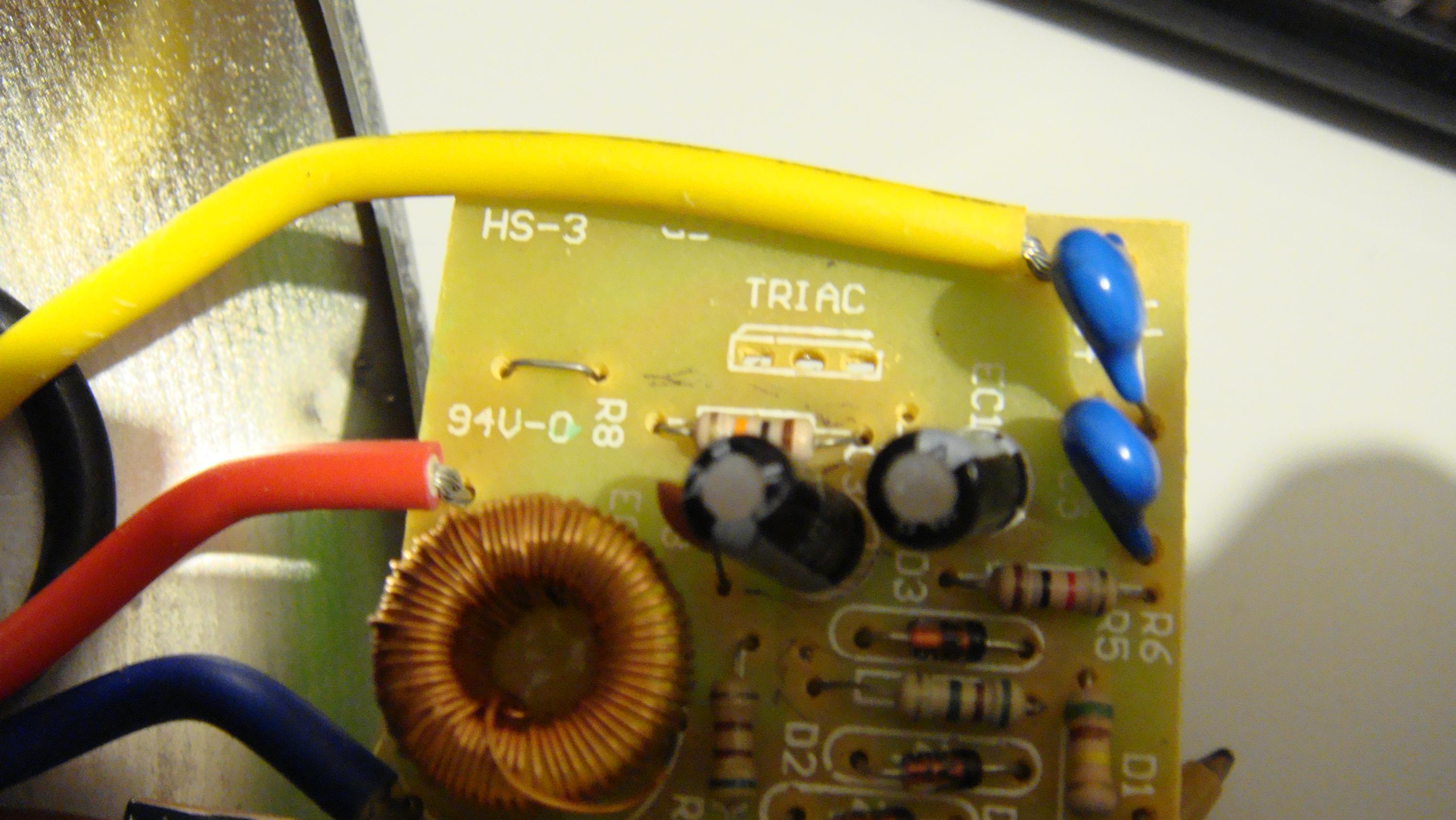

                  Ok, 3 more photos at slightly different angles hopefully should clear things up. By the way to avoid confusion by some readers, the last diagram loaded earlier was a similar circuit I found on the internet, it is not the diagram to my circuit.
                  Noticed there's another mistake on the board? There's 2 C3, the 1uf 50v electrolytic cap and a small ceramic cap (C6 in the diagram you were referring to I believe) hidden behind in the earlier photo.
                  The MT1 (should be the gate) is currently connected to the ceramic C3 and R7 (in series) and then to pin 8 of IC1, which logically should be the trigger.
                  I've re-traced the circuit again and still came to the conclusion that the Triac was mounted incorrectly, ie, MT! and gate the other way round.
                  @R_J, bt136 is the original Triac.
                    OK, after looking at the board layout, you are right, it does look like the TRIAC was mounted wrong.

                      Thanks budm. Based on the diagram I drew, with the triac the wrong way round, could it have worked at all in the first place? The lamp is at least 5 yrs old and my daughter said it's definitely been working fine before it blew last week! Weird.....

                          I can't see how it would work being mounted wrong, that other site shows a very similar circuit that seems to use the same cob

                                    The lamp return had the choice of two paths, the triac's T2 through gate, the other was the triac's T2 through T1 and 10k 1/2w resistor.
                                    Or they purchaced a bunch of triacs that were mfg. with T1 and G reversed
