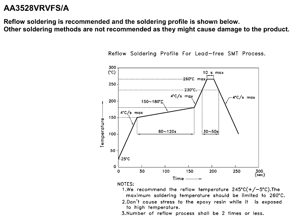

                              Well, I actually found one item that may be potentially useful to you. It's a suggested reflow profile from a Kingbright AA3528VRVFS purple SMD LED (the one I used in my AN5272-based headphone amp.)
                              Of course, for different SMD chips of different sizes, you might have to vary those temperatures a bit.
                              But again, a first step would be to get one of those type-K thermometers like TM-902C if you don't have a reflow machine and want to practice on your own with a regular hot air wand (and perhaps something for bottom heat... like a toaster? )
