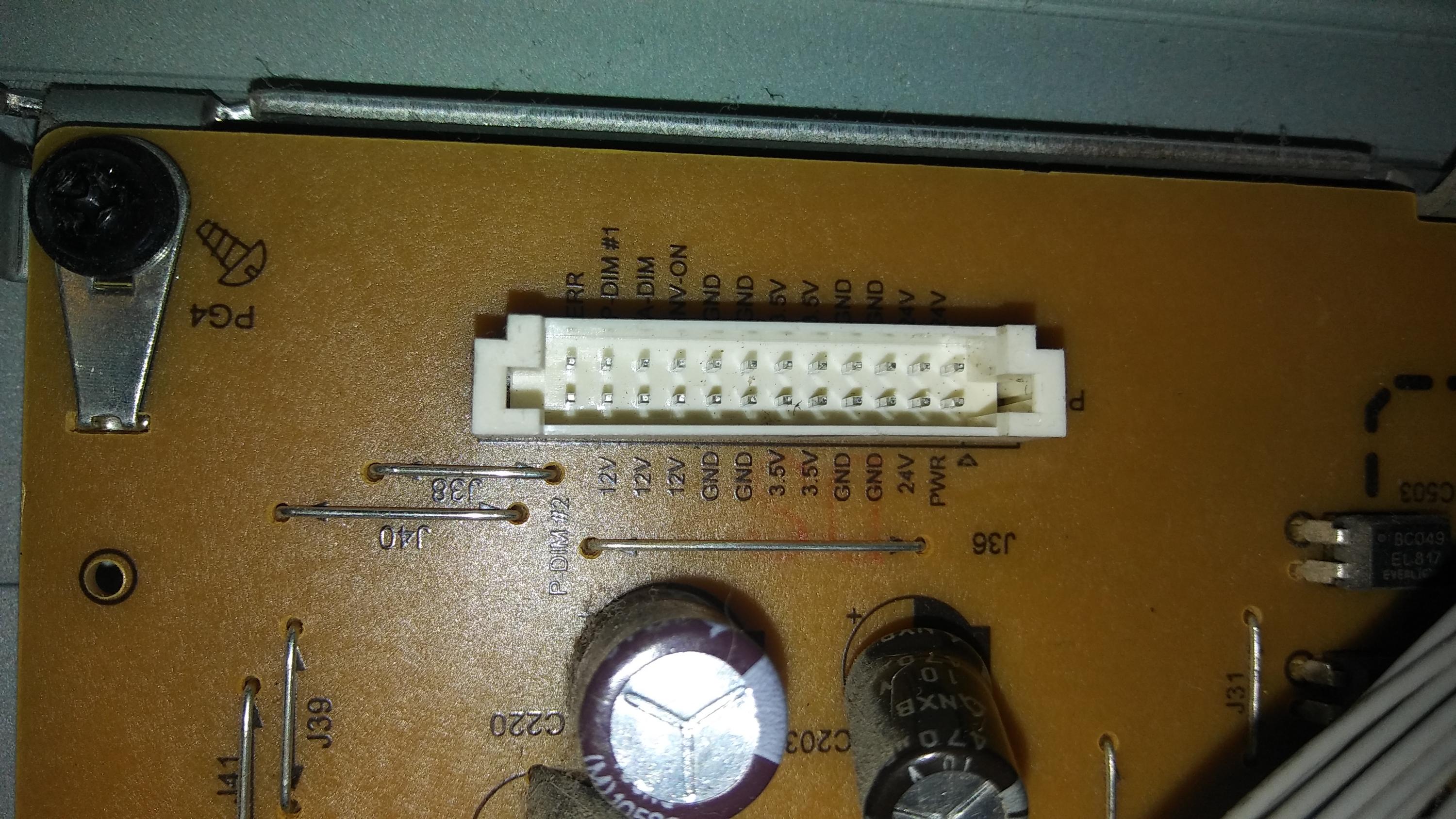

    P-Dim # 2 ?
    I would like to know what is P-Dim # 2?
    Is that means the TV, LG 55" ccfl, has double dimming control signals, for what purpose needs A-dim, p-dim#1 and p-dim#2?

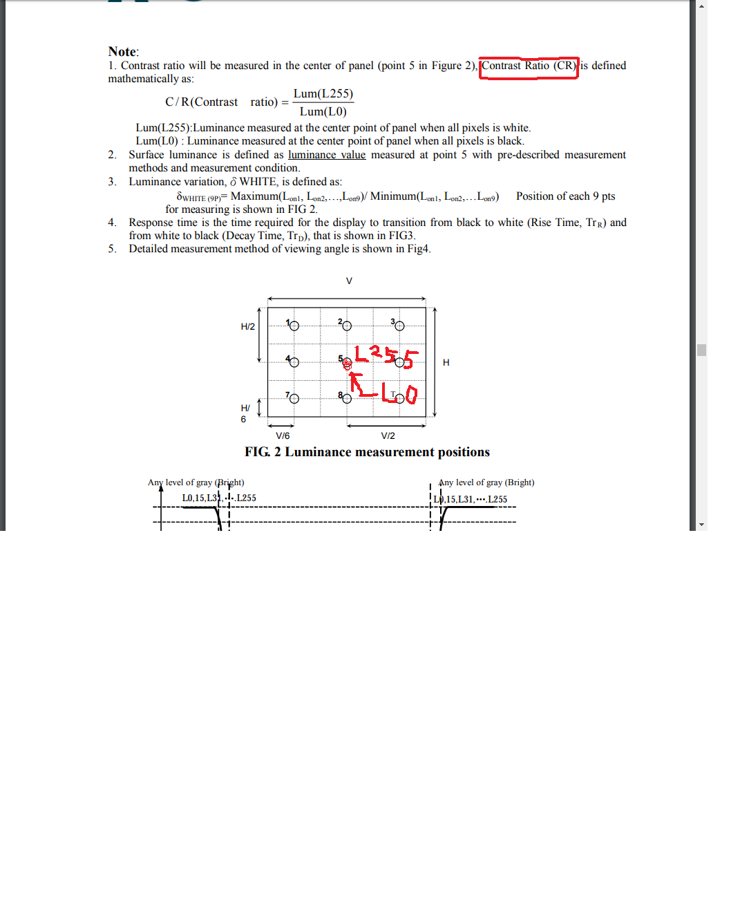

          Re: P-Dim # 2 ?
          Min Typical Max
          External PWM Duty ratio D_EPWM 30 100 %
          External PWM Frequency F_EPWM 150 180 300 Hz
          on page 10
          EPWM = Open/High (Turn on for 45minutes) what does this mean?
          I found it:
          warm-up procedure: Stable for 45 minutes in dark environment at 25oC. Does it take so long to stabilize, warm-up LED panel?
          contrast ratio (CR) picture 1
