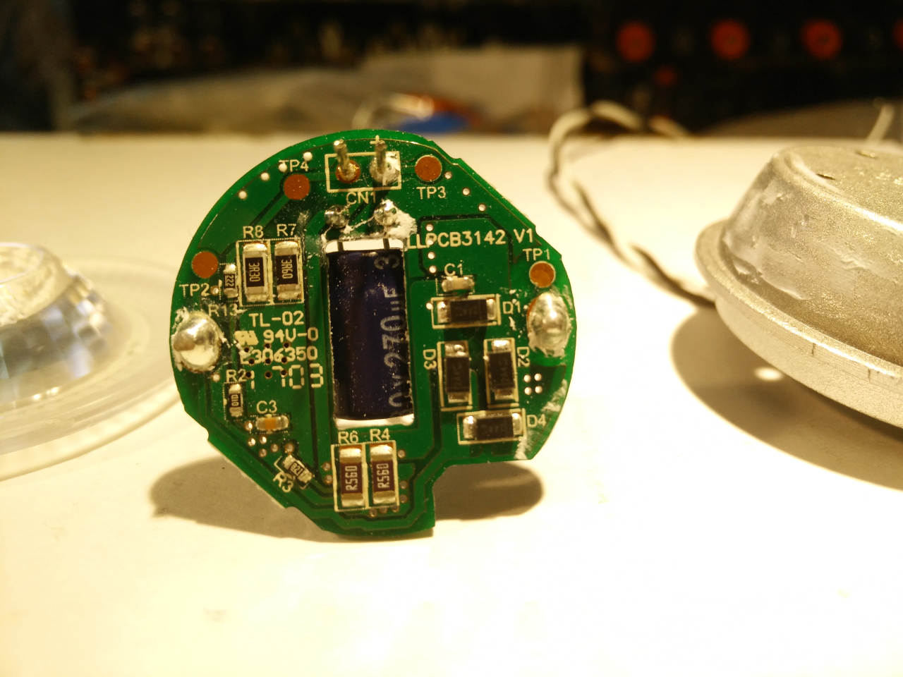

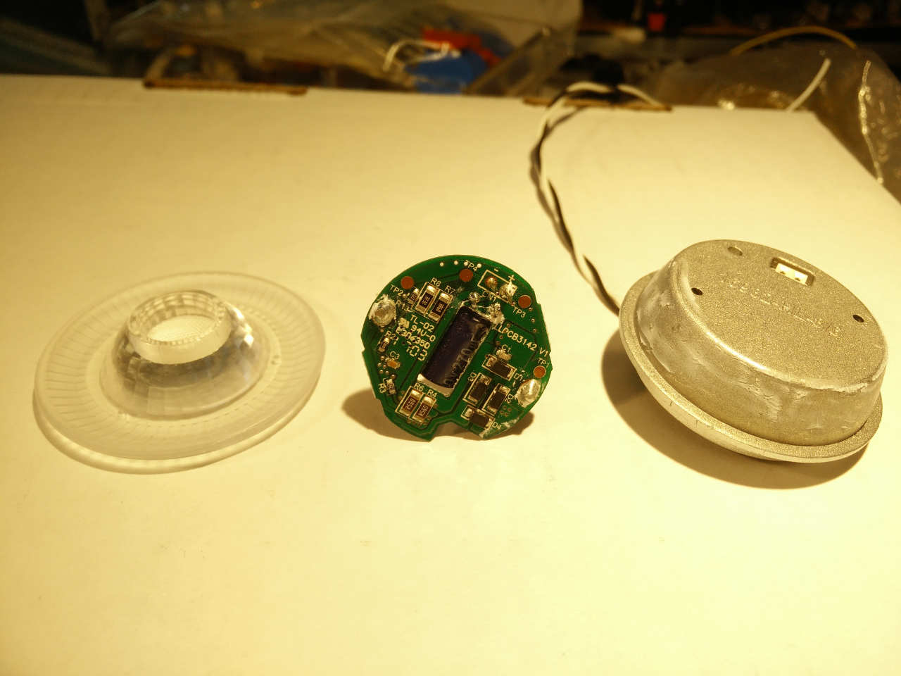

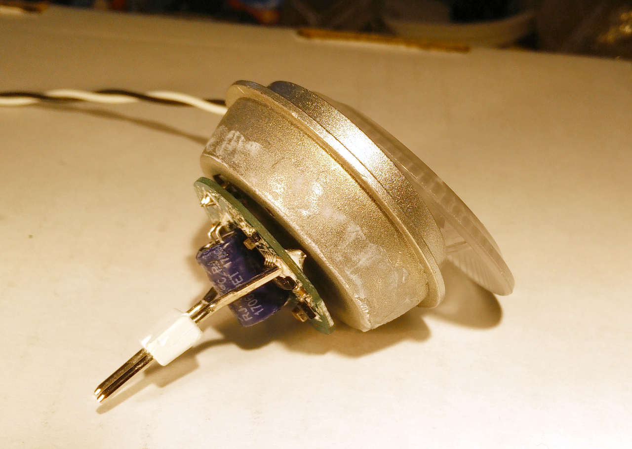

                                        Tore apart a Philips MR16 LED bulb. I busted it up a bit because of the glass housing and silicone glue.
                                        The main board has a bridge rectifier and 270uF 30V filter cap with AL8821 boost-converter for MR16 LED's.
                                        The bulb has a 20V COB LED with current control SOIC-8 PLD1B/H1A01A and 0.75R current-set, on the heatsink. I'm not sure what that is for. It's a two-pin connector between the boost and LED board.
