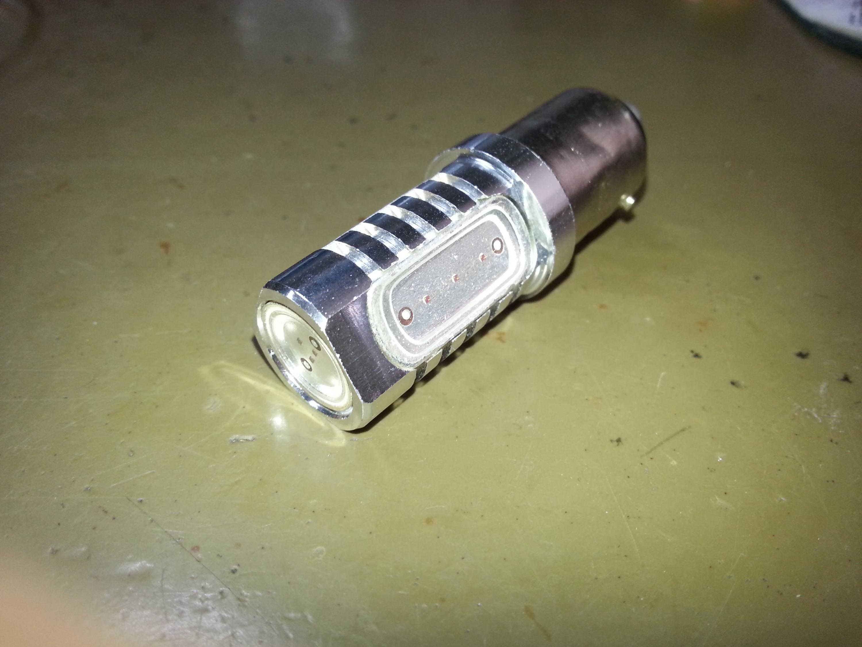

          This is what the lamps look like BTW...about time I posted an actual picture Not that it'd matter too much but anyway...

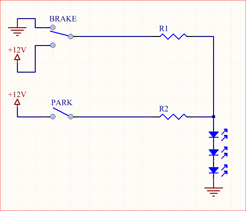

                              Do you think this LED lamp has inside a buck-converter or is just cheapo resistors? It acts like cheapo resistors.
                              Because brake resistor R1 much lower than park resistor R2, grounded brake wire prevents it from working.
                              Try ohmmeter the LED lamp between park/brake.

                                  Definitely resistors. Either like in your drawing or a resistor divider on the parker wire, with the input terminal going to one end of the ladder "ladder", GND at the other end and the LEDs in the middle...classic divider, simple and easy to understand. I mocked-up a schematic like that somewhere along the way myself, since I immediately thought of the same thing. This perfectly explains issue no.1 (the parker not turning on when brake is grounded), but not issue no.2, why the brake causes no change in brightness once a diode IS added in series with the brake wire.
                                  Actually come to think of it, issue 1 is not completely solved either, just "put aside for now", since we don't know for sure that there's a GND there...both the schematic and the facts (AKA putting my head under the bloody dash and looking at that switch in some weird power-stance/sex position sort of deal ) show there's no GND going to that switch, so the ABS module connected in parallel to the output of the switch is somehow interfering. Unfortunately I can't disconnect it, not even temporarily for testing, because the wire is crimped together with the other one going to the lamps (exactly the same as in the schematic - page 65 or 66 if memory serves).
