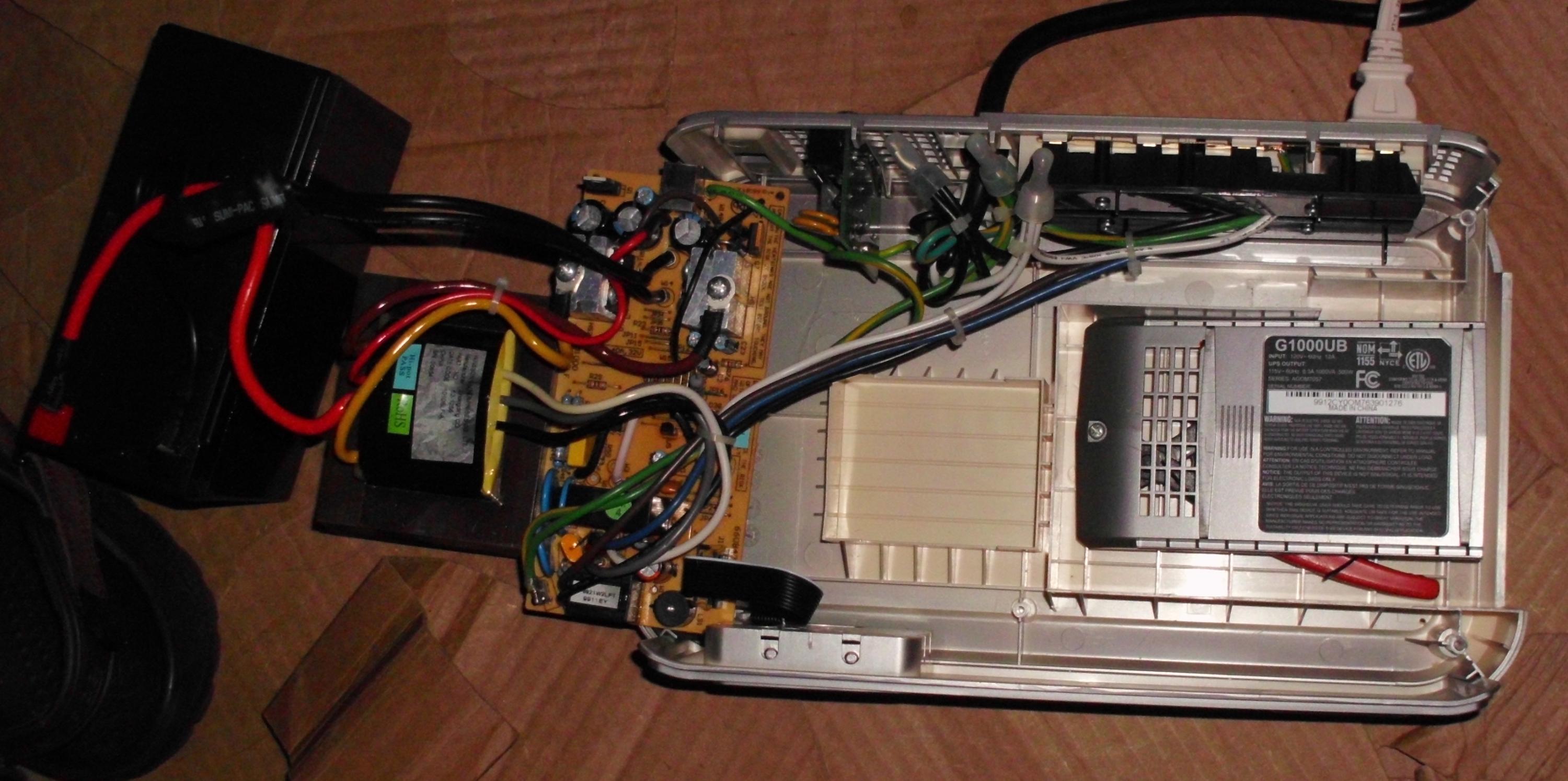

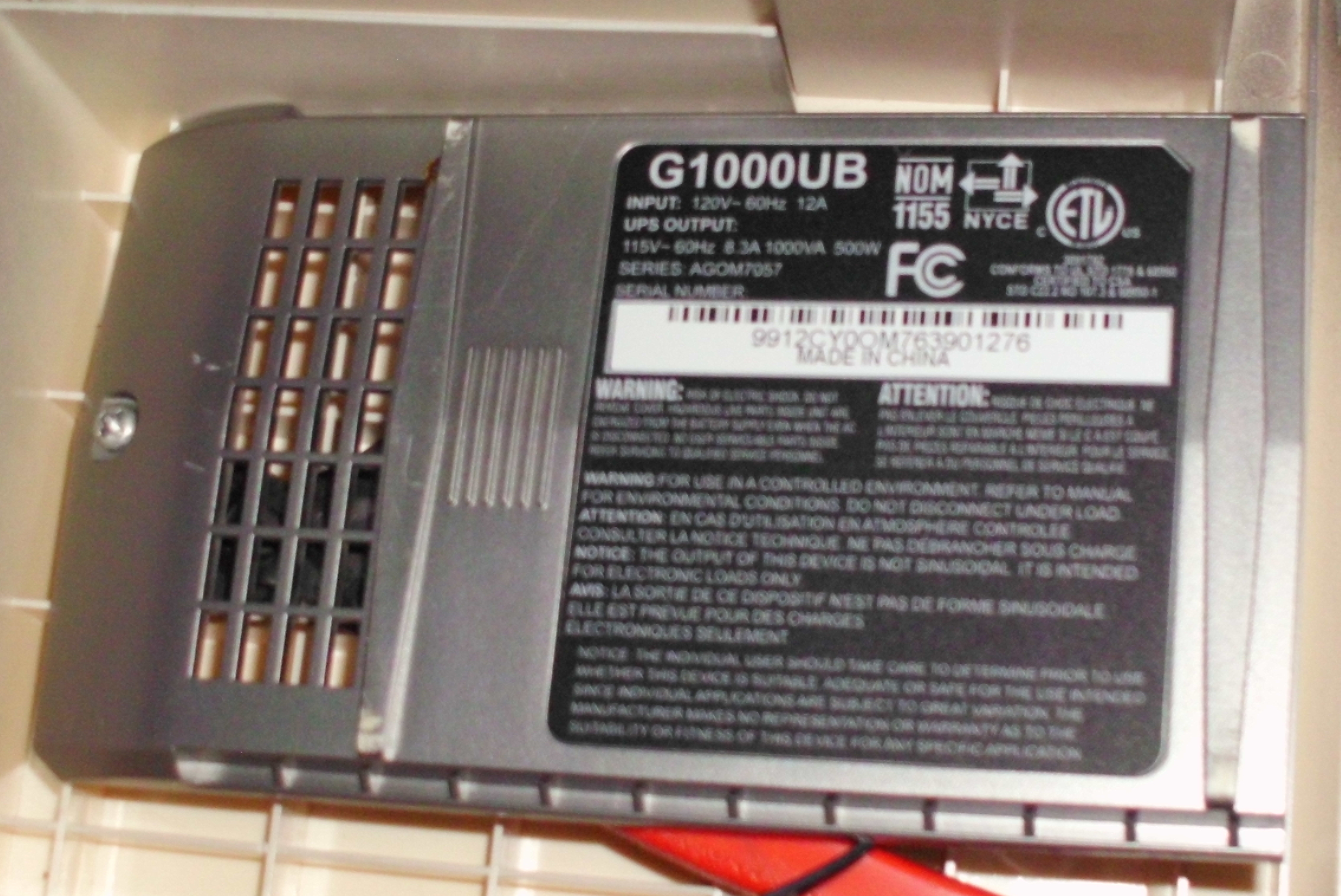

Transformer in UPS runs warm for no apparent reason
  • evilkitty
    • Nov 2017
    • 299
    Running temp in open air is 27.5C to the touch (the part that is iron), ambient temp is a 15.9
    this thing as always ram warm, not sure if it has a bad component or is designed that way, you can imaging how hot it gets when the unit is closed
    I know the APC units do not run close to this warm
    the battery is cool to the touch, UPC is running on mains power
    I was not sure if i needed a load on the system, so i hooked up my heated blanket, needless to say that made the cat happy

    Re: Transformer in UPS runs warm for no apparent reason
    how much current is the battery drawing ?
      my clamp on meter shows 0.8A on the large red wire, 0.7A on the black wire (0.6 if i flip it around on the black wire)
      may be worth noting this meter read 0.3A just sitting all by it self
      *my other meter needs fuses (on order)
        30C doesn't seem that hot, even with 16C ambient. Your transformer will always draw a few Watts for itself, even when not loaded.
        I have a pair of computer speakers whose transformer runs so hot that you can't even touch it (over 60C). This is regardless if the speakers are used or not, and with an average ambient temperature in my home at around 22-24C.
        Most Class B -rated transformers are rated for up to 120 or 130C case temperature, if I remember correctly. So 30C really is nothing.
          That sounds normal to me. It's normal for a transformer to be warm even when unloaded, due to the "eddy current" losses in the iron core.
          This is why environmentalists don't like iron-core transformer (mains frequency transformers) based power bricks, because the standby power draw is higher compared to that of a switch-mode power supply.
          My guess is that the transformer is staying energized by the mains input in order to provide power to charge the battery.
                              I find these low cost UPS just run really warm when doing nothing. Then the batteries don't last, due to the heat and high charging voltage for the warmer battery.
                              The transformer design is low cost with high flux density near saturation, so the core runs hot. Especially if your mains voltage is high >120VAC. It may have a shorted turn though.
                              The only other time I've seen these run hot and cook is if there is a shorted cell in the battery, it goes full tilt charging a 10V battery.
                              WINSSON ZHONGAING Transformer 62-1256 Tripp-Lite G1000UB UPS
                              Guy rips apart similar Winsson 62-1225 teardown
