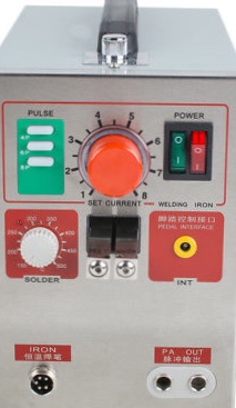

    I need to build current controller for a transformer on a battery spot welder
    Does anyone have any good idea on how I can do this

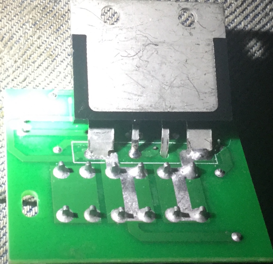

    The TRIAC that was used in this unit was a ( BCR30AM ) but think that this TRIAC is not big enough for the transformer that they used
    Here is the data sheet for it
    https://cdn.badcaps-static.com/pdfs/...bd578d1bbf.pdf
    The photos are below
    I have a few of these TRIAC ( BTA100-800B ) would it be possible to use these to control a transformer
    Here is the data sheet for this device
    https://cdn.badcaps-static.com/pdfs/...980f798e70.pdf

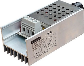

              I did some testing on this device that is in the photo below
                • Jul 2011
                • 6040
                Re: How to use a dimmer controller on a transformer
                Here are the results of the testing of this device
                https://www.ebay.com/itm/10000W-SCR-...-/252538426028
                --Voltage: AC 110- 220V
                --Maximum Power: 10000W (connected resistive load,220VAC)
                --Voltage Regulation: AC 10V to 220VAC
                --Dimensions: 130MMx 60MMx 47MM
                --Rated current:25A MAX 45A
                --for Electric furnace, water heater, lamps, small motor, electric iron etc.

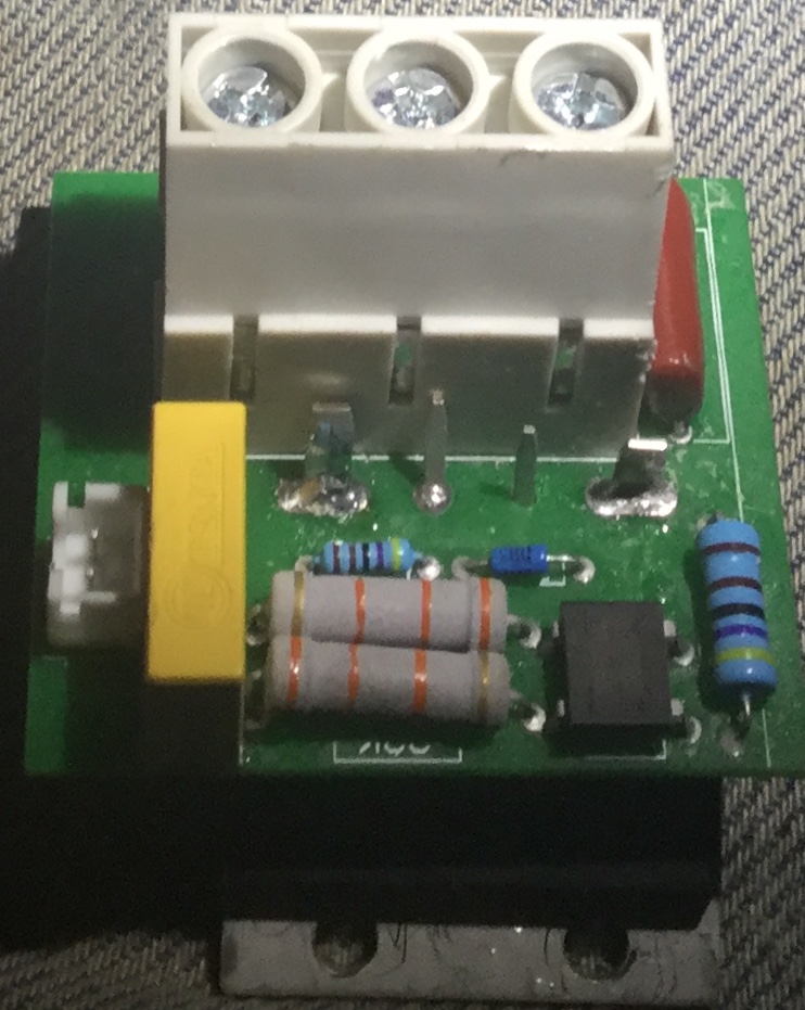

                The device is for 220 volts so I had mod it for 110 volts
                There is a 4.7 k-ohm resistor next the Diac I had add another 4.7 k-ohm on top of one that was there because I was not getting full power out the transformer <——- which works great
                But I going to pull both of those 4.7 k-ohm resistors out and put in a 5 k-ohm pot in it place
                so I can fine tune the voltage going to the Diac so I can limit the triac’s current to 20 amps
                This transformer might be 30 amps hook straight to the main power outlet
                I have not tried it yet I do not have any 30 amp outlet in my house or shed in shed I could wire one for 30 amp but I do not think I need it to be that high amperage any way

                I have this battery spot welder that the controller when bad I can get a replace controller board
                for $28.00 plus $16.00 for shipping I going order one for the exact same battery spot welder that just bought a month ago
                The problem with these battery spot welders is that the transformers are not same in every unit for some reason I have bought two of the exact same model at different times one last year and one month ago
                This one where the controller board went bad the lights would dim when I would hit button to weld
                The new one does not do this but it does not get a hot of a weld as older one does
                Some time you need the extra power with thicker metal tabbing
