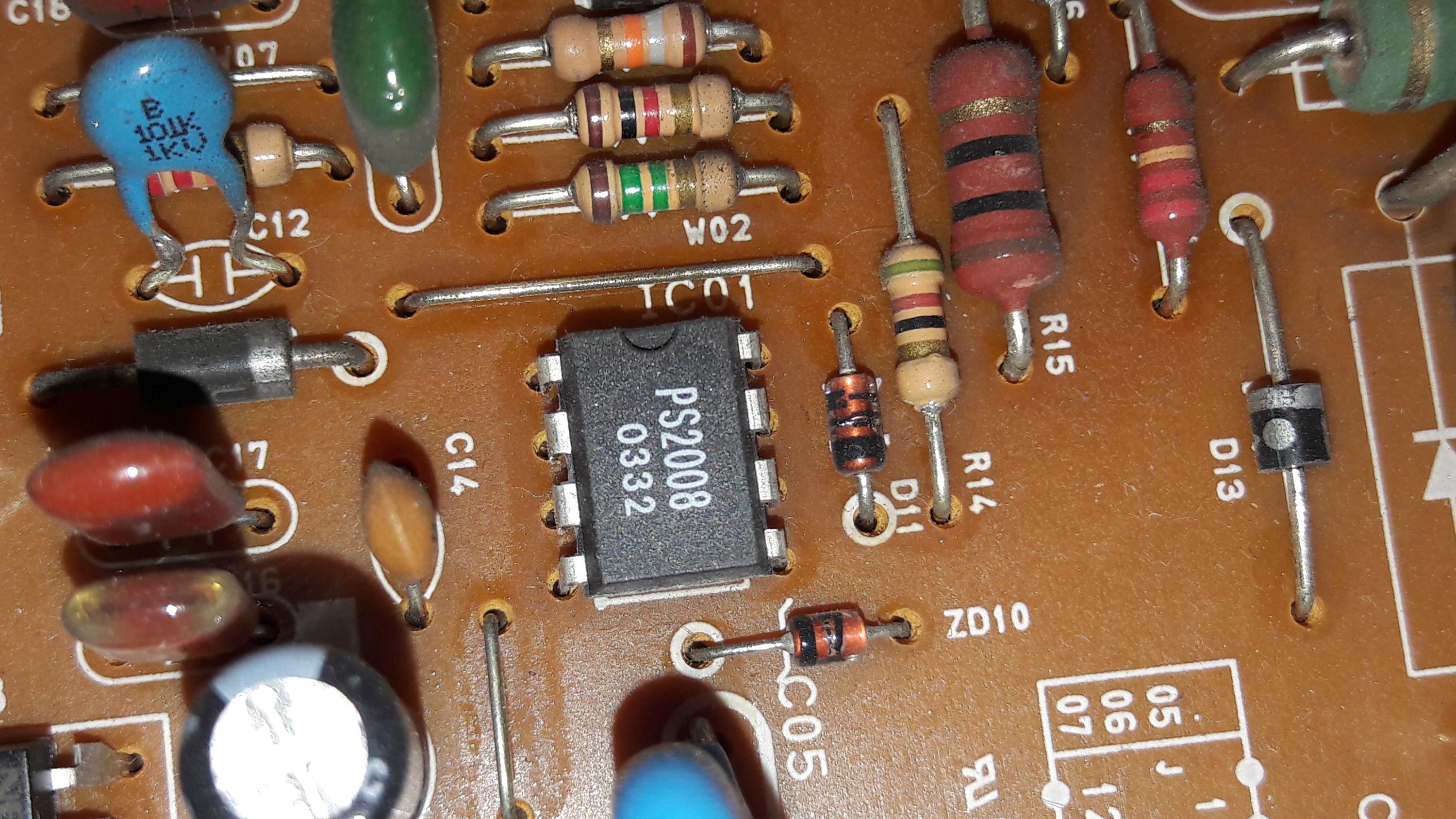

    i cant seem to find any kind of datasheet or anything related to it besides PS2008L, and i cant find any datasheet for that either, help?
    can anyone suggest a replacement for this?

    It is SMPS IC.
    See PDF to see how it is connected in the circuit.
    Show us the straight shot pictures of the whole top and bottom side of the board will help.

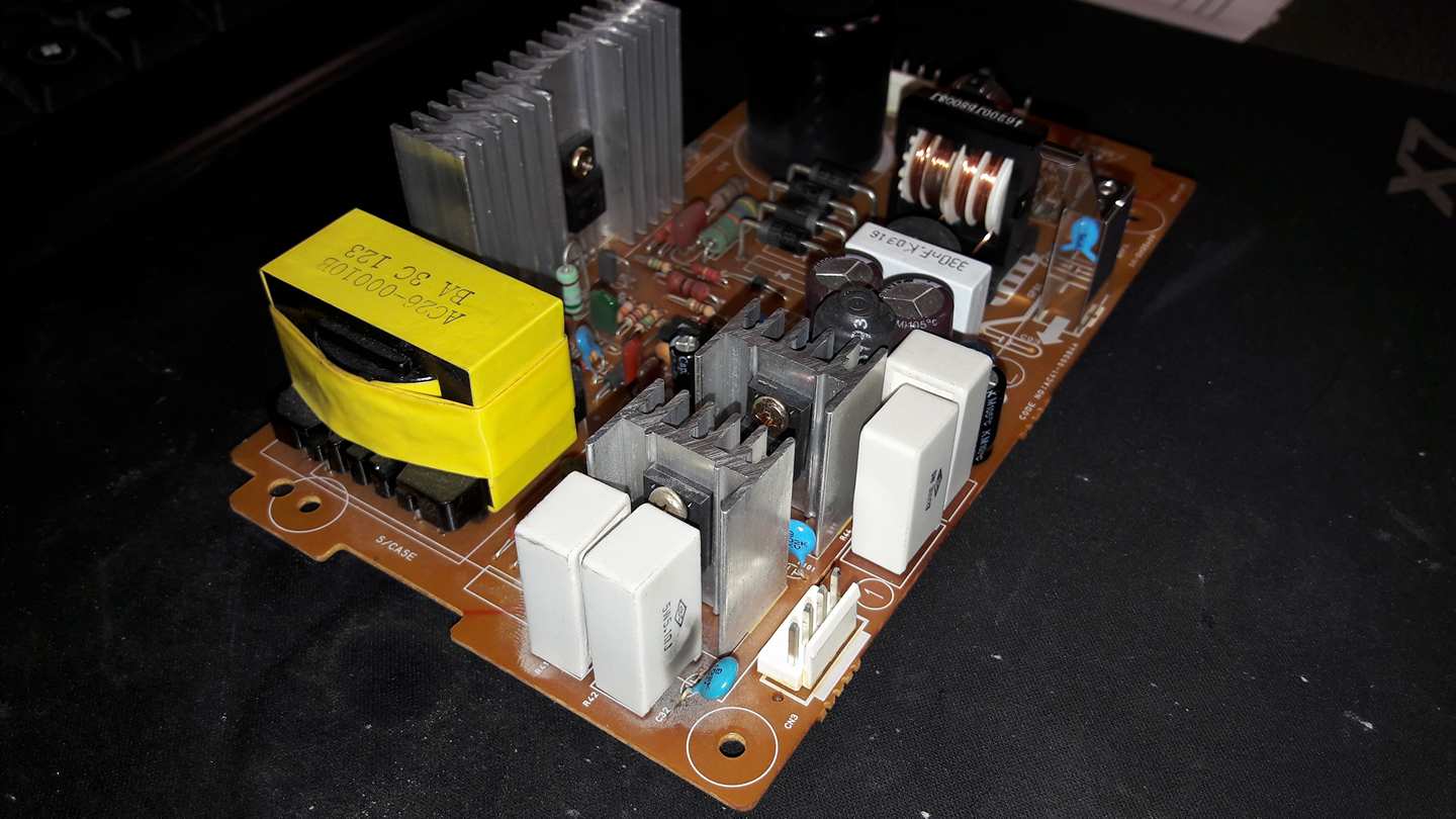

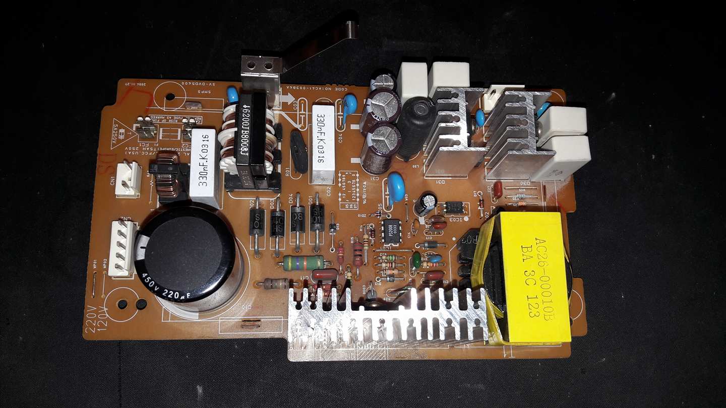

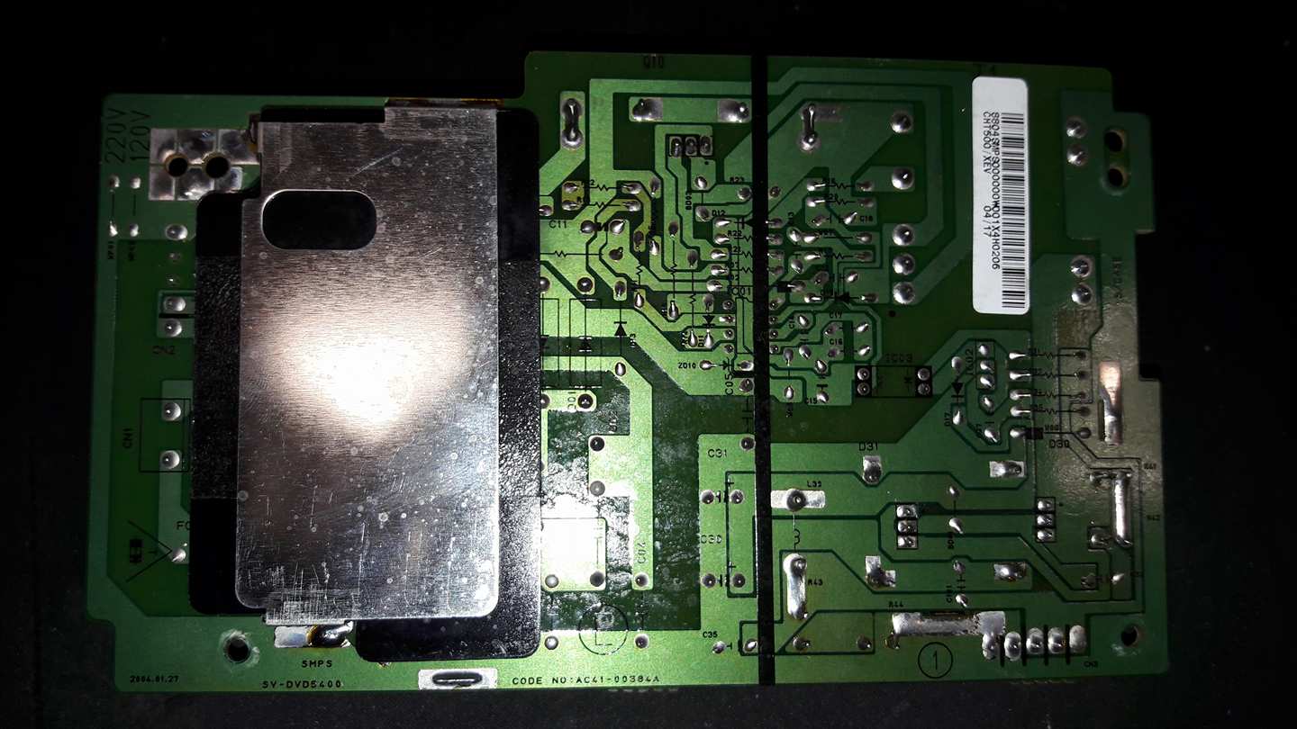

                sorry for the late, response. I've tried to replace the three legged transistor, it worked for a bit with lots of noise until an awesome explosion went by the 6.5A fuse
                here are some images as you wanted
                EDIT: as you see near the blue cap, it looks like something has been burnt, but it does not look like it has any cracks

                  Re: Need help replacing a power source component
                  Those two small blue disk caps and the resistors looks to be the R/C Snubber circuit for those two rectifier diodes that are mounted on the heatsinks.
                  You need to remove the blue to see if it is shorted or has leakage resistance or not, also check the resistance of those white rectangular resistor (5.10 Ohms 5W) and the rectifier diodes too.
                  So was the old MOSFET bad?
