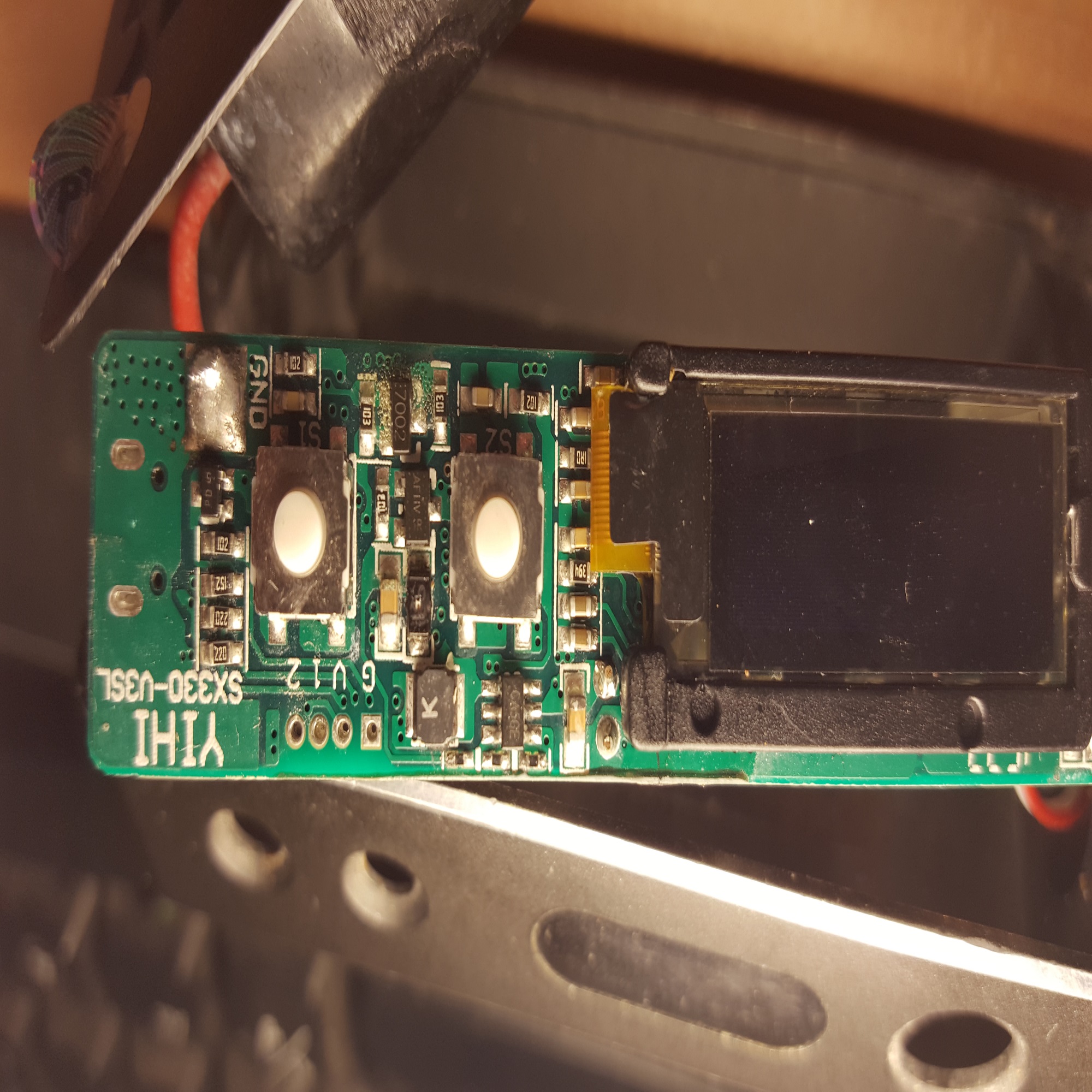

    WTF does "S4" mean on blown diode?
    I've looked and it seems most likely to be a 1n5819. But could also be: 1SS367, or: 1SS389.
    This is a small SMD diode(probably chinese) inside an electronic vaporizer that I am trying to fix for my brother.
    If anyone has any suggestions please let me know.
    I have a device to test components, but this one let the magic smoke out when it got salt water in it.
    I have looked at many code books. Ebays Chinese s4 caps point to the first option and a lot of them say s4. Some code books list the second and third choices, but when looking at Chinese and name brand caps they have a different number printed on them.
    I have a ton of diodes and other components, and of course; I do not have a match for it.

    If you look at the circuit it is connected to then you may be able to figure it out if it is used for switching power supply rectifier, or small switching diode.
    More likely to be schottky rectifier diode.
    Good clear pictures of the board will help.

      I took a few pictures when I had it open. I will try to post them. Thanks for the fast response buddy!
      I believe it enables a infrared or capacative touch switch(which no longer works) as the alternative to the mechanical switch(which still works).
      And as far as tracing out the circuit... That's alot of traces to follow and I am a bit of a noob. I can diagnose most issues but I am still practicing the enginerding of circuit design. Heck even recognizing a buck/boost converter on a block diagram is a bit of a challenge.

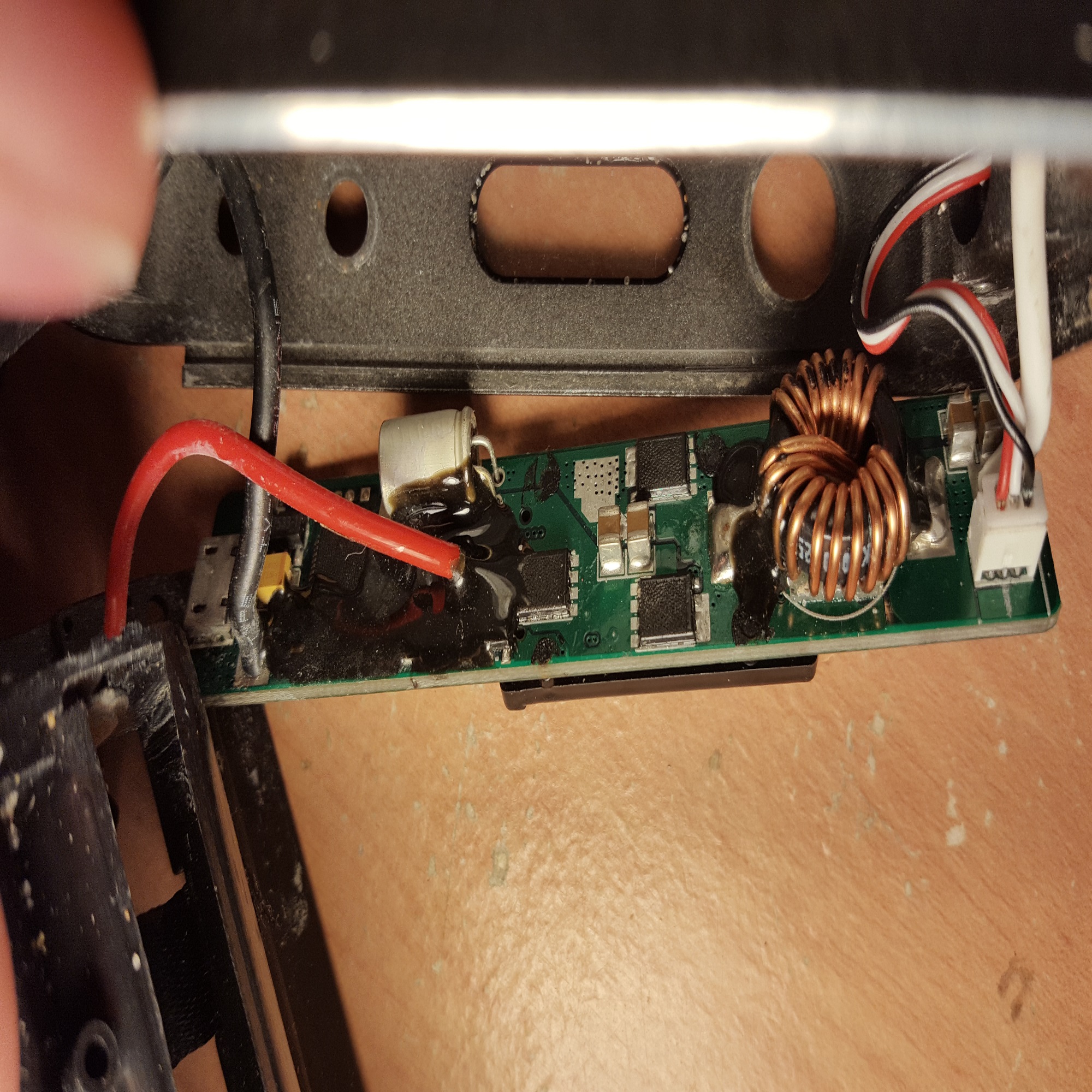

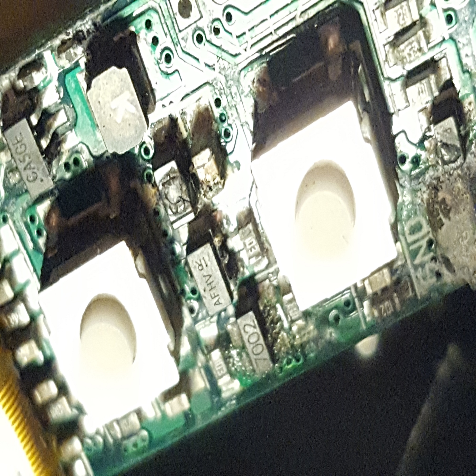

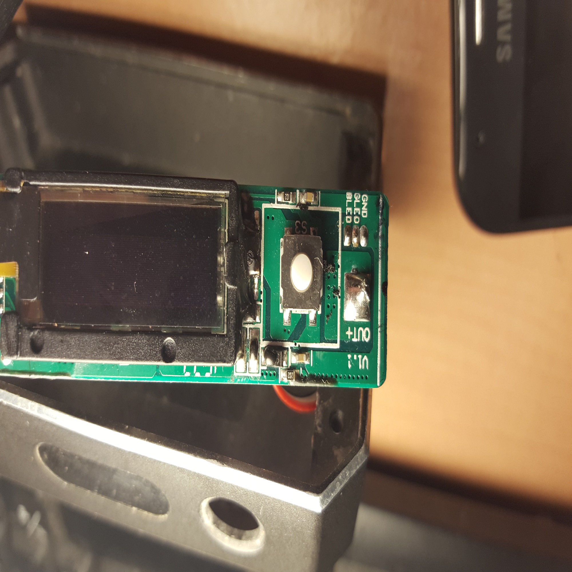

              Ok. Finally! If anyone has a Pic 2 Vape feel free to as what the component labels are, if you have blown components.
              This circuit goes to the 3 wire white connector on the right side of the last picture.

                Aliexpress seems to confirm the 1n5819 number. I will have to solder a through hole diode onto the smd diodes location since I can't wait for it to come from China. Does anyone forsee an issue with that?

                      I put in a through hole 1N5819. Finally got it soldered in.
                      The capacitive/infrared switch STILL does not seem to be working.
                      Then after trying out the momentary switch... SMOOOKE....
                      So it looks like a 8legged AN3102(?) no idea. Googled and can't find it.
                      I looked at the 40(?) leg I.C. Which I had just cleaned with a toothbrush and alcohol-for the 5th time. And there was a tiny solder bead bridging 2 of the legs, I tried for a long time to unbridge them, and finally succeeded-using a razor blade to seperate them while the solder was hot..
                      I've been looking for shorts and have not found any so far.

                          Hello NeedsMoreFlux,
                          When I had a look at the last picture you posted up, I nearly had a heart attack.
                          The brown colored glue smeared on at the factory on the connector side can possibly cause major problems. Please see my 3 posts in another Forum:
                          [url=http://www.edaboard.com/showthread.php?t=371555[/url]
                          (Sorry, but "Insert Link" isn't working for me)
                          How old is the Vaporizer?
                          Is the brown glue flaky and loose around the edges?

                            I'm not sure what you're referring to. I see clear glue near the blown diode. None of the glue is flaky-I think I removed most of the flux. and I see black glue on other components. I'll take another look at the pictures. I've had to set that on the back burner and try to get some of these LCD T.V.s fixed and sold-they are taking up too much space!
                            The vaporizer-I believe it less than 5 years old.
