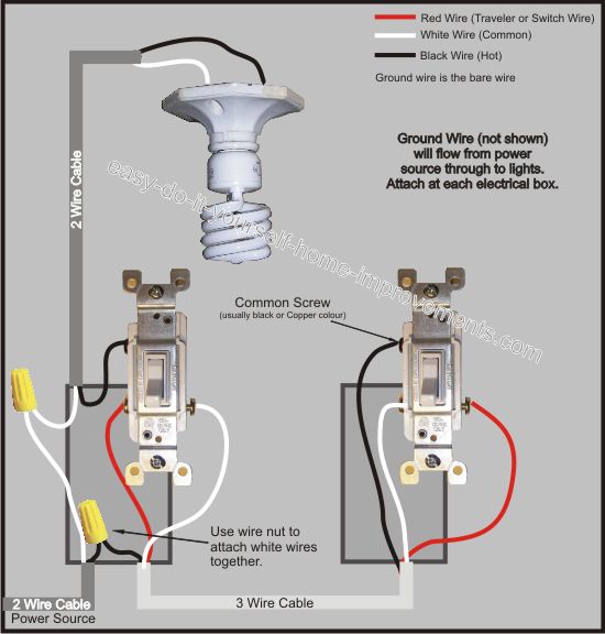

      This might be a bit more work than I realized. I'm looking at these two images that I've just uploaded.
      I see with the 3-way, the hot from the source goes to the second switch, but with the 4-way, the way it's connected to the bulb is different. So I'm probably going to have to undo the ceiling fan / light and mess around with the wires up there and maybe I'm going to have to run a new wire all together...
      I was hoping I could just not touch the wires from the ceiling fan / light, but I don't think that's the case.

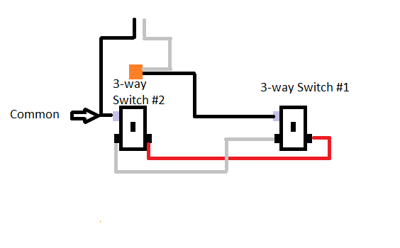

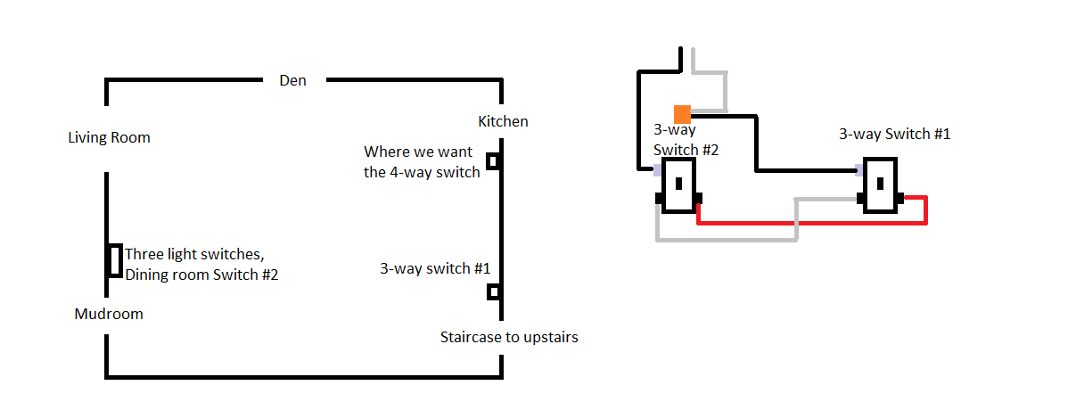

                Here's a crude drawing that I did. There's two drawings. The first is a layout of the dining room. Where there's a cap, that's a doorway to another room (I've labeled them). I drew little black boxes for where the switches are. There's three switches by the mudroom door that control various things. One of those switches is the 3-way switch that controls the dining room light.
                There's a switch by the stairs that lead upstairs. That's a three-way as well.
                I can see how the switches are wired, but with switch #2, there's a Romex 12/2 that goes up the wall. I cannot tell exactly where the wires go without taking the wall down, but one goes to the light. Not sure where the "source" is coming from.
                Also, things aren't wired properly. There's metal workman's boxes, which I don't like. The switch by the stairs has a ground wire that just connects to the screw that holds the switch into the workman's box.
                The switch by the mudroom actually just has the ground wires tied together with a wirenut. We've seen this in other places of the house and fixed them. For some reason, most of the switches / receptacles just don't have the bare ground hooked up. The bare ground is always in the workman's box, and the receptacles that I've looked at so far have a place to hook the ground up to, it's just the previous owner never physically hooked them up. They just use a wirenut to connect the ground coming into the workman's box to the ground going out of the workman's box. I think that's wrong.
                -- Law of Expanding Memory: Applications Will Also Expand Until RAM Is Full

                  I was thinking the easiest, once I figure out where the wires that leave switch #2 go, would be to move switch #1 to where we want the new switch and then add the 4-way to where switch #1 was...you know, put it in the middle, so to speak.
                  From the drawings in post #3 ( https://www.badcaps.net/forum/showpo...20&postcount=3 ), it just doesn't seem like this 3-way switch is wired properly at all, does it? Look at the pic for the 3-way in post #3 and see how they wire the traveler wire. Then see how it's wired in my house.

                        The wiring must be correct, well, it does work?
                        If you replace switch #1 by the stairs with the 4-way and put the displaced 3-way into the kitchen, yeah, should be able to use a 3-conductor wire. You'll need to pass black to the new switch location, else the two sets of red/white goes to the 4-way now in the middle.
                        So there's two bundles of wires that goes to the switch#2, right? One 12-2 where black goes to the switch and white goes to a wire nut to black of the 12-3? That sort of makes sense but indeed confusing... Then the suspicion is that box used to be a 2-way switch that was added on to a 3-way perhaps? If this is the case the power must be going straight to the light and that 12-2 is the control cable?

                          Re: Suggestions for a 4-way switch.
                          Do you think you could modify my PNG image to show how the third switch would be wired?
                          That is correct. That one 12/2, that somehow goes to the light. I know this because I can follow the 12/3 down in the basement. If I buy one of those non-contact voltage detectors, maybe I can make more sense out of it. The 12/3 they used to go between switch #1 and switch #2 is black in colour. In the gang boxes, I can see where the black wire comes up from the basement, into the bottom of both gang boxes. To me, it makes sense that the 12/2 that connects to the switch #2 and leaves from the top of the gang box goes towards the light. I just can't figure out where the actual juice comes from. Could they have the 120VAC wired directly to the light and it's always there, but the switches just control the neutral? Is that possible?

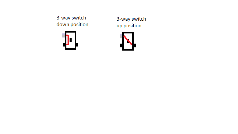

                            I might have this understood now. I'm uploading another picture I've made.
                            On-line, I found a picture where they label the "common" wire, but if I'm understanding it correctly, it's not necessarily a common.
                            In my picture, if we take switch number one, the terminal on the right hand side (where the red wire connects), if we switch switch #1 up, it will be like connecting the red wire on switch #1 to the black wire on switch #1, right? If we switch it down, it'd be like connecting the red wire on switch #1 to the white wire on switch #1.
                            Looking at the diagram, I'm thinking if I were to take that 12/2 that goes into the gang box on switch #2 and just remove all the 3-way switches and wire those two wires together directly, the light would be on. Is that correct?
                            I'm still a little confused those. Take a look at switch #2. If that's down, that would connect the white wire on switch #2 to the red wire on switch #2, right? If so, I don't see how switch #1 could control the light at all, if switch #2 is in the down position....
                            I've uploaded another diagram that I think explains how the switches actually work. But if this second diagram is true, I don't understand how the light turns on if switch #2 is in the down position, regardless of what position switch #1 is in.

                              I believe I figured it out! I tore the old broken one apart to see how it works and now it makes sense to me. In our house, the light is on only if both switches are down or both switches are up.
                              This is how the connections are made if it's in the up or down position. Now the wiring diagram I look at of how it's wired makes since.
                              My wife is going to go purchase a non-contact voltage detector, but if I understand this, that 12/2 that leaves the top of the gang box on switch #2 is the secret. One of the wires goes directly to the light and the other one goes to the breaker (either a neutral or a hot wire). The wire that's connected to the light always is the opposite of whatever the wire is that goes to the breaker.
                              If the switch is controlling the hot wire that goes to the light, then if I turn off the light, I should be able to use that non-contact voltage detector to determine if it's the black wire or the white wire on the 12/2. Now I just gotta find a torn apart image of the 4-way switches to see how they work.

                                Yeah, the 3-way switches are SPDT switches.
                                The 4-way switches are DPDT switches wired as crossover/straightthrough switch.
