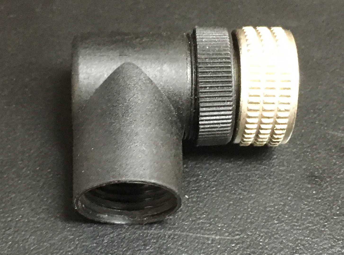

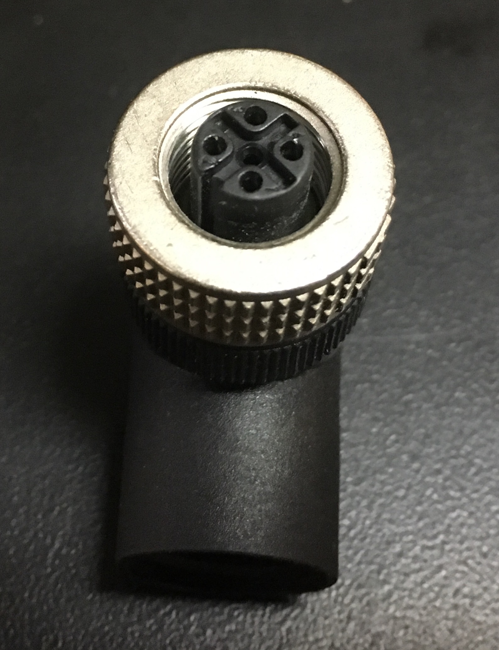

What type of sensor connector is this where can I buy some
    • Jul 2011
    • 6039
    Here are some reason photos of this connector
    Thanks to anyone that can help

    Re: What type of sensor connector is this where can I buy some
    It's a connector for a Siemens induction sensor.
    Probably: 3RX1-502 or something similar.
    See here in the catalog:
      Your pic looks like "M12 Eurofast" 4-pin female, right angle.
      Those are a common European connector used in industrial automation and sensors, fieldbus.
      Not popular in North America because they are expensive and the pins break off easy.
      Digikey has some by Amphenol, TE, I usually get them from Turck
      There are 4-pin, 5-pin (shield), molded/sealed cordsets for water proof, zillions of variations on them.

        Thank you for the info

          Thank you for the info it is a m12 connector
