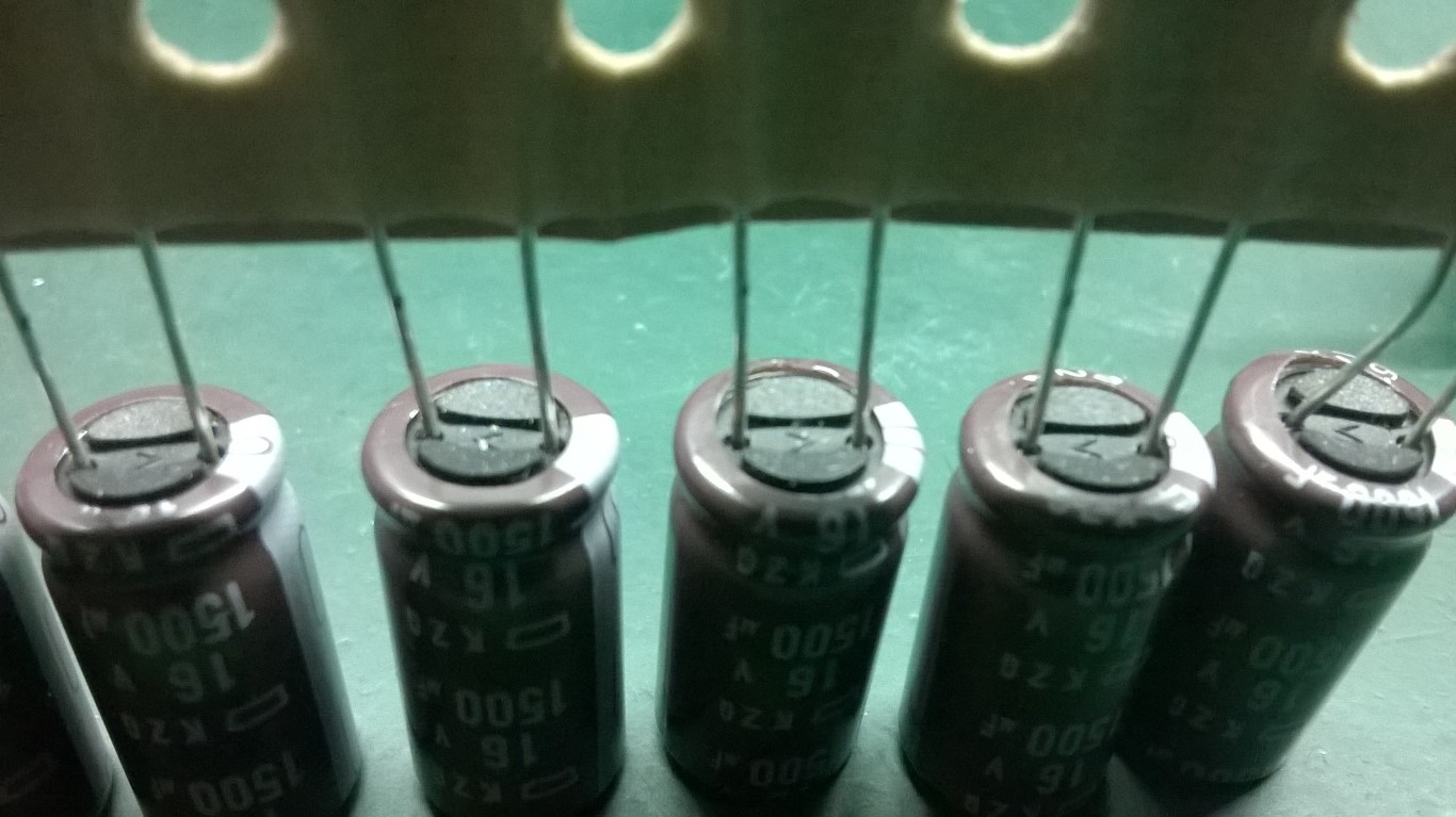

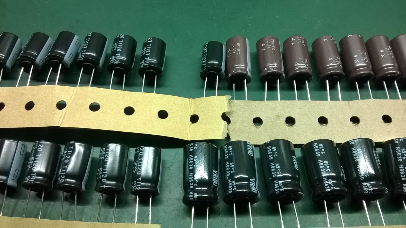

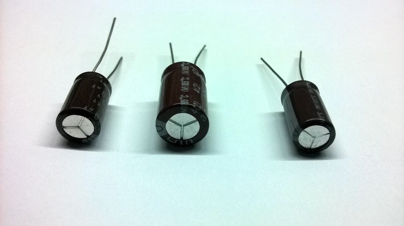

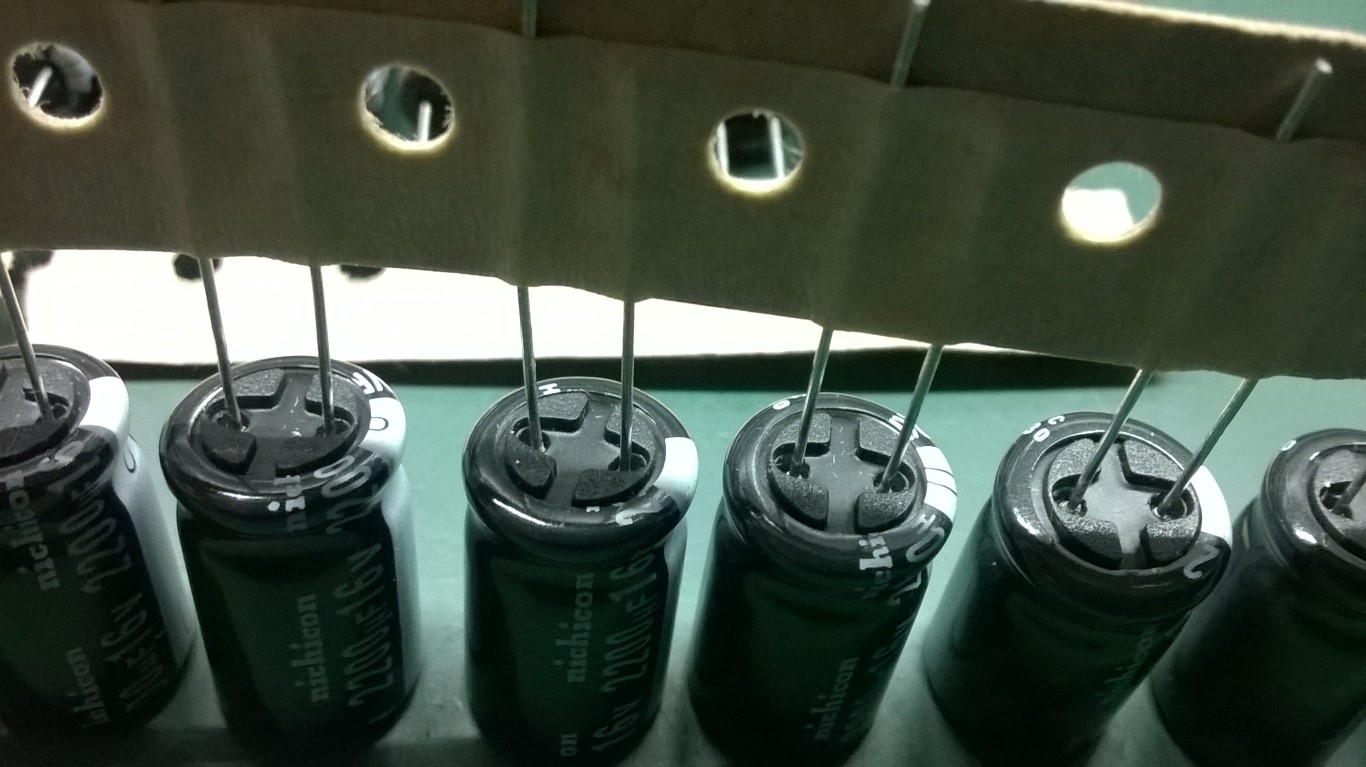

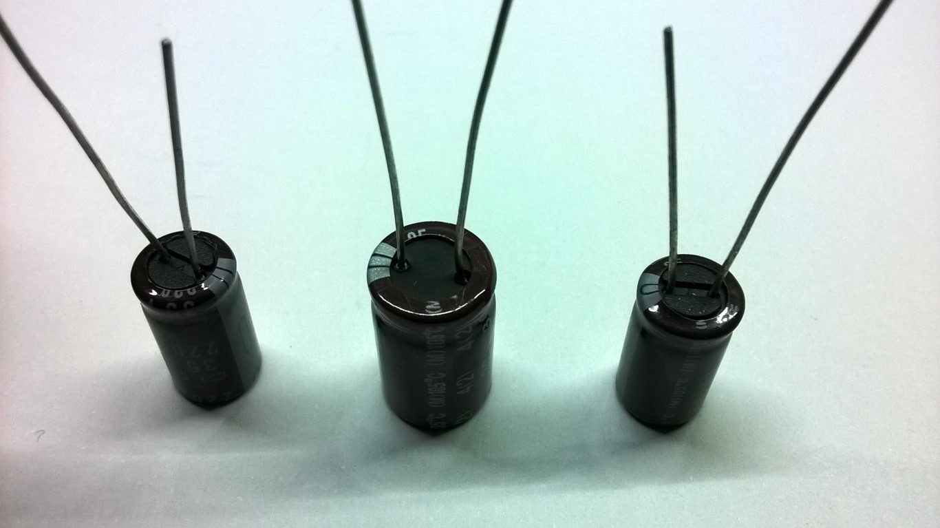

    Here i have a few caps that i got at aliexpress some years ago most seem original to me, what do you think?

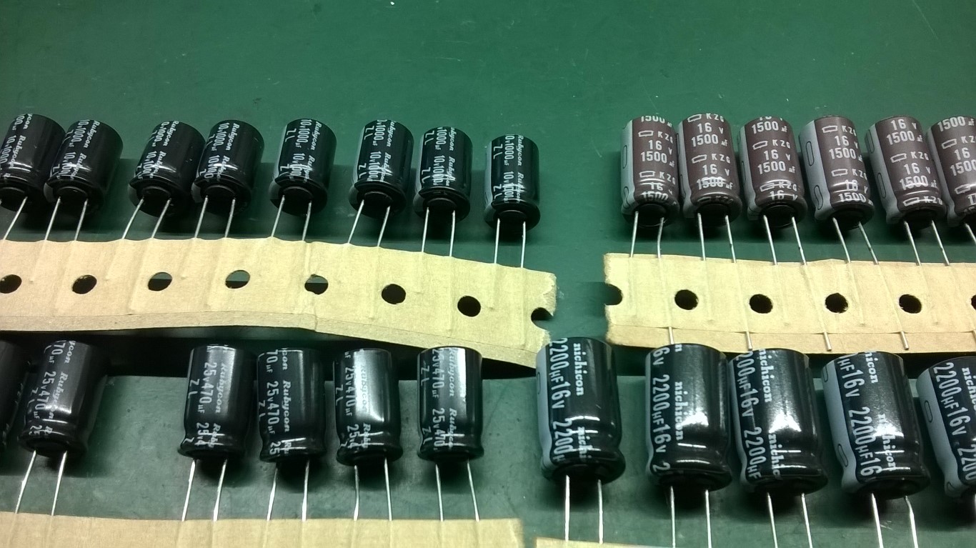

    nichicon VR(M) 2200 16V (in tape) --> original to me but no low ESR model
    nippon chemi-con KZG 1500 16V (in tape)--> original to me, but unreliable series

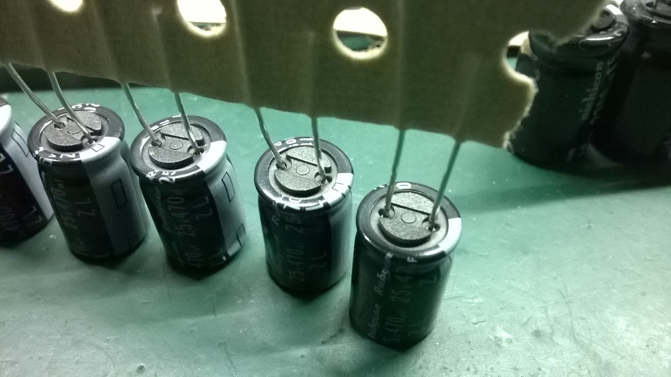

    Rubycon ZL 470 25V and 1000 10V (in tape)-->original to me, good for PSU

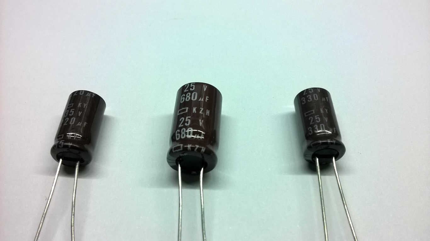

    nippon chemi-con KY 220 35V and 330 25V (in a bag)-->original to me, good for PSU
    nippon chemi-con KZH 680 25V (in a bag)-->FAKE rubber base without markings
    All caps seem to meet the specs, even the one i think is fake (at least when unused)

    The Rubycon and Nichicon don't look like counterfeit. The KZG could actually be counterfeit too, but I'm willing to bet counterfeit KZG are better than the real thing. Aliexpress is about as bad as eBay and Amazon, with respect to counterfeit caps. Best to stick to authorized distributors, which will immensely lower the chances of counterfeit caps.

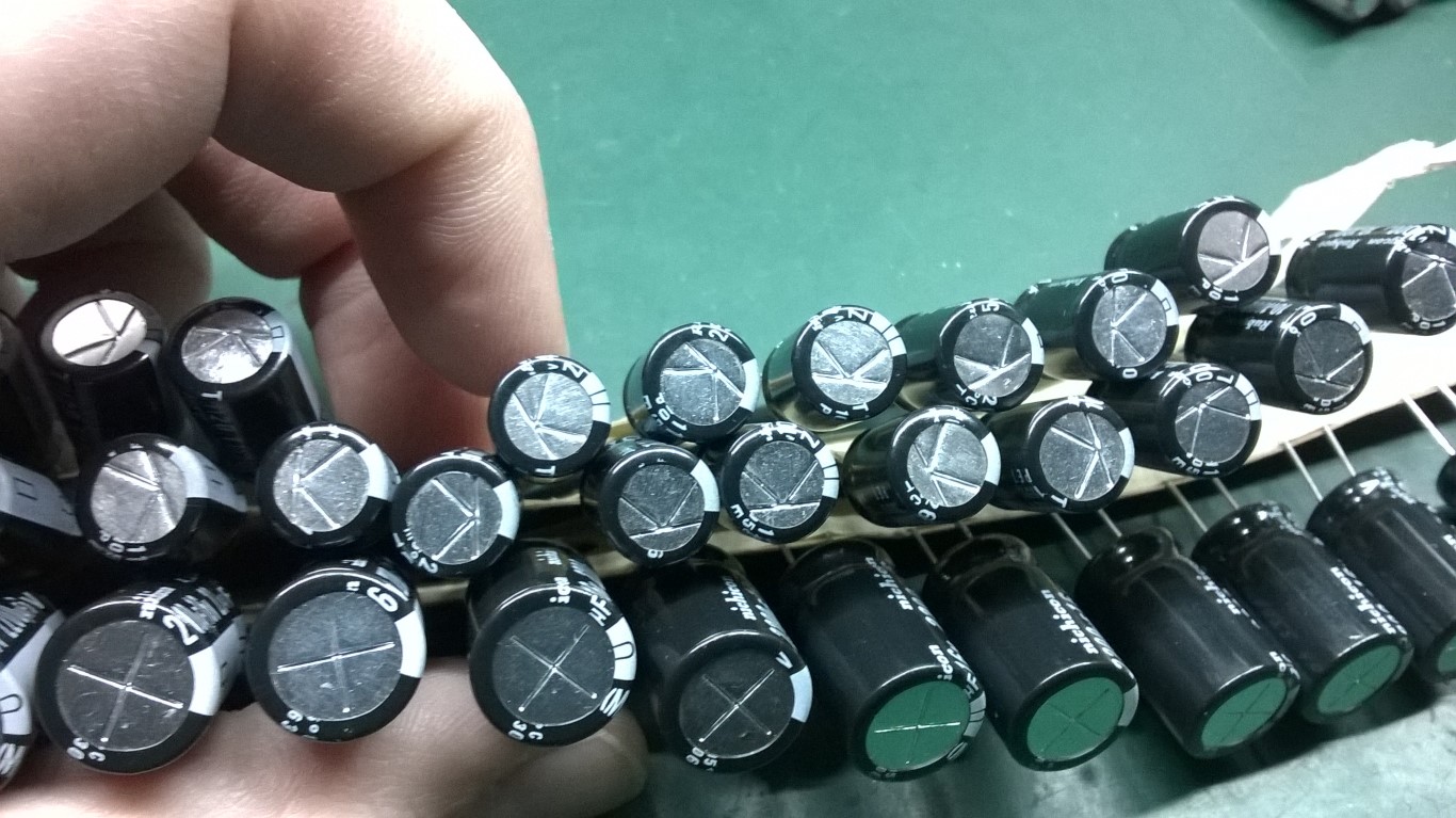

      at least the sleeves on yours look intact. the suncon wg i got off aliexpress had the sleeves flapping around on top around the vent while others had the sleeves flapping around on the bung. either they are genuine factory rejects because the sleeve wasnt formed properly around the cap case (the sweatshop worker doing the sleeving was a nub) or someone resleeved them and did a terrible job.

        Lots of them look real but i wouldn't risk putting them into anything.
        I have a few fake sanyo [suncon] capacitors.
