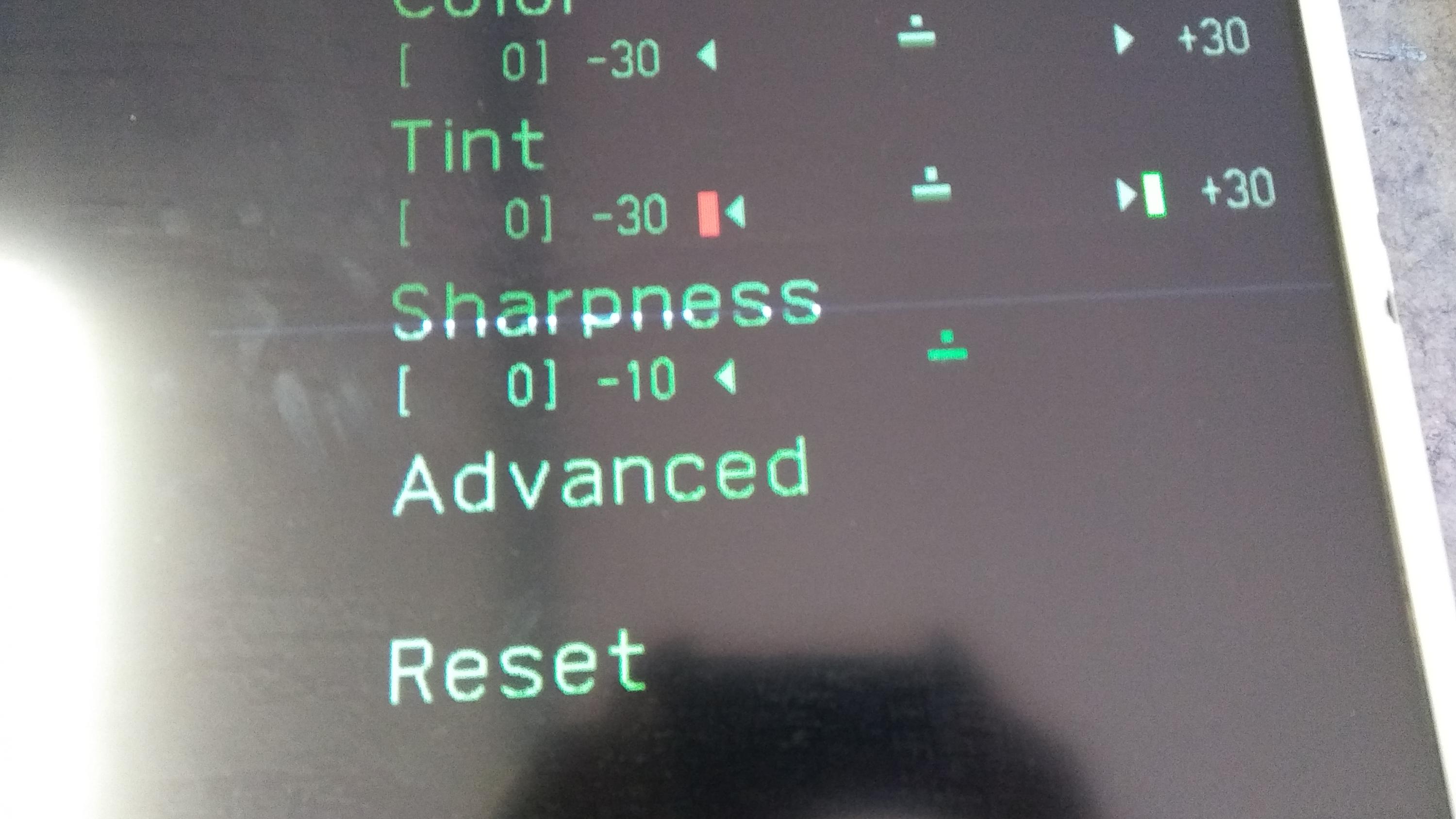

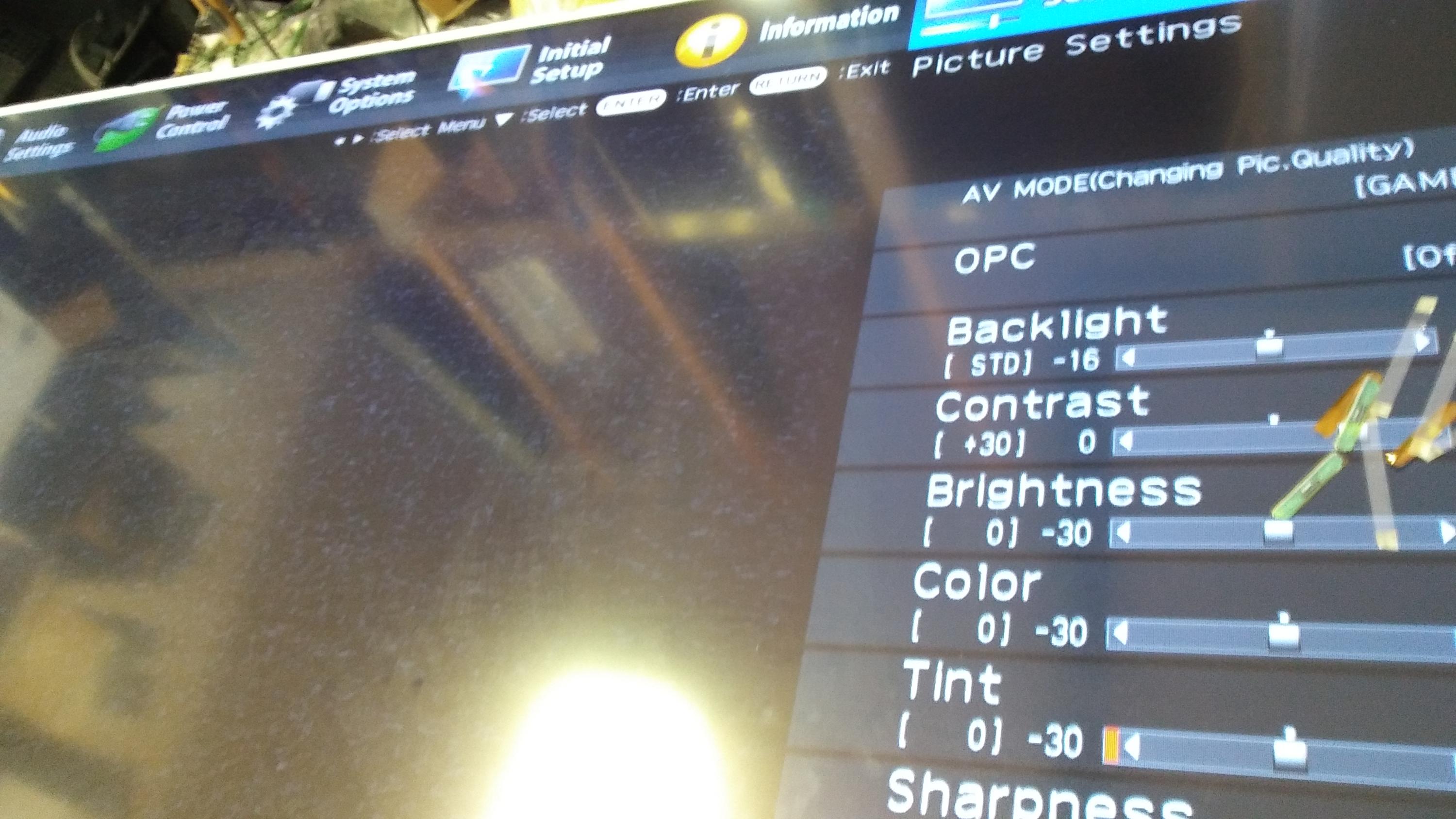

    This Sharp 60 edge TV came from other shop, has been opened and try to fixed, quoted it $280, think-less said YES, after I change LEDs TV light up, but right-side image has bar on it, I read this Tips, cut the 3 taps of one-side of screen. First i am hesitating to do it, finally I cut it and TV has been working for 3 months. Whose tips is this?
    PS: Do not understand why he will cut off the tabs, Isn't the resolutions will down to half? but customer never complain about it?
