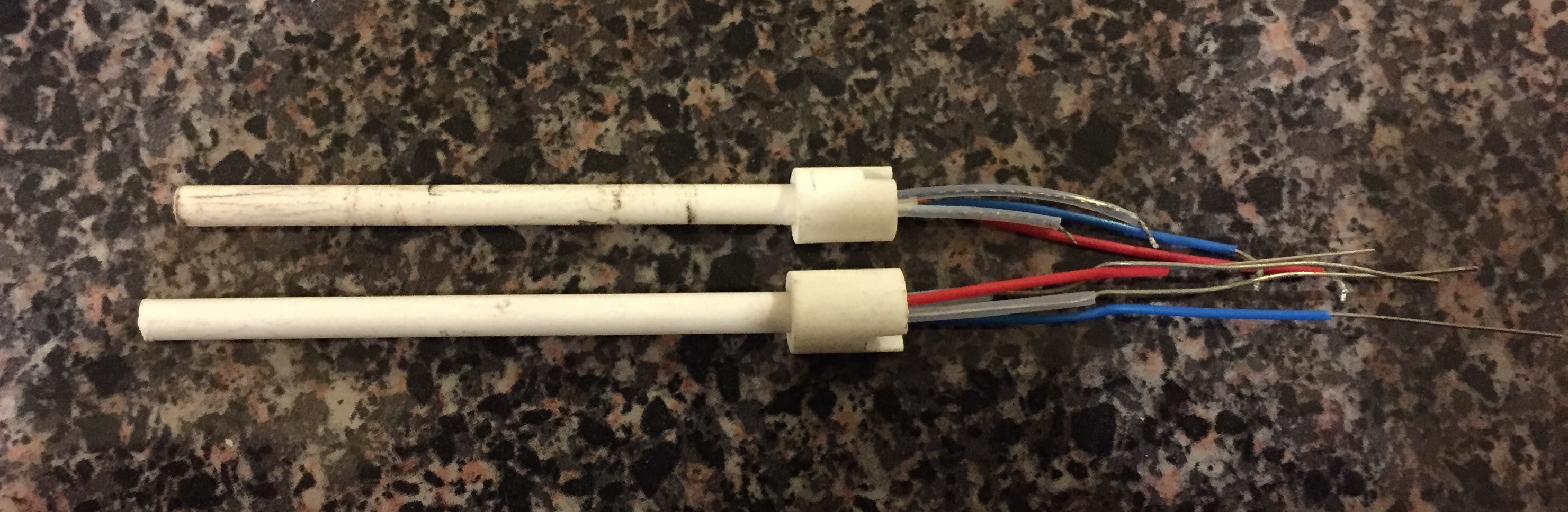

    Ordered some replacement heating elements for my soldering iron. Went to install one and noticed it's longer than the other by a little.
    The instructions are in Chinese so I have no idea what it says. Can it be trimmed? If not will it affect function?

    isnt the element mounted on a spring so it can push in a bit? some are.
    • caphair
      • Nov 2011
      • 1249
      Re: Replacement heating element too long, trim?
      Yeah it's pushed in all the way
                      I could only find a US seller that sold entire handle so purchased that but it seemed of lesser quality.
                      Shorter cable, thinner, different feel.
                      Found heating element on eBay in china for original handle so figured I'd get it so can have original feel I was used to but when I soldered it in I ran into that problem

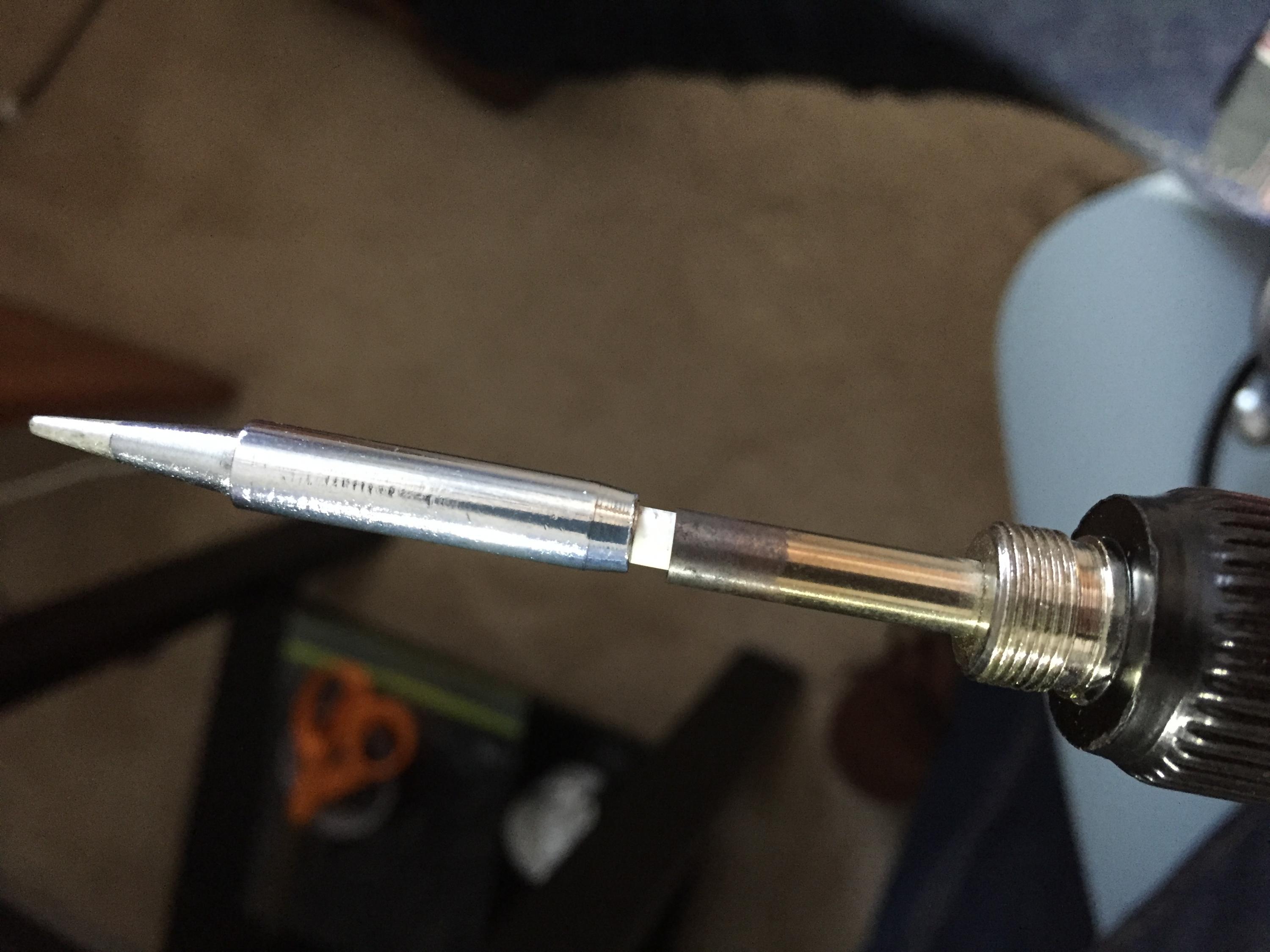

                        I tested it and it seems to work fine. I'm wondering if I alter the little indents on the bottom that seat into the soldering iron PCB if it would be safe to use?
                        See here the top is original and bottom is the replacement which said is for the 852D+ station. I also just noticed the original iron had writing that faded and all I can make out is "907" and the last letter I think was an "A"
                        Should I be looking for a heater element for a 907A instead of the station 852D+?
                        The iron as a whole just looks better quality compared to cheap alternative I got for $7 which was entire assembly but the wires are shorter, cheaper plastic, no labels and I noticed I need to crank the temp up higher than I did with the original.

                                Thanks. My concern is the resistance of the heater and sensor. Would it hurt anything if not exact to original? I can't take a measurement to compare since original is bad
                                • caphair
                                  • Nov 2011
                                  • 1249
                                  Had someone with a 907a iron measure heater resistances for me
                                  Heater - 14.4 ohms
                                  Sensor - 1.0 ohms
                                  My replacements measure
                                  Heater - 14.6 ohms
                                  Sensor - .8 ohms
                                  So close enough. What I ended up doing was trimming the holder slots on the iron PCB so heater sits recessed as needed.
                                    What I'm noticing now is solder is melting at a lower temperature than it was with the old entire iron assembly I had (not original iron that came with the system). I can melt leaded solder with a beveled tip at 155c where with the other one it would have to be set to around 230c. Is something wrong?
                                      There are two types of heating elements for these irons, depending on how accurate your knockoff is compared to a genuine Hakko. One is a standard wire resistive heater with a thermocouple (cheaper) and the other is a ceramic heater with a thermistor (like the genuine one)
                                      If you had the wrong type, I'm not sure exactly what would happen, but the heater either running full power or not at all would be my guess, because a thermocouple outputs a voltage, and the thermistor will change resistance, so you're measuring two completely different properties and a circuit designed to use one will be completely incorrect for reading the other.
                                      If the iron does regulate and you can actually adjust the temperature, but the numbers are 'wrong', then it sounds like you have the right type of heater, but something isn't quite the same as the old one (I suspect cheap Chinese knockoff heaters for cheap irons don't have very tight manufacturing tolerances )
                                      You probably just need to recalibrate the iron. There should be a calibration\adjustment trimpot on your soldering station somewhere. Obviously you will also need a known good thermometer.
                                      -David VanHorn
                                      • caphair
                                        • Nov 2011
                                        • 1249
                                        Yeah I thought maybe it's just fully on or off but if I keep it set to 100c (the lowest setting) solder doesn't melt, it doesn't start to melt till I hit 155c and if I try melting lead free solder it doesn't melt till 200c
                                        So definitely lower than I'm used to. Before I'd have to crank it up higher to just melt solder and really crank it to solder on a PCB. This is with the knock off entire soldering iron assembly. I don't remember the number for original heater that came with the station.
                                        Is a thermometer accurate enough to measure soldering iron temperature? I have an infrared type.
                                        I do like that at lower temps it's hot as it leaves me plenty on the dial to increase if ever need be. Just worried if it'll ruin the station or not.
                                        Don't want to start calibrating inside the station as I'm not even sure which heater is best suited for it lol
