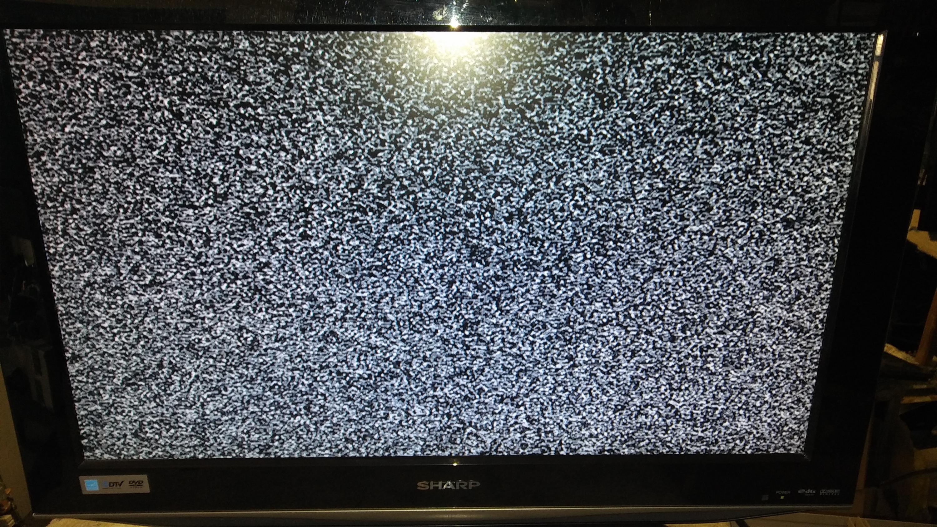

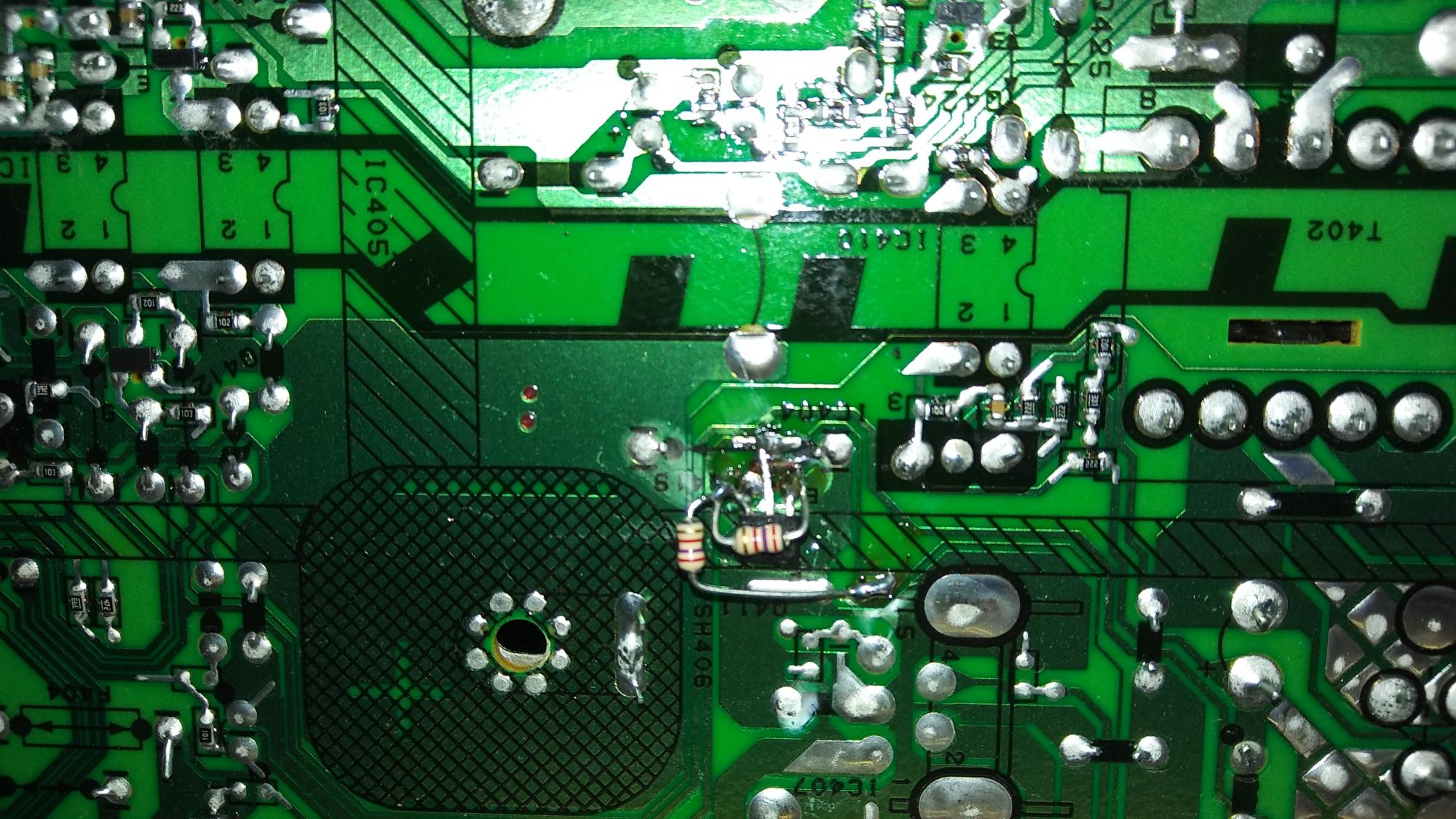

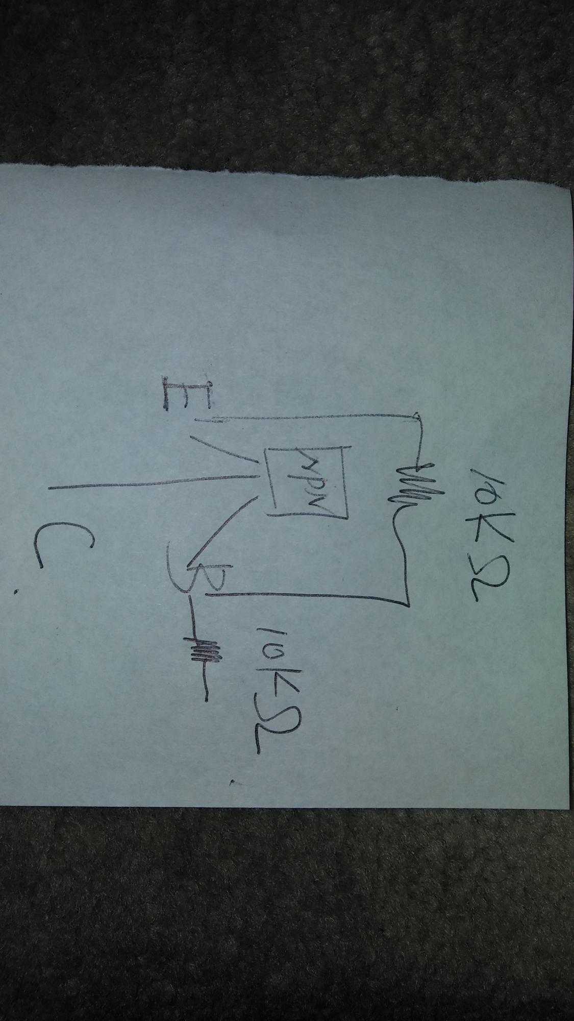

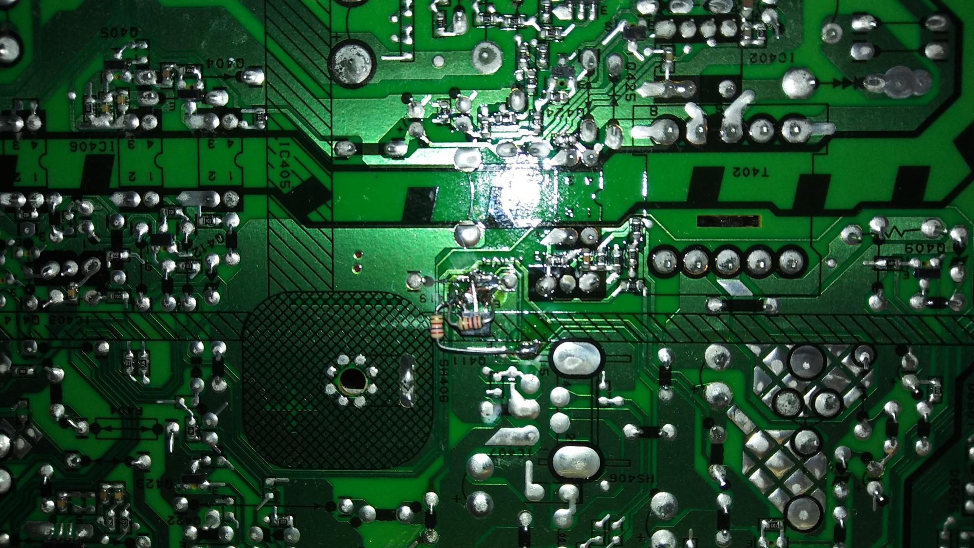

    I have A redo on LC-26DV24U, after had changed Q413, original problem is white screen, now indeed needs to change Q419, is A COMPOUND TRANSISTOR, I used npn Tr (2sc1399 found it on junk PCB near by me) + two 2.7k (should be 10k) resistors , finished the redo. ..........

        Re: Sub COMPOUND TRANSISTOR with NPN.
        For experiment, I put only NPN Tr with no resistor TV works, I put resistors is for better characteristics, this Tr is for switching 12v panel voltage.
        To stock compound Trs or digital transistors is not easy, so many types of variation are there, Seems Panasonic, Sharp and Sony love to use those parts?

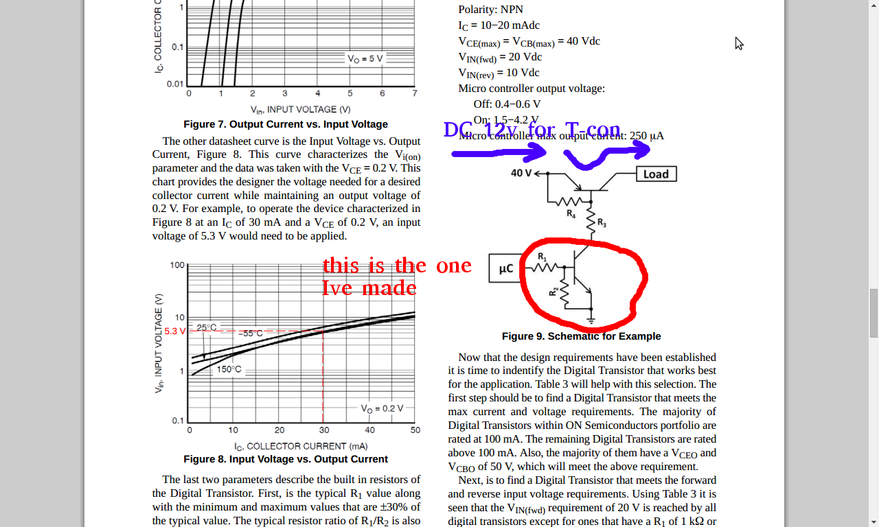

              Thanks for the information, pic1 circuit is as same as Sharp LC-26DV24U TV's Q419 ( COMPOUND TRANSISTOR, driver for another PNP switch Tr Q413).

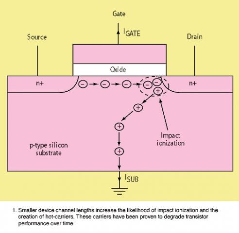

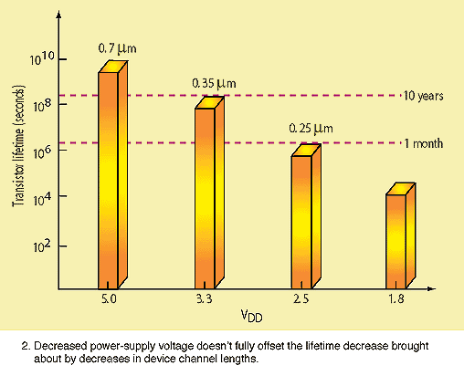

                One question is why Q413 after 10 years and failed? aging transistor decline??
                Transistor aging:
                http://spectrum.ieee.org/semiconduct...ansistor-aging
                PIC1: the different physical mechanisms of transistor aging. Semiconductor engineers measure those aging effects primarily by examining transistors one at a time, using microscopic electrodes to probe a silicon wafer.
                Circuit Aging: A New Phenomenon For SoC
                http://electronicdesign.com/products...on-soc-designs
                  How much current and inrush current does the T-CON board require?
                  Same failure also happen in the 32"version.
                  10 Years is not that bad if the part is used at max spec.

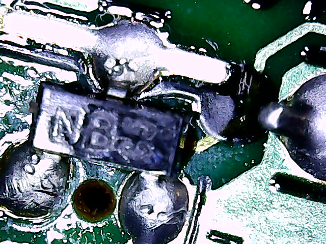

                          Hello
                          Got this speaker from a friend , defective. Power led comes on and off , in a loop.
                          Disassembled, got the board out, and after a bit of measuring I found a low resistance on a 5v6 line. With a bit of current I found a transistor heating up on that line (labeled T1 and 113 as on pic).
                          After removing this guy, I got a value of 0.7 in diode mode on that 5v6 line, which before had 0.02 or something like that.
                          I tested powering it up without the IC, and the speaker turns on and stays on, and works fine
                          Still, I need to replace this transistor....
