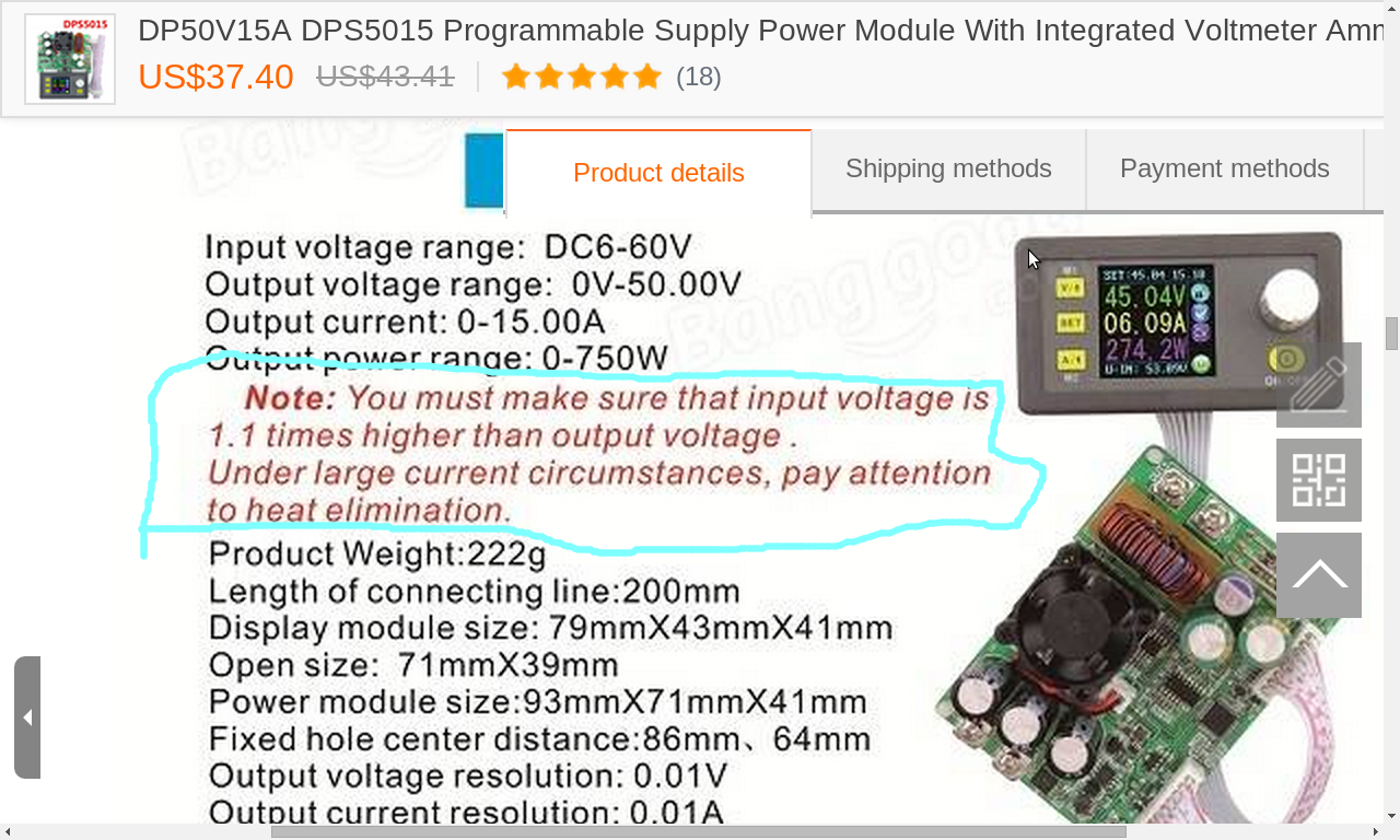

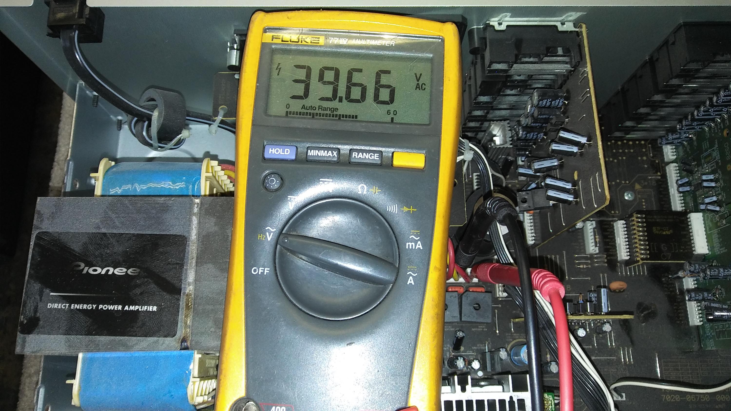

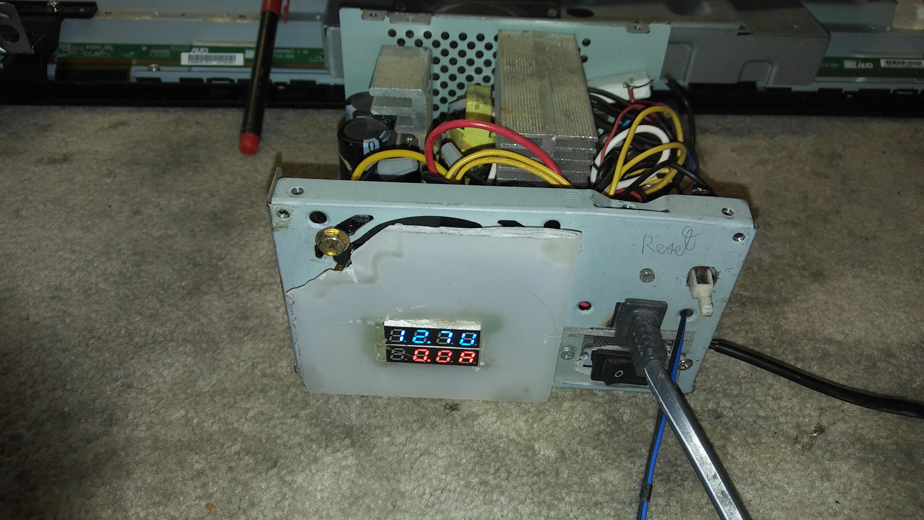

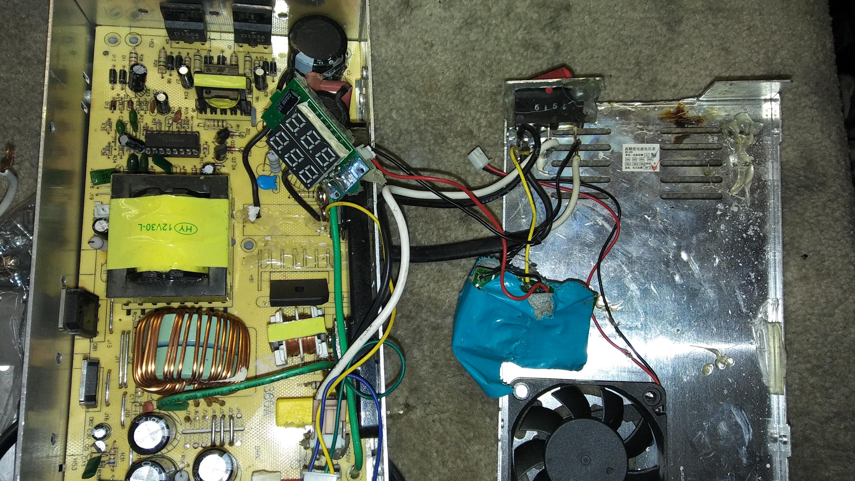

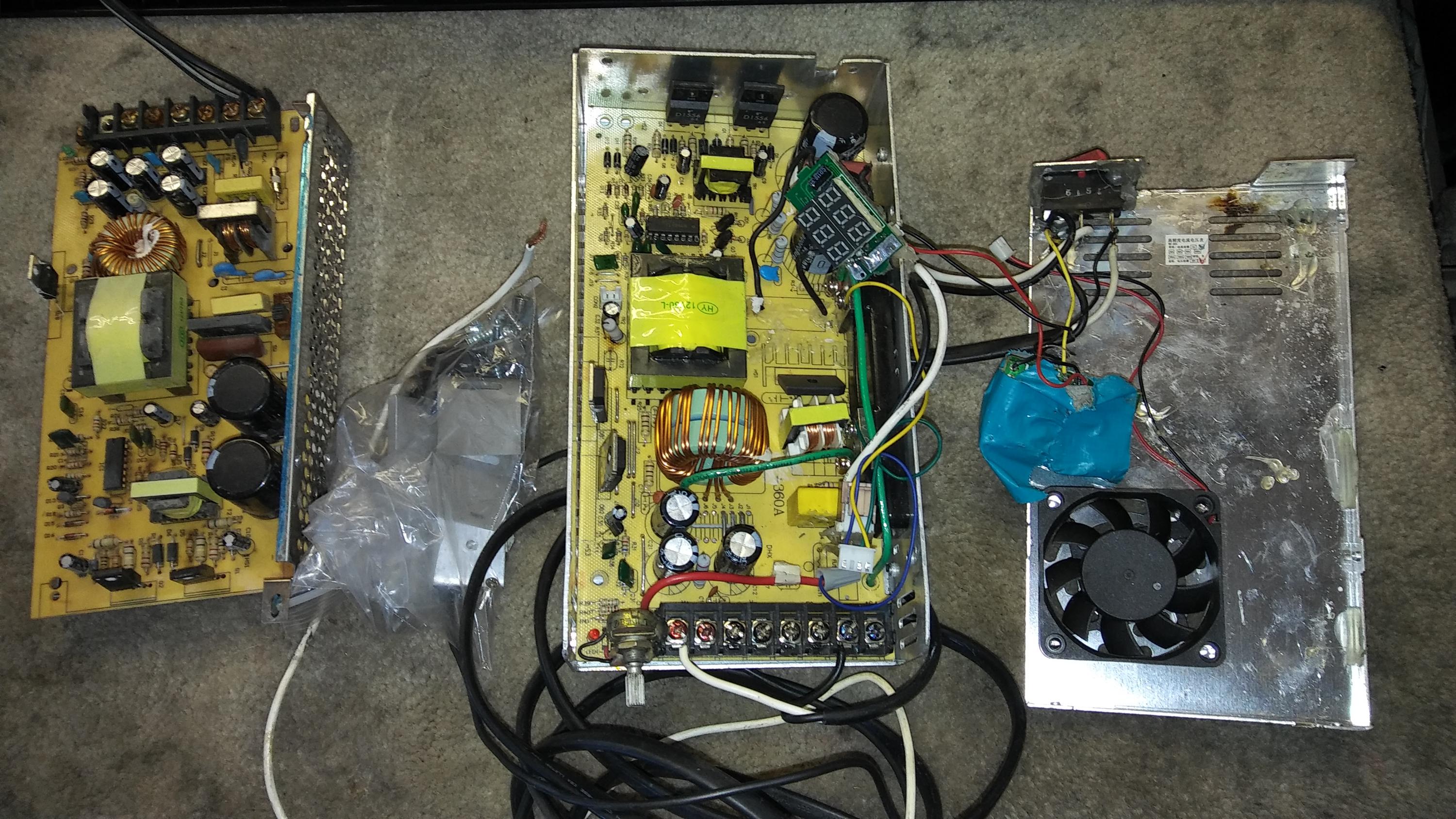

                Re: XL7005A vs XL7005

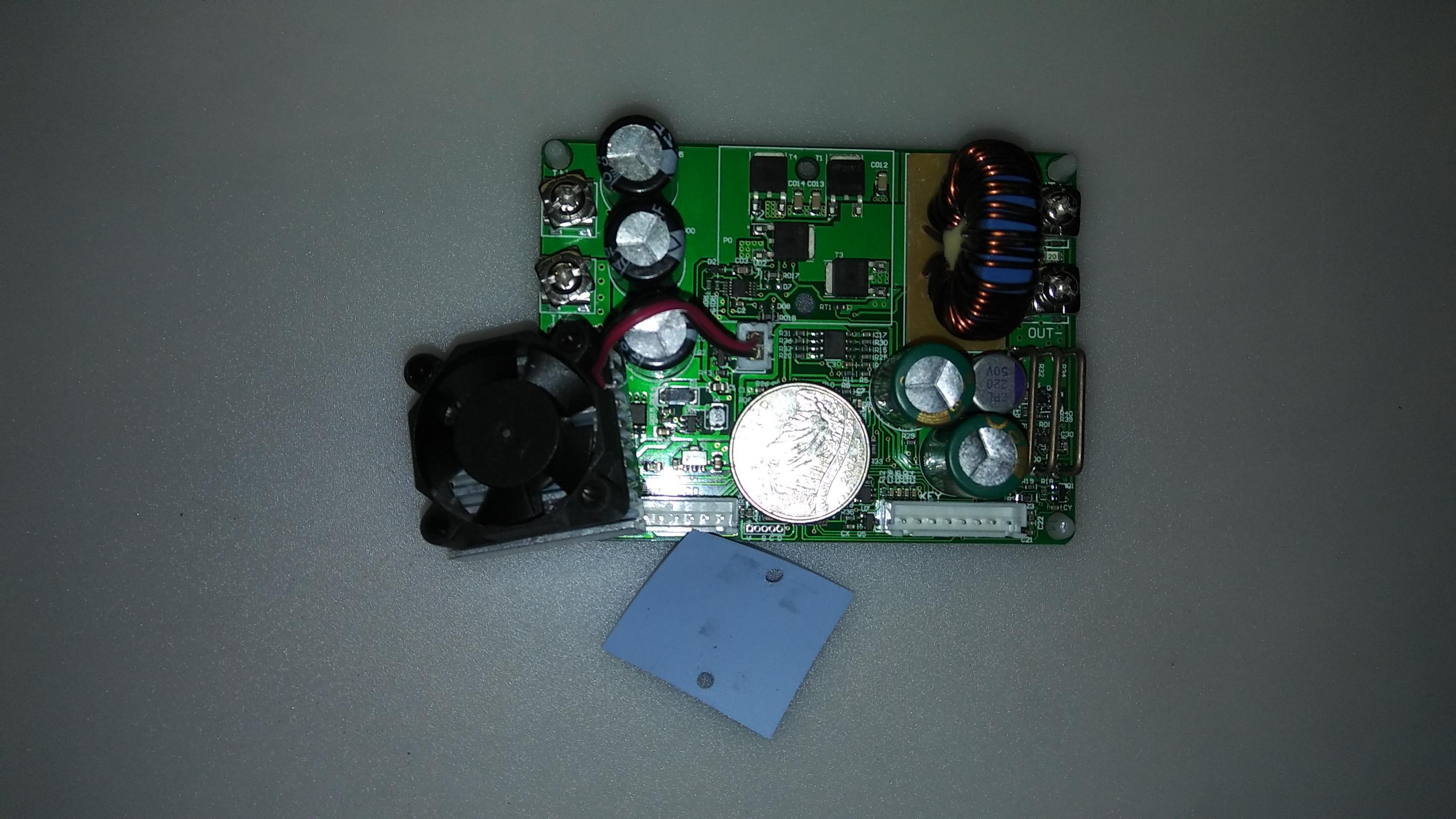

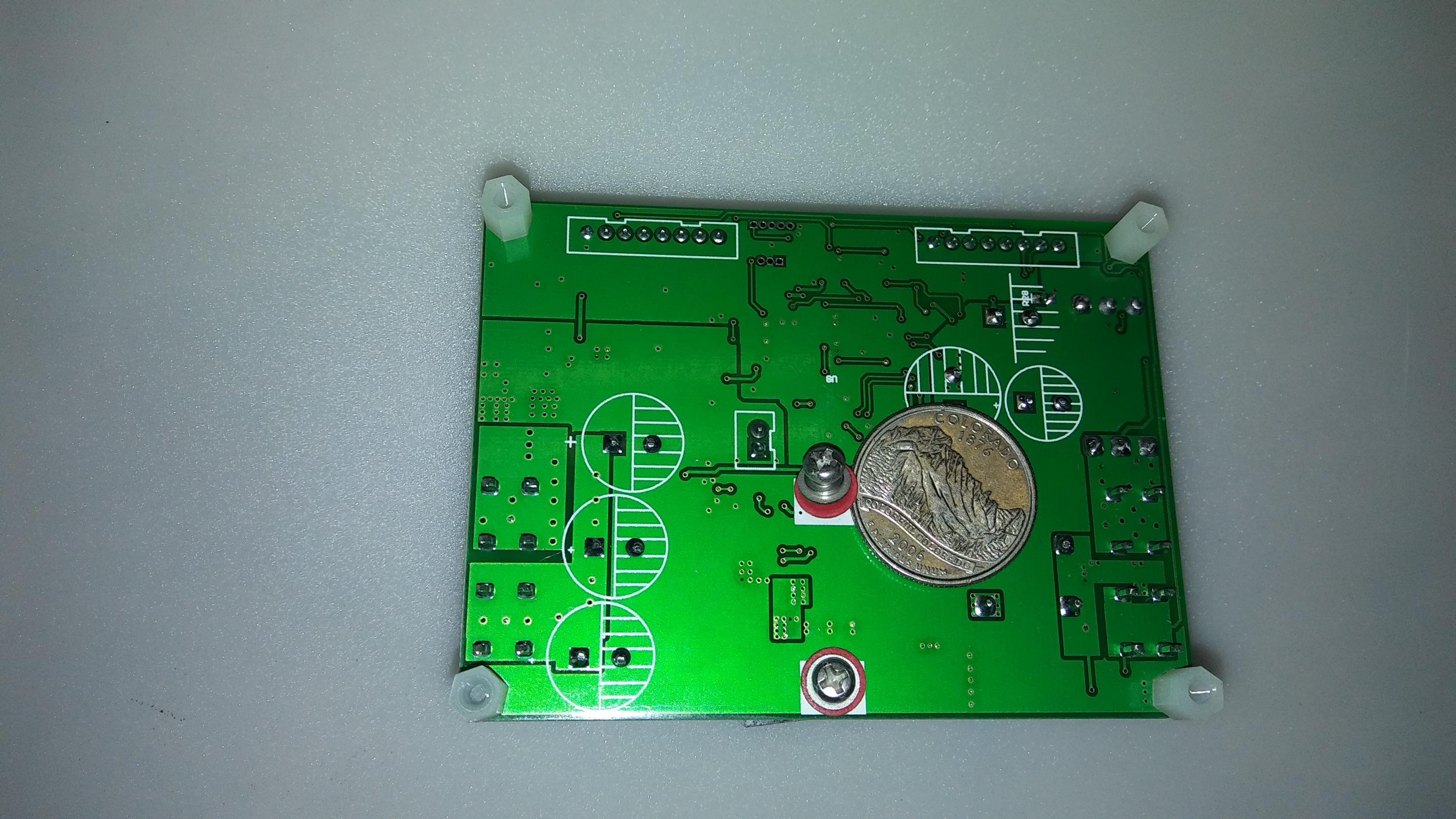

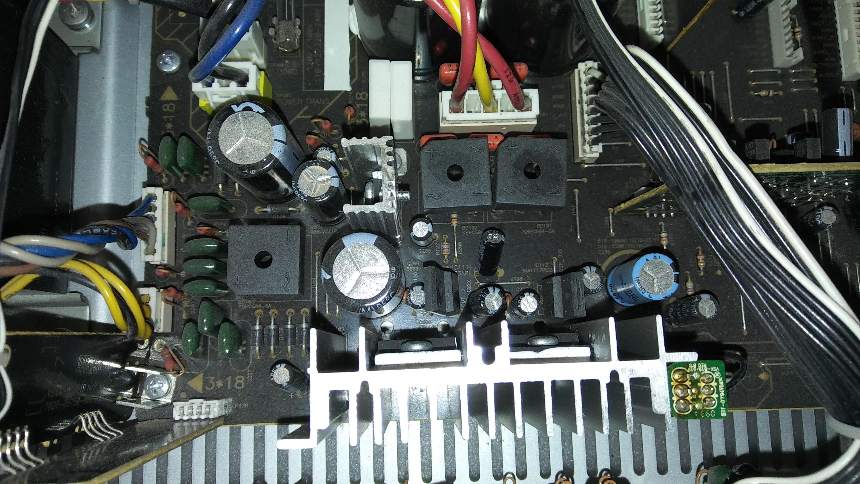

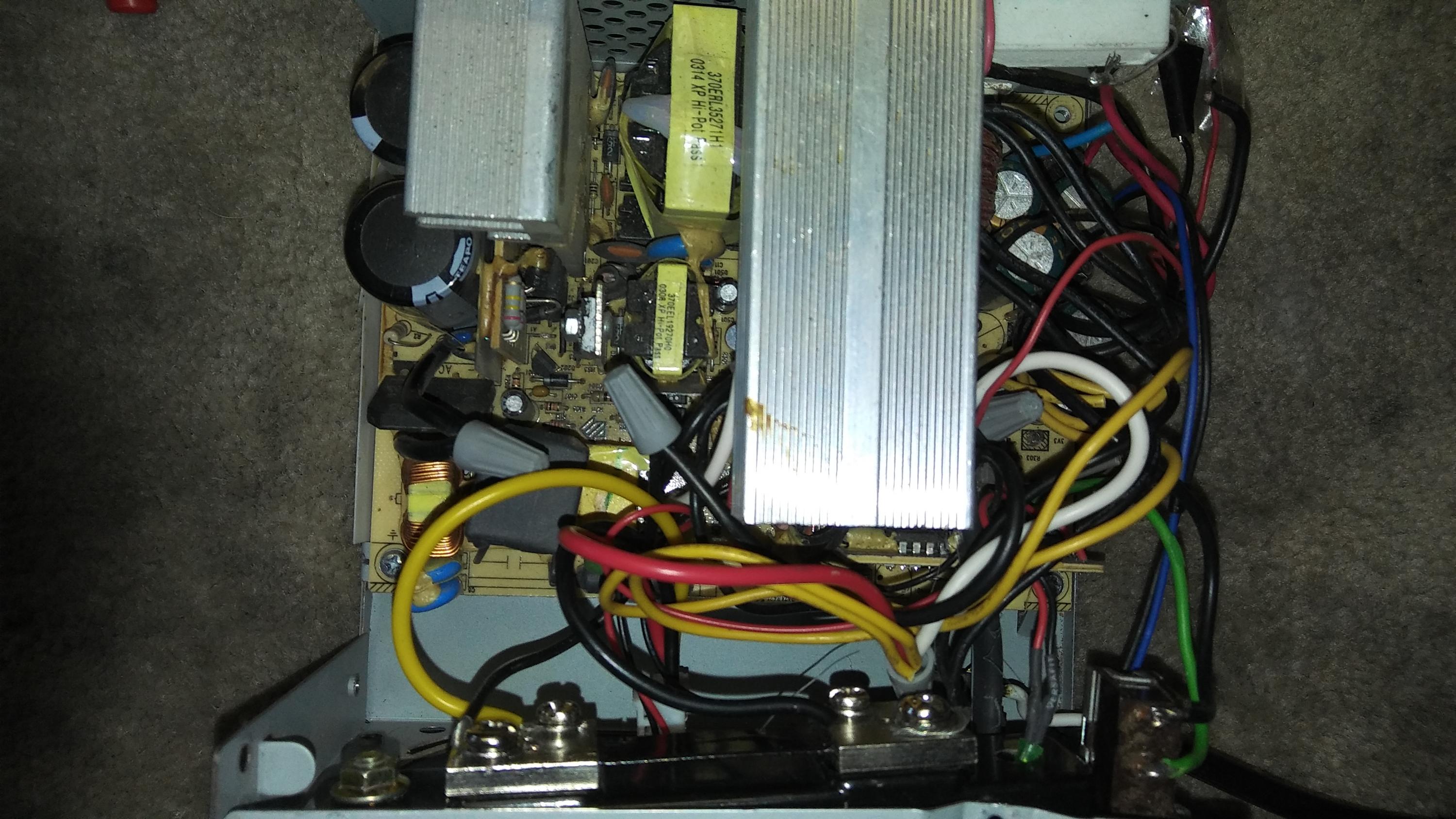

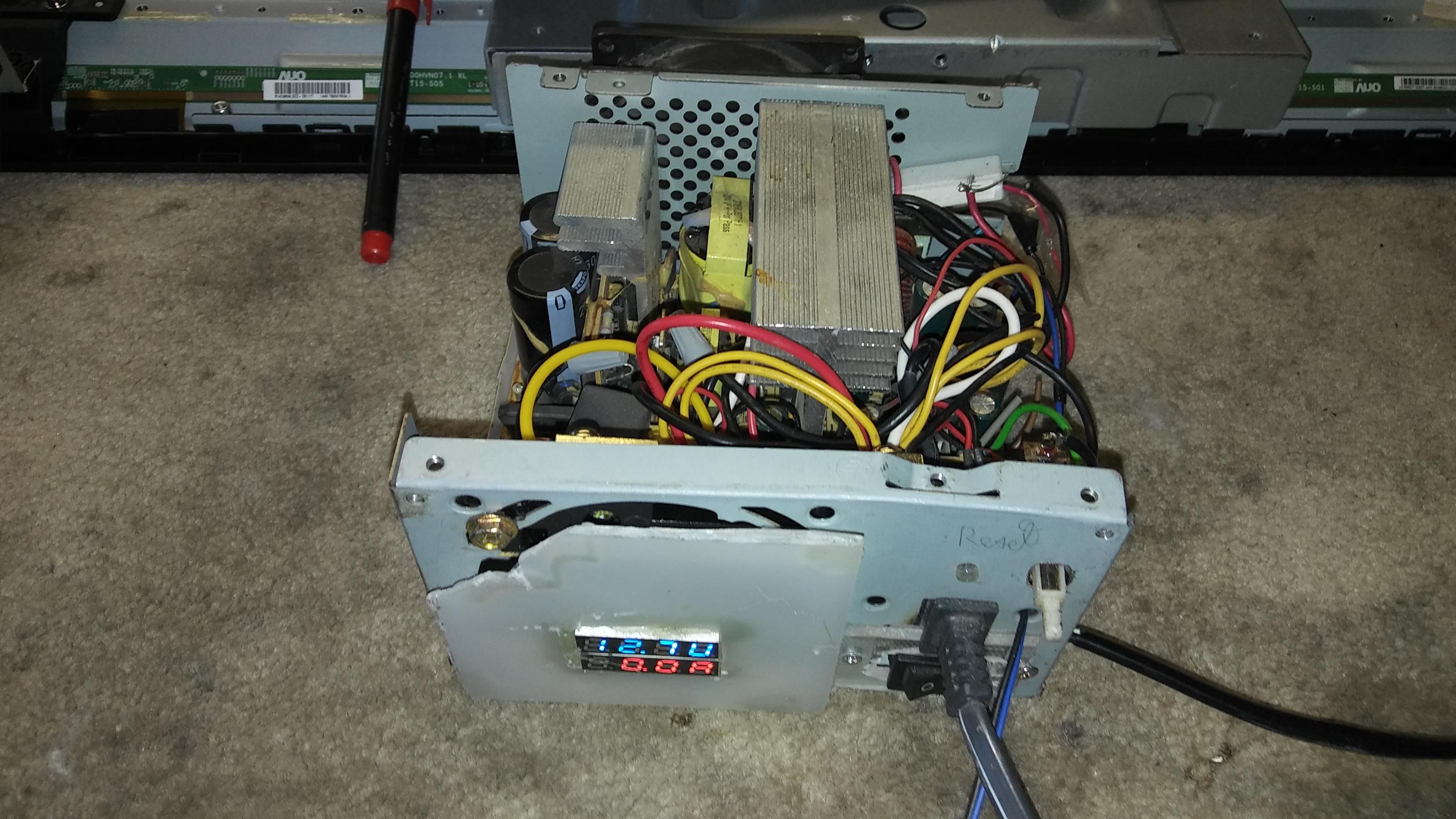

                Pic1-2 those are junks, now i test 12v car amp is use this pic3-5 ATX power supple, customer face looks strange, so I will use old stereo amp. build power supple right inside the DENON's case......

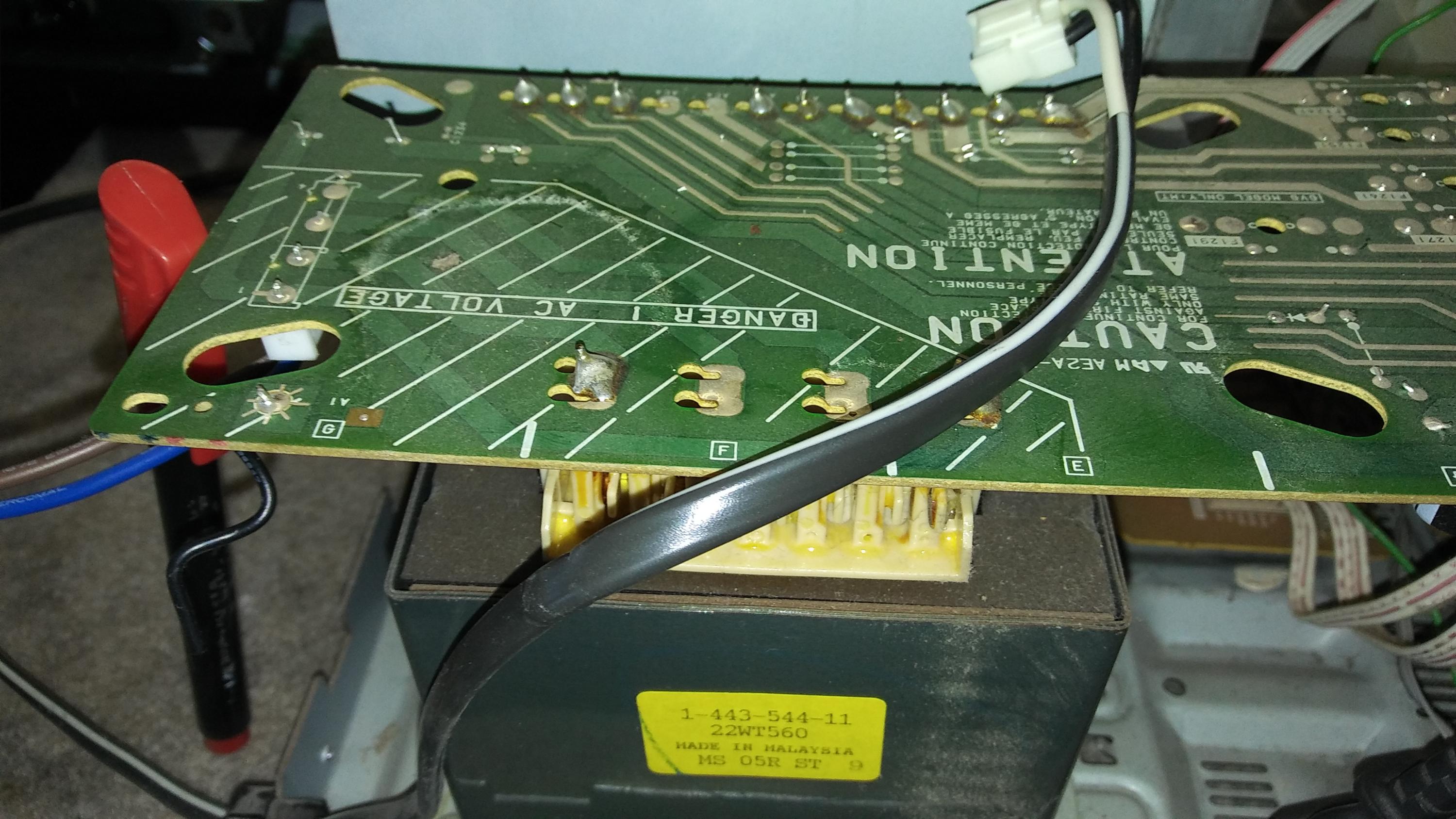

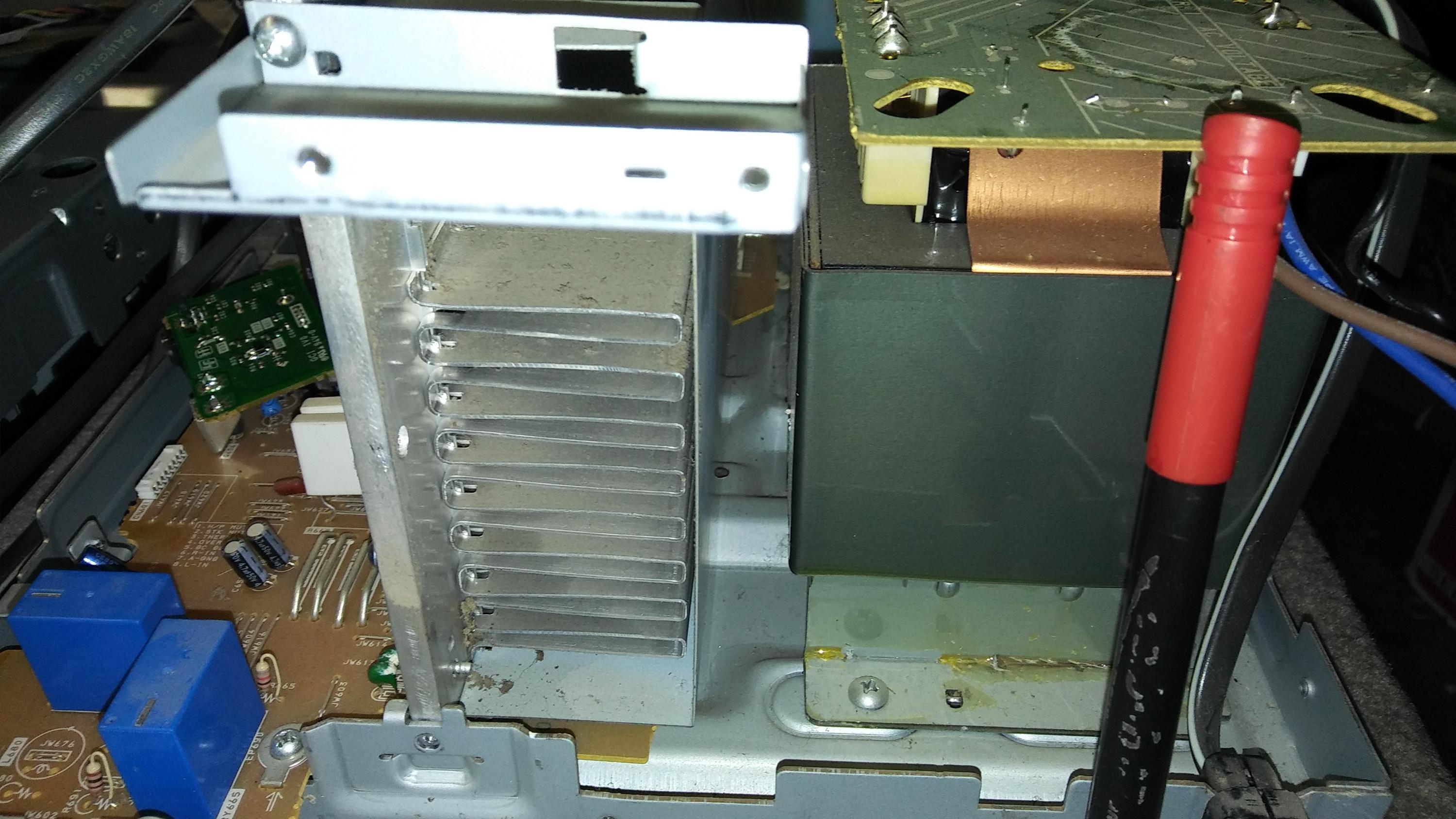

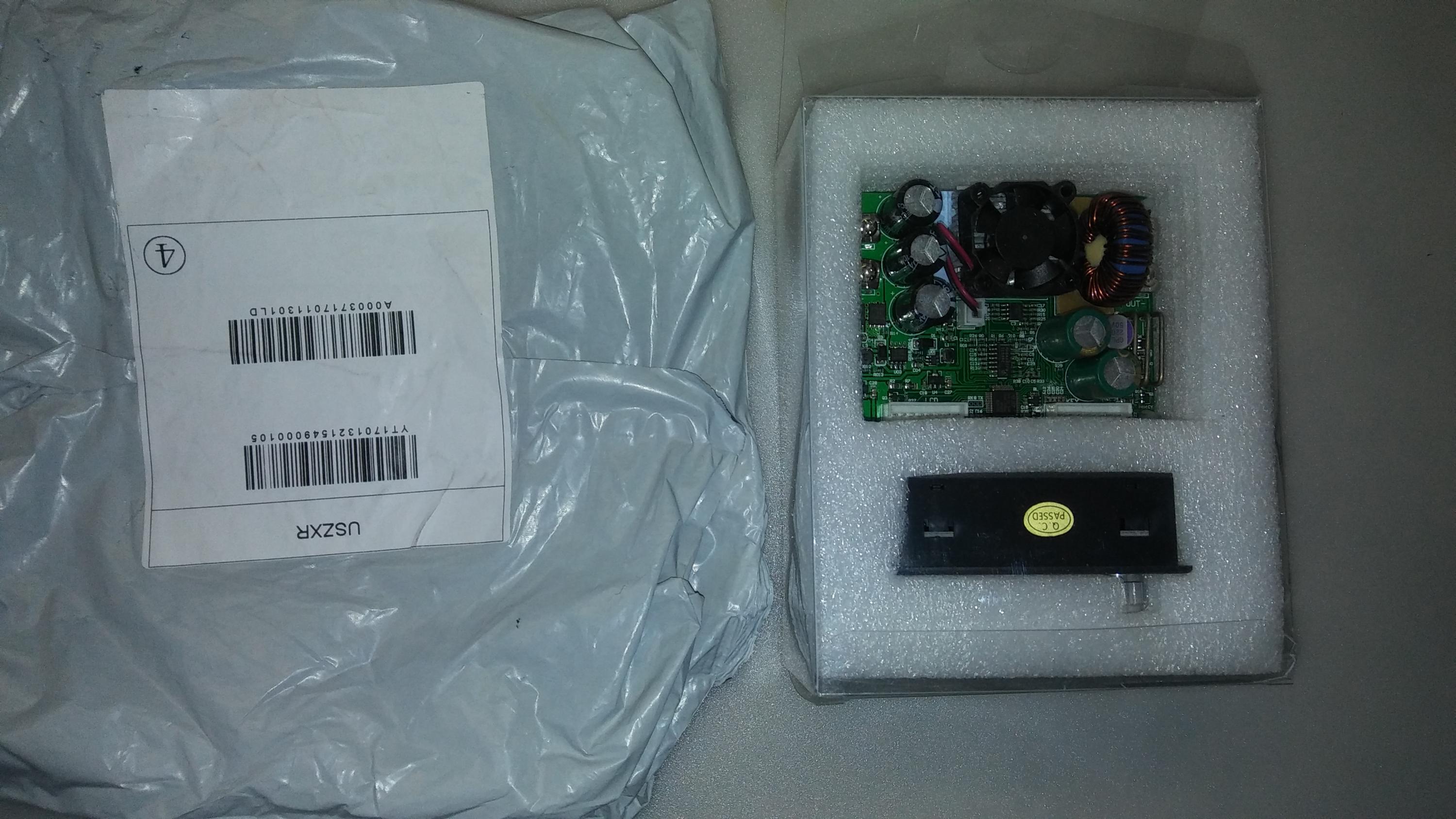

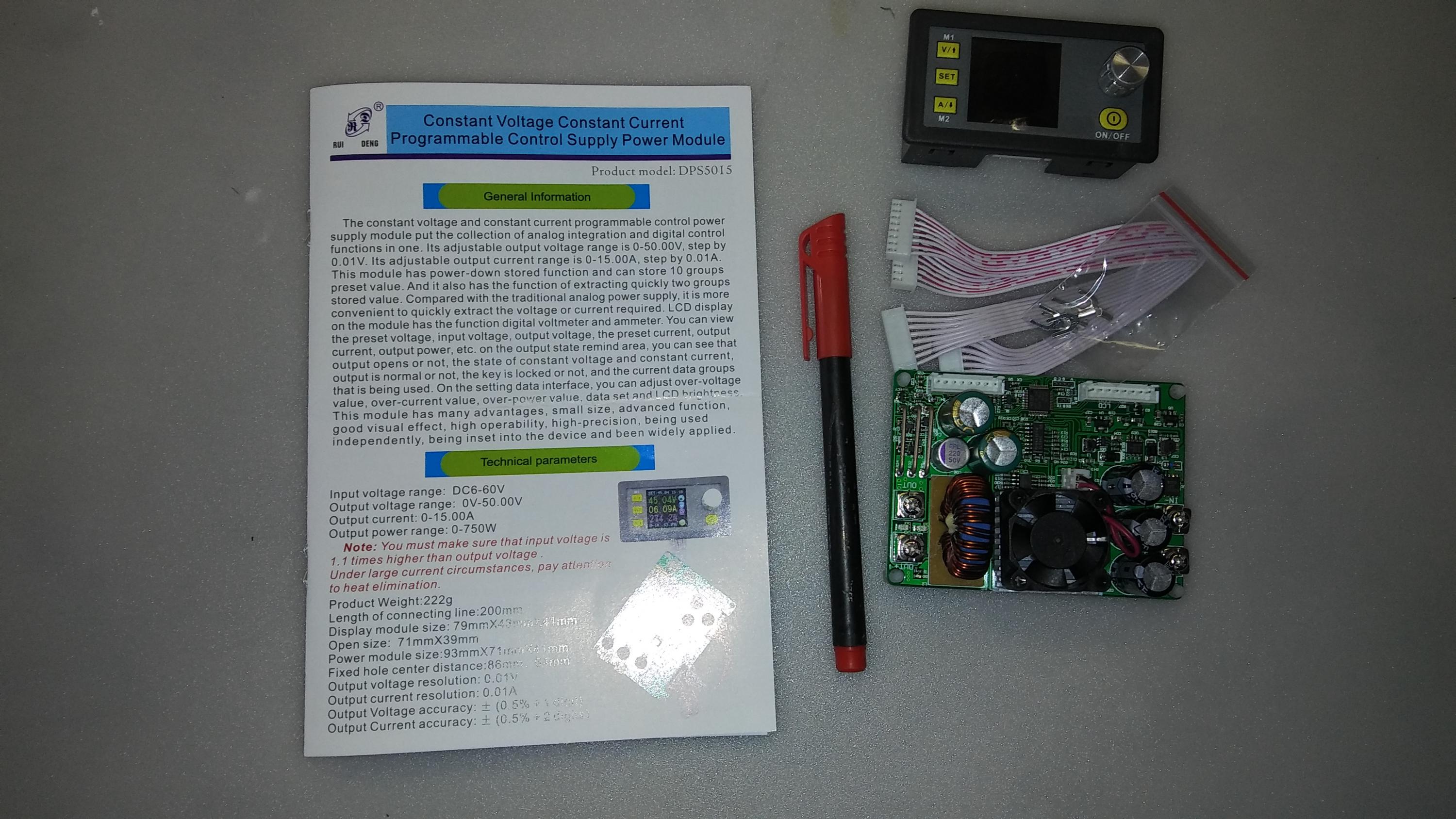

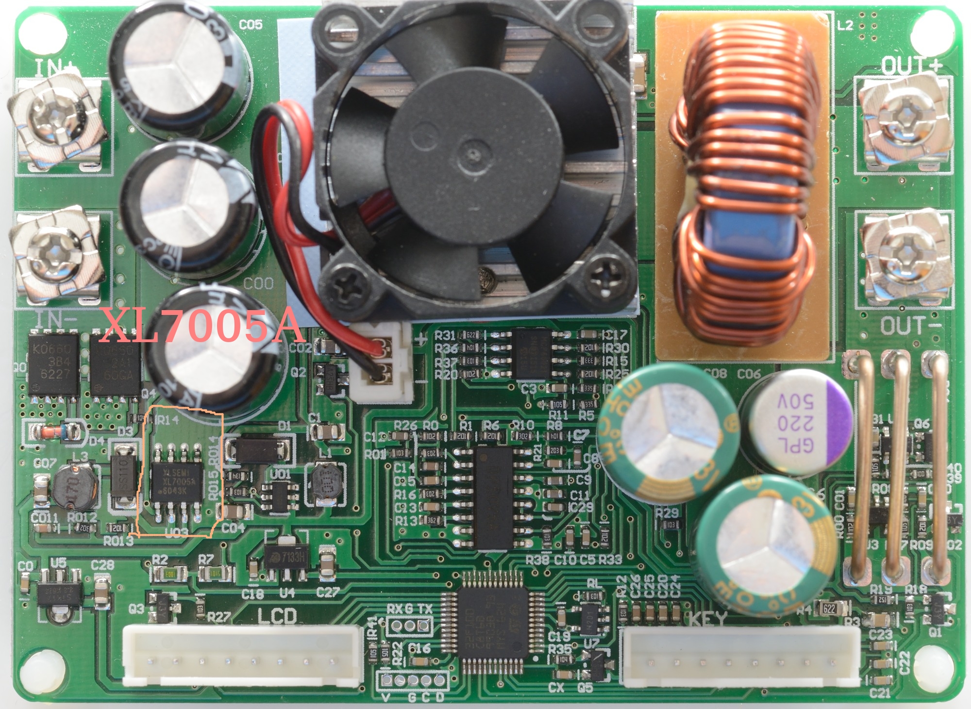

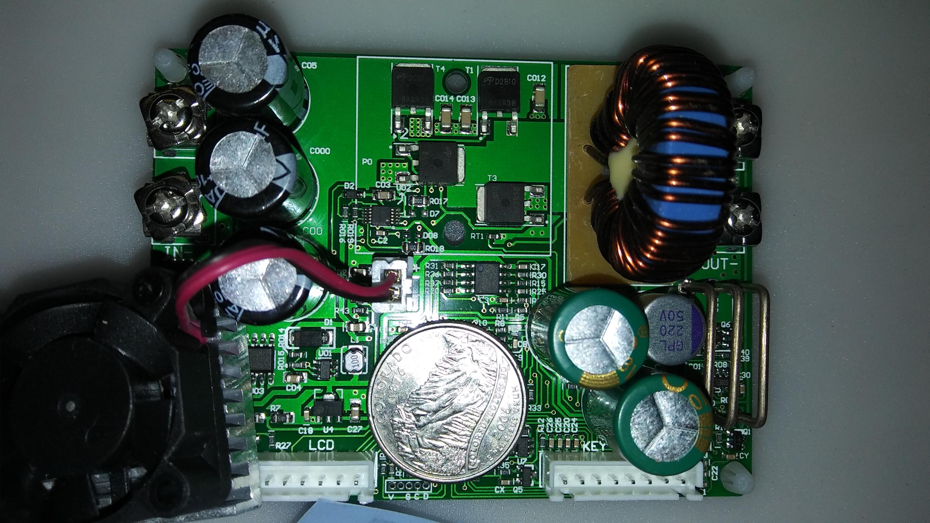

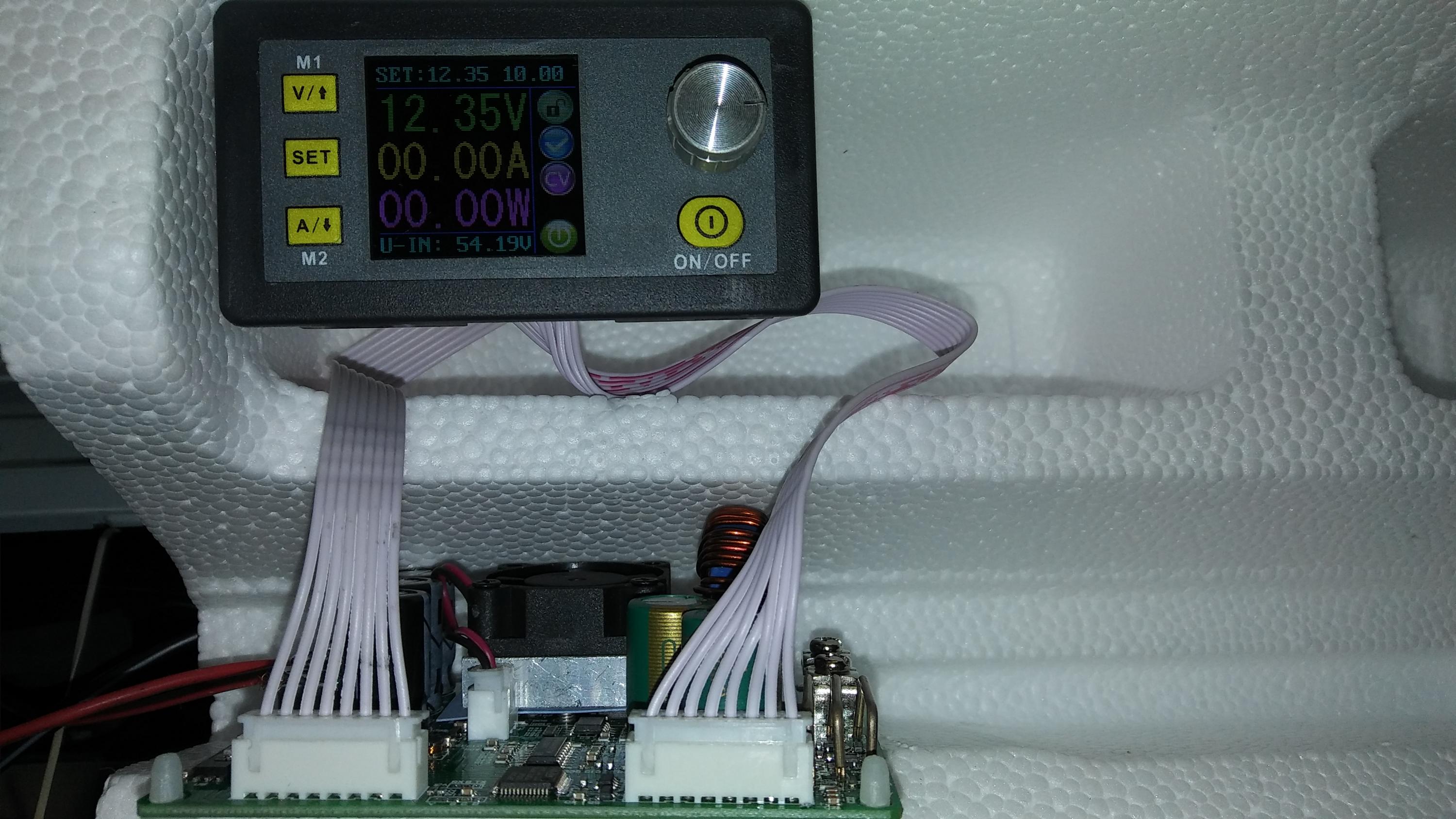

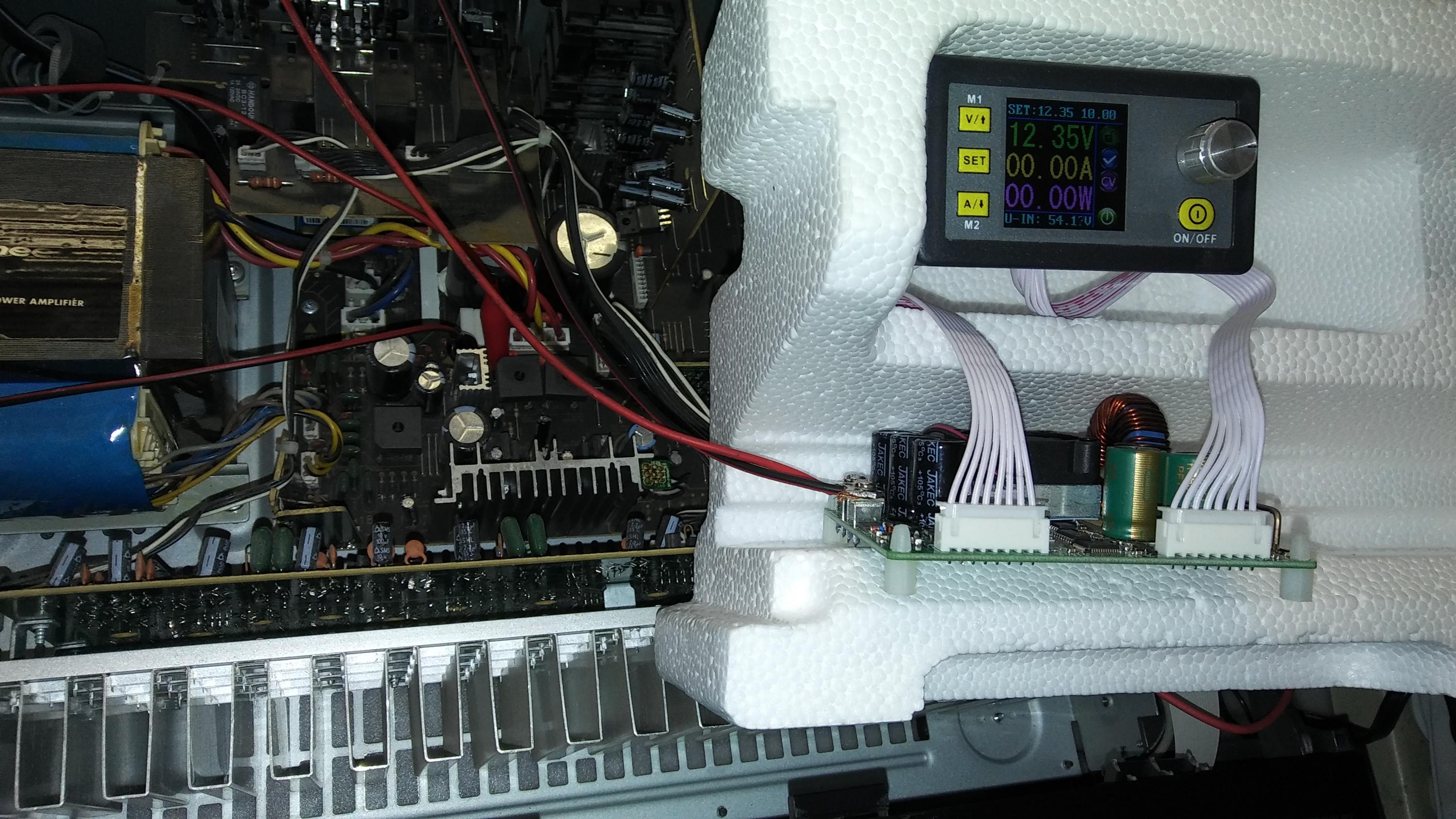

                  DPS 5015 Parts came, Smaller than what I thought.

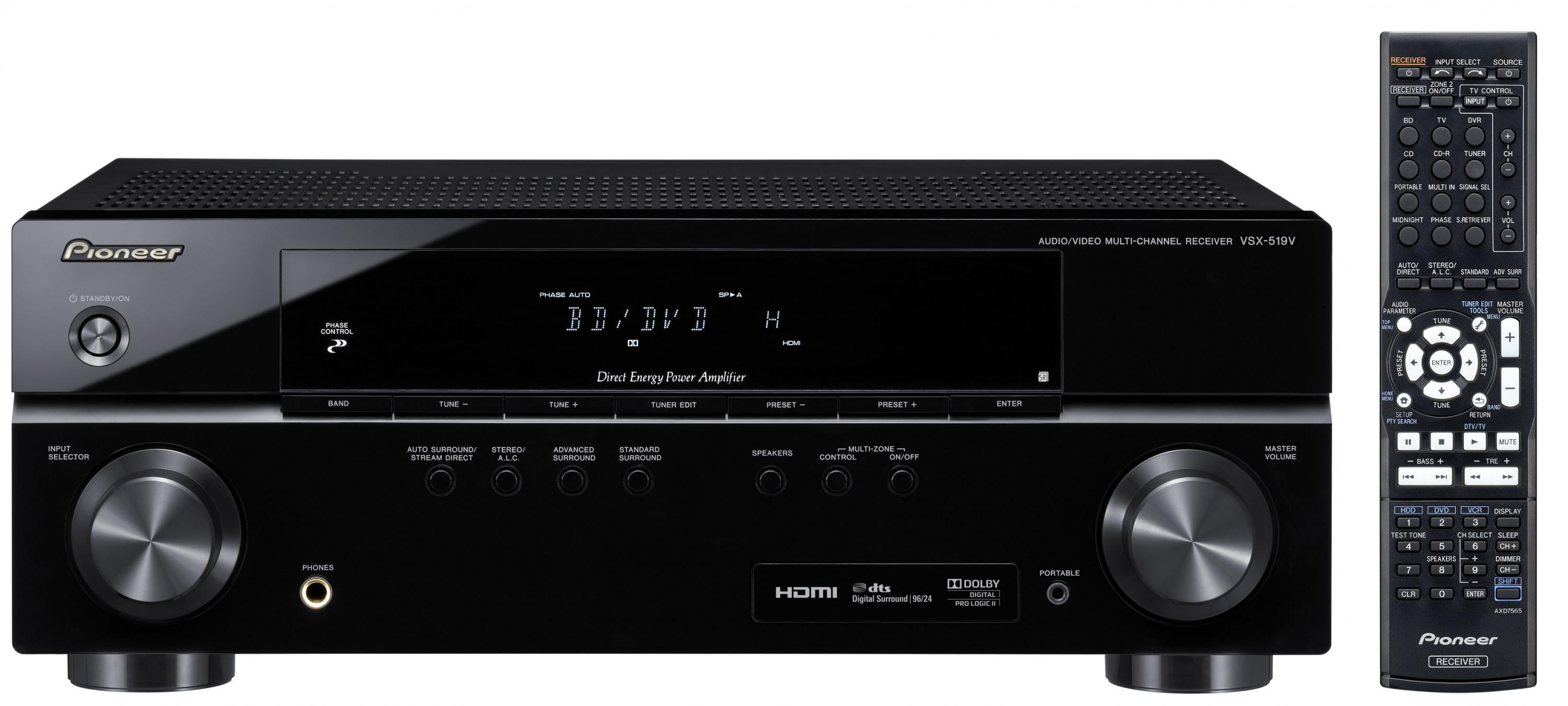

                  Pioneer stereo vsx-519v has no sound, customer abandoned, I gonna use the power supply as sti said : "55-0-55 toroid from an old amplifier," . found AC 39.66v X 1.414 = DC 56v -0-56v, It could be used as a dual 15A power supply. Thanks sti.
                  If I fix the Amp, I can use the power supply and linsen to the music at same time...........Voltage I set up to 12.35v current at 10A( on top of the meter small letters, set: xxxx xxxxx )..........Don't bug me , will change thicker input wires................................
                  PS: My recommendation is: don't but it, It can't survive even at 5A for long period of time! (It is A toy.)

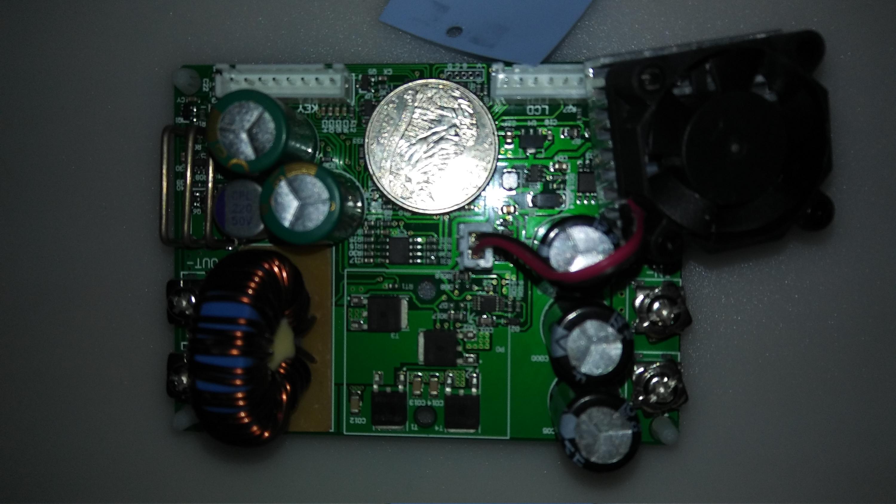

                    • capwizard
                      • Jun 2016
                      • 1991

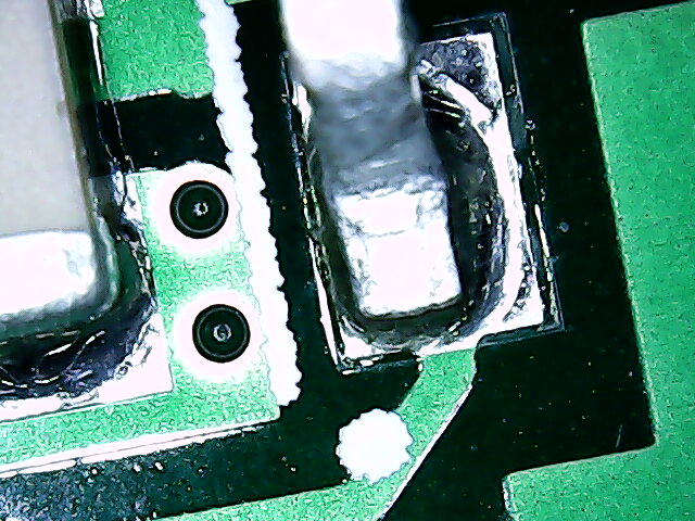

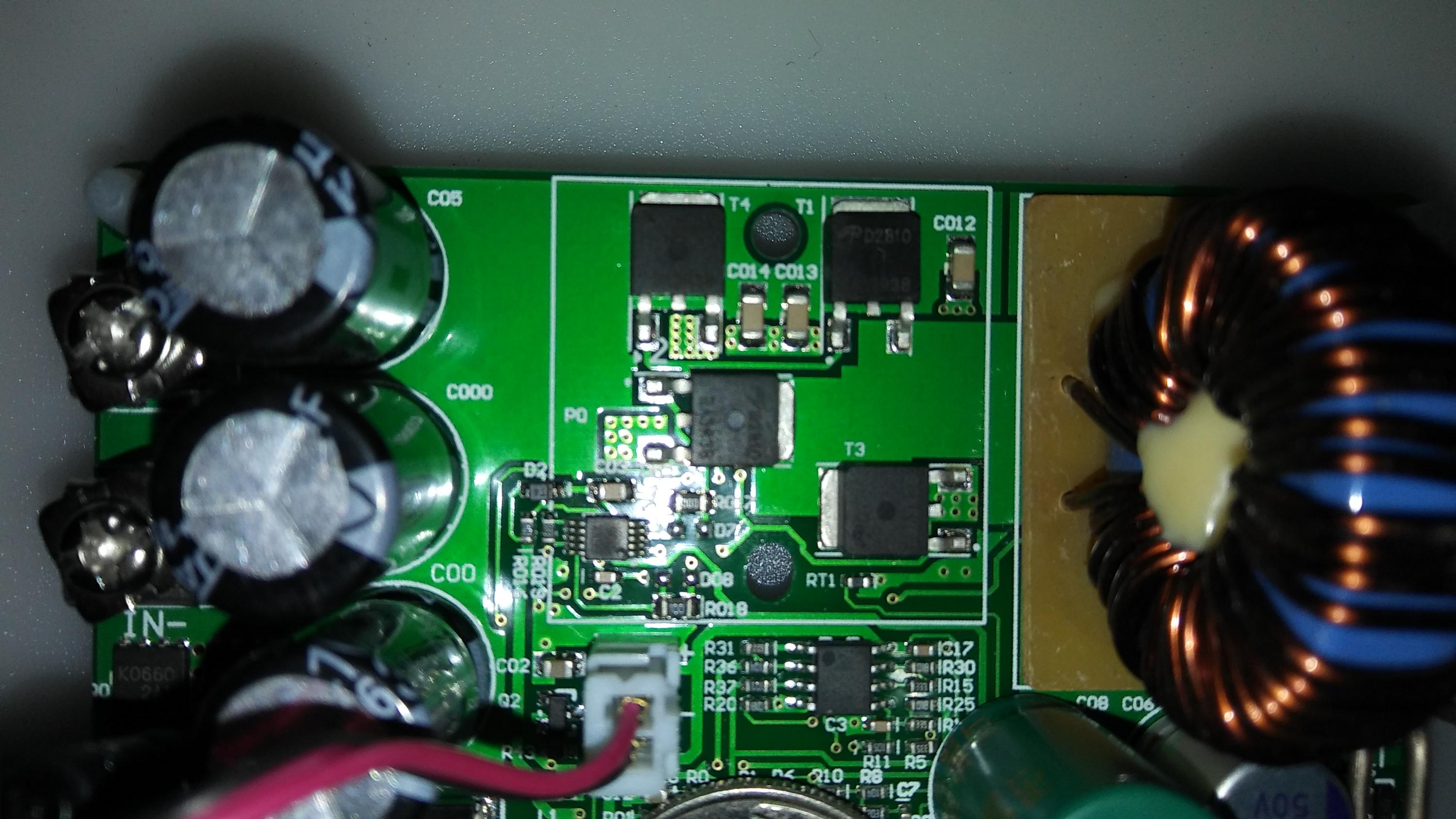

                      "what happens I also bought one, " YOU are my body!..............................

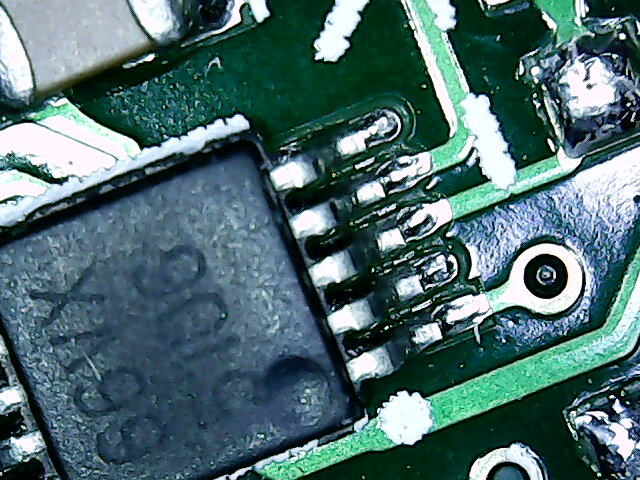

                      The MOSFET legs (pins) under the fan need to be resolder, it already have ring on legs even it is brand new. If you are seriously, you can put bigger TO-220 MOSFETs on it (four MOSFETs bridge) will give more power.
                      "So what amperage can safely run it at for long periods of time"
                      extra large heat sink or oil cooler for cpu.

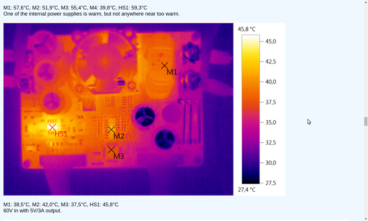

                      Measuring the Voltage Ripple of the DPS5015
                      https://www.youtube.com/watch?v=WpbkxL0p7u8
                      http://www.eevblog.com/forum/testgea...ps5015-50v15a/
                      http://lygte-info.dk/review/Power%20...arts%20UK.html
                      Compared to professional units it is missing a lot: Lower noise, both numeric keypad and encoded, 4 terminal connections, computer control, larger display. But for the price it is very good and works fine.
                      http://lygte-info.dk/review/Power%20DPS5015%20UK.html

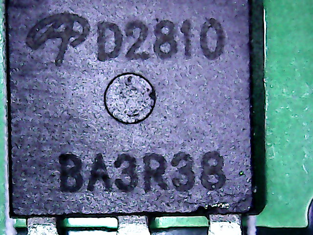

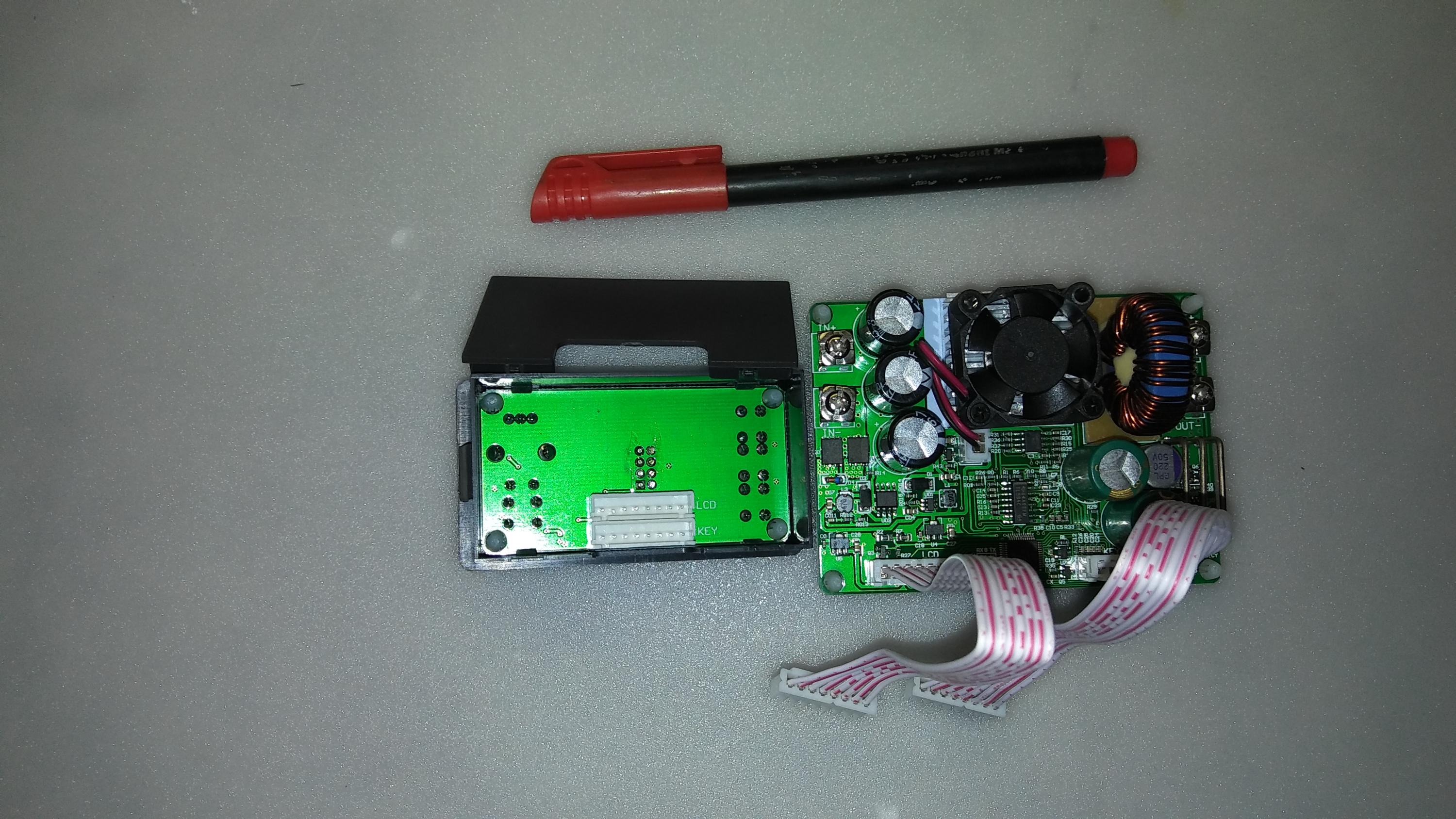

                        Need help to find the specification of this mosfet which is one of the (four MOSFETs Full Bridge)? at Pic8
                        Pic last one: The MOSFET legs (pins) under the fan needs to be resolder, it already has ring on leg even it is brand new (with never load)
                        PS: look! How small it is!
                        Hope! Can use Door Hinge Rework Station take out the microcontroller and read Firmware on it then ZIP for you guys. Anyone has idea of those pins ( V GCD) or the other one (Rx B TX) at (pic2) . Can I read it with my TL866A ? and HOW?

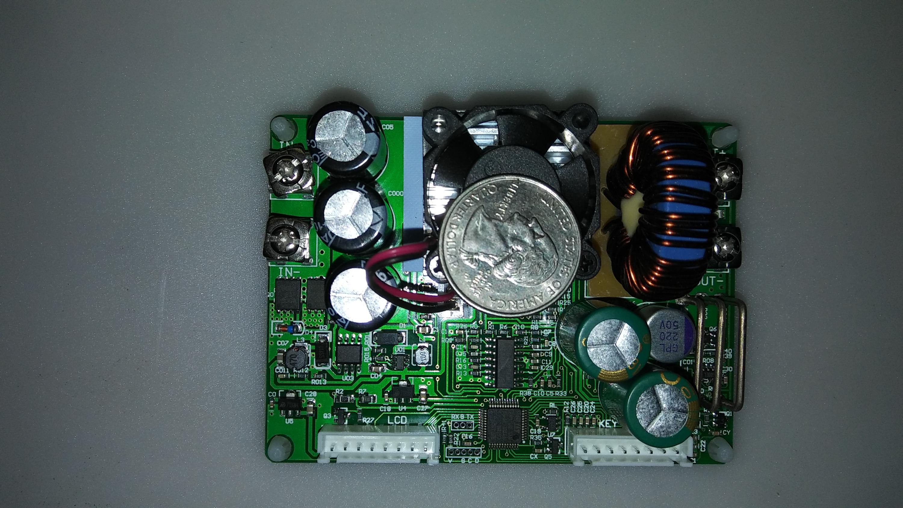

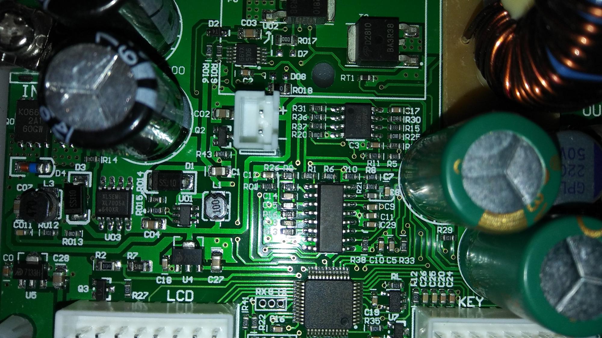

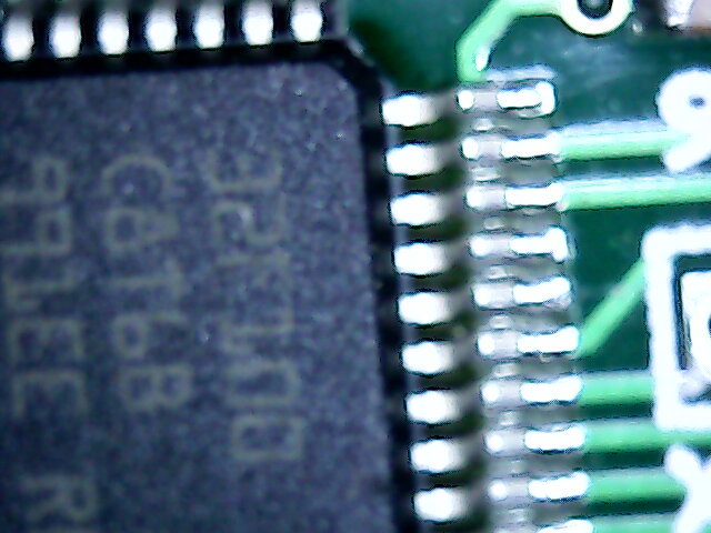

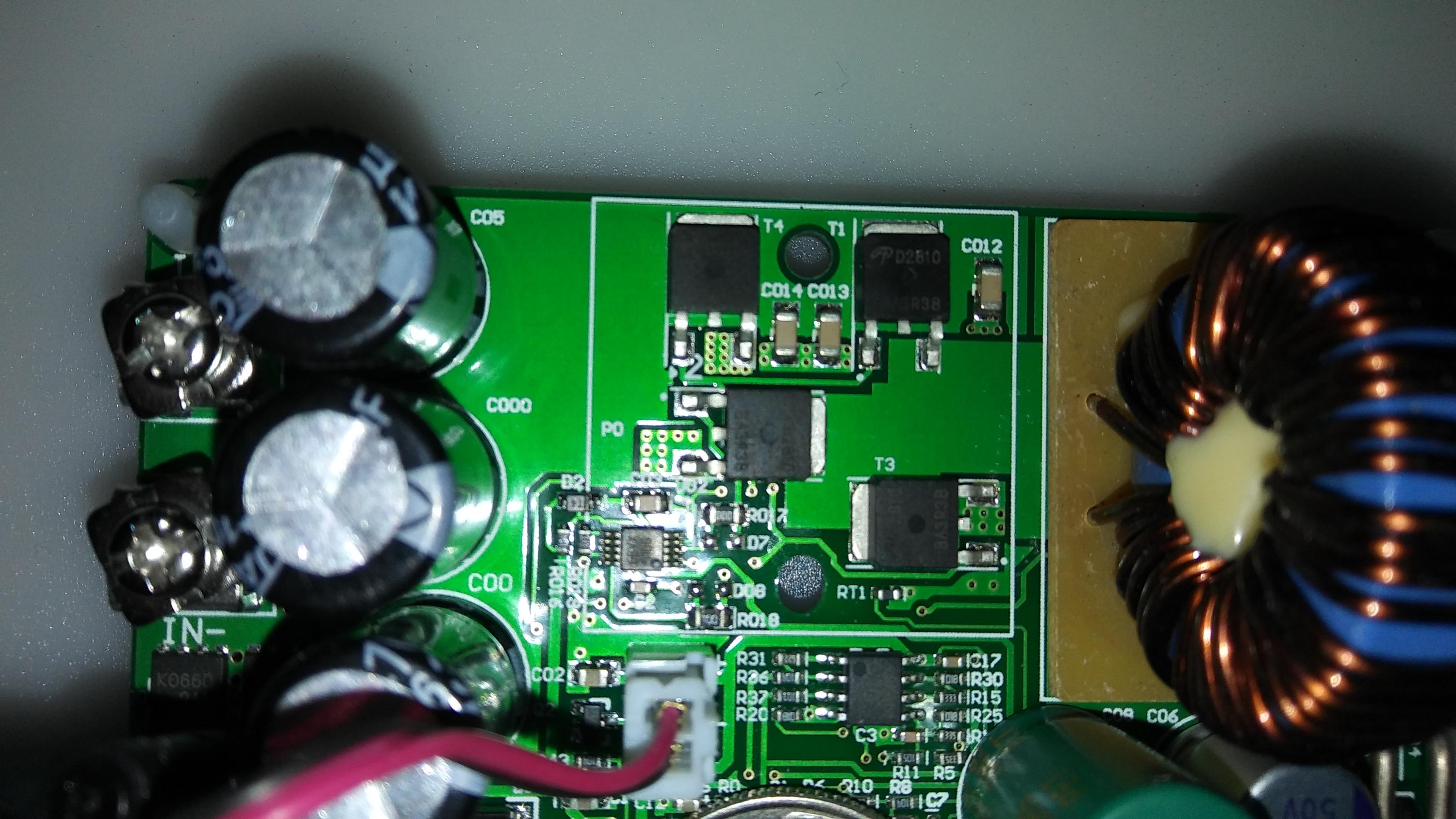

                          microcontroller is 32f100 in LQFP48 packing
                          https://cdn.badcaps-static.com/pdfs/...a875e57a69.pdf
                          PS: Anyone has idea of those pins ( V GCD) or the other one (Rx B TX) at (pic2) . Can I read it with my TL866A ? and HOW?
                          PS: TX is at pin30, RX is at pin 31, (pin30 is PA9 pin31 is PA10?).
                            It is not hooked up as full bridge, look at how Gate of T1 and T4 are tied together, also how the Drain of T2, T3 are tied together and connected to T1 Drain.

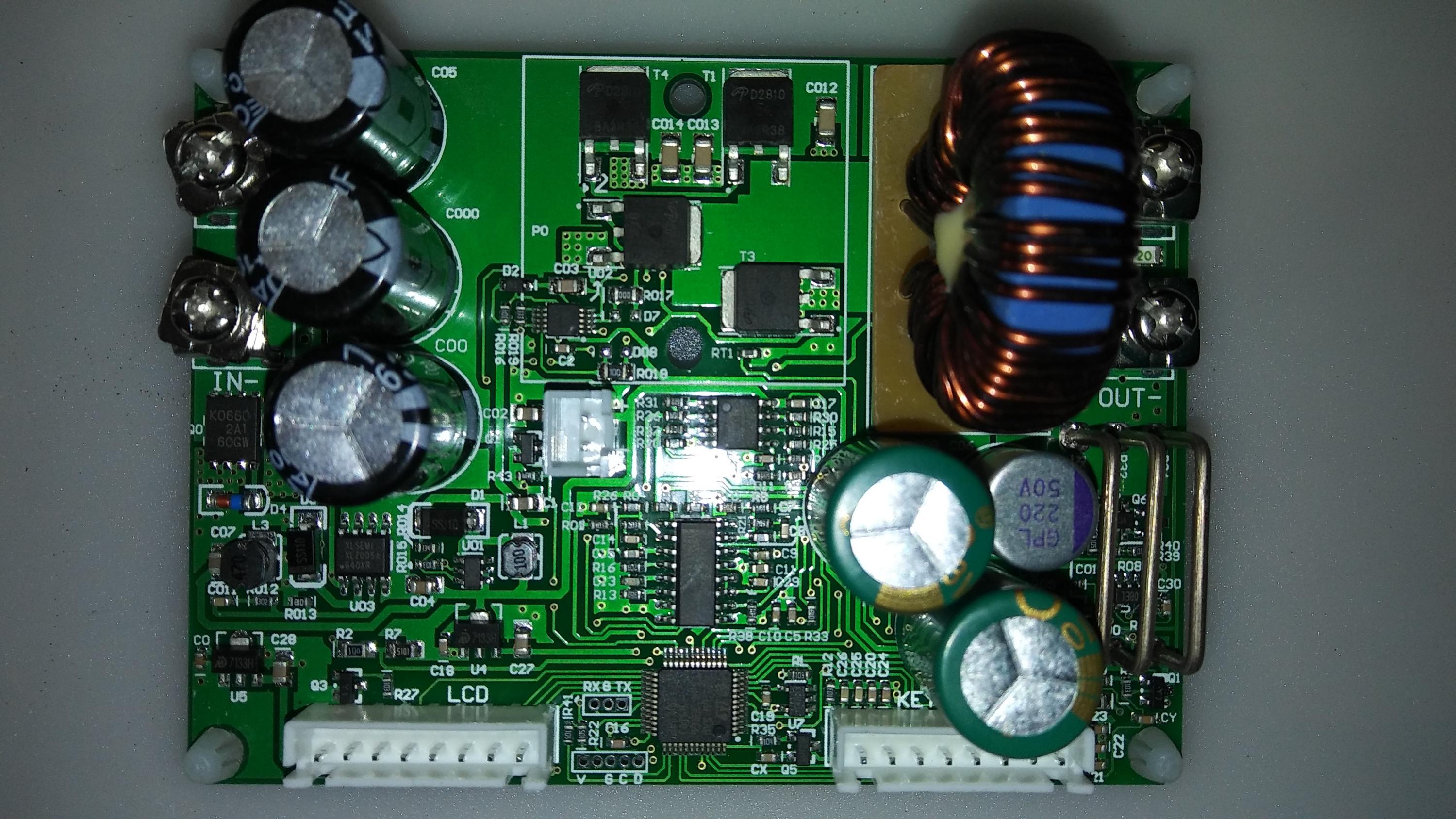

                              You are good and Youre really pay attention to detail. YES it is A Half-Bridge.......you're right again..............
                              Pic1 is U02 show 5106 is LM5106 100-V Half-Bridge Gate Driver With Programmable Dead-Time
                                So that 10-pin IC where the 4 MOSFETs are, is it XL7005? 5106?
                                Never mind, I see it now.

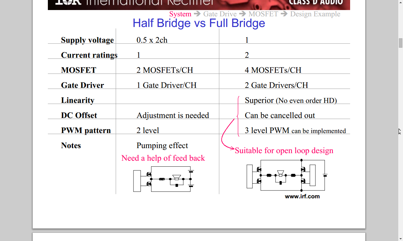

                                  One question? why uses A half-bridge driver not the full bridge driver?
                                    Full Bridge, both terminals of outputs are not ref to GND, V drops on the load is also about 2x the supply Voltage, they are both hot, same basic as amplifier set to bridge mode.
                                    You need to see how those 4 MOSFETs are actually connected.
                                      "V drops on the load is also about 2x the supply Voltage." very good!
                                      PS: Ive traced the circuits, it like twins, two MOSFETs put together to increase current, and it only has two driver signals (Lo and Hi) (full bridge needs 4 driver signals.).
                                      My home work.
                                      provides characterization data of its half−bridge driver to show the maximum negative voltage the driver can safely operate with. To prevent the negative injection, it is the designer duty to verify that the amount of negative voltage pertinent to his/her application does not exceed the
                                      characterization curve we provide, including some safety margin.
                                      Confirm zero-voltage switching during all operating conditions
                                      http://www.powerguru.org/the-half-br...cuit-revealed/
                                      Half Bridge vs Full Bridge
                                      https://cdn.badcaps-static.com/pdfs/...aa877cf64a.pdf
