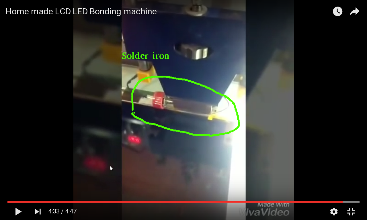

    Home made LCD LED Bonding machine
    https://www.youtube.com/watch?v=j_Y0VSElRB0
    I try to copy this idea use hand crank winch (Pic1).and Temp. control solder iron as a heating element. I will add microscope as an optical alignment.
    Yes, it is a LCD Bonding Machine or a COF Bonding Machine.

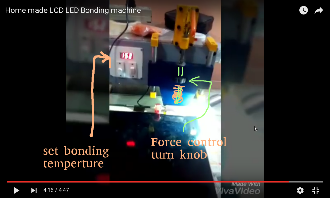

    Re: Home made LCD LED Bonding machine
    The bonding force control use turn knob to adjust the pressure.
